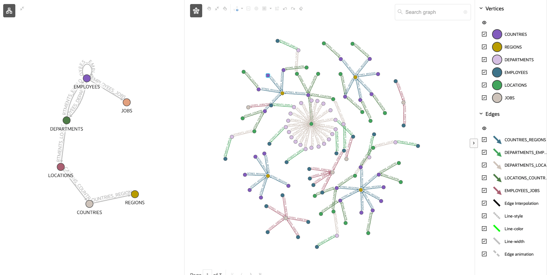

Once the schema view is enabled, it will appear along side the graph in the graph visualization panel as shown:
Figure 3-1 Visualizing Schema and Graph Views

3.4.1 Schema View Modes
You can switch between Schema view, Graph view, or use both in the graph visualization panel using the toggle buttons in the toolbar.
Depending on which toggle button is active the corresponding view will be displayed. The following describes more about the supported modes:
- Schema: In this mode, the schema view is displayed spanning the entire visualization.
- Graph (default): In this mode, the graph is displayed spanning the entire visualization.
- Schema and Graph: In this mode, when both the toggle buttons are active, the schema and graph regions will appear side-by-side with a separator in between, as shown in Figure 3-1. The separator can be dragged to resize the regions.
It is important to note that depending on your data and settings configurations, either the Schema or Graph view will be always enabled in the toolbar. If both the toggle buttons are manually turned off, then it automatically defaults to Graph view.
