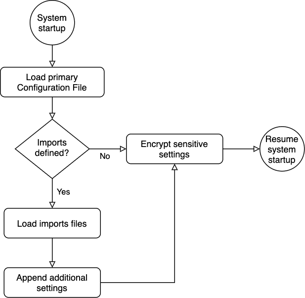

Importing Additional Configuration Files in Spatial Studio
Spatial Studio 22.1 allows you to import different configuration files into the main sgtech_config.json configuration file.
The following describes the workflow for handling multiple configuration files:
Figure 2-7 Workflow to Handle Multiple Configuration Files
Description of Figure 2-7 follows
Description of "Figure 2-7 Workflow to Handle Multiple Configuration Files"
  1. At startup, Spatial Studio loads the primary configuration file, sgtech_config.json.
    All the settings defined in sgtech_config.json are used as the base settings.
  2. If the sgtech_config.json file contains the imports directive, then it loads the import files in the order (top to bottom) in which they are declared.
    For each loaded import file, the system reads and appends the settings to the base settings.
  3. Once the base settings are all read in, the system encrypts any sensitive items and saves them back to their corresponding file.
  4. Spatial Studio resumes loading the rest of the system.
