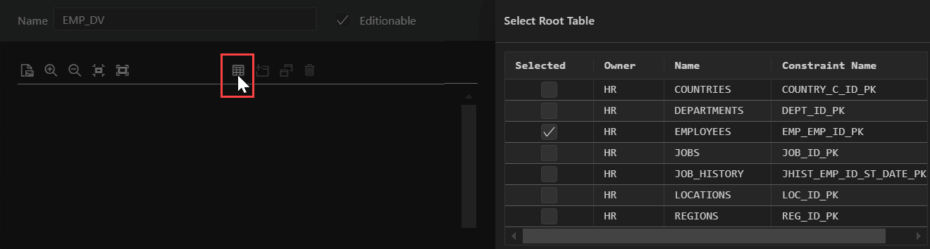

  1. From the toolbar, select Add Root Table. In the following figure, the table Employees is selected.
    Select root table
  2. In the Select Root Table pane, select the checkbox for the root table that you want, and click Apply.
    The selected table appears in the diagram pane. You can zoom in and zoom out and export to SVG format using the icons in the toolbar.

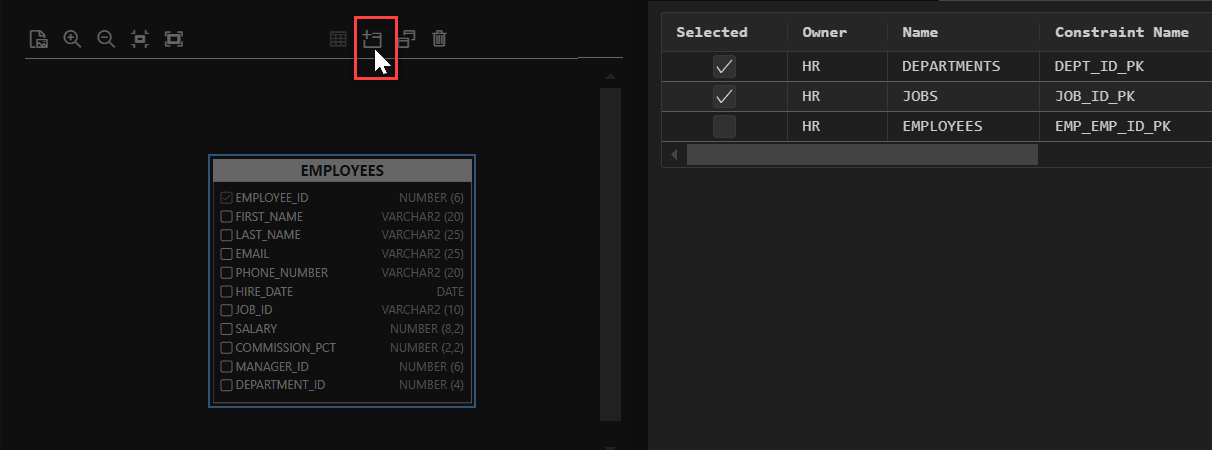

  3. You can now select Parent and Child Tables. Select the table in the diagram (when selected, a blue border appears around the table) and from the toolbar, and select Add Parent Table(s). Following this, if you want to add child tables, select the parent table and select Add Child Table(s) from the toolbar.
    In the following figure, Departments and Jobs are selected as parent tables.
    Select parent tables

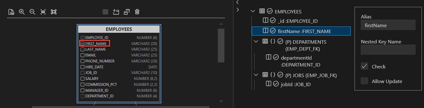

  1. You can select additional columns for the table by selecting the appropriate checkbox in the diagram panel. As you select, these changes instantly appear in the preview panel. Select an object in the preview panel to set additional properties such as Alias, Nested Key Name, Allow Update, Allow Insert, Allow Delete, Check, and Filter.
    In the following figure, the First_Name column is selected in the diagram panel and it immediately appears in the preview panel. Select First_Name in the preview panel to set additional properties such as Nested Key Name, Check and Allow Update.
    Preview panel

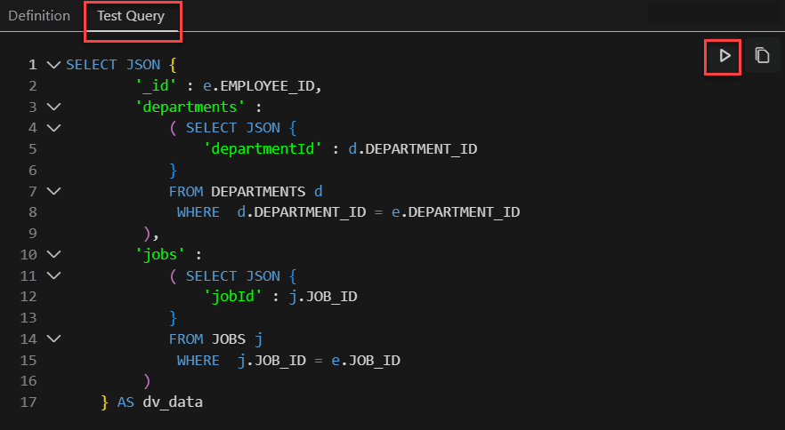

  1. In the Definition tab, the duality view definition is automatically generated as a SQL Statement.
  2. To test the SELECT statement, select the Test Query tab and click the Run Query icon.
    test query
    The output is displayed below the defintion panel.

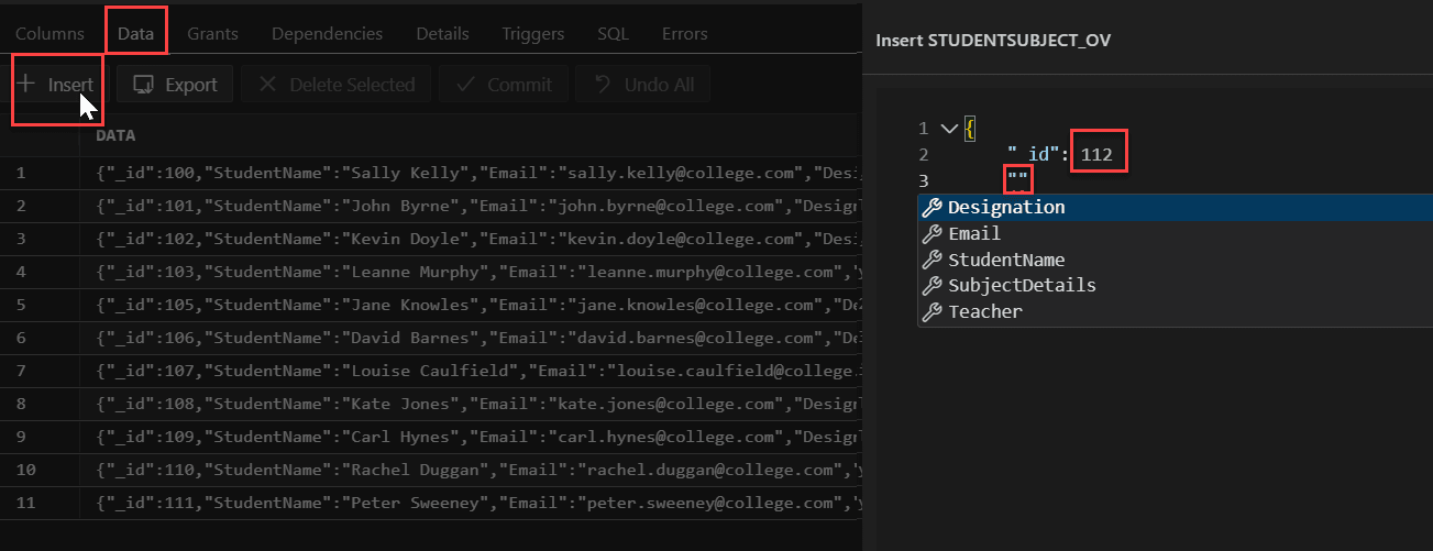

  1. In the Connections panel, expand the Duality Views node, and then click the duality view name to open it in the right panel.
  2. Select the Data tab.
  3. Click Insert.
  4. In the Insert panel, enter the value for the first property. Press the Enter key to move to the next line. When you enter quotation marks, the available properties that you can choose from are displayed in a list.
    Inserting data record
    If you add any new property that is not part of the schema, an error notification is displayed.
    After you complete entering all the details, click Save.
  5. Click Commit to commit the changes to the database.

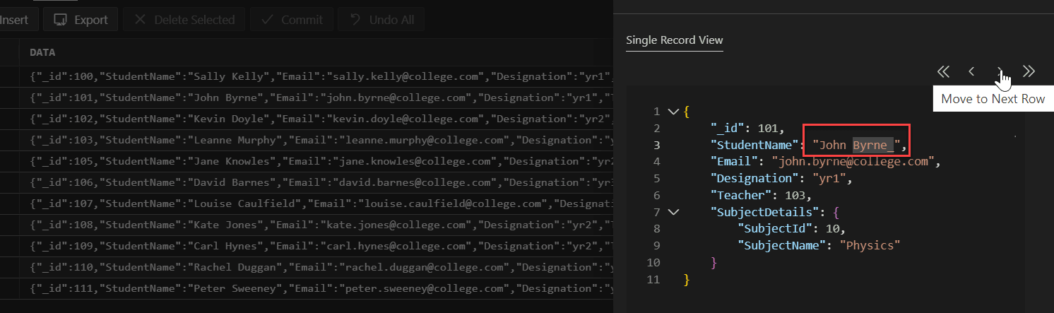

  3. Position the cursor on the row that you want to edit, right-click and select Single Record View.
    Alternatively, click the Edit icon at the end of the row that you want to edit.
  4. In the Single Record View panel, click and type to complete the required changes.
    Edit data record
    To move to another record, you can use the move to next row or move to previous row icons.

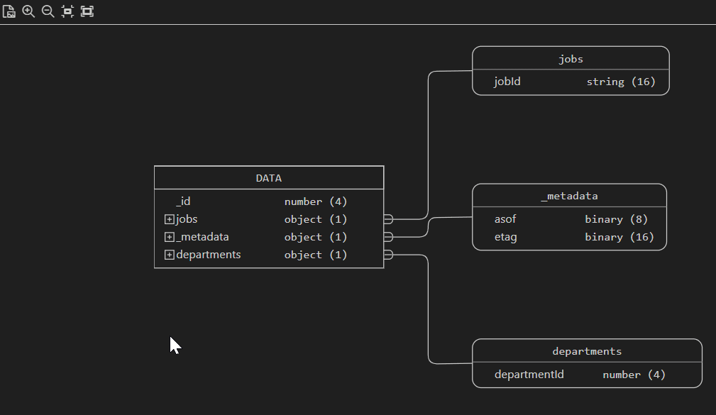

3.3.5 Display the JSON Data Guide Diagram for a Duality View
The JSON data guide diagram represents the JSON schema for a duality view.
In the Connections panel, expand the Duality Views node, right-click the name of the duality view to edit, and select Show JSON Data Guide to display the diagram.
The following figure displays the JSON data guide diagram for the EMP_DV duality view that was created in Create a Duality View.
