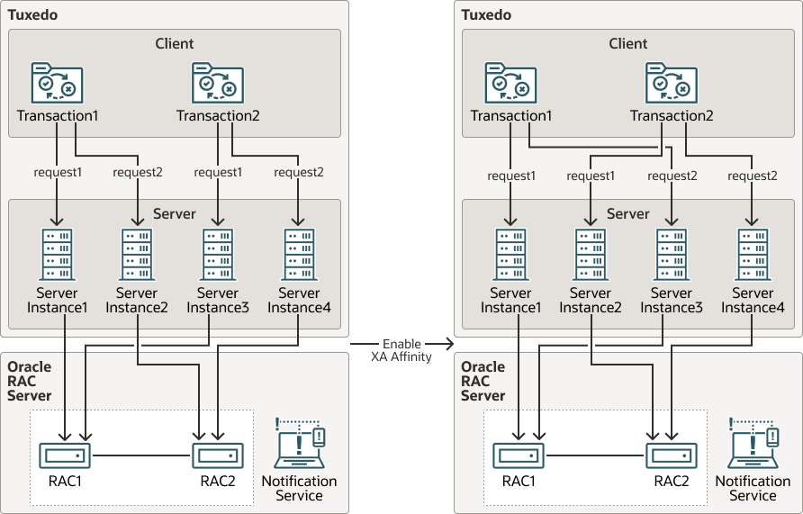

3.4 Single Group Multiple Branches (SGMB)
3.4.1 Scenarios Recommended
If a Tuxedo application is running on the Oracle RAC, you may want to take advantage of non-singleton database service, such as load balance, service failover, and so on. Tuxedo groups can use RAC non-singleton service by enabling this feature. Given that the business may involve multiple groups, it is better to also enable Common XID and XA Transaction Affinity to achieve good performance.
A typical UBB configuration is as follows.
Listing UBB Configuration
*RESROUCES
MODEL SHM
OPTIONS XPP
*MACHINES
"mach1" LMID=L1
*GROUPS
GRP1 LMID=L1 GRPNO=10 TMSNAME="TMSORA1"
OPENINFO="Oracle_XA:ORACLE_XA+SqlNet=orcl.tux3+ACC=
P/scott/tiger +SesTM=120"
GRP2 LMID=L1 GRPNO=20 TMSNAME="TMSORA2"
*SERVERS
server1 SRVGRP=GRP1 SRVID=10 MIN=4
server2 SRVGRP=GRP2 SRVID=10 MIN=4
GRP1 and GRP2 use the same net service
orcl.tux3 to connect the resource manager; orcl.tux3 is
configured to database service tux3, which both RAC instance1 and instance2
support. Server1 offers Tuxedo service svc1 and
server2 offers Tuxedo service svc2. The transactional
business A calls svc1 and then svc2, and so involves both
server1 and server2. Because orcl.tux3 is
non-singleton database service, server1 copies associate with either
instance1 or instance2, so do server2 copies.
SGMB can ensure business working well and ensure that business A transactions are distributed evenly on instance1 and instanc2.
Given that both Common XID and XA Transaction Affinity are enabled, all business A transactions become one-phase commit.
Parent topic: Single Group Multiple Branches (SGMB)

3.5 Common XID
Common XID shares the coordinator's instance information and branch (common XID) to all participated groups. The servers in a participated group will reuse the common XID if they have the same instance information as the coordinator does. This feature brings significant performance improvement when a global transaction involves multiple groups, especially when all participated groups associate with the same database instance through the same database service.
3.5.1 Scenarios Recommended

3.5.1.3 Scenario C
Redundant servers or groups are configured when they are running on different Oracle RAC instances. Given this scenario, the XA Transaction Affinity feature should be enabled too. It helps the business involves the servers/groups that associate same database instance via same database service with the coordinator.
Listing 19 UBB Configuration
*RESROUCES
MODEL SHM
OPTIONS XPP
*MACHINES
"mach1" LMID=L1
*GROUPS
OPENINFO="Oracle_XA:ORACLE_XA+SqlNet=orcl.tux1+ACC=
GRP3 LMID=L1 GRPNO=30 TMSNAME="TMSORA3"
OPENINFO="Oracle_XA:ORACLE_XA+SqlNet=orcl.tux2+ACC=
*SERVERS
server1 SRVGRP=GRP1 SRVID=10 MIN=2
server2 SRVGRP=GRP2 SRVID=10 MIN=2
server3 SRVGRP=GRP3 SRVID=10 MIN=2
orcl.tux1 to connect the resource manager; orcl.tux1 is
configured to database service tux1, which RAC instance1 supports.
GRP3 uses net service orcl.tux2 to connect the resource
manager; orcl.tux2 is configured to database service tux2,
which RAC instance2 supports. Server1 offers Tuxedo service
svc1; both server2 and server3 offer
Tuxedo service svc2. The transactional business A calls svc1
and then svc2.
In general, business A may involve server1 and server2, or
server1 and server3, because of Tuxedo load balance. When
Common XID is enabled, the transactions that involve server1 and
server2 become one-phase commit; when XA Transaction Affinity feature is
enabled, business A always involves server1 and server2 so
that all transactions of the business A would be one-phase commit.
Parent topic: Scenarios Recommended

3.6 XA Transaction Affinity
3.6.1 Scenarios Recommended
It is recommended to enable this feature when Tuxedo server has multiple instances running on different Oracle RAC instances via the same Oracle Database service.
In the event that XA Transaction Affinity is enabled, there is no need to utilize the rule of Oracle RAC routing specified by the environment variable TUXRACGROUPS, and this rule will be disabled.
Figure 3-1 XA Transaction Affinity Enablement
Parent topic: XA Transaction Affinity
3.6.2 Limitations
- Groups with multiple resource managers are not supported.
- The max number of affinity context (database name+instance name+service name) in one transaction is 16.
- XA Transaction Affinity does not support multi-server single queue, multi-threaded server, or cross-domain services.
