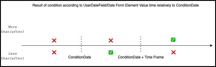

    • 1.1. The trickier ones :
      • More than (after), Less than (after), More than (before), Less than (before)
      • Rules of thumb to follow:
        • Before/After is the relation between UserFieldDate and ConditionDate.
          • –Before = UserFieldDate was prior to ConditionDate
          • –After = UserFieldDate was later than the ConditionDate.
          • –Except some edge cases, which will be discussed and marked by ?
        • More than/less than refers the difference of time between the two dates, compared to a given time frame.
        • Diagram of more/less than (After):
          More than after
        • Diagram of more/less than (Before)
          more than before
        • More than (after)
          • Means: UserFieldDate happens later than ConditionDate by more than the given timeframe.

        • Less than (after)
          • Means: UserFieldDate happens after ConditionDate, within the given timeframe.
            –or UserFieldDate happens before ConditionDate ? (this is not expected, will be changed to be false)
          • Use case: End user should see the guide in autoload if they joined less than one day after March 1 2025
