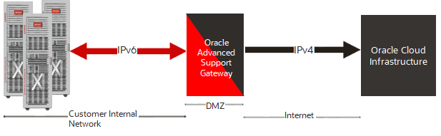

The diagram below depicts an example network configuration featuring an internal customer network and Oracle that incorporates both IPv4 and IPv6.
Figure 1  High Level Network Configuration and IPv4/IPv6 Distribution
image:Picture of high level network configuration and IPv4/IPv6
                            distribution

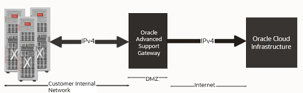

The diagram below depicts an example network configuration featuring an internal customer network and Oracle that uses only IPv4.
Figure 2  High Level Network Configuration and IPv4 Distribution
                            distribution
