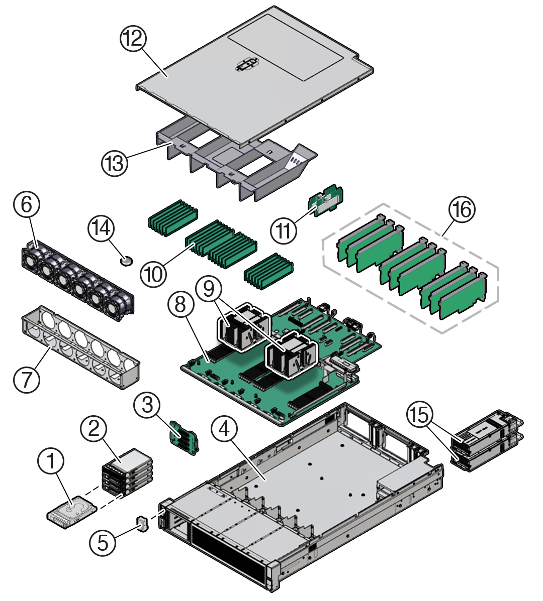

Identify major components of Oracle Database Appliance X10 server.
The following figure identifies Oracle Dababase Appliance X10 server major components.
| Callout | Description |
| 1 | 2.5-inch NVMe SSD (up to two supported with the Oracle Database Appliance X10-S, or up to four with the Oracle Database Appliance X10-L) |
| 2 | Storage drive bay cage |
| 3 | 4-Drive backplane |
| 4 | System chassis |
| 5 | Front LED indicator module |
| 6 | Six fan modules (FM0-5) |
| 7 | Fan tray |
| 8 | Motherboard assembly |
| 9 | Processors (P0, P1) and heatsinks (Single-processor systems contain only a single processor in socket P0; socket P1 contains a cap to protect processor socket pins.) |
| 10 | 24 DIMMs (Twelve DIMMs are supported in single-processor systems and the DIMMs must be installed in P0 DIMM sockets.) |
| 11 | Internal M.2 SSD memory with two internal M.2 Risers |
| 12 | Top cover |
| 13 | Air baffle |
| 14 | System RTC battery |
| 15 | Two power supplies (PS0, PS1) |
| 16 | (Optional) Nine half-height half-length PCIe cards PCIe slots 1 through 4 are nonfunctional in single-processor systems. |

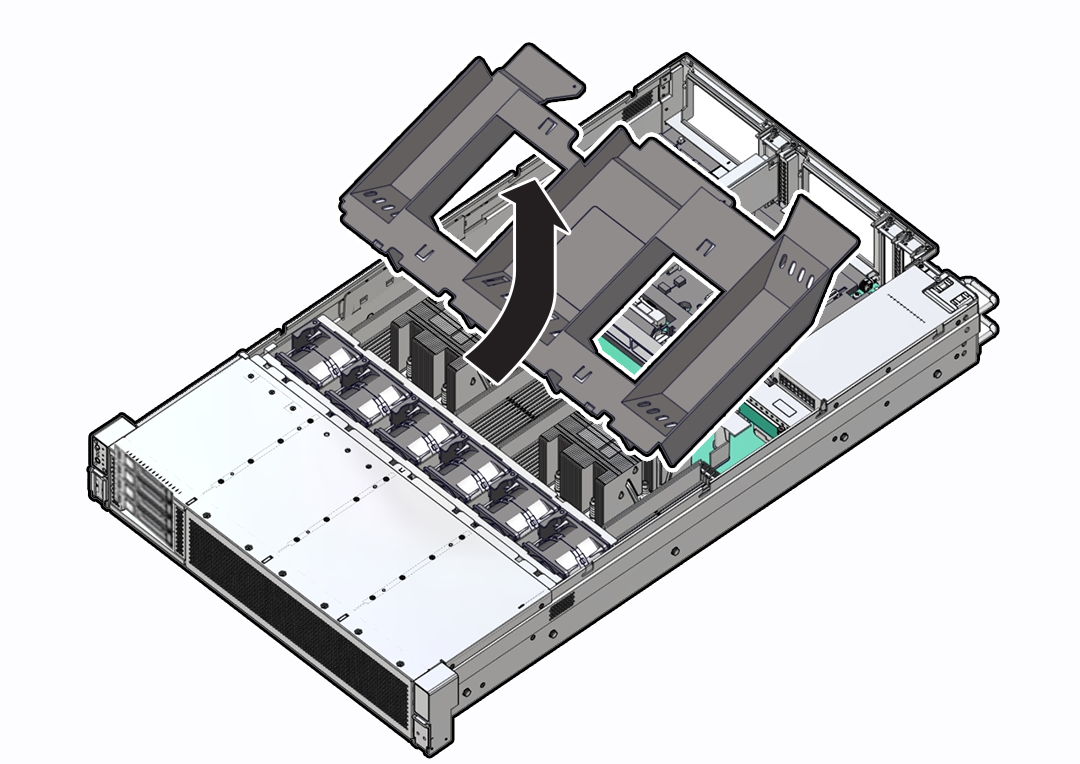

- Remove the Air Baffle

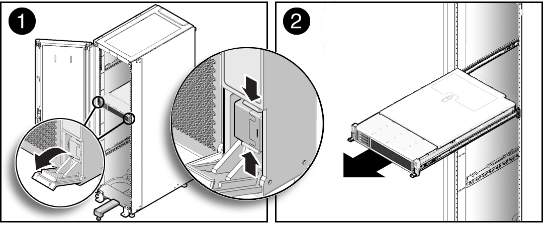

Extend the Server to the Maintenance Position
The following components can be serviced with the server in the maintenance position:
                              Fan modules
                              DDR5 DIMMs
                              Processors
                              M.2 Flash drives and risers
                              System battery
                              Motherboard
                              PCIe cards and cables
                              Disk backplane
                              Front indicator module
If the server is installed in a rack with extendable slide-rails, use this procedure to extend the server to the maintenance position.

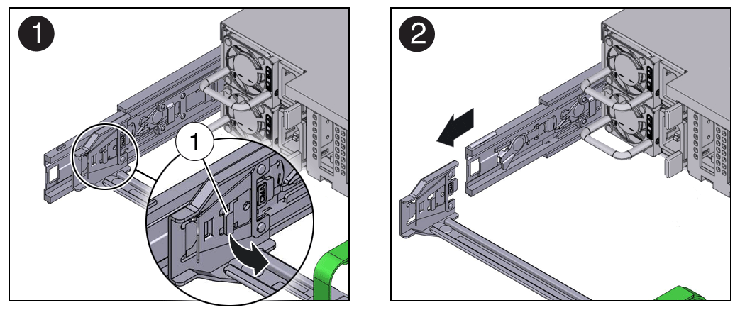

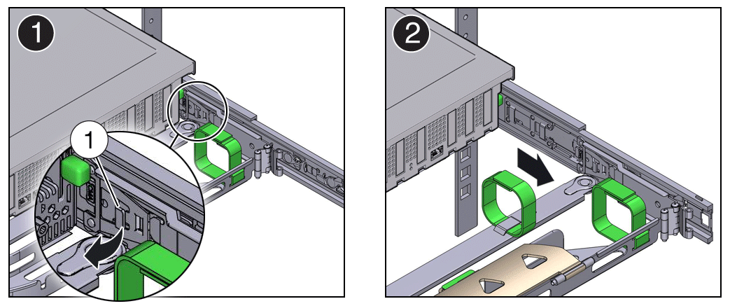

Remove the Cable Management Arm
Follow this procedure to remove the cable management arm (CMA). You might need to remove the CMA to service power supplies or cables connected to the back of the system.
Before you begin this procedure, refer to the illustration provided in the procedure Install the Cable Management Arm (Optional) to identify CMA connectors A, B, C, and D. Disconnect the CMA connectors in the reverse order in which you installed them, that is, disconnect connector D first, followed by C, B, and A.
Throughout this procedure, after you disconnect any of the CMA four connectors, do not allow the CMA to hang under its own weight.
References to “left” or “right” in this procedure assume that you are facing the back of the equipment rack.

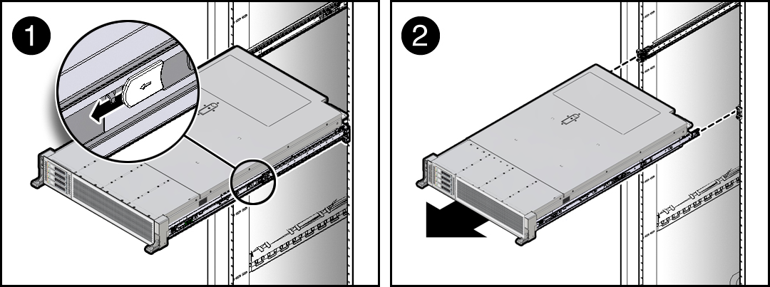

Remove the Server From the Rack
This section describes how to remove the server from the rack. For most service actions you won't need to do this.
Caution:
The server weighs approximately 76 lbs (34 kg). A mechanical lift or two people are required to remove the server from the rack and carry the chassis.Always load equipment into a rack from the bottom up so that the rack does not become top-heavy and tip over. Extend the rack anti-tilt bar to prevent the rack from tipping during equipment installation.
Parent topic: Preparing the Server for Component Replacement

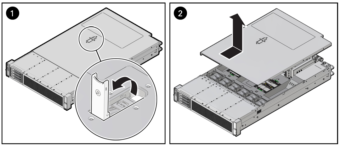

Remove the Server Top Cover
Remove the top cover to service components inside the server.
