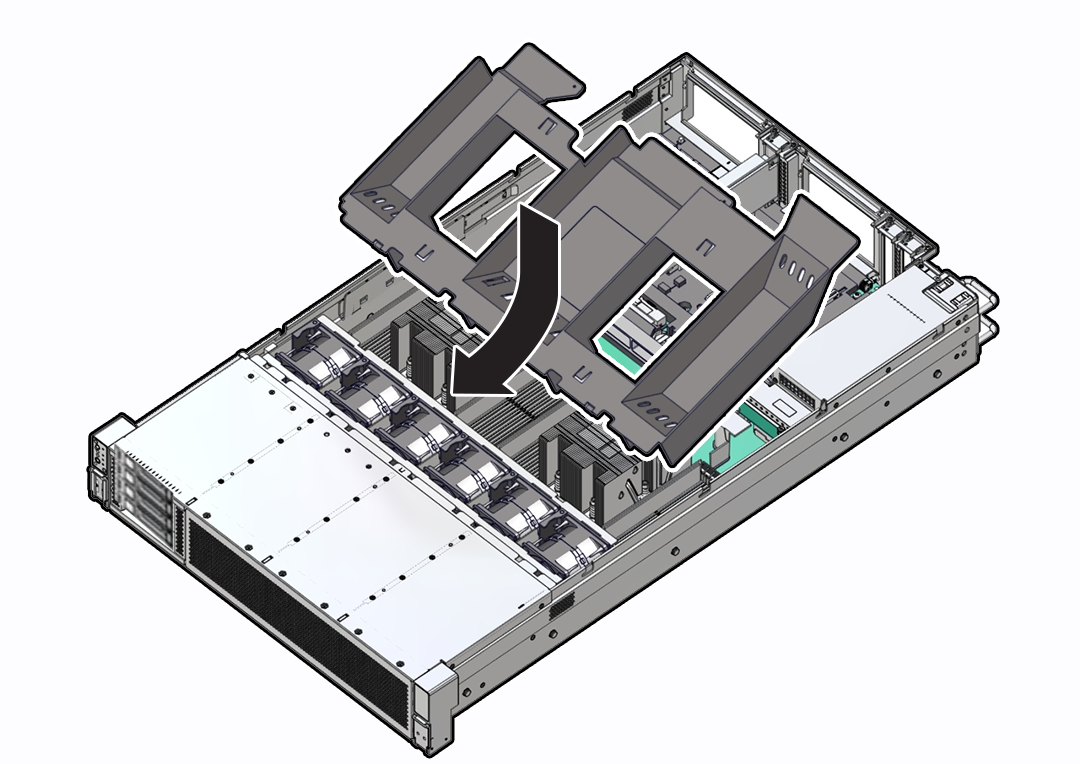

Install the Air Baffle
Install the air baffle by placing it into the server and lowering it to its inserted position.
To install the air baffle, the baffle must fit around the processor heatsinks, then lifted up about 50 degrees. Locate the tabs on the air baffle so that one tab on each side is under the lip of the fan tray, and the others are on top of the fan tray.
Description of the illustration aog-54_install-air-baffle.png -
Consider your next step:
If you removed the air baffle as part of another procedure, return to that procedure.
Otherwise, continue to with this procedure.

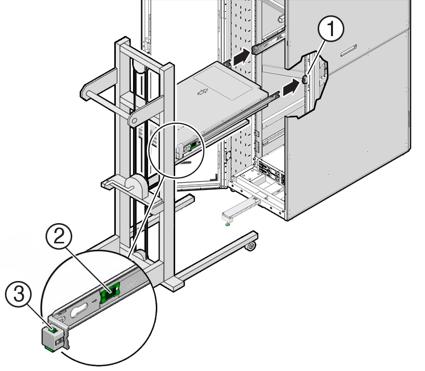

Reinstall the Server Into the Rack
Use this procedure to install the server chassis with mounting brackets into the slide-rail assemblies that are mounted to the rack.
Caution:
Personal Injury or Equipment Damage: This procedure requires a minimum of two people because of the weight of the server. Attempting this procedure alone could result in equipment damage or personal injury.
Always load equipment into a rack from the bottom up so that the rack does not become top-heavy and tip over. Extend the rack anti-tilt bar to prevent the rack from tipping during equipment installation.
- To prevent the rack from tipping forward when the server is extended, extend all
rack anti-tilt mechanisms.
See Stabilize the Rack.
- Push the slide-rails as far as possible into the slide-rail assemblies in the rack.
- Position the server so that the back ends of the mounting brackets are aligned with the slide-rail assemblies that are mounted in the rack.
- Insert the mounting brackets into the slide-rails, and then push the server into
the rack until the mounting brackets are flush with the slide-rail stops
(approximately 30 cm or 12 inches).
Description of the illustration aog-250_server-mtng-brkt-rack.pngCall Out Description 1
Inserting mounting bracket into slide-rail
2
Slide-rail release button
3
Slide-rail lock

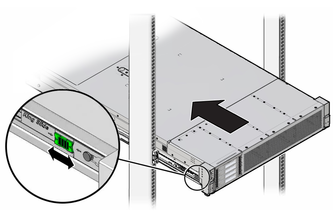

- Simultaneously push and hold the green slide-rail release buttons on each mounting
bracket while you push the server into the rack. Continue pushing the server into the
rack until the slide-rail locks (on the front of the mounting brackets) engage the
slide-rail assemblies with an audible click.
Caution:
Before you install the optional cable management arm verify that the server is securely mounted in the rack and that the slide-rail locks are engaged with the mounting brackets.
- If you extended the rack anti-tilt mechanism to stabalize the rack, retract it back to its normal position.
Parent topic: Returning Oracle Database Appliance to Operation
Return the Server to the Normal Rack Position
If the server is in the extended maintenance position, use this procedure to return the server to the normal rack position.
Push the server back into the rack, as described in the following steps.
Simultaneously pull and hold the two green release tabs (one on each side of the slide rails on the server) toward the front of the server, while you push the server into the rack.
Verify that the cable management arm (CMA) retracts without binding.
To pull the green release tab, place your finger in the center of the tab, not on the end, and apply pressure as you pull the tab toward the front of the server.
Description of the illustration aog-248_maint-position-latch-release.png -
Continue pushing the server into the rack until the slide-rail locks (on the front of the server) engage the slide-rail assemblies.
You hear an audible click when the server is in the normal rack position.
- Do one of the following:
- If you previously removed the CMA, proceed to the next section to reinstall it. See Install the Cable Management Arm (Optional).
- If you did not remove or purchase the optional cable management arm, retract the rack anti-tilt mechanism back to its normal position.

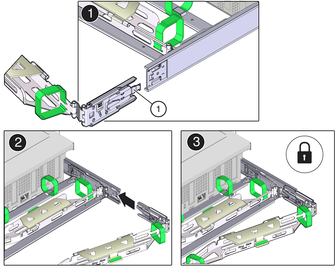

To install CMA connector C into the right slide-rail:
Align connector C with the slide-rail so that the locking spring
(callout 1) is positioned inside (server side) of the right
slide-rail [1].
Description of the illustration mm-10236_rt_slide_rear_conn.pngCall Out Description 1
Connector C locking spring
- Insert connector C into the right slide-rail until it locks into place with an audible click [2 and 3].
- Gently tug on the right side of the CMA back slide bar to verify that connector C is properly seated.
slide-rail [1].

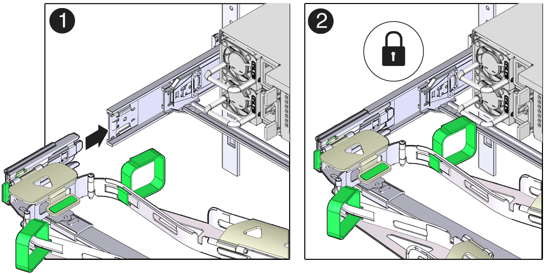

To prepare CMA connector D for installation, remove the tape that secures
the slide-rail latching bracket to connector D, and ensure that the latching
bracket is properly aligned with connector D [1 and 2].
The CMA is shipped with the slide-rail latching bracket taped to connector D. You must remove the tape before you install this connector.
To install CMA connector D into the left slide-rail:
While holding the slide-rail latching bracket in place, insert
connector D and its associated slide-rail latching bracket into the
left slide-rail until connector D locks into place with an audible
click [1 and 2].
When inserting connector D into the slide-rail, the preferred and easier method is to install connector D and the latching bracket as one assembly into the slide-rail.
Gently tug on the left side of the CMA back slide bar to verify
that connector D is properly seated.
The slide-rail latching bracket has a green release tab. Use the tab to release and remove the latching bracket so that you can remove connector D.
click [1 and 2].
- Gently tug on the four CMA connection points to ensure that the CMA connectors are fully seated before you allow the CMA to hang by its own weight.

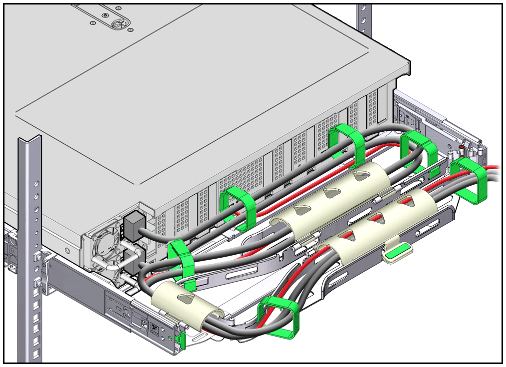

- Connect cables to the server, as required.
Open the CMA cable covers, route the server cables through the CMA cable
troughs (in the order specified in the following steps), close the cable
covers, and secure the cables with the six Velcro straps.
- First through the front-most cable trough.
- Then through the small cable trough.
Then through the back-most cable trough.
Caution:
When securing the cables with the Velcro straps located on the front slide bar, ensure that the Velcro straps do not wrap around the bottom of the slide bar. Otherwise, expansion and contraction of the slide bar might be hindered when the server is extended from the rack and returned to the rack.
Ensure that the secured cables do not extend above the top or below the
bottom of the server to which they are attached.
Otherwise, the cables might snag on other equipment installed in the rack when the server is extended from the rack or returned to the rack.
If necessary, bundle the cables with additional Velcro straps to ensure
that they stay clear of other equipment.
If you need to install additional Velcro straps, wrap the straps around the cables only, not around any of the CMA components. Otherwise, expansion and contraction of the CMA slide bars might be hindered when the server is extended from the rack and returned to the rack.
