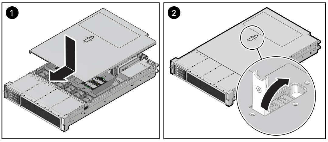

Install the Server Top Cover
Place the top cover on the chassis [1].
Set the cover down so that it hangs over the back of the server by about 1 inch (25 mm) and the side latches align with the cutouts in the chassis.
Check both sides of the chassis to ensure that the top cover is fully down and flush with the chassis.
If the cover is not fully down and flush with the chassis, slide the cover towards the back of the chassis to position the cover in the correct position.
- Gently slide the cover toward the front of the chassis until it latches into place with
an audible click [2].
As you slide the cover toward the front of the server, the release button on the top of the server automatically rotates downward to the closed position. Latch the top cover by pushing down on the button until it is flush with the cover and you hear an audible click. An audible click indicates that the cover is latched.
Use a Torx T15 screwdriver to turn the release button latch counterclockwise to the locked position.
If you are done replacing server components, remove any antistatic straps or conductors from the server chassis.

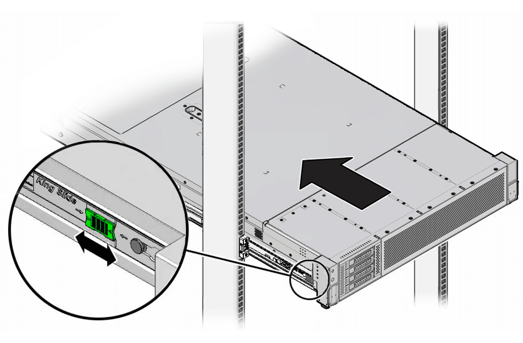

Return the Server to the Normal Rack Position
If the server is in the extended maintenance position, use this procedure to return the server to the normal rack position.
Push the server back into the rack, as described in the following steps.
Simultaneously pull and hold the two green release tabs (one on each side of the slide rails on the server) toward the front of the server, while you push the server into the rack.
Verify that the cable management arm (CMA) retracts without binding.
To pull the green release tab, place your finger in the center of the tab, not on the end, and apply pressure as you pull the tab toward the front of the server.
Continue pushing the server into the rack until the slide rail locks (on the front of the server) engage the slide rail assemblies.
You hear an audible click when the server is in the normal rack position.
