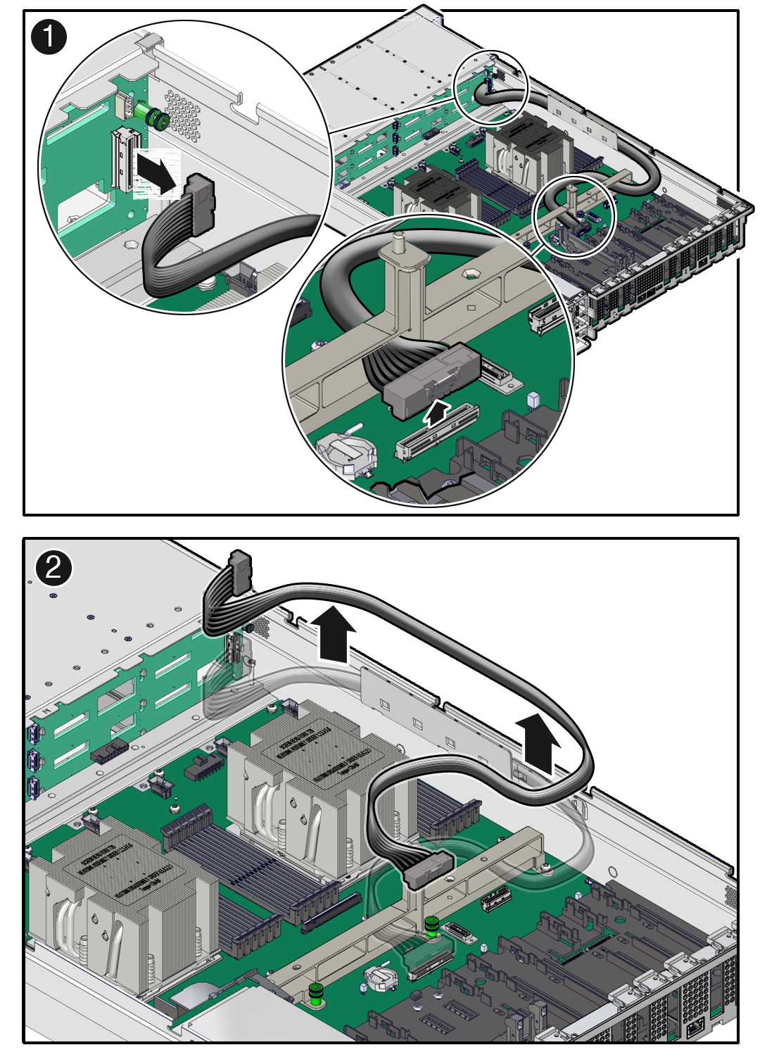

- Locate the disk backplane signal cable.
The disk backplane signal cable is connected between the 4 or 12 disk backplane and the motherboard connector, which is located between PCIe slot 4 and the motherboard handle. The signal cable is routed from the disk backplane, through the left-side cable trough, and then through the motherboard handle before connecting to the motherboard [1, 2].
- Disconnect and remove the disk backplane signal cable from the server.
- Disconnect the signal cable from the disk backplane and the motherboard [1].
At each end of the signal cable, press and hold the connector to disengage the locking mechanism, then gently lift the connector from the disk backplane and motherboard.
For information on disconnecting the disk backplane signal cable from the 4-disk backplane, see Remove the 4-Drive Backplane. - Remove the cable from the server.
Gently direct the cable through the motherboard handle and then lift the cable from the left-side cable trough [2].
Ensure that the disk backplane signal cable is free from snagging motherboard components and other cables in the server. You might need to remove the SAS cables from the left-side cable trough before removing the disk backplane signal cable. See Remove SAS Storage Drive Cables.
