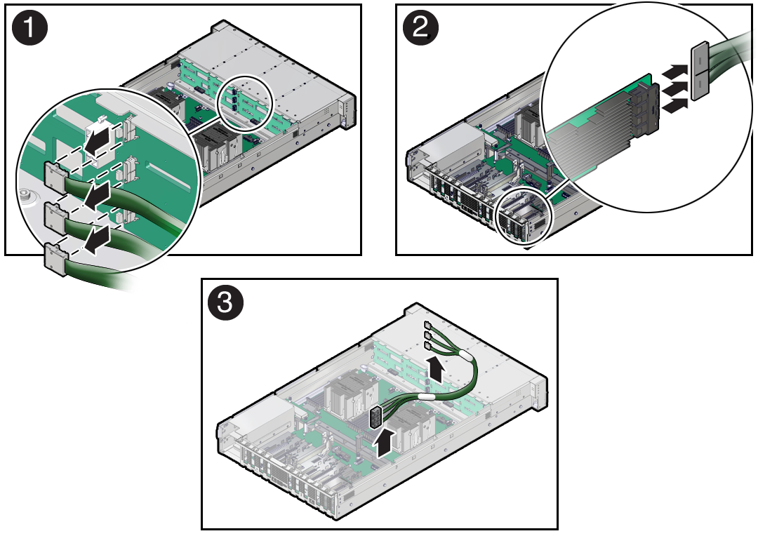

Disconnect the SAS cables from the disk backplane [1].
Press and hold the button on the connector to disengage the locking mechanism, then gently pull the connector from the disk backplane.
- Disconnect the SAS cables from the Broadcom 9500-16i, 12GB SAS PCIe, 16 Port, Internal card in PCIe slot 9 [2].
Press each latch, and then pull out to disengage the cable from each connector.
Remove the SAS cables from the server [3].
Carefully remove the SAS cable bundles from the server. Be careful not to snag the cables on the server components.
