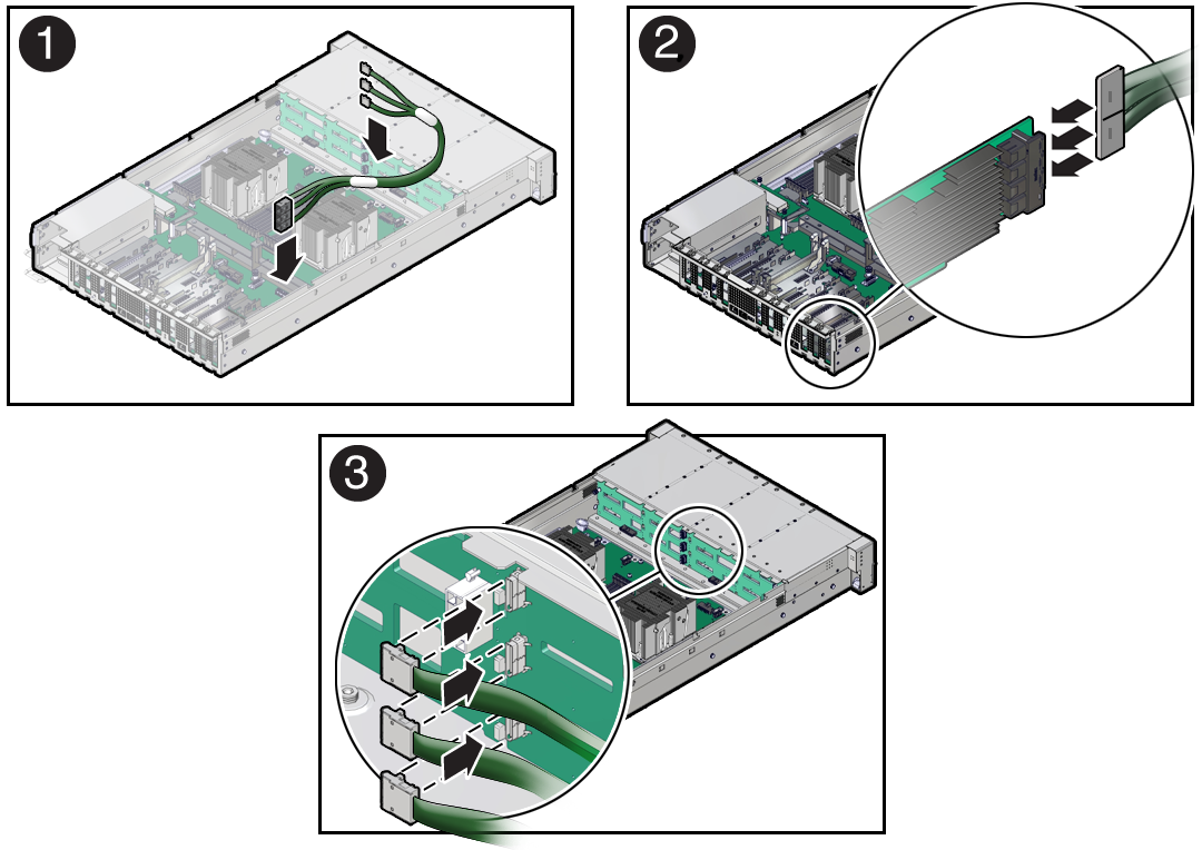

Install SAS Storage Drive Cables
Install the SAS cables between the disk backplane and the rear PCIe slots [1].
Route the SAS cable bundle through the left-side cable trough.
- Reconnect the SAS cables to the Broadcom 9500-16i, 12GB SAS PCIe, 16 Port, Internal card in PCIe slot 9 [2].
Plug each cable into its SAS connector until you hear an audible click. To ensure proper SAS cable connections, see the SAS cable connections table in Step 3.
SAS cable assembly, part number 8211223 [F] is required to connect the HBA card to the disk backplane. -
Reconnect the SAS cables to the disk backplane [3].
When attaching SAS cables, ensure that you match the numbers on the SAS cables with the SAS connectors on the disk backplane and on the HBA card. Use the following table to ensure proper SAS connections between the disk backplane and the HBA card.
HBA Card PCIe Slot Location HBA Connector Disk Backplane Connector SAS Storage Drives Broadcom 9500-16i, 12GB SAS PCIe, 16 Port, Internal
9
C0 - 1
1
0, 1, 2, 3
C0 - 2
2
4, 5, 6, 7
C1 - 3
3
8, 9, 10, 11
