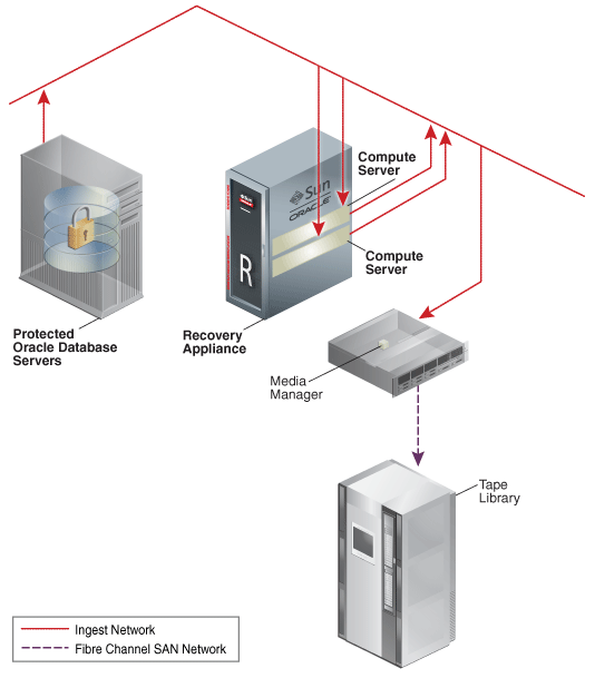

Connecting Recovery Appliance to a Tape Library
The network connections between Recovery Appliance and an optional tape library depend on whether you are using Oracle or third-party tape components. See "About Tape Backup Infrastructure" for the differences in support provided by Recovery Appliance.
Oracle Recommended Stack
When you use the Oracle recommended tape solution, a fiber channel adapter is installed in each compute server to provide a connection to the fiber channel storage area network (SAN). Tape backups are isolated on this network, and thus do not interfere with the performance of the other networks. Figure 3-4 provides an overview of the network connections when using an Oracle tape system.
Figure 3-4 Recovery Appliance Connection to an Oracle Tape System
Description of "Figure 3-4 Recovery Appliance Connection to an Oracle Tape System"
