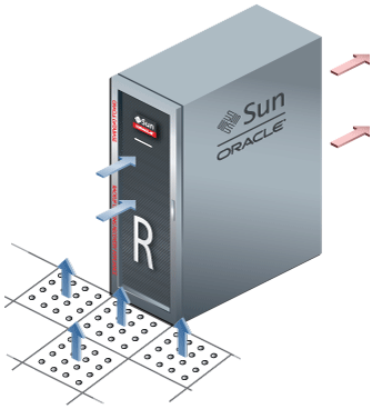

Air flow front-to-back (subject to actual data center environment)
See Also: "Temperature and Humidity Requirements", and "Ventilation and Cooling Requirements"
Maximum: 2,283 CFM
Typical: 1,598 CFM
Maximum: 674 CFM
Typical: 472 CFM
Maximum: 2,177 CFM
Typical: 1,524 CFM
Maximum: 686 CFM
Typical: 480 CFM
Maximum: 2,027 CFM
Typical: 1,419 CFM
Maximum: 633 CFM
Typical: 443 CFM
Maximum: 1,895 CFM
Typical: 1,327 CFM
Maximum: 628 CFM
Typical: 439 CFM
Maximum: 1,260 CFM
Typical: 880 CFM
Maximum: 490 CFM
Typical: 350 CFM
Always provide adequate space in front and behind the rack to allow for proper ventilation. Do not obstruct the front or rear of the rack with equipment or objects that might prevent air from flowing through the rack. Rack-mountable servers and equipment typically draw cool air in through the front of the rack and let out warm air through the rear of the rack. There is no air flow requirement for the left and right sides because of front-to-back cooling.
If the rack is not completely filled with components, then cover the empty sections with filler panels. Gaps between components can adversely affect air flow and cooling within the rack.
Relative humidity is the percentage of the total water vapor that can exist in the air without condensing, and it is inversely proportional to the air temperature. Humidity goes down when the temperature rises, and it goes up when the temperature drops. For example, air with a relative humidity of 45 percent at a temperature of 24 degrees Celsius (75 degrees Fahrenheit) has a relative humidity of 65 percent at a temperature of 18 degrees Celsius (64 degrees Fahrenheit). As the temperature drops, the relative humidity rises to more than 65 percent, and water droplets form.
Air conditioning facilities usually do not precisely monitor or control temperature and humidity throughout an entire computer room. Generally, you should monitor individual points corresponding to multiple exhaust vents in the main unit and other units in the room, because the distribution of temperature and humidity is uneven across the room. Pay special attention to humidity when using underfloor ventilation.
The Recovery Appliance racks are designed to function while mounted in a natural convection air flow. Follow these requirements to meet the environmental specification:
  • Ensure that the rack has adequate air flow
  • Ensure that the rack has front-to-back cooling. The air inlet is at the front of the servers, and the air is let out the rear.
  • Allow a minimum clearance of 152.5 cm (60 inches) at the front of the rack and 91.4 cm (36 inches) at the rear for ventilation.
Use perforated tiles, rated for 400 cubic feet per minute (CFM) per tile air flow, in front of the rack for cold air intake. The tiles can be arranged in any order in front of the rack, if cold air from the tiles can flow into the rack. Inadequate cold air flow could result in a higher inlet temperature in the servers due to exhaust air recirculation. Oracle recommends four perforated floor tiles for a full Recovery Appliance rack, and one tile for a minimum configuration.
Figure 2-5 shows a typical installation of the floor tiles for a full rack.
Figure 2-5 Typical Data Center Configuration for Perforated Floor Tiles
Description of Figure 2-5 follows
Description of "Figure 2-5 Typical Data Center Configuration for Perforated Floor Tiles"
