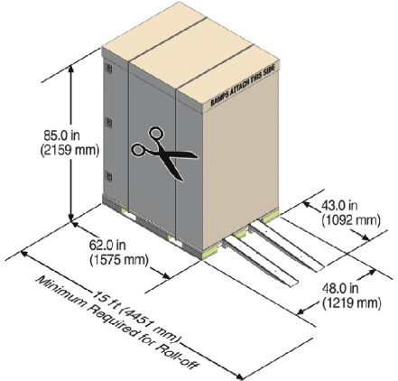

The unpacking location should be determined during the site planning process. The following image shows the ZDLRA Rack shipping crate.
Figure 6-1 ZDLRA Rack in Shipping Crate
Description of Figure 6-1 follows
Description of "Figure 6-1 ZDLRA Rack in Shipping Crate"

Removing ZDLRA Rack from the Shipping Crate
Oracle strongly recommends that you use professional movers when unpacking and installing ZDLRA Rack.
The following procedure describes how to unpack ZDLRA Rack:
  1. Unpack ZDLRA Rack carefully from the packaging and shipping pallet as follows:
    Before unpacking the rack from the shipping carton, refer to the labels on the carton and to the instructions that they provide.
    1. Remove the shipping carton bands.
    2. Remove the yellow fasteners and carton top.
    3. Remove the carton sides and inner top.
    WARNING:
    Rocking or tilting the rack can cause the rack to fall over and cause serious injury or death.
  2. Remove the shipping kit.
  3. Attach the ramps to the shipping pallet as follows:
    1. Remove the ramps from the pallet sides.
    2. Obtain the parts bag from inside the cabinet.
    3. Adjust the leveling bolts on the ramps and connect the ramps to the pallet wheel track.
    4. Verify that leveling feet are up before moving rack.
  4. Carefully roll ZDLRA Rack off the shipping pallet as follows:
    1. Unfasten the exterior shipping brackets from the pallet.
    2. Unfasten the interior shipping brackets from the pallet.
      Use care when removing the shipping brackets from underneath ZDLRA Rack. Access to the inside shipping brackets might be limited.
    3. Roll the cabinet down the ramps to the level floor. Oracle recommends having three people available to move the rack down the ramp: two people on both sides to help guide the rack and one person in back.
  5. Save the shipping brackets used to secure the rack to the shipping pallet. Do not dispose of these brackets, because you cannot order replacement brackets.
  6. Recycle the packaging properly. Follow local laws and guidelines to dispose of the material.

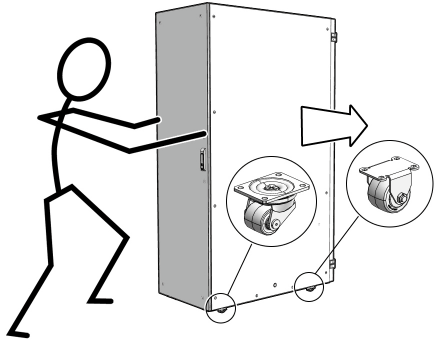

Moving ZDLRA Rack
The following procedure describes how to move ZDLRA Rack:
  1. Ensure the doors are closed and secured.
  2. Ensure the leveling and stabilizing feet on the rack are raised and out of the way.
  3. Push ZDLRA Rack from behind to the installation site.
    When moving ZDLRA Rack to the installation site, the front casters do not turn; you must steer the unit by moving the rear casters. You can safely maneuver ZDLRA Rack by carefully pushing it. Figure 6-2 shows the correct way to push the rack.
    Figure 6-2 Carefully Push ZDLRA Rack from Behind
    Description of Figure 6-2 follows
    Description of "Figure 6-2 Carefully Push ZDLRA Rack from Behind"
    Oracle recommends having two people to move the rack: one person in front and one person in back to help guide the rack. When transporting configured racks from one location to another, take care to move them slowly, 0.65 meters per second (2.13 feet per second) or slower.
    Carefully examine the transportation path. Avoid obstacles such as doorways or elevator thresholds that can cause abrupt stops or shocks. Go around obstacles by using ramps or lifts to enable smooth transport.
WARNING:
  • Never attempt to move ZDLRA Rack by pushing on the side panels. Pushing on the side panels can tip the rack over. This can cause serious personal injury or death as well as damage to the equipment.
  • Never tip or rock ZDLRA Rack because the rack can fall over.

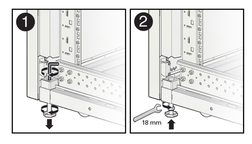

You can stabilize the rack by extending the rack leveling feet.
Stabilize ZDLRA Rack with Leveling Feet
The ZDLRA Rack contains four leveling feet that can be lowered to stabilize the rack. The leveling feet can be used even when the rack is permanently secured to the floor. The four leveling feet should share the rack load with at least one other support. The following is an acceptable method to share the rack load:
  • Casters and leveling feet
To adjust the leveling feet, do the following:

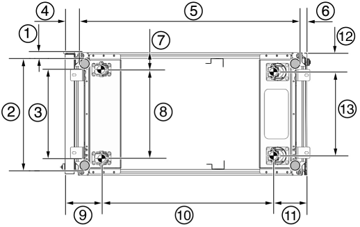

  1. Locate the four leveling feet located at the bottom corners of the ZDLRA Rack. Figure 6-3 shows the location of the leveling feet on the bottom of the rack.
    Figure 6-3 Location of Leveling Feet on ZDLRA Rack
    Description of Figure 6-3 follows
    Description of "Figure 6-3 Location of Leveling Feet on ZDLRA Rack"
    • 1: Distance from the edge of the mounting feet to the side of the rack is 33.75 mm (1.33 inches)
    • 2: Width from the outside edges of the leveling feet is 532.5 mm (20.96 inches)
    • 3: Width from the inside edges of the leveling feet is 429 mm (16.89 inches)
    • 4: Distance from the edge of the feet to the front rack surface is 73.75 m (2.90 inches)
    • 5: Depth of the outside edges of the leveling feet is 1058.5 mm (41.67 inches)
    • 6: Distance from the edge of the leveling feet to the rear rack surface is 32.5 mm (1.28 inches)
    • 7: Distance from the center of front casters to the side of the rack is 86.7 mm (3.41 inches)
    • 8: Width between the center of the front casters is 426.6 mm (16.80 inches)
    • 9: Distance from the center of the rear casters to the rear of the rack is 173.7 mm (6.83 inches)
    • 10: Depth between the front and rear casters is 828.6 mm (32.62 inches)
    • 11: Distance between the rear casters and the rear of the rack is 162.4 mm (6.39 inches)
    • 12: Distance from the center of rear casters to the side of the rack is 96.4 mm (3.80 inches)
    • 13: Width between the center of the rear casters is 407.2 mm (16.03 inches)
  2. Lower the leveling feet to the floor to share the load with the casters, as shown in Figure 6-4 using the SW 12 mm wrench.

Stabilize ZDLRA Rack X7 and Later with Leveling Feet
The rack contains four leveling feet that can be lowered to stabilize the rack.
The leveling feet can be used even when the rack is permanently secured to the floor. The four leveling feet share the load with the casters. This increases the footprint of the rack which improves stability and helps prevent rack movement.

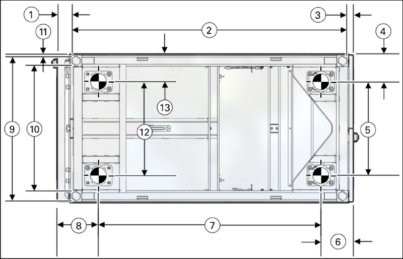

  1. Locate the four leveling feet located at the bottom corners of ZDLRA Rack. The following figure shows the location of the leveling feet on the bottom of ZDLRA Rack. The image dimensions include the doors attached to the rack.
    Figure 6-5 Location of Leveling Feet on ZDLRA Rack X7 or later
    Description of Figure 6-5 follows
    Description of "Figure 6-5 Location of Leveling Feet on ZDLRA Rack X7 or later"
    • 1: Distance from the edge of the feet to the Front door surface is 58 mm (2.3 inches)
    • 2: Depth of the outside edges of the leveling feet is 1113 mm (43.8 inches)
    • 3: Distance from the edge of the leveling feet to the rear door surface is 26 mm (1.0 inches)
    • 4: Distance from the center of rear casters to the side of the rack is 96.5 mm (3.8 inches)
    • 5: Width between the center of the rear casters is 407 mm (16.0 inches)
    • 6: Distance from the center of the rear casters to the rear door surface is 142 mm (5.6 inches)
    • 7: Depth between the front and rear casters is 889 mm (35.0 inches)
    • 8: Distance between the center of the front casters and the Front door surface is 166 mm (6.5 inches)
    • 9: Width from the outside edges of the leveling feet is 583 mm (23.0 inches)
    • 10: Width from the inside edges of the leveling feet is 513 mm (20.2 inches)
    • 11: Distance from the edge of the mounting feet to the side of the rack is 8.5 mm (0.3 inches)
    • 12: Width between the center of the front casters is 410 mm (16.1 inches)
    • 13: Distance from the center of front casters to the side of the rack is 95 mm (3.7 inches)
  2. Stabilize the rack by lowering the four leveling feet to the floor, using a 6-mm hex wrench or your fingers, as shown in the following image.

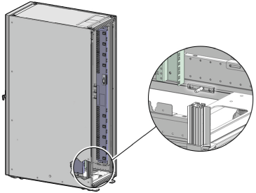

Attaching a Ground Cable (Optional)
The ZDLRA Rack power distribution units (PDUs) achieve earth ground through their power cords. Final chassis ground is achieved by way of the ground prong when you connect the power cord to a socket. For additional grounding, attach a chassis earth ground cable to ZDLRA Rack. The additional ground point enables electrical current leakage to dissipate more efficiently.
WARNING:
The PDU power input lead cords and the ground cable must reference a common earth ground. If they do not, then a difference in ground potential can be introduced. If you are unsure of your facility's PDU receptacle grounding, then do not install a ground cable until you confirm that there is a proper PDU receptacle grounding. If a difference in ground potential is apparent, then you must take corrective action.
A grounding cable is not shipped with the system.
  1. Ensure the installation site has properly grounded the power source in the data center. The facility PDU must have earth ground.
  2. Ensure all grounding points, such as raised floors and power receptacles, reference the facility ground.
  3. Ensure that direct, metal-to-metal contact is made for this installation. During manufacturing, the ground cable attachment area might have been painted or coated.
  4. Attach the ground cable to one of the attachment points located at the bottom rear of the system frame as shown in Figure 6-7. The attachment point is an adjustable bolt that is inside the rear of the ZDLRA Rack cabinet on the right side.
    Figure 6-7 Earth Ground Attachment Bolt Location
