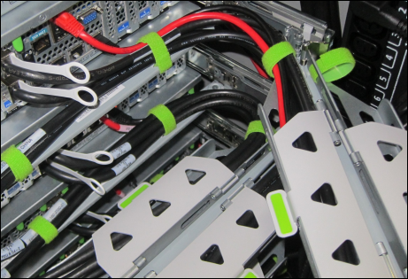

InfiniBand Cable Bundling Guidelines
When bundling InfiniBand cables in groups, use hook-and-loop straps to keep the cables organized. If possible, use color-coordinated straps to help identify the cables and their routing. The InfiniBand splitter and 4X copper conductor cables are thick and heavy for their length. Consider the retention strength of the hook-and-loop straps when supporting cables. Bundle as few cables as reasonably possible. Oracle recommends that no more than eight cables be bundled together.
If the InfiniBand cables break free of their straps and fall, then they might break internally from striking the floor or from sudden changes in tension. Place the hook-and-loop straps as close together as reasonably possible, for example, one strap every foot (0.3 m). If a cable breaks free from a strap, then the cable cannot fall far before it is supported by another strap.

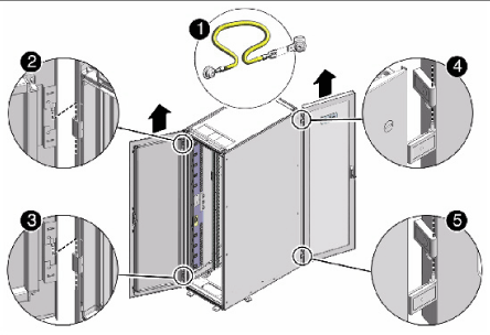

Removing the Doors
To remove the doors on the Recovery Appliance rack:
Remove the front and rear doors, as follows:
Unlock the front and rear doors. The keys are in the shipping kit.
Open the doors.
Detach the grounding straps connected to the doors by pressing down on the tabs of its quick-release connectors, and pull the straps from the frame.
Lift the doors up and off their hinges.
Description of the callouts in Figure 7-2:
1: Detaching the grounding cable
2: Top rear hinge
3: Bottom rear hinge
4: Top front hinge
5: Bottom front hinge

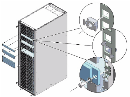

To remove the filler panels where the servers will be installed, use a No. 2 screwdriver to remove the M6 screws. The number of screws depends on the type of filler panel. Save the screws for future use.
If you are replacing the filler panels, then do not remove the Duosert cage nuts from the Radio Electronics Television Manufacturers Association (RETMA) rail holes.

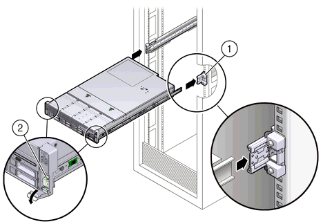

To install the server:
Read the service label on the top cover of the server before installing a server into the rack.
Push the server into the slide rail assembly:
Push the slide rails into the slide rail assemblies as far as possible.
Position the server so the rear ends of the mounting brackets are aligned with the slide rail assemblies mounted in the equipment rack.
Figure 7-6 Inserting the Server with Mounting Brackets into the Slide Rails
Description of "Figure 7-6 Inserting the Server with Mounting Brackets into the Slide Rails"Figure 7-6 callouts highlight the following:
1: Mounting bracket inserted into slide rail
2: Slide-rail release lever
Insert the mounting brackets into the slide rails, and push the server into the rack until the mounting brackets encounter the slide rail stops, approximately 30 cm (12 inches).
Simultaneously push down and hold the slide rail release levers on each mounting bracket while pushing the server into the rack.
Continue pushing until the slide rail locks on the front of the mounting brackets engage the slide rail assemblies, and you hear the click.

Attach and route the management cables on the CMA and rear panel for one server at a time. Do not slide out multiple servers.
Start from the bottom of the rack, and work upward.
Longer hook and loop straps are needed when cabling three CAT5e cables or two twinaxial cables.

Insert the cables into their ports through the hook and loop straps, then route the cables into the CMA in this order:
Power
Ethernet
InfiniBand
Route the cables through the CMA and secure them with hook and loop straps on both sides of each bend in the CMA.
Close the crossbar covers to secure the cables in the straightaway.

Push the server back into the rack:
Release the two sets of slide rail stops.
Locate the levers on the inside of each slide rail, just behind the back panel of the server. They are labeled PUSH.
Simultaneously push in both levers and slide the server into the rack, until it stops in approximately 46 cm (18 inches).
Verify that the cables and CMA retract without binding.
Locate the slide rail release buttons near the front of each mounting bracket.
Simultaneously push in both slide rail release buttons and slide the server completely into the rack, until both slide rails engage.
Dress the cables, and then tie off the cables with the straps. Oracle recommends that you dress the InfiniBand cables in bundles of eight or fewer.
Slide each server out and back fully to ensure that the cables are not binding or catching.
Repeat the procedure for all servers.

Replace the rack front and rear doors:
Retrieve the doors and place them carefully on the door hinges.
Connect the front and rear door grounding strap to the frame.
Close the doors.
(Optional) Lock the doors. The keys are in the shipping kit.
