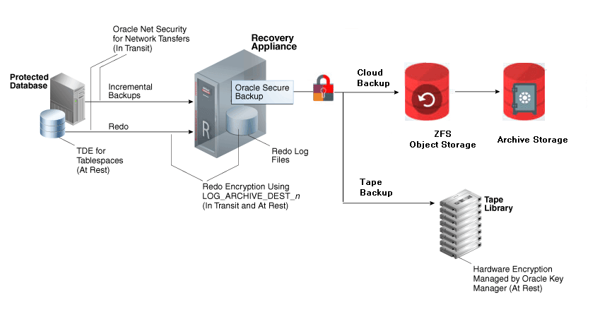

2.9 Data Encryption Techniques
Various encryption options are available for backups and redo sent to the Recovery Appliance, as shown in Figure 2-9. The Recovery Appliance does not provide server-side encryption, which means that the appliance does not itself encrypt and decrypt data.
The following types of encryption are supported:

2.9.2 Redo Encryption Using LOG_ARCHIVE_DEST_n
When enabled, the ENCRYPTION attribute of LOG_ARCHIVE_DEST_n encrypts redo both at rest on the Recovery Appliance and during the network transfer to the appliance. The basic process is as follows:
The protected database encrypts the redo in memory, using the private key contained in the Oracle Wallet on the protected database.
The protected database transfers the redo to the Recovery Appliance over the network.
If Oracle Net security is also enabled, then the redo is double encrypted during network transfer.
The Recovery Appliance writes the encrypted redo to archived redo log files, which exist in encrypted form only on the Recovery Appliance.
In a recovery scenario, RMAN restores and decrypts the encrypted redo log files on the protected database, using the encryption key stored in the Oracle wallet on the protected database host (not on the Recovery Appliance). RMAN never applies encrypted redo log files during media recovery.

2.9.3 Tape Drive-Based Hardware Encryption
The Recovery Appliance supports tape drive-based hardware encryption. In this case, the tape drive encrypts the data, not the software.
Oracle Secure Backup can encrypt backup pieces before Recovery Appliance copies them to tape. However, Oracle does not recommend software-based encryption because of its possible negative effect on performance.
