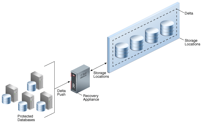

2.5.1.2 Oracle ASM and Recovery Appliance Storage
Recovery Appliance storage locations occupy space in Oracle ASM disk groups. By default, the delta pool is stored in normal redundancy Oracle ASM disk groups, which means that the Recovery Appliance maintains two copies of all on-disk backups. Database backups can survive the loss of any one disk or storage server. The Recovery Appliance metadata database, which tracks the files and blocks, is stored in a high redundancy Oracle ASM disk group.
2.5.1.3 DELTA Storage Location
By default, Recovery Appliance is configured with all available disk storage assigned to a single storage location called DELTA. As shown in Figure 2-7, all protected databases share this storage location.

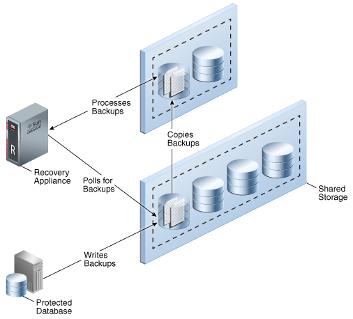

2.5.2 Backup Polling Locations
A backup polling policy defines a file system directory where a protected database places backups without interacting directly with Recovery Appliance. The backup polling directory is an NFS mount point, and is not in a Recovery Appliance storage server.
The polling policy defines the file system path to the storage and how often it will be searched for new backups. Polling policies are optional and do not need to be created if backups are not sent to Recovery Appliance using the polling method.
See Also:
2.5.2.1 Stages of Backup Polling
Backup polling occurs in the following stages:
The protected database writes backups without the involvement of Recovery Appliance, which does not need to be running while backups are created.
Recovery Appliance polls for newly arrived backups.
When Recovery Appliance discovers a file through polling, the Recovery Appliance examines its contents and tries to associate it with a protected database, and then does either of the following:
If the file is associated with a registered protected database, then Recovery Appliance processes the backup.
If the file is not associated with any registered protected database, then Recovery Appliance logs a warning message and does not process the file.
2.5.2.2 How Recovery Appliance Processes Backups in Backup Polling Directories
To set up polling so that backups are copied to Recovery Appliance storage, you must configure a backup polling directory that exists outside Recovery Appliance storage locations, but which the Recovery Appliance can access. The protected database writes its backups to the polling directory, which you specify in the polling policy.
The Recovery Appliance checks the polling directory for newly created backups. When backups exist, the Recovery Appliance copies the backups from the polling directory to its internal Recovery Appliance storage location, and then processes them. After enough time has passed for Recovery Appliance to copy the backups, the protected database deletes the backups from the polling directory. Figure 2-8 depicts this configuration.

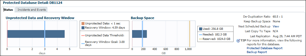

2.5.3.2 Reserved Space
Next in importance to the recovery window goal is the reserved_space parameter of DBMS_RA.ADD_DB and DBMS_RA.UPDATE_DB. The reserved space defines the amount of disk space guaranteed to each protected database to meet its recovery window goal.
This is the only storage parameter that is specified in ADD_DB rather than in the protection policy.
Because backups need space, you must estimate how much reserve space you believe is needed to store backups. For example, you might allocate 1024 GB of reserved space to the DB1124 database, which means the Recovery Appliance guarantees 1024 GB to DB1124 if the database needs this amount to meet its recovery window goal. The following graphic shows a section of a Protected Database Details report:
In the preceding example, the disk recovery window goal for DB1124 is 3 days, and the actual recovery window (the time to which the Recovery Appliance can currently recover) is 4.59 days. Meeting the recovery window goal requires 182.3 GB of backup data. This amount is less than 20% of the specified reserved space setting of 1024 GB. By default, at any given time, a database may actually have more or less than its specified reserved space available.
Reserved space is measured in space (GB), whereas the recovery window goal is measured in time.
The Recovery Appliance uses recovery window goals and reserved space settings to allocate storage dynamically to meet business requirements. If the Recovery Appliance has purged as much backup data as possible while still meeting the recovery window goal for each database, and if more space is needed, then the Recovery Appliance evaluates the reserved space setting of each database. Recovery Appliance purges backups for the database whose backups exceed the reserved space by the highest percentage, and logs a message in the RA_INCIDENT_LOG view. Query the RA_PURGING_QUEUE view to determine which database will next have a backup purged.
