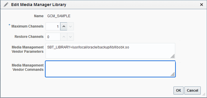

  2. On the Media Managers page, select the Media Manager library that you want to edit and click Edit.
    The Edit Media Manager Library screen appears with the existing library parameters.
    Figure 9-3 Edit Media Manager Library Screen
    Description of Figure 9-3 follows
    Description of "Figure 9-3 Edit Media Manager Library Screen"
  3. Change the number of Maximum Channels.
  4. Click OK.
