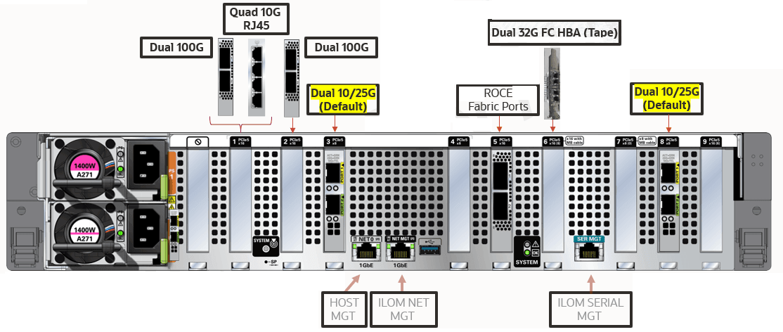

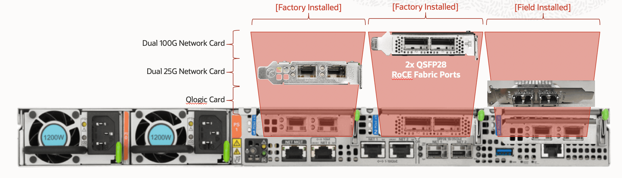

Each compute server in the RA23 configuration consists of the following network components and interfaces:
2 x Dual Port 10/25 Gb Ethernet SFP28
2 x 10/25 Gb optical (ingest)
2 x 10/25 Gb optical (replication)
2 x Dual Port 100 Gb Ethernet QSFP28
2 x 100 Gb optical (ingest)
2 x 100 Gb optical (replication)
1 x Quad Port 10 Gb Ethernet RJ45
2 x 10 Gb copper (ingest)
2 x 10 Gb copper (replication)
For ingest network, maximum of
2 x 10 Gb Ports,
2 x 25 Gb Ports, or
2 x 100 Gb Ports
For replication network, maximum of
2 x 10 Gb Ports,
2 x 25 Gb Ports, or
2 x 100 Gb Ports
Ingest and Replication can be different, for example 100Gb for ingest and 25Gb for replication.
Optional Ports
- Sun Storage Dual 32 Gb Fibre Channel PCIe Universal HBA, QLogic for tape connectivity
Standard Ports
2 x 100 Gb QSFP28 RoCE Fabric Ports
1 x 1 Gb copper Ethernet Port (mgmt)
1 x ILOM Ethernet Port
Figure 3-1: Oracle Zero Data Loss Recovery ApplianceRA23Networking

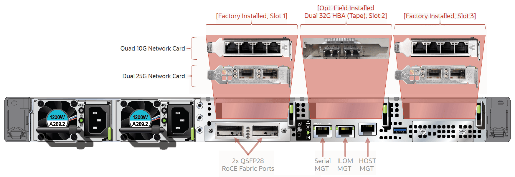

Each compute server in the X8M configuration consists of the following network components and interfaces:
Ethernet ingest and replication network connectivity, :
2 x Dual 10/25G Network Cards, or
2 x Quad 10G Network Cards, or
1 x Quad 10G Network Card and 1 x Dual 10/25G Network Card
2 x QSFP2B RoCE Fabric Ports
1 Ethernet port for
Serial MGTremote management -
1 Ethernet port for
ILOM MGT(Oracle Integrated Lights Out Manager) remote management -
1 Ethernet port for
HOST MGTremote management -
Optional: Dual 32G HBA (Tape) card that can be field installed. This slot is not available for other network cards.
Figure 3-3: Oracle Zero Data Loss Recovery Appliance X8M Backplane External Network Connectivity

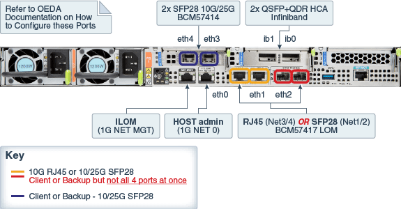

Each compute server in the X8 and X7 configuration consists of the following network components and interfaces:
On-board: 2 x 10 Gb copper Ethernet (eth1)
On-board: 2 x 10/25 Gb optical Ethernet Ports (eth2)
PCIe card: 2 x 10/25 Gb optical Ethernet Ports (eth3 and eth4)
1 dual-port 4X QDR (40 Gbps) InfiniBand Host Channel Adapter (HCA) (IB0 and IB1)
1 Ethernet port for Oracle Integrated Lights Out Manager (ILOM) remote management
1 dual-port 32 GB FC Converged Network Adapter (CNA) FC ports 0 and 1.
Note: The corresponding SFP modules that work with the 10/25 GbE PCIe 2.0 network cards are purchased separately.
Figure 3-4: Oracle Zero Data Loss Recovery Appliance X8 and X7 Backplane External Network Connectivity
Given that the base rack has two (2) compute servers, the maximum for ingest is 2 x 10 Gb or 2 x 25 Gb Ethernet ports, while the maximum for replication is 2 x 10 Gb or 2 x 25 Gb Ethernet ports. The following are valid combinations of the options.
2 x 10Gb on-board copper (ingest) + 2 x 10/25Gb PCIe card optical (replication)
2 x 10/25Gb PCIe card optical (ingest) + 2 x 10Gb on-board copper (replication)
2 x 10/25Gb PCIe card optical (ingest) + 2 x 10/25Gb on-board optical (replication)
2 x 10/25Gb on-board optical (ingest) + 2 x 10/25Gb PCIe card optical (replication)
Note: If ingest and replication traffic is desired to be configured on the same network, define the required network interface in OEDA in the ingest network section, and leave the replication network section blank. With this setup, Recovery Appliance will use the ingest network for replication traffic.

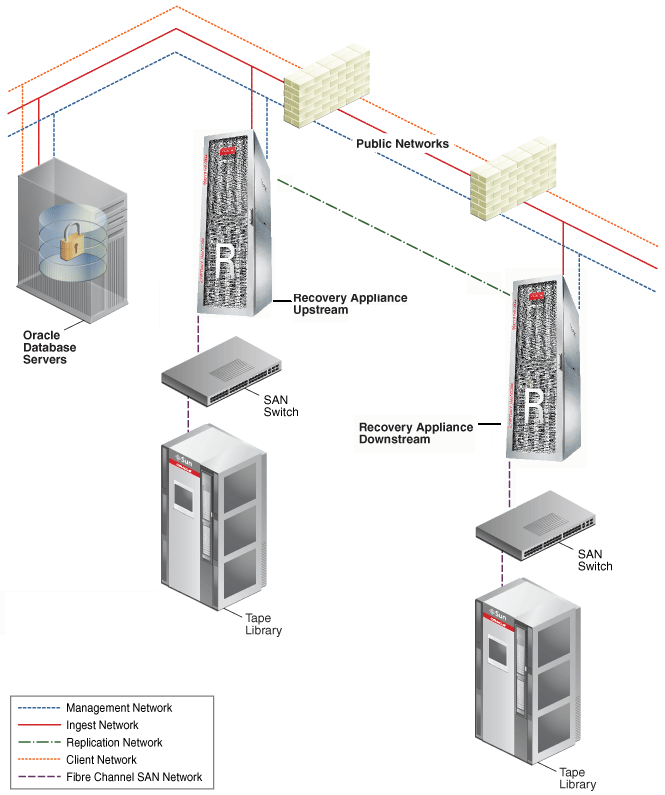

Example of Network Connections for Recovery Appliance
Figure 3-5 shows the network cabling of a sample configuration. Two Recovery Appliance racks are installed in separate data centers. The protected Oracle databases are connected to the upstream Recovery Appliance over the ingest network. The upstream Recovery Appliance is connected to the downstream Recovery Appliance over the replication network. Both racks are configured to use an Oracle tape solution.
Figure 3-5: Network Diagram for Recovery Appliance

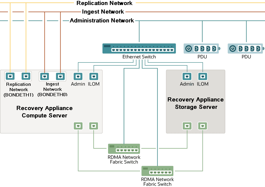

Connecting Recovery Appliance Rack Components to the Networks
Figure 3-6 shows the network connections to components of Recovery Appliance rack.
The management network connects through the Ethernet switch to the compute servers, the storage servers, and the RDMA Network Fabric switches. The management network connects directly to the PDUs.
The ingest network, the optional replication network, and the optional fiber channel SAN network connect to the two compute servers.
The RDMA Network Fabric network connects the switches to the compute servers and the storage servers.
Figure 3-6: Network Connections to the Recovery Appliance Rack Components

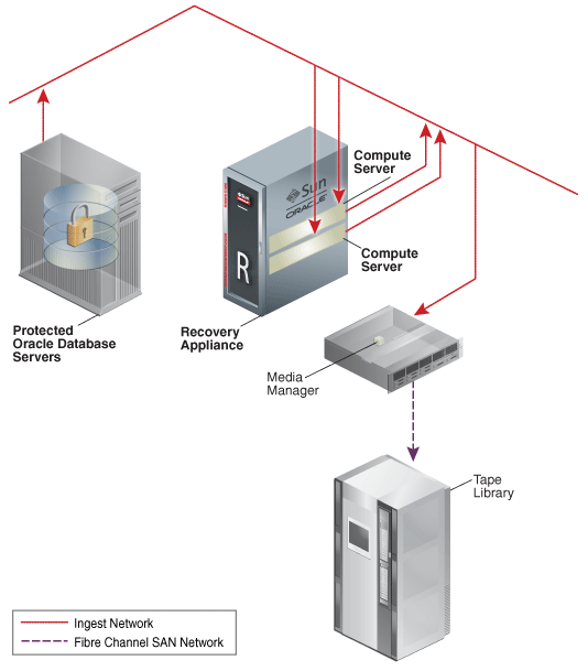

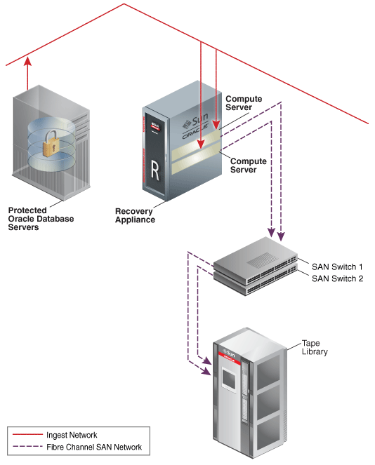

Connecting Recovery Appliance to a Tape Library
The network connections between Recovery Appliance and an optional tape library depend on whether you are using Oracle or third-party tape management system. See “About Tape Backup Infrastructure” for the differences in support provided by Recovery Appliance.
Oracle Recommended Stack
When you use the Oracle compatible tape solution, a fiber channel adapter is installed in each compute server to provide a connection to the fiber channel storage area network (SAN). Tape backups are isolated on this network, and thus do not interfere with the performance of the other networks. Figure 3-7 provides an overview of the network connections when using an Oracle tape system.
Figure 3-7: Recovery Appliance Connection to an Oracle Tape System
Third-Party Tape Systems
When you use a third-party tape system, the backups to tape use the ingest network. This is the same network that the local protected databases use to backup to Recovery Appliance. Figure 3-8 provides an overview of the network connections when using a third-party tape system.
Figure 3-8: Recovery Appliance Connection to a Third-Party Tape System
