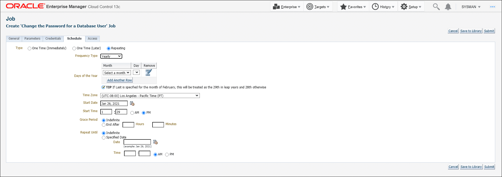

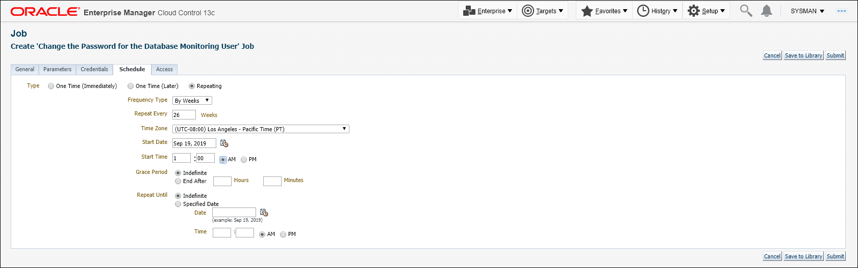

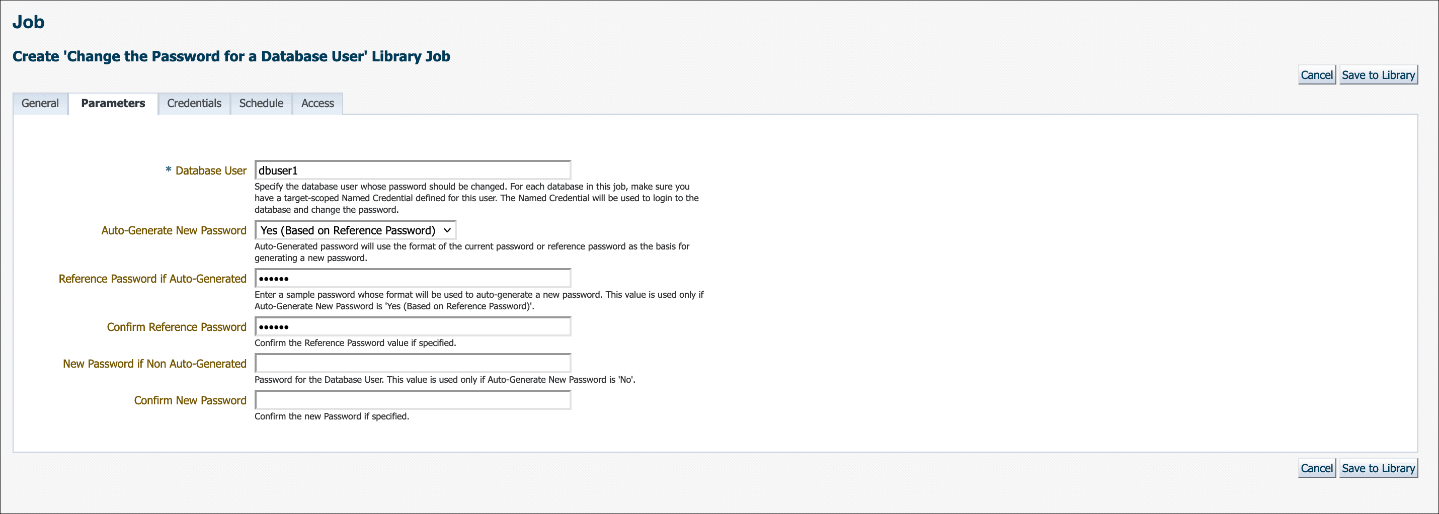

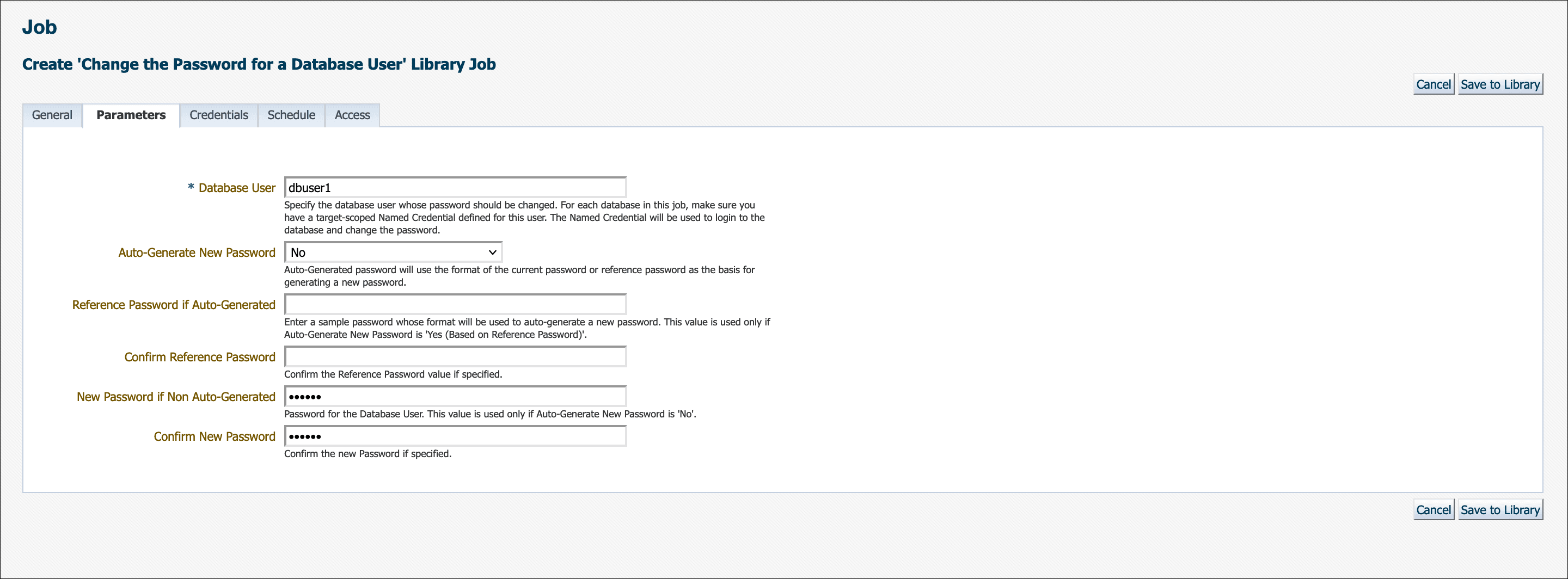

Change SYSMAN and MGMT_VIEW users' password on a regular basis using only the method documented in the Security section of the Oracle Enterprise Manager Cloud Control Administrator's Guide. The documented command (update_db_password()) helps you change the SYSMAN related passwords in the OMS and in the repository database. If you do not execute this command properly, the OMS may fail to start due to inconsistent passwords for one of the many accounts. You will be prompted for the old and new SYSMAN passwords.
When changing the MGMT_VIEW password, you can select “-auto_generate" to generate a random password that no one will know. The MGMT_VIEW password is used only by the Reporting system and should not be used for login, therefore the auto_generate flag can ensure the password is not known.
To avoid the service interruption due to the lockout of internal users, SYSMAN and MGMT_VIEW users are associated with MGMT_INTERNAL_USER_PROFILE upon install. The password parameters are all set to UNLIMITED. In addition, to avoid sessions hanging or taking a long time due to resource consumption limit, MGMT_INTERNAL_USER_PROFILE's kernel parameters are set to default, which is unlimited as well.

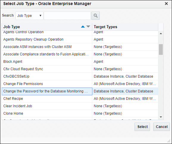

  1. From the Enterprise menu, choose Job and then Activity. On the Activity page, click Create Job. The Select Job Type dialog displays.
    DBNSMP Change password job.
    Choose the Change the Password for the Database Monitoring User job type and click Select.

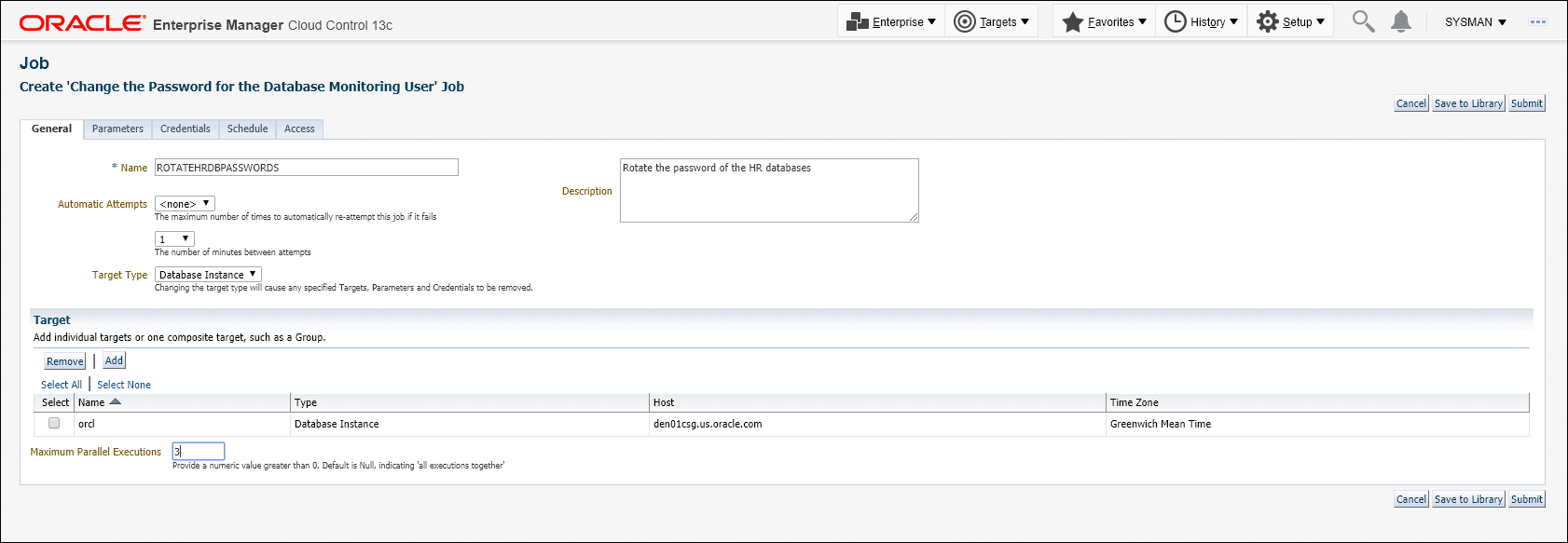

  2. Define the job by specifying the required attributes (Job Name, Description, etc.) as well as selecting list of targets on which to schedule/run the job.
    Instead of selecting a list of targets, you could also create a dynamic group and select the group. When selecting a dynamic group, all instances of type Oracle Database and Cluster Database present in the group will have the monitoring user passwords updated when the job is executed.
    If there are a large number of targets being selected, it is recommended to specify a reasonable number of Maximum Parallel Executions for your environment (around 3) so that all of these jobs are not executed in parallel. Running large numbers of jobs in parallel will not only overload the job system, but also cause your targets to be in blackout concurrently.
    Create Job General Tab

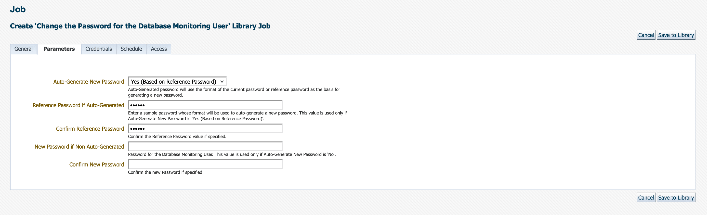

  3. Specify a New Password if you do not want Enterprise Manager to auto-generate a password as shown below.
    Create Job Parameters Page
    Auto-Generate New Password must be set to No. Enter the new password. If the new password and confirmation do not match, an inline error message will appear and you will not be able to submit the job.
    If no parameters are specified in the Parameters tab, then a new password will be generated. Auto-generated passwords are only known to and managed by Enterprise Manager.
    There are two explicit options for Auto-Generate New Password. Initially, auto-generating a new password used only the format of the current password as the basis for generating a new one. Beginning with Enterprise Manager 13c Release 5 Update 12 (13.5.0.12), there is now an additional option to auto-generate a new password based on the reference password. This means that you can enter a sample password in the provided field and Enterprise Manager will use the format of the sample as the basis for auto-generating a new password.
    When selecting Auto-Generate New Password: Yes (Based on Reference Password) you must ensure your sample/reference password is compliant with your current enterprise's password policies for Enterprise Manager to auto-generate a new compliant password. This option is useful for when your password policy changes (e.g., minimum password length increases) and the current password is no longer compliant and thus needs to be changed.

  4. Define a schedule for this job. This would typically be the interval after which the monitoring user password needs to be changed as per the password profile defined for the database.
    Set Job Schedule
    Click Submit.

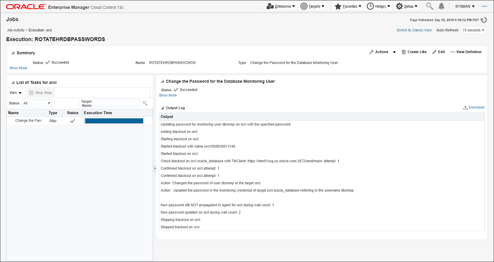

Viewing the job run output (executions per target)
You can view the status/output of the password change job by clicking on the job name in the Job Activity table as shown below.
Job Run Output

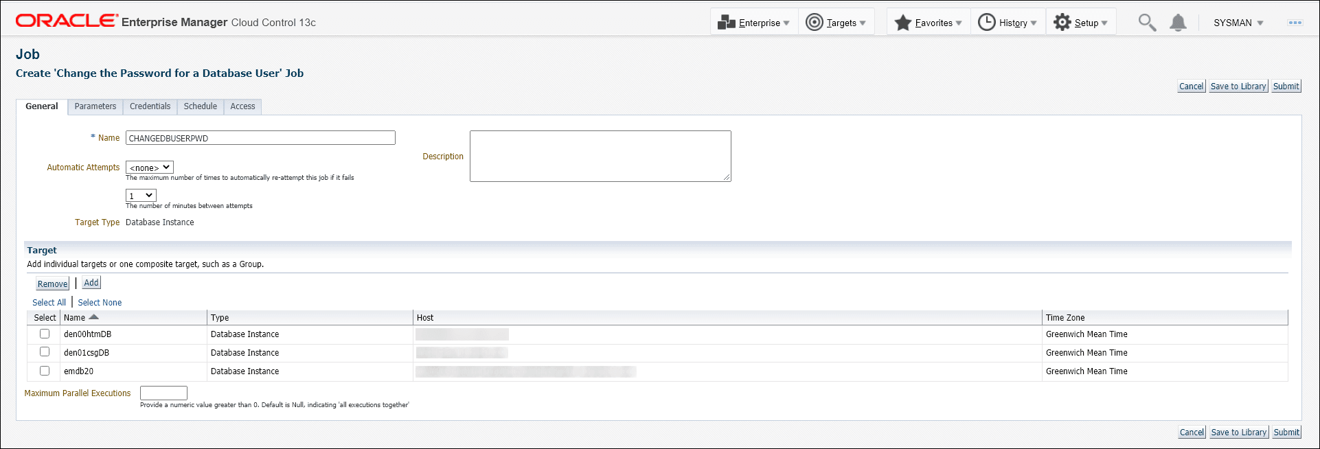

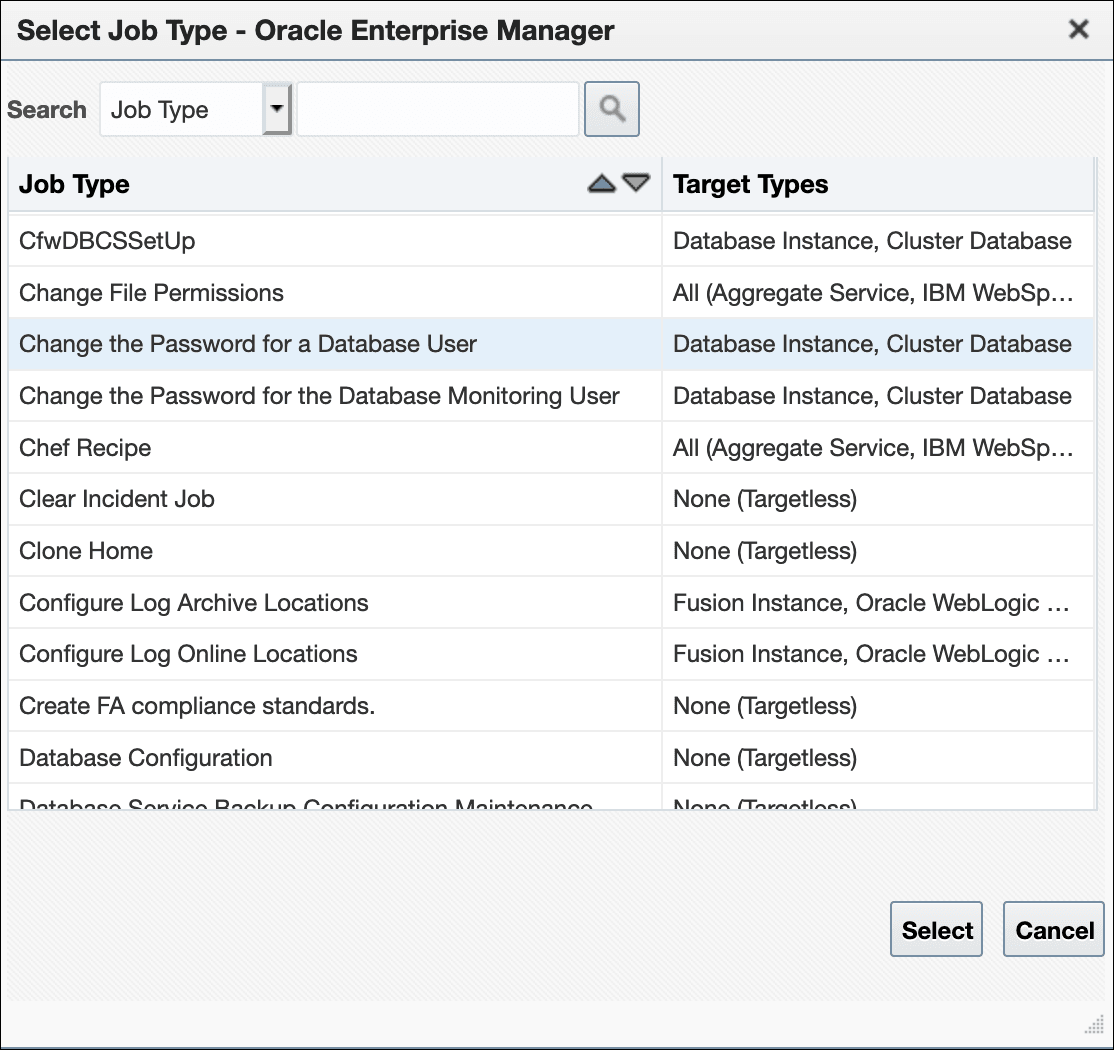

    Graphic shows the Job type selection dialog fo non-dbsnmp users.r
  2. Choose the Change the password of the Database User job type and click Select.
  3. Define the job by specifying the required attributes (Job Name, Description, etc.) as well as selecting list of targets on which to schedule/run the job.
    Instead of selecting a list of targets, you could also create a dynamic group and select the group. When selecting a dynamic group, all instances of type Oracle Database and Cluster Database present in the group will have the database user passwords updated when the job is executed.
    If there are a large number of targets being selected, it is recommended to specify a number reasonable for your environment (around 3) so that all of these jobs are not executed in parallel. Running large numbers of jobs in parallel will not only overload the job system.
    Graphic shows the Create Job page.
  4. Define the job type Parameters. In this case the Database User is the user whose password needs to be changed/rotated. The job will check for the existence of ONE and only ONE Named Credential defined on each of the database instances defined for the job. The job will generate an error if there are no Named Credentials or more than one Named Credentials defined for this user on a DB target that is specified for the job. An error will also occur if this user is the default Monitoring user for the DB target.
  5. Specify a New Password if you do not want Enterprise Manager to auto-generate a password as shown below.
    Graphic shows the Parameters page.
    There are two explicit options for Auto-Generate New Password. Initially, auto-generating a new password used only the format of the current password as the basis for generating a new one. Beginning in Enterprise Manager 13c Release 5 Update 12 (13.5.0.12), there is now an additional option to auto-generate a new password based on the reference password. This means that you can enter a sample password in the provided field and Enterprise Manager will use the format of the sample as the basis for auto-generating a new password.
    Image shows the DB user reference password.
  6. Define a schedule for this job. This would typically be the interval after which the monitoring user password needs to be changed as per the password profile defined for the database.
    Graphic shows the Job schedule page for the non-dbsnmp user.
    Click Submit.
