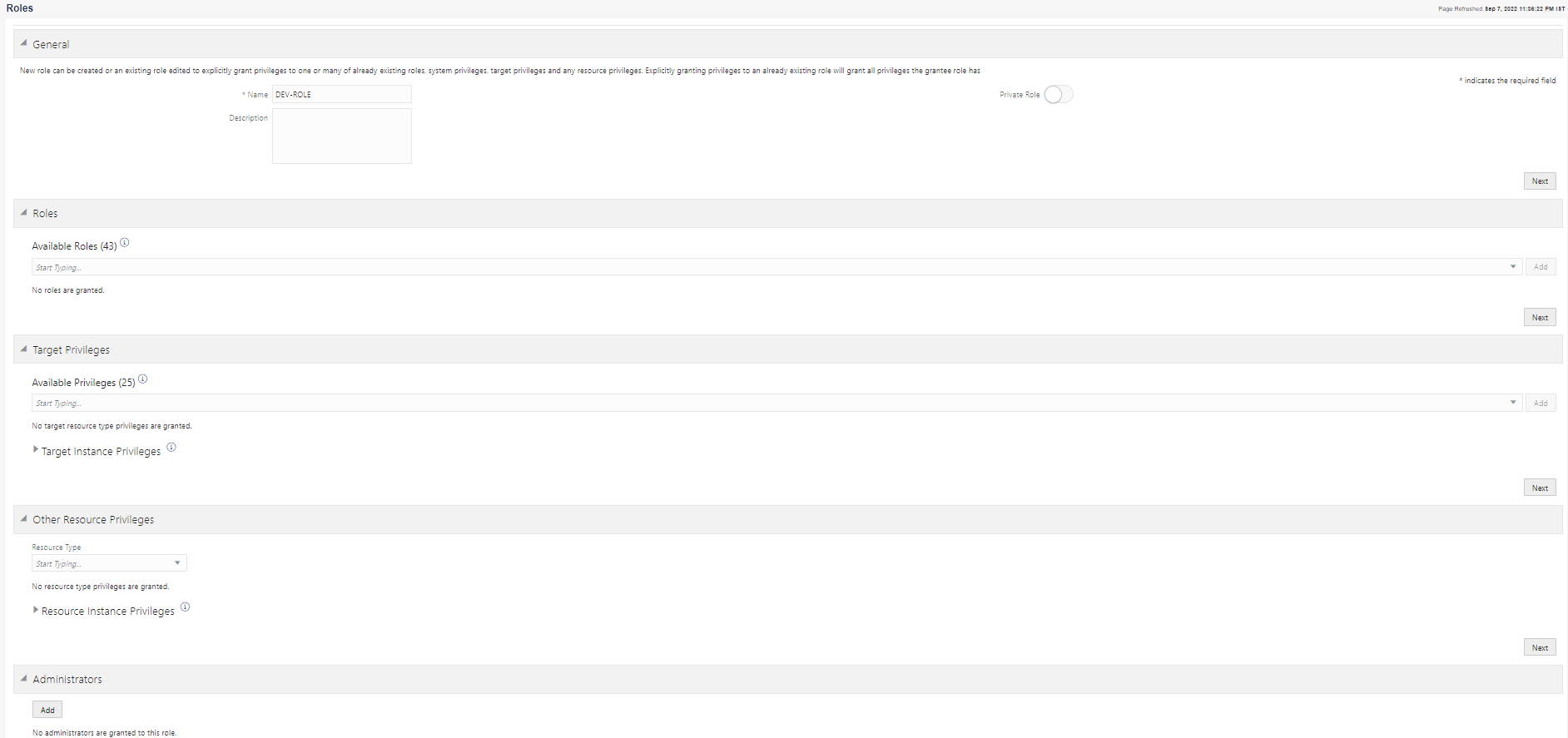

Understanding Users, Privileges, and Roles
When an Enterprise Manager administrator adds a user to the system, the primary consideration must be what does this person need to do in order to perform his job? Once the job for this new user is defined and understood, appropriate privileges must be assigned to this user and access granted to the required systems required to complete the job.
Privileges are ultimately granted to administrators to enable them to manage targets in Enterprise Manager. While you can grant specific privileges to individual administrators, tracking and granting privileges on many targets across many administrators easily becomes error-prone and an administrative burden in itself. Our recommendation is to define and use roles to manage the granting of privileges to administrators.
A role is a user-defined set of privileges typically containing the set of privileges that you want to grant to a team of users. A role can contain other roles as well. For example, you can create a First Line Support role containing the privileges needed for the administrators to view and manage incidents on targets. Once this role is created, you can grant this role to the appropriate administrators who will manage these incidents as part of their job responsibility. If you need to change the set of privileges for your administrators, e.g. add new privileges or remove privileges, then all you need to do is update the role. The updated set of privileges in the role is automatically enabled for the administrators to whom the role has been granted. Likewise if new administrators are added, all you need to do is grant them the appropriate role(s) instead of granting them individual privileges. See "Classes of Users" for more information.
Using roles is one big step towards managing privileges. However, there is still the challenge of having to keep the role updated with privileges on new targets as they are added to Enterprise Manager.
Classes of Users
Oracle Enterprise Manager supports different classes of Oracle users, depending upon the environment you are managing and the context in which you are using Oracle Enterprise Manager.
The Enterprise Manager administrators you create and manage in the Enterprise Manager console are granted privileges and roles to log in to the Enterprise Manager console and to manage specific target types and to perform specific management tasks. The default super administrator for the Enterprise Manager console is the SYSMAN user, which is a database user associated with the Oracle Management Repository. You define the password for the SYSMAN account during the Enterprise Manager installation procedure.
By restricting access to privileged users and providing tools to secure communications between Oracle Enterprise Manager 13c components, Enterprise Manager protects critical information in the Oracle Management Repository.
The Management Repository contains management data that Enterprise Manager uses to help you monitor the performance and availability of your entire enterprise. This data provides you with information about the types of hardware and software you have deployed, as well as the historical performance and specific characteristics of the applications, databases, applications servers, and other targets that you manage. The Management Repository also contains information about the Enterprise Manager administrators who have the privileges to access the management data.
You can create and manage multiple Enterprise Manager administrator accounts, or EM users, using the EM interface. Each administrator account includes its own login credentials, as well as a set of roles and privileges that are assigned to the account. There are three classes of users:
  • Super Administrator: A powerful EM user with special access privileges to targets and other user accounts within the Enterprise Manager environment. The Super Administrator SYSMAN is created by default when Enterprise Manager is installed. A Super Administrator can:

  7. Next, create a view only Role for the Target DevGroup. A Role is a privilege that is granted to an Administrator. Proceed to the Roles page, go to the Setup->Security->Roles page.
  8. Click "Create" button.
  9. On the General page, type the name of the new Role, DEV-ROLE, click the "Next" button.
    Create role page
  10. Click "Next" on the "Roles" page.
  11. On the "Target Privileges" page, scroll down to the "Target Privileges" section, at the bottom of the page. Click the "Add" button. The available targets are displayed. Select the "Group" Target Type, to improve the search. Select the group we just created, DevGroup. Click the "Select" button.
  12. The target group is displayed. For this role, DEV-ROLE, we want to grant "Connect Target Read-Only" on all databases in the DevGroup. This is done by selecting the pencil icon, to the right of "View" in the "Manage Target Privilege Grants" column.
  13. Click the privilege "Connect Target Read-Only", scroll to the bottom of the page. Select the "Continue" button.
  14. The new privilege is displayed. Select the "Next" button
  15. Select the "Next" button on the Resource Privilege page.
  16. Select the Administrators you want to grant this role, DEV-ROLE too. Select the "Next" button.
  17. Review the setting of your new role DEV-ROLE.

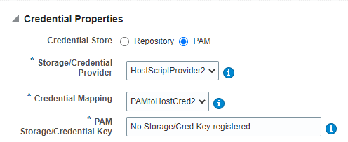

  • Pluggable Authentication Modules (PAM) Support

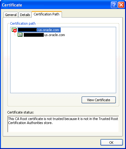

  4. At the top of the browser, click Certificate Error to display the Certificate pop-up.
  5. Click View Certificates. The Certificates dialog appears.
  6. Click the Certificate Path tab and select the first entry in the list of certificates as shown in the following graphic.
    Graphic shows the certificate dialog.

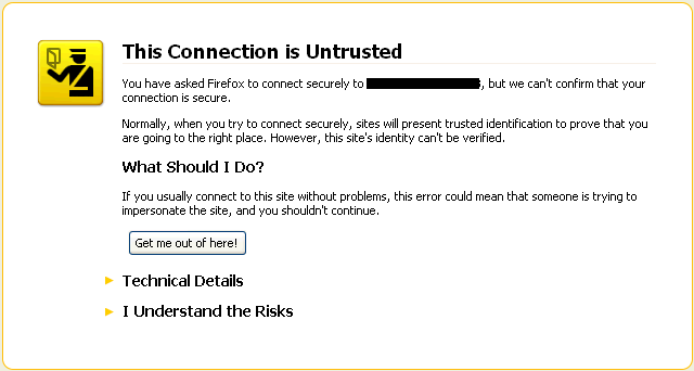

Responding to the Mozilla Firefox New Site Certificate Dialog Box
Firefox will also issue a connection warning when Enterprise Manager's certificate is issued by a Certificate Authority which the browser does not trust. When you first attempt to display the Cloud Control console using the HTTPS URL in Mozilla Firefox, you will receive a warning because the connection is untrusted.
graphic shows the connection untrusted message.
When Firefox displays the Untrusted Connection page, use the following instructions to install the certificate and avoid viewing this page again in future Enterprise Manager sessions:

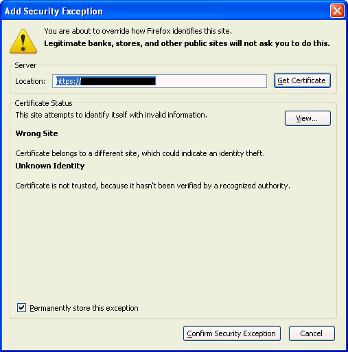

  1. Review the instructions and information. Click I Understand the Risks. Firefox displays additional information and the opportunity to add the certificate.
  2. Click Add Exception... . Firefox displays the Add Security Exception dialog.
    graphic shows the add security excpetion dialog.
  3. Ensure that the Permanently store this exception option is selected.
    You should no longer receive the New Site Certificate dialog box when using the current browser.
  4. Click Confirm Security Exception. The Enterprise Manager console displays.

Step 2: Register the PAM Provider with EM
As an EM Administrator, register the PAM provider with EM using the EM CLI command emcli config_cred_provider.
This is a new verb that allows the credential provider to be configured with the required attributes.
[-provider_name=\"provider name\"]
[-provider_type=\"provider type\"]
[-access_cred_type=\"cred type\"]
-params="params"
[-refparams="params"]
[-input_file="FILE:file_path"]
[-separator="separator:attribute_name:character"]
[-subseparator="subseparator:attribute_name:character"]
Options:
  • -provider_name: Name of the provider to configure and should contain only alphabets, numbers, hyphen(-) and underscore(_) and not exceed 64 characters.
  • -access_cred_type: The type of credential that is required to authenticate against this credential provider.
    Example: In case of using PAM user credentials to authenticate with PAM system then create named credentials of type "Host Credentials using the PAM user and password and provide -access_cred_type="HostCreds" and then map the named credential to PAM provider created using set_credprovider_cred.
  • -params : Comma separated set of name=value pairs. It can be used in conjunction with - input_file to specify tags to file paths that contain longer content.
    Example:
    -params="Command:sh %ScriptFile% -key %CredKey%;StdInVars:CACertLoc,AuthToken;ScriptFileExt:sh;Script:getCyberArkPassword"
    • Example commands that need to be run to fetch credential from PAM depending on the script type being used:
      • sh %ScriptFile% -key %CredKey%
      • perl %ScriptFile% -k %CredKey%
      ScriptFile and CredKey are mandatory keywords, while %ScriptFile% will be replaced by the script file name (in OMS file system), and %CredKey% will be replaced by the credential key provided while creating the named credential.
    • StdInVars: list of input parameters separated by comma that needs to be passed thru standard input
      Example:
      StdInVars:AuthToken;
    • ScriptFileExt: supported script file extensions:
      • sh
      • pl
    • Script: tag pointing to the actual script file path which will be defined in the parameter input_file.
  • -input_file: to specify tag pointing to actual file path.
    Example:
    -input_file="getCyberArkPassword:/u01/app/pam_scripts/getcreds.sh"
  • -refparams: Comma separated set of name=value pairs. Can be used to map input parameters to integration script to any of three below mentioned OMS properties:
    • "oracle.sysman.core.security.auth.cred_provider_prop1"
    • "oracle.sysman.core.security.auth.cred_provider_prop2"
    • "oracle.sysman.core.security.auth.cred_provider_prop3"
Example:
sh getcreds.sh -k CredKey
pamuser:user
pampassword:password
authtoken:token
./emcli config_cred_provider-provider_name="CyberArk"
-provider_type=ScriptProvider \
-params="Command:sh %ScriptFile% -k %CredKey%;StdInVars:CACertLoc,AuthToken;ScriptFileExt:sh;Script:getCyberArkPassword"\
-input_file="getCyberArkPassToken:/u01/app/pam_scripts/getcreds.sh"\
-refparams="AuthToken:oracle.sysman.core.security.auth.cred_provider_prop1,CACertLoc:oracle.sysman.core.security.auth.cred_provider_prop2"
Once the script is registered in EM, it is stored in the repository table EM_NC_CREDPROVIDER_PARAMS and you can run a select query to see the data. Here is an example of a query:
SELECT * FROM EM_NC_CREDPROVIDER_PARAMS;
If you would like to re-create the PAM provider registration with EM, you can use the emcli delete_cred_provider command and then execute the emcli config_cred_provider command to re-create it.

Step 4: Create or Modify the Named Credentials
Next, as an EM Administrator, create the credentials:
  1. Use an EM CLI verb to create the new credentials in EM with an alternate credential storage type. The following example creates the named credential ssh1 based on the SSH key named credentials for host myhost.example.com. It indicates that the credential attributes are stored in the OracleKeyVault credential provider at the location emssh1 and that the mapping named OKVSSHCreds can map the attributes required for the HostSSHCreds credential type.
    emcli create_named_credential
    -cred_name=ssh1
    -auth_target_type=host
    -cred_type=HostSSHCreds
    -target_name="myhost.example.com"
    -target_type=host
    -cred_scope=instance
    -alt_cred_storage
    -cred_provider=<PAM Provider>
    -cred_key=emssh1
    -cred_mapping=OKVSSHCreds
  2. Modify the Named Credentials as needed. Similar to create_named_cred, the modify_named_credential verb also takes the additional parameters : alt_cred_storage, cred_provider, cred_key, cred_mapping
    The following example modifies the named credential ssh1 based on the SSH key named credentials for host myhost.example.com. It indicates that the credential attributes are stored in the OracleKeyVault credential provider at the location emssh1 and that the mapping named OKVSSHCreds can map the attributes required for the HostSSHCreds credential type.
    emcli modify_named_credential
    -cred_name=<credential name>
    -target_type=host
    -cred_scope=instance-alt_cred_storage
    -cred_provider=OracleKeyVault-cred_key=emssh1
