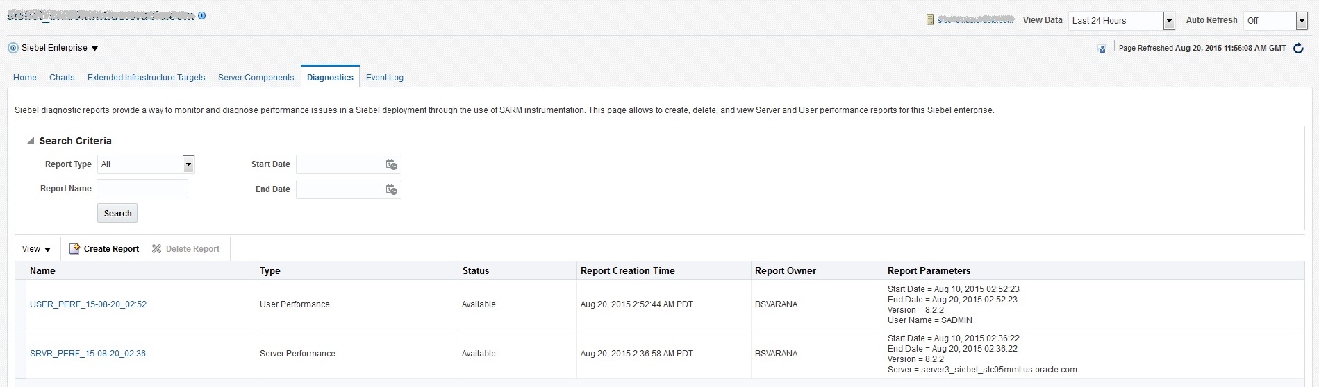

  1. From the Targets menu, select Siebel.
  2. From the Siebel Enterprise Home page, click the Diagnostics tab.
    Figure 6-1 displays the Diagnostics Reports Page.
    Figure 6-1 Diagnostics Reports Page
  3. Click Create Report.

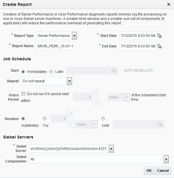

    Clicking on Create Report opens the Create Report Wizard. Figure 6-2 displays the Create Report wizard, which enables you to create a Server Performance or User Performance report.
  4. Select the report type, Server Performance Report or User Performance Report, specify values for the fields, and click OK.
    There is also the option of scheduling reports for a later time or later date.

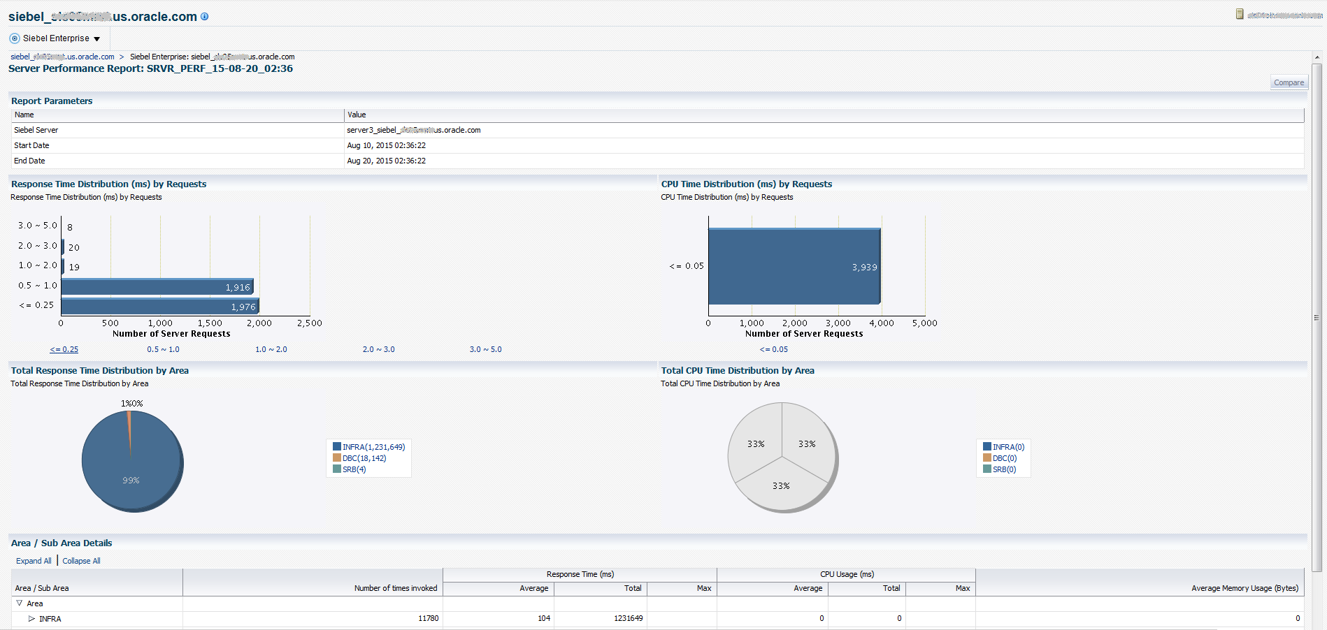

Server Performance Report <Report Name> Page
To view this page (shown in Figure 6-3), from the Diagnostics Reports page, click the name of the Server Performance report you want to view.
Figure 6-3 Server Performance Report - Example 1
This page contains the following information:
  • Report Parameters — Displays report parameters for the server and the value for each.
  • SARM Response Time — Displays the response time to process requests measured through the Siebel Application Response Measurement (SARM) facility. SARM is a mechanism for capturing performance data of Siebel Applications at key locations within the Siebel Server infrastructure. See the System Monitoring and Diagnostic Guide included in the Siebel documentation for details.
    This chart helps you understand the response time to process requests by the Siebel server. The information is displayed in a histogram. Basically, the chart displays buckets in a time range and displays the requests processed for each bucket. You can click the bucket to drill down and view more details from the Server Performance <Report Name> <Bucket> page.
    When you click one of the two most expensive buckets (that is, the buckets with the most expensive requests in terms of Response Time or CPU Time consumption), the page is displayed instantly as the data is pre-fetched. When you click other buckets, the same page is displayed, but only after the job to retrieve SARM data from the log files is completed.
  • CPU Time — Displays the CPU time consumed by requests measured through the SARM network. This helps you understand the CPU time consumed to process requests by the Siebel server. The information is displayed in a histogram. The chart displays buckets in a time range and displays the requests processed for each bucket. You can click the bucket to drill down and view more details from the Server Performance - <Report Name> <Bucket> page.
  • Area / Sub Area Distribution — Displays performance details for areas or sub-areas of the Siebel server. SARM functions based on points or areas where performance information is generated; for example, the start and end of each database operation. Area specifies the broad area or software layer where a request is processed. For example:
    • DBC (Database Connector): This database layer tracks the percentage of time for requests in database processing.
    • INFRA (Infrastructure Area): This infrastructure area handles all functions related to networking, memory management, and so on.
    • SWE (Siebel Web Engine): This area is active when actual Web pages are built; for example, during assembly of HTML output.
    • OBJMGR (Object Manager): This layer handles object relational mapping, and is where most of the actual application code is executed.
    • SARM: This is the performance diagnostics area.
    Also, each of these areas has certain sub-areas; for example, DBC_EXECUTE, DBC_FETCH, and others in the DBC area that permit tracking of performance data at a higher level of granularity.

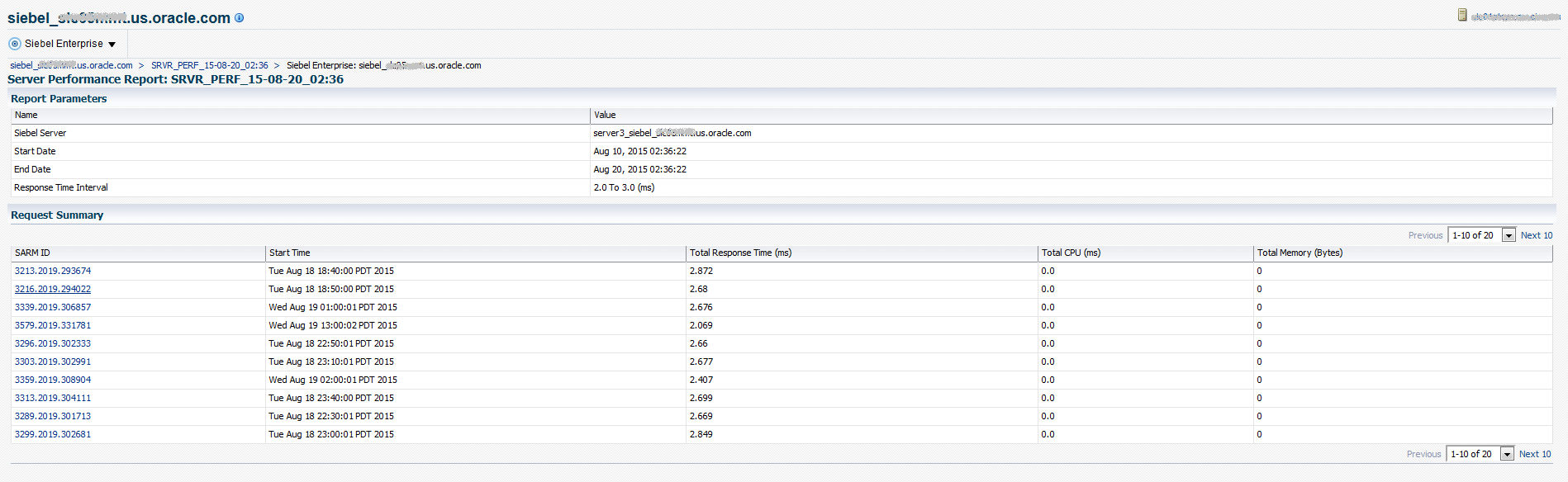

Server Performance Report <Report Name> <Bucket> Page
To view this page (shown in Figure 6-4), from the Server Performance Report <Report Name> Page, click a bucket in the SARM Response Time or CPU Time page.
Figure 6-4 Server Performance Report - Example 2
  • Report Parameters — Displays the report parameters for the server and the value for each.
  • Request Summary — Displays the summary of requests the Siebel server processes as measured by the Siebel Application Response Measurement (SARM) network. Click SARM ID in this page to drill down and view details of the percentage of resource consumed in each of the layers involved in processing a request. Enterprise Manager displays the Server Performance Report <Report Name> <Request ID > page.

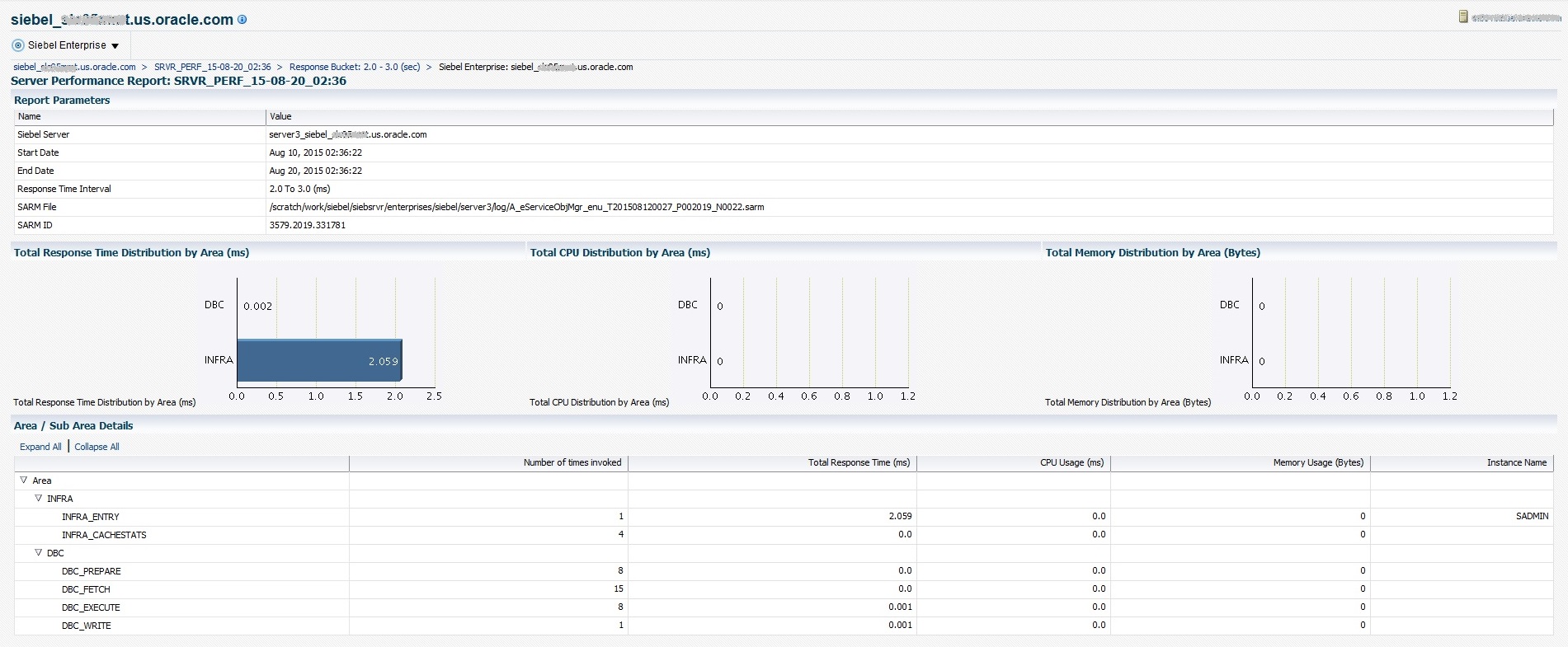

Server Performance Report <Report Name> <Request ID> Page
To view this page (shown in Figure 6-5), click SARM ID in the Request Summary section of the Server Performance Report <Report Name> <Bucket> page. You can use this page to view details about SARM requests serviced by the server.
Figure 6-5 Server Performance Report - Example 3
The details displayed in this page are:
  • Total Response Time Distribution by Area — Displays the response time by area measured by the SARM framework. This helps you understand the response time taken by each area of the Siebel server to process requests.
  • Total Memory Distribution by Area — Displays the memory distribution by area measured by the SARM framework. This helps you understand the memory distribution among various areas of the Siebel server while processing requests.
  • Total CPU Distribution by Area — Displays the CPU distribution by area measured by the SARM framework. You can analyze the CPU time taken by each area of the Siebel server.
  • Area / Sub Area Distribution Section — Displays performance details for areas or sub-areas of the Siebel server. SARM functions based on points or areas where performance information is generated; for example, the start and end of each database operation. Area specifies the broad area or software layer where a request is processed.

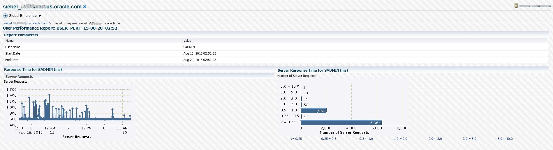

Viewing User Performance Reports
User Performance reports enable you to analyze the performance for sessions of a specific user, providing details on the response time and allowing drill-downs into individual user requests. The following sections describe how to use the User Performance reports to monitor, analyze, and diagnose user data.
User Performance Report <Report Name> Page
To view this page (shown in Figure 6-6), from the Diagnostics Reports page, click the name of the User Performance report you want to view.
Figure 6-6 User Performance Report - Example 1
  • Reports Parameters — Displays report parameters for the user and the value for each.
  • Response Time for 'User' — Displays the response time to process the user's requests measured through the Siebel Application Response Measurement (SARM) network. This helps you understand the response time to process requests by the user. It provides a trend and overview of the response time for the selected user and the specified time; that is, the chart displays requests from oldest to the most recent from right to left.
  • Histograms of Server Response Time for 'User' — Displays the server response time to process the user's requests. This chart helps you understand the response time to process user requests by the Siebel server. The information is displayed in a histogram. Basically, the chart displays buckets in a time range and displays the requests processed for each bucket. You can click the bucket to drill down and view more details from the User Performance <Report Name> <Bucket> page.

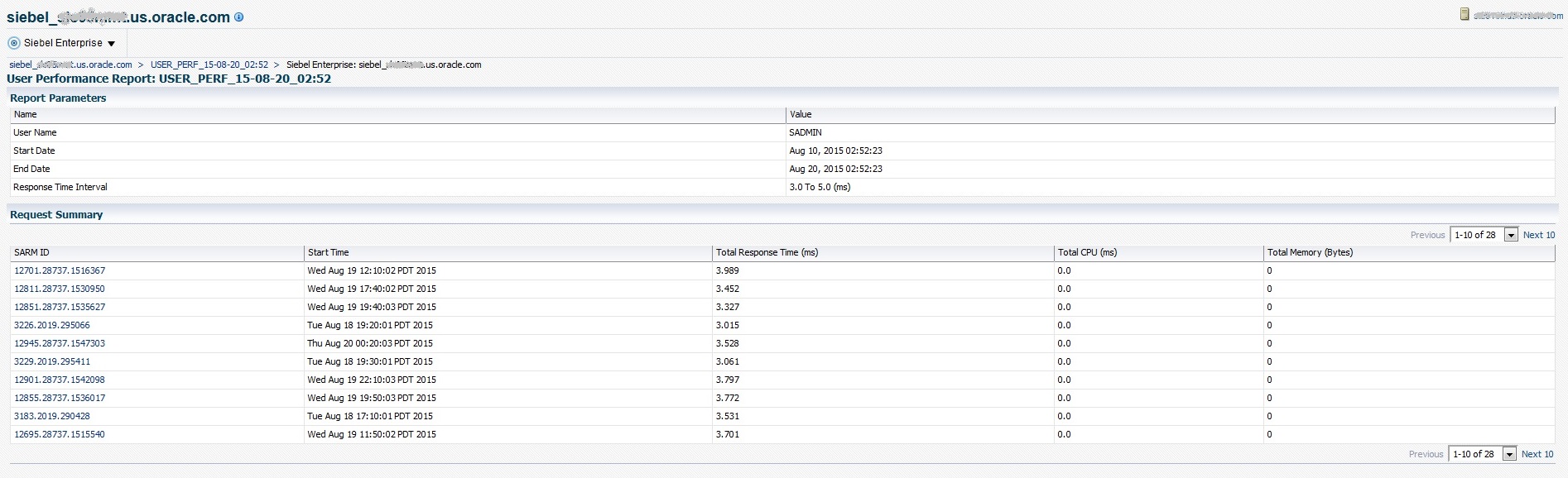

User Performance Report <Report Name> <Bucket> Page
To view this page (shown in Figure 6-7), from the User Performance Report <Report Name> Page, click a bucket in the Histograms of Server Response Time for 'User' chart in the User Performance Report <Report Name> page.
Figure 6-7 User Performance Report - Example 2
  • Report Parameters — Displays the report parameters for the user and the value for each.
  • Request Summary — Displays the summary of user requests as measured by the Siebel Application Response Measurement (SARM) network. Click the SARM ID to drill down and view details of the percentage of resource consumed in each of the layers involved in processing a request. Enterprise Manager displays the User Performance Report <Report Name> <Request ID > page.

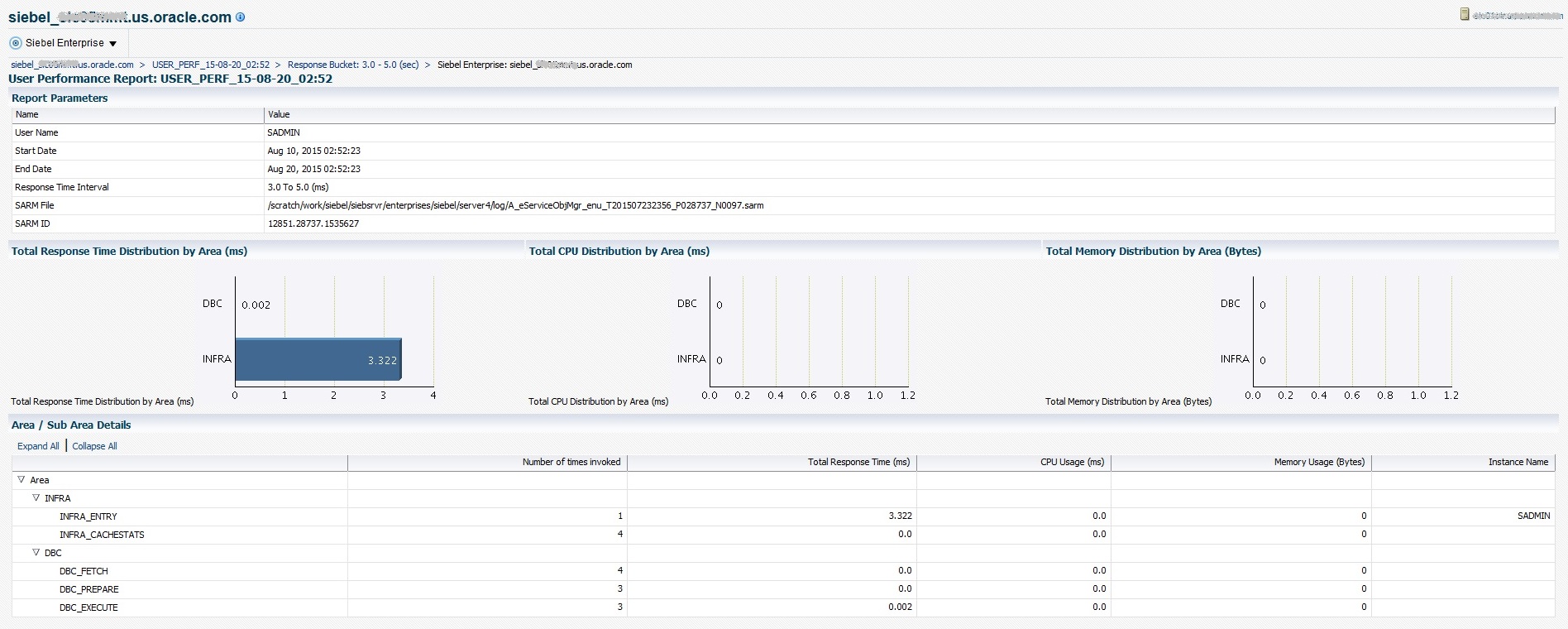

User Performance Report <Report Name> <Request ID> Page
To view this page (shown in Figure 6-8), click SARM ID in the Request Summary section of the User Performance Report <Report Name> <Bucket> page. You can use this page to view details about SARM requests serviced by the user.
Figure 6-8 User Performance Report - Example 3
  • Total Response Time Distribution by Area — Displays the response time by area measured by the SARM framework. This helps you understand the response time taken by each area of the Siebel server to process user requests.
  • Total Memory Distribution by Area — Displays the memory distribution by area measured by the SARM framework. The chart displays the memory distribution among various areas of the Siebel server while processing user requests.
  • Total CPU Distribution by Area — Displays the CPU distribution by area measured by the SARM framework. The chart displays the CPU time taken by each area of the Siebel server to process user requests.
  • Area / Sub Area Distribution Section — Displays performance details for areas or sub areas of the Siebel server. SARM functions based on points or areas where performance information is generated; for example, the start and end of each database operation. Area specifies the broad area or software layer where a request is processed.
