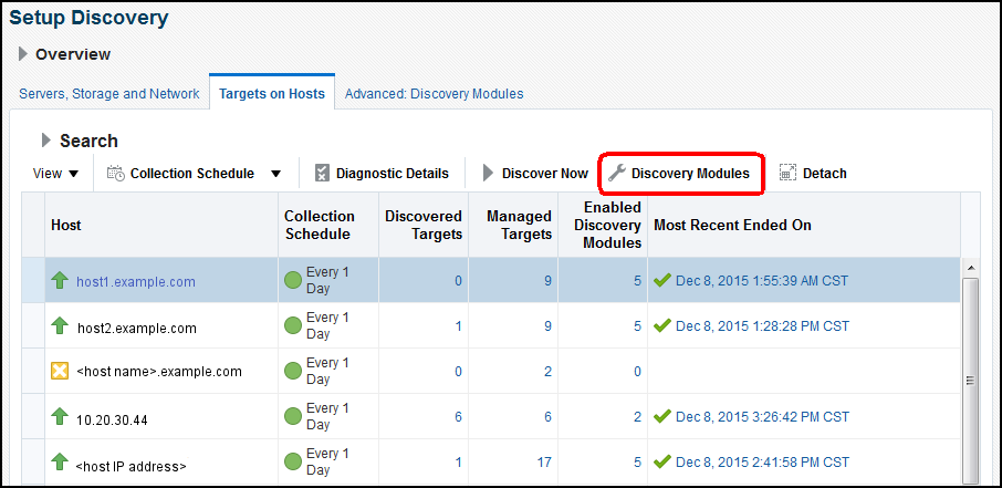

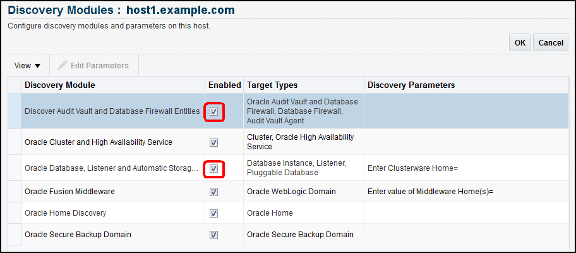

Discover Audit Vault Agent Target
Discovery of the Audit Vault (AV) Agent also can be done using automated discovery. Similar to other AVDF targets, you can run discovery on the host where the AV Agent is installed. The discovery script identifies the AV Agent and includes it with the discovered targets, which could be promoted by providing the Oracle home of the AV Agent and AVDF server AV_Admin credential.
In order to manage an Audit Vault agent with Enterprise Manager, a Management Agent needs to be present on the machine where the Audit Vault agent is about to be deployed.
Follow the steps below to add the Oracle Audit Vault agent target:
