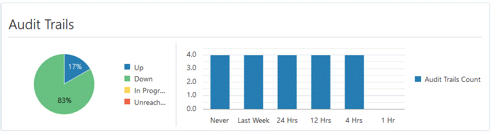

Audit Trails
Like Audit Vault Agents region, the Audit Trails region shows status information for all the audit trails in the Audit Vault and Database Firewall system. It shows since how long the data upload issues exist.
For a detailed report, select Audit Trails from the Oracle Audit Vault and Database Firewall menu or select the Audit Trails title found under Summary region from the Oracle AVDF Home Page.
Audit Trails List

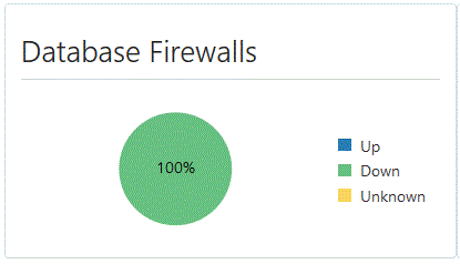

Database Firewalls
Like the Audit Vault Agents region, the Database Firewalls region shows all of the firewalls in the Audit Vault and Database Firewall system, not only the one monitored by Enterprise Manager as an Enterprise Manager target. This section also shows the count of Database Firewalls not monitored by Enterprise Manager as an Enterprise Manager target.
For a detailed report, select Database Firewalls from the Oracle Audit Vault and Database Firewall menu or click on the Database Firewalls title found under Summary region from the Oracle Audit Vault Home Page.
Database Firewalls List

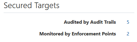

Targets
Targets can be supported databases or operating systems that Audit Vault and Database Firewall monitors. You must register all targets in Oracle Audit Vault and Database Firewall. From this page you can perform the following tasks:
This region shows number of Targets:
Contained in the Audit Vault and Database Firewall system.
Monitored by the Audit Trails in Audit Vault and Database Firewall system.
Protected by the monitoring points in the Audit Vault and Database Firewall system.
For a detailed report, select Targets from the Oracle Audit Vault and Database Firewall menu or click the Targets title on the Oracle AVDF home page.

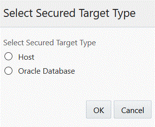

Add Host Target
- From the Targets page, click Add.
- On the pop-up, select Host Operating System. Click OK.
- Another pop-up displays, which shows all available Host Targets. Select a host target from the list. Click OK to return to the Targets page.
- Optional: On the Targets page, you can modify the Host target name. Click the Host name and then enter a new target name.
- Click Submit.
- On the credential pop-up, enter the Oracle user credential for the AV Server host. Click OK.

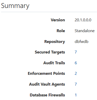

Summary Region
This region shows high-level information including the Oracle Audit Vault Server version and the number and type of components monitored by the plug-in.
