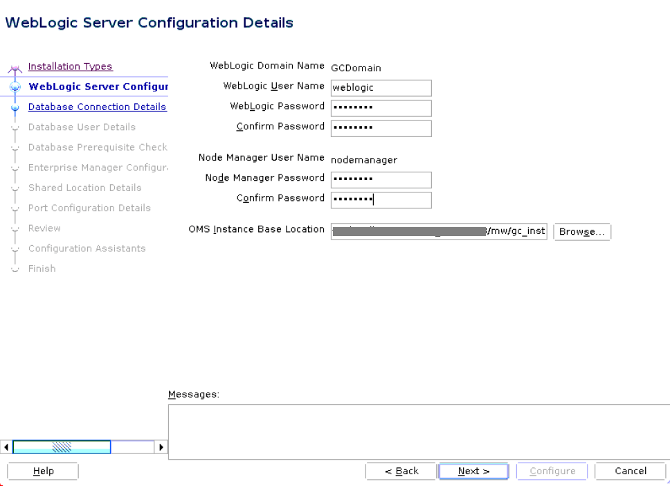

Allows you to change the name of the default WebLogic user account for the WebLogic domain GCDomain.
Prompts for separate, distinct passwords for WebLogic Server administration, Node Manager, SYSMAN user account, and Management Agent registration.
Allows you to change the name of the default OMS instance base directory (gc_inst) to a name of your choice, and creates that directory outside the Middleware home.

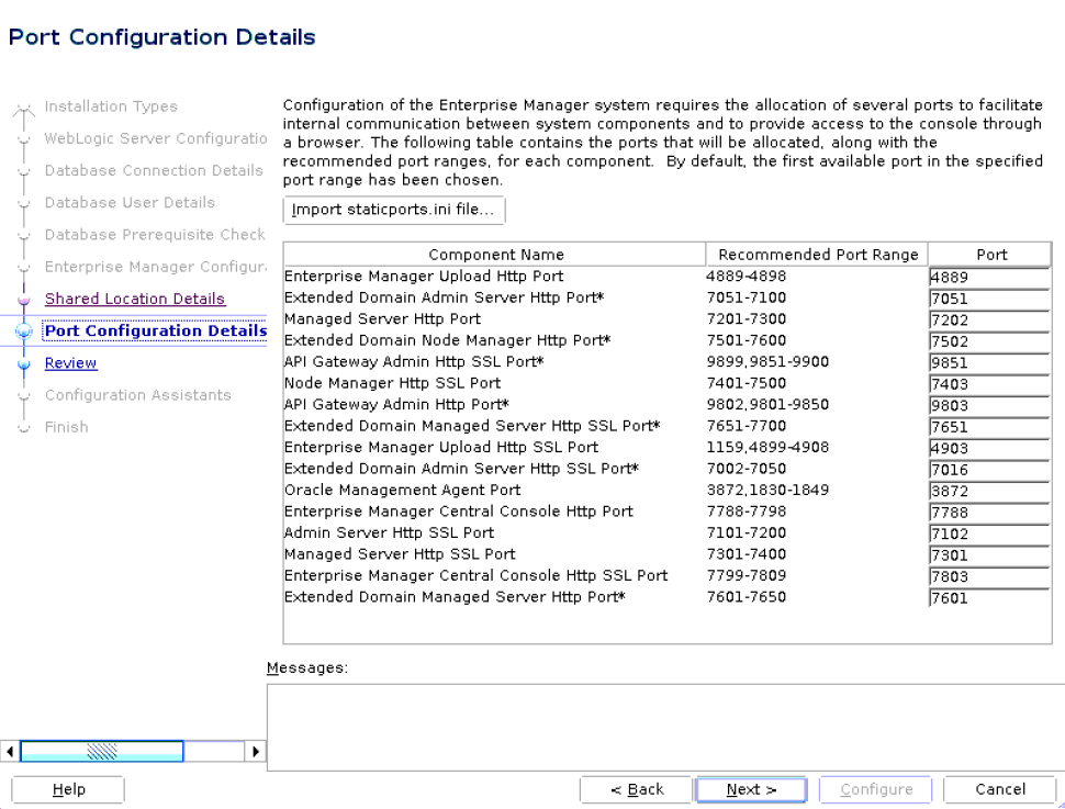

Allows you to customize the ports according to your environment.

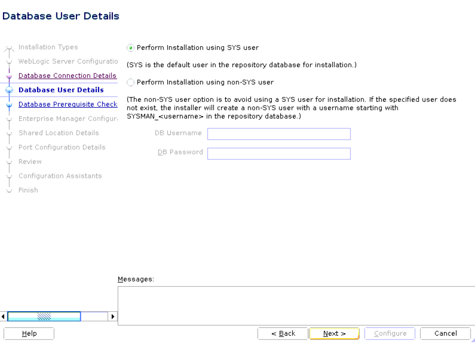

Non-SYS User: You can configure Oracle Enterprise Manager with a non-SYS admin user during the Configuring the Enterprise Manager Software Only in Graphical Mode step when running the
ConfigureGCscript. Using a non-SYS user allows Enterprise Manager administrators to use another user, an admin user, for these tasks since organizations continue to lock privileges credentials like the SYS database user to perform those activities.

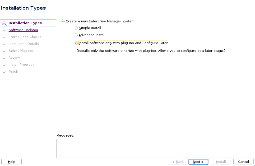

Select Installation Type.
On the Installation Types screen, select Create a new Enterprise Manager system, then select Install software only with plug-ins
Click Next.

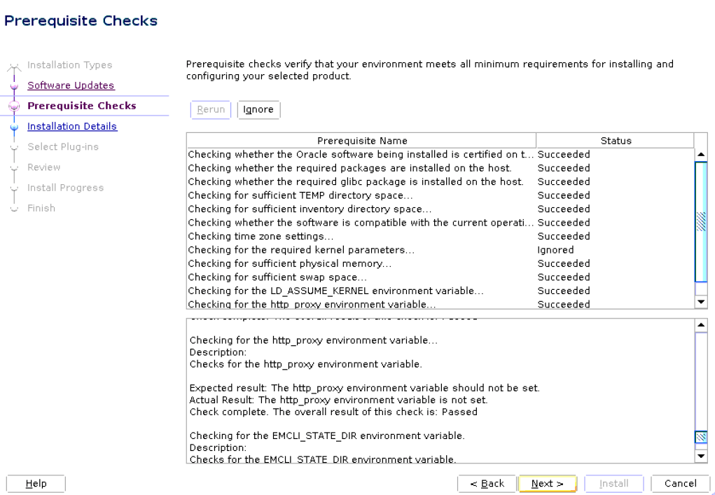

Check Prerequisites.
On the Prerequisite Checks screen, check the status of the prerequisite checks run by the installation wizard, and verify whether your environment meets all the minimum requirements for a successful installation.
The installation wizard runs the prerequisite checks automatically when you come to this screen. For example, it checks for the required operating system patches and operating system packages.
The status of the prerequisite check can be either Warning, Failed, Succeeded, Not Executed, In Progress, or Pending.
If some checks result in Warning or Failed status, then investigate and correct the problems before you proceed with the installation. The screen provides details on why the prerequisites failed and how you can resolve them. After you correct the problems, return to this screen and click Rerun to check the prerequisites again.
You can choose to ignore the checks with Warning status by clicking Ignore. However, all package requirements must be met or fixed before proceeding any further.
Click Next.

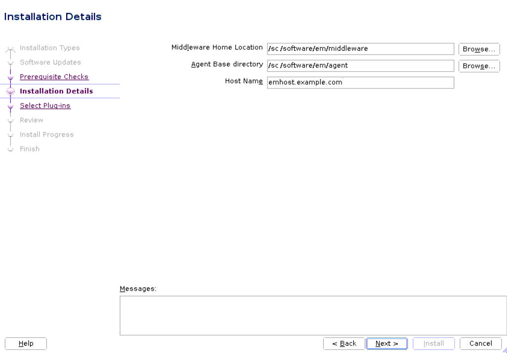

On the Installation Details screen, do the following:
Enter the Middleware home where you want to install the OMS and other core components. This is essentially the Oracle home.
The Enterprise Manager Installation Wizard installs Oracle WebLogic Server 12c Release 2 (12.2.1.4.0) and JDK 1.8.0_431 by default in this middleware home directory you enter here. A preinstalled JDK or Oracle WebLogic Server is not supported from 13c Release 1 onwards.
Ensure that the number of characters in the middleware home path does not exceed 70 characters for Unix platforms and 25 characters for Microsoft Windows platforms.
For example, the middleware home path
C:\Oracle\MW\EMcontaining only 15 characters is acceptable. However,C:\OracleSoftware\OracleMiddleware\OracleEnterpriseManager\OMS\newrelease\omscontaining more than 25 characters is not acceptable for Microsoft Windows platforms.
Enter the absolute path to the agent base directory, a location outside the middleware home where the Management Agent can be installed. For example, if the middleware home is
/u01/software/em24/middleware, then you can specify the agent base directory as/u01/software/em24/agentbasedir.Ensure that this location is empty and has write permission. Also ensure that it is always maintained outside the Oracle Middleware home.
C:\Oracle\MW\EMcontaining only 15 characters is acceptable. However,C:\OracleSoftware\OracleMiddleware\OracleEnterpriseManager\OMS\newrelease\omscontaining more than 25 characters is not acceptable for Microsoft Windows platforms. -
Validate the name of the host where you want to configure the OMS.
The host name appears as a fully qualified name, or as a virtual host name if your host is configured with virtual machine. If the installation wizard was invoked with a value for
ORACLE_HOSTNAME, then this field is prepopulated with that name.Accept the default host name, or enter a fully qualified domain name that is registered in the DNS and is accessible from other network hosts, or enter an alias host name that is defined in the
/etc/hostsfile on all the OMS instances at this site.Note:
The host name must resolve to the local host or virtual host because the host name is used for the local Oracle WebLogic Server as well as the Oracle Management Service. Do not provide a remote host or a load balancer virtual host in this field. Do not enter an IP address. Do not use underscores in the name. Short names are allowed, but you will see a warning, so Oracle recommends that you enter a fully qualified domain name instead.
Click Next.

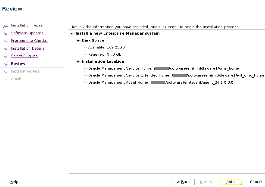

Review and Install.
On the Review screen, review the details you provided for the selected installation type.
If you want to change the details, click Back repeatedly until you reach the screen where you want to make the changes.
After you verify the details, if you are satisfied, click Install to begin the software only installation process.

Invoke the Enterprise Manager Installation Wizard
Invoke the installation wizard in graphical mode. (On Unix, make sure you invoke the installation wizard as a user who belongs to the
oinstallgroup you created. For information about creating operating system groups and users see, Creating Operating System Groups and Users for Enterprise Manager in the Oracle Enterprise Manager Basic Installation Guide.$<ORACLE_HOME>/sysman/install/ConfigureGC.sh [-invPtrLoc <absolute_path_to_oraInst.loc>]For Microsoft Windows platforms, invoke

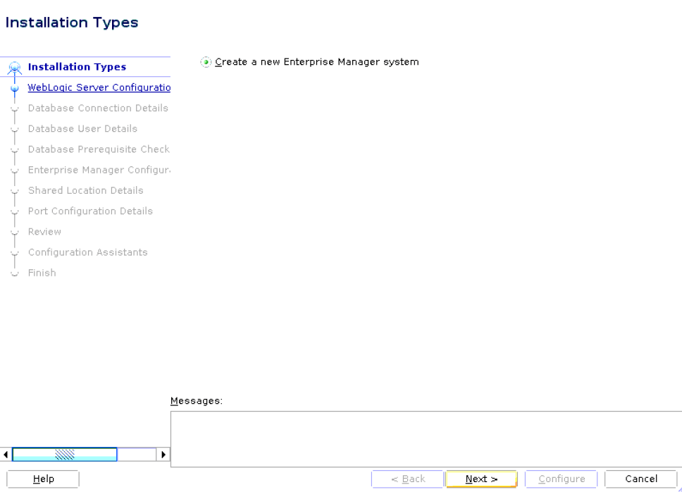

On the Installation Types screen, select Create a new Enterprise Manager system.
Click Next.
Enter WebLogic Server Configuration Details
On the WebLogic Server Configuration Details screen, enter the credentials for the WebLogic Server user account and the Node Manager user account, and validate the path to the Oracle Management Service instance base location. Ensure that the Oracle Management Service instance base location is outside the middleware home
Ensure that your password contains at least 8 characters without any spaces, begins with a letter, and includes at least one numeric value.
Ensure that the Oracle Management Service instance base location is outside the middleware home.
By default, the WebLogic Domain name is
GCDomain, and the Node Manager name isnodemanager. These are non-editable fields. The installer uses this information for creating Oracle WebLogic Domain and other associated components such as the admin server, the managed server, and the node manager.A Node Manager enables you to start, shut down, or restart an Oracle WebLogic Server instance remotely, and is recommended for applications with high availability requirements.
On Microsoft Windows, a Node Manager service is NOT created. This is an expected behavior.
By default, the Oracle Management Service instance base location is
gc_inst, which is created outside the Middleware home for storing all configuration details related to the OMS. -
Click Next.

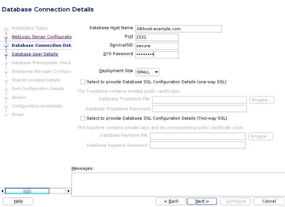

Enter Database Connection Details
On the Database Connection Details screen, do the following:
Enter the Database connection details.
Provide the following details of the existing certified database where the Management Repository needs to get created:
- Database host name.
- Port (Database listener port).
- Service/SID (Database service id).
- SYS Password (Password of the SYS database user).
If you have already created a database instance with a preconfigured Management Repository using the database templates offered by Oracle, then provide details about that database instance.
The installer uses this information to connect to the existing database for creating the SYSMAN schema and plug-in schemas. If you provide details of a database that already has a preconfigured Management Repository, then the installer only creates plug-in schemas.
For information about creating a database instance with a preconfigured Management Repository using the database templates offered by Oracle, refer to Enterprise Manager Basic Installation Guide.
If you connect to a database instance that was created using the database template offered by Oracle, then note that the password assigned to the user accounts SYSMAN_MDS, SYSMAN_APM, and SYSMAN122140_OPSS, which were created while preconfiguring the Management Repository, are automatically reset with the SYSMAN password you enter on the Repository Configuration Details screen).
The PDB name will always be
empdbreposirrespective of the CDB name if the PDB is created with the above listed templates. However, if the CDB is created with<domain name>then the PDB will beempdbrepos.<domain name>. For more information see, Creating a Database Instance with Preconfigured Repository Using Database Templates in the Oracle Enterprise Manager Basic Installation Guide. -
If you are providing the details of a pluggable database (PDB), then use the full service name instead of the alias. For example, pdb.example.com. If you are providing the details of a lone-pluggable database (Lone-PDB), then use the full service name. For example, pdb.example.com. If you are providing the details of a non-container database (Non-CDB), then use the SID.
To identify whether your database is a certified database listed in the certification matrix, access the certification matrix as described in Accessing the Enterprise Manager Certification Matrix in the Oracle Enterprise Manager Basic Installation Guide.
For information on all the database initialization parameters that are set, and all the prerequisite checks that are run, and for instructions to run the prerequisite checks manually if they fail, see Overview of the EM Prerequisite Kit in the Oracle Enterprise Manager Basic Installation Guide.
Select the deployment size from the Deployment Size list to indicate the number of targets you plan to monitor, the number of Management Agents you plan to have, and the number of concurrent user sessions you plan to have.
The prerequisite checks are run regardless of the selection you make, but the values to be set for the various parameters checked depend on the selection you make.
For more information on deployment sizes, the prerequisite checks that are run, the database parameters that are set, and how you can modify the deployment size after installation, refer to What Is a Deployment Size for Enterprise Manager in an Advanced Configuration?.
Table 4-1 describes each deployment size.
Table 4-1 Deployment Size
Deployment Size Targets Count Management Agents Count Concurrent User Session Count Small
Up to 999
Up to 99
Up to 10
Medium
Between 1000 and 9999
Between 100 and 999
Between 10 and 24
Large
10,000 or more
1000 or more
Between 25 and 50
(Optional) Check the Select to provide Database SSL Configuration Details (one-way SSL) checkbox if the database is one-way SSL configured. The truststore details are required for one-way SSL configuration.
Provide the database truststore file and password.
(Optional) Check the Select to provide Database SSL Configuration Details (two-way SSL) checkbox if the database is two-way SSL configured. The keystore details are required for two-way SSL configuration.
Provide the database keystore file and password.
PKCS12 wallet file format is supported.
Click Next.

Enter Database User Details
On the Database User Details screen, select if you want to perform the installation using SYS or non-SYS database user.Note:
Starting with Enterprise Manager 13c Release 5 Update 15 (13.5.0.15) or higher, you can perform the configuration using the SYS admin user (default option) or a different user, known as a non-SYS admin user.SYS is the default user in the Repository database.
A non-SYS user is a less privileged administrator user of the Repository database that still allows you to perform Enterprise Manager administration tasks.
If the Perform Installation using non-SYS user is selected, you need to provide the database user name and password for the non-SYS user. The non-SYS user name should have the
SYSMAN_prefix as part of user name. For example, you can enterSYSMAN_ADMINunder DB Username. If the user doesn't exist, the Enterprise Manager installer creates the new user in the Repository database.Click Next.

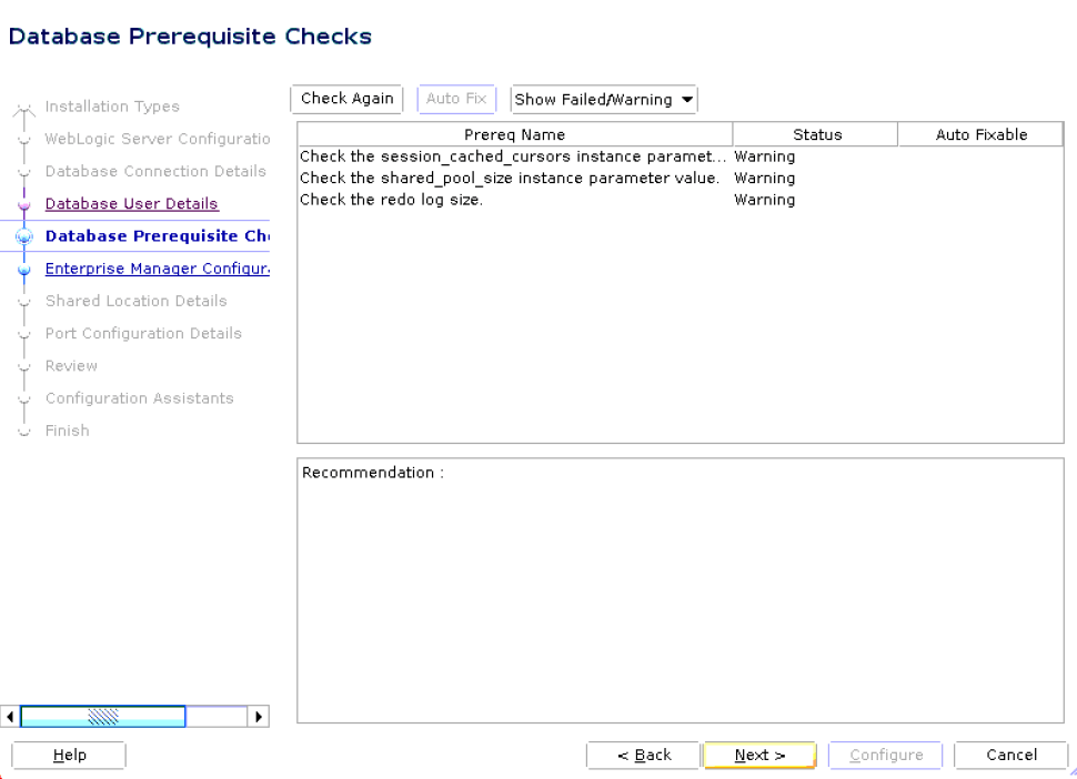

Check the Database Prerequisites.
On the Database Prerequisite Checks screen, check the status of the database prerequisites performed by the installation wizard, and verify whether your environment meets all the minimum requirements for a successful installation. Then click Next.
The installation wizard runs the database prerequisite checks automatically when you come to this screen. The status of the prerequisite check can be either Warning, Failed or Succeeded.
If some checks result in Warning or Failed status, then investigate and correct the problems before you proceed with the installation. The screen provides details on why the prerequisites failed and how you can resolve them. After you correct the problems, return to this screen and click Check Again to check the database prerequisites again.- If the Auto Fixable column is
Yes, you can click on Auto Fix and the installer will fix the issue automatically. - If the recommendation indicates that the Correction
Type is
Manual, you need to fix the issue manually.
After you complete reviewing and fixing the prerequisites results, click Next.

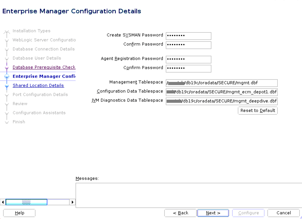

Enter Enterprise Manager Configuration Details
On the Repository Configuration Details screen, do the following:
For SYSMAN Password, enter and confirm a password for creating the SYSMAN user account.
The SYSMAN user account is used for creating the SYSMAN schema, which holds most of the relational data used in managing Enterprise Manager. SYSMAN is also the super administrator for Enterprise Manager.
If you connect to a database instance that was created using the database template offered by Oracle, then note that the password assigned to the user accounts SYSMAN_MDS, SYSMAN_APM, and SYSMAN122140_OPSS, which were created while preconfiguring the Management Repository, are automatically reset with the SYSMAN password you enter on this screen.
For Agent Registration Password, enter and confirm a password for registering the new Management Agents that join the Enterprise Manager system.
For Management Tablespace, enter the absolute path to the location where the data file for management tablespace (
mgmt.dbf) can be stored. The installer uses this information for storing data about the monitored targets, their metrics, and so on. Ensure that the specified path leads up to the file name.For example,
/u01/oracle/prod/oradata/mgmt.dbfIf the database is on Oracle Automatic Storage Management (Oracle ASM), then the path must look like:
+<disk_group>/<sid>/<subdir_path_if_any>/<datafilename>.dbfFor example,
+DATA/oemrsp01d/datafile/mgmt.dbf -
For Configuration Data Tablespace, enter the absolute path to the location where the data file for configuration data tablespace (
mgmt_ecm_depot1.dbf) can be stored. This is required for storing configuration information collected from the monitored targets. Ensure that the specified path leads up to the file name.For example,
/u01/oracle/prod/oradata/mgmt_ecm_depot1.dbfIf the database is on Oracle Automatic Storage Management (Oracle ASM), then the path must look like:
+DATA/oemrsp01d/datafile/mgmt_ecm_depot1.dbf -
For JVM Diagnostics Data Tablespace, enter the absolute path to a location where the data file for JVM Diagnostics data tablespace (
mgmt_deepdive.dbf) can be stored. Ensure that the specified path leads up to the file name. Enterprise Manager requires this data file to store monitoring data related to JVM Diagnostics and Application Dependency Performance (ADP).For example,
/u01/oracle/prod/oradata/mgmt_deepdive.dbfIf the database is on Oracle Automatic Storage Management (Oracle ASM), then the path must look like:
+DATA/oemrsp01d/datafile/mgmt_deepdive.dbf

Review Port Configuration Details
On the Port Configuration Details screen, customize the ports to be used for various components.
You can enter an available custom port that is either within or outside the port range recommended by Oracle.
To verify if a port is free, run the following command:
On Unix:
netstat -anp | grep <port no> -
On Microsoft Windows:
netstat -an|findstr <port_no>
However, the custom port must be greater than 1024 and lesser than 65535. Alternatively, if you already have the ports predefined in a
staticports.inifile and if you want to use those ports, then click Import staticports.ini file and select the file.Note:
If the
staticports.inifile is passed during installation, then by default, the ports defined in thestaticports.inifile are displayed. Otherwise, the first available port from the recommended range is displayed.The
staticports.inifile is available in the following location:<Software_Extracted_Location>/response -
Click Next.

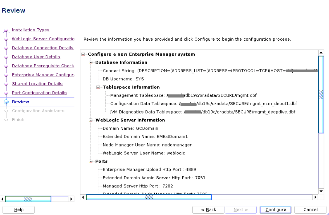

Review and Configure
After you verify the details, click Configure to begin the configuration process.

Oracle recommends running the EM Prerequisite Kit before invoking the installer to ensure that you meet all the repository requirements beforehand. Even if you do not run it manually, the installer anyway runs it in the background while installing the product. However, running it manually beforehand sets up your Management Repository even before you can start the installation or upgrade process. For information on the kit, to understand how to run it, and to know about the prerequisite checks it runs, see the Enterprise Manager Basic Installation Guide.
However, if you plan to use a database instance that was created with a preconfigured Management Repository using the database templates offered by Oracle, then make sure you pass the following parameter while invoking the EM Prerequisite Kit.
-componentVariables repository:EXECUTE_CHECKS_NOSEED_DB_FOUND:false

ORACLE_MIDDLEWARE_HOME_LOCATION |
String |
Yes |
Enter the location where you want the installer to install Oracle WebLogic Server and Java Development Kit (JDK). Ensure that the middleware location has write permission. For example, Note: Ensure that the number of characters in the middleware home path does not exceed 70 characters for Unix platforms and 25 characters for Microsoft Windows platforms. For example, the middleware home path |
AGENT_BASE_DIR |
String |
Yes |
Enter the absolute path to the agent base directory, a location outside the Oracle Middleware home where the Management Agent can be installed. For example, Ensure that this location is empty and has write permission. Also ensure that it is always maintained outside the Oracle Middleware home. Note: (Only for Microsoft Windows) Ensure that the number of characters in the agent base directory path does not exceed 25 characters. For example, the agent base directory path |
ORACLE_HOSTNAME |
String |
Yes |
Enter a fully qualified domain name that is registered in the DNS and is accessible from other network hosts, or enter an alias host name that is defined in the The host name must resolve to the local host because the host name is used for the local Oracle WebLogic Server as well as the Oracle Management Service. Do not provide a remote host or a load balancer virtual host in this field. Do not enter an IP address. Do not use underscores in the name. Short names are allowed, but you will see a warning, so Oracle recommends that you enter a fully qualified domain name instead. If you do not mention the host name, the installation wizard will proceed further, honoring the host name it automatically detects for that host. |

Evaluate Non-SYS User Creation
Since security is a growing concern, Oracle provides the option to perform the installation, configuration and patching of the OMS using a non-privileged administrator user, also known as non-SYS user.
Once you create and start using the non-SYS admin user for the installation, configuration and patching of the OMS, you cannot switch back to use SYS as an admin user to perform any of those operations.- Less-privileged database administrator user. Also known as admin user.
- Performs Enterprise Manager installation, configuration and patching operations. (The SYS database user is no longer required during the installation, configuration and patching).
- User is created during the execution of the
ConfigureGCscript (Enterprise Manager configuration). - Naming convention:
SYSMAN_is the username prefix.
- Privileged database administrator user.
- Performs the Enterprise Manager installation, configuration and patching operations.
You are prompted to make the selection of creating and performing the installation using SYS or non-SYS user during the Database User Details step from Configuring the Enterprise Manager Software Only in Graphical Mode.
String |
Yes |
Enter the location where you want the installer to install Oracle WebLogic Server 12c Release 2 (12.2.1.4.0) and Java Development Kit (JDK) 1.8.0_431. Ensure that the middleware location has write permission. Note that the middleware location is essentially the one and only Oracle home in 24ai release. For example, Note: Ensure that the number of characters in the middleware home path does not exceed 70 characters for Unix platforms and 25 characters for Microsoft Windows platforms. For example, the middleware home path |
ORACLE_HOSTNAME |
String |
Yes |
AGENT_BASE_DIR |
String |
Yes |
WLS_ADMIN_SERVER_USERNAME |
String |
Yes |
By default, |
WLS_ADMIN_SERVER_PASSWORD |
String |
Yes |
Enter a password for the WebLogic user account. Ensure that your password contains at least 8 characters without any spaces, begins with a letter, and includes at least one numeric value. |
WLS_ADMIN_SERVER_CONFIRM_PASSWORD |
String |
Yes |
Confirm the password for the WebLogic user account. |
NODE_MANAGER_PASSWORD |
String |
Yes |
By default, Ensure that your password contains at least 8 characters without any spaces, begins with a letter, and includes at least one numeric value. |
NODE_MANAGER_CONFIRM_PASSWORD |
String |
Yes |
Confirm the password for the node manager user account. |
ORACLE_INSTANCE_HOME_LOCATION |
String |
Yes |
By default, For more information about this location, see What Is an Oracle Management Service Instance Base Location?. Note: If you are installing on an NFS-mounted drive and creating the OMS instance base directory (gc_inst) on that NFS-mounted drive, then after you install, move the lock files from the NFS-mounted drive to a local file system location. For instructions, refer to Performing Postconfiguration Tasks After Configuring the Enterprise Manager Software Only in Silent Mode. |

dbUser |
String |
Yes |
Enter the non-SYS (admin) username. If using the default option, enter 'SYS' as a user. The database user name that creates the repository schema during the install process. This is the non-SYS database user (a database admin user other than the SYS user). Naming convention: User name should start with the For example: If the user doesn't exist, the install process creates the new user in the Repository database. This parameter is only required if |
dbPassword |
String |
Yes |
Enter the non-SYS (admin) user password. If using the default option, enter the password of the 'SYS' user. The password of the database user that creates the repository schema. This is the non-SYS database user password. This parameter is only required if |
