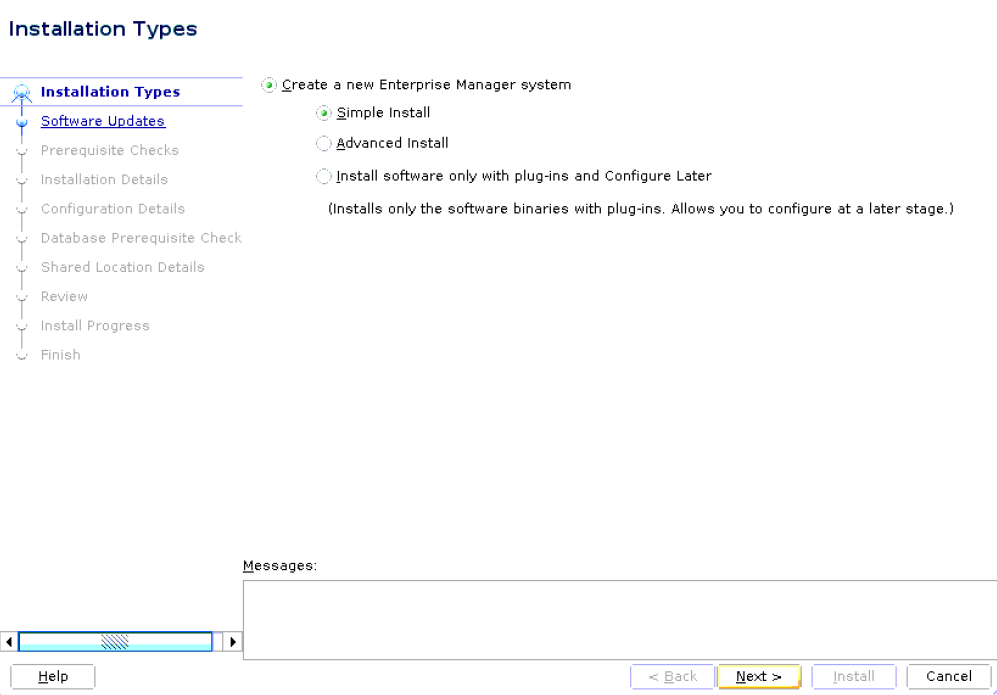

Overview of the Installation Types Offered for Enterprise Manager

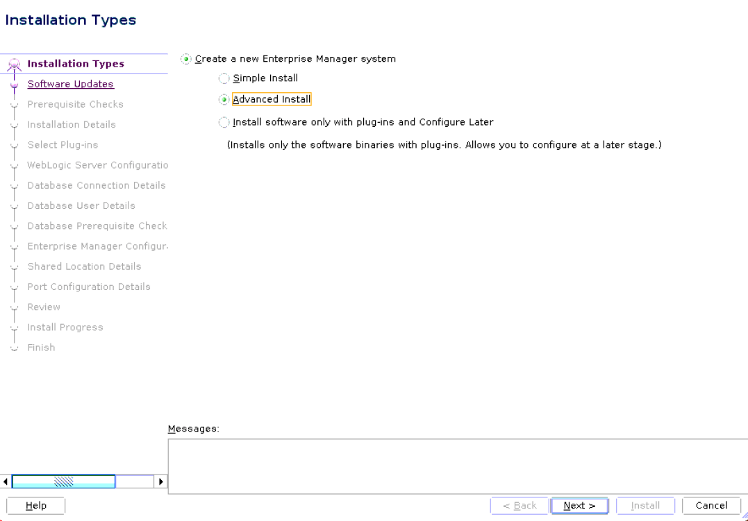

Enterprise Manager offers the following different types of installation options:
  • Simple install
  • Advanced install
  • Install software only with plug-ins and configure later
The Table 5-1 table describes the basic differences between simple and advanced installation types.
If you want to install Enterprise Manager for evaluation or demo purposes, then use the Simple installation type.
  • If you want to install only the software binaries of Enterprise Manager with plug-ins in graphical mode and then configure the installation at a later point, use the Software Only installation type. For more information, see Installing an Enterprise Manager System Using Software Only Install Along With Plugins and Configuring Later in the Enterprise Manager Advanced Installation and Configuration Guide.
  • Starting with Oracle Enterprise Manager 24ai Release 1 Update 9 (24.1.0.9), Oracle Autonomous AI Transaction Processing Serverless (ATP-S) can be used as the database that hosts the Oracle Management Repository (OMR). ATP-S repository configuration is supported only when Enterprise Manager is installed using the Software Only installation type and configured later using ConfigureGC; it is not supported through the Simple Install or end-to-end Advanced Install flow. For more information, see Using ATP-S as the Oracle Management Repository in the Enterprise Manager Advanced Installation and Configuration Guide.

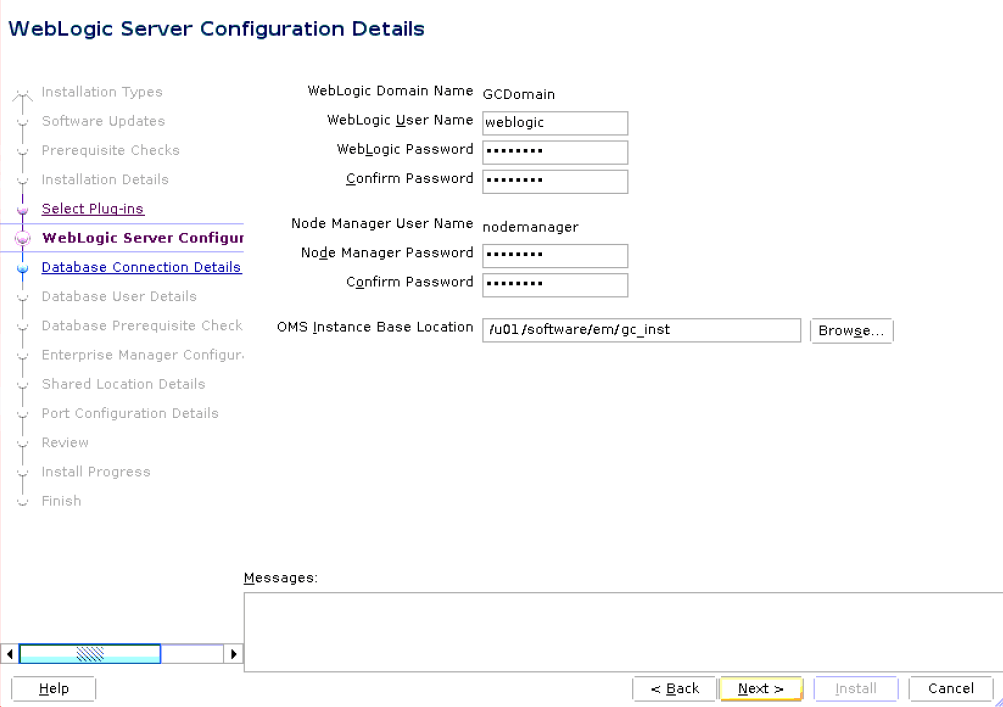

Creates a default user account weblogic for the WebLogic domain GCDomain.
Allows you to change the name of the default user account weblogic for the WebLogic domain GCDomain.
Prompts for a common password for WebLogic Server administration, Node Manager, SYSMAN user account, and Management Agent registration.
Prompts for separate, distinct passwords for WebLogic Server administration, Node Manager, SYSMAN user account, and Management Agent registration.

  • Creates an Oracle WebLogic domain called GCDomain in the WebLogic container. For this WebLogic domain, a default user account weblogic is used as the administrative user. This domain is one across all OMSs.
    During the advanced installation process, you can choose to change it if preferred.
  • Creates an Oracle WebLogic domain called EMExtDomain1 in the Zero Downtime (ZDT) WebLogic container. It's also called extended domain. This domain is one per OMS instance.
  • Creates a Node Manager user account called nodemanager. A Node Manager enables you to start, shut down, or restart an Oracle WebLogic Server instance remotely, and is recommended for applications with high availability requirements.

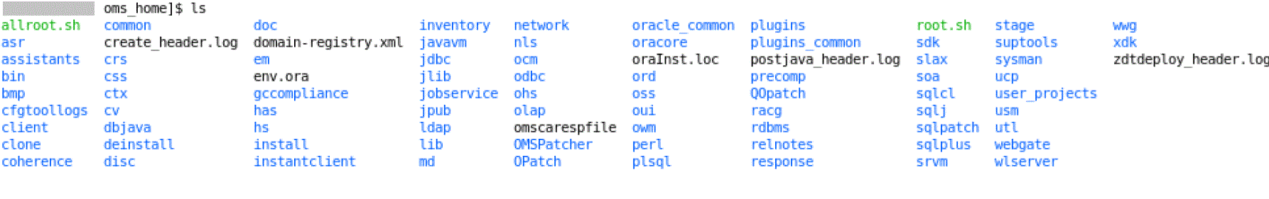

The OMS instance base directory (typically gc_inst directory) is maintained outside of the middleware home directory, and that is why it is not shown in Figure 5-1.
OMS Home (oms_home)
Figure 5-1 shows the contents of the OMS home for this type of installation.
Figure 5-1 OMS Home Contents for a Fresh Installation
oms_home Contents for a Fresh Installation

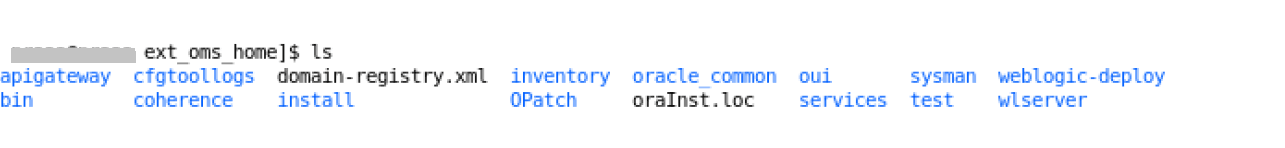

Extended OMS Home (ext_oms_home)
Figure 5-2 shows the contents of the extended OMS home for this type of installation.
Figure 5-2 EXT_OMS Home Contents for a Fresh Installation
ext_oms_home Contents for a Fresh Installation

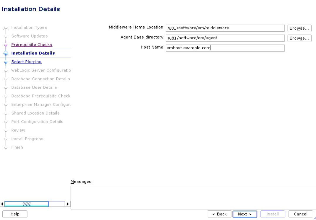

  • Ensure that there are no white spaces in the name of the directory where you download and run the Enterprise Manager software from. For example, do not download and run the software from a directory titled EM Software because there is a white space between the two words of the directory name.

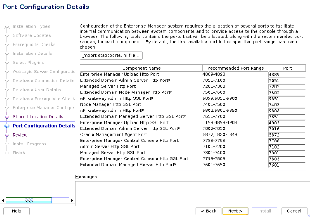

Port Requirements
Ensure that the ports you assign (within the given range) to the core components of Enterprise Manager are free and available. For information on the core components and their port ranges, see What Ports Are Used for Installation? in the Oracle Enterprise Manager Advanced Installation and Configuration Guide.
To verify if a port is free, run the following command:
  • On Unix:
    netstat -an | grep <port no>
  • On Microsoft Windows:
    netstat -an|findstr <port_no>

  3. Select Installation Type.
    Figure 5-4 Installation Types
    Installation Types Screen for Simple Installation
    On the Installation Types screen, select Create a new Enterprise Manager system, then select Simple install.
  4. Click Next.

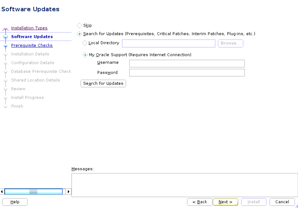

  5. (Recommended) Install Software Updates.
    On the Software Updates screen, select Search for Updates, and then select one of the following options to apply the latest software updates:
    • Local Directory, if you do not have Internet connectivity on your host, and want to download the updates in offline mode and apply them while performing the installation.
    • My Oracle Support, if you have Internet connectivity on your host, and want to connect to My Oracle Support directly via the installer to download the updates in online mode and apply them while performing the installation.
    For more information on these options, and for instructions to download and apply the software updates using these options, see Are the Software Updates Applied Automatically Even for Databases That Have Oracle Management Repository Preconfigured? in the Oracle Enterprise Manager Advanced Installation and Configuration Guide.
    The Software Updates screen uses the built-in feature Auto Update to automatically download and deploy the latest recommended patches while installing or upgrading Enterprise Manager. This way, you do not have to keep a manual check on the patches released by Oracle. All patches required by the installer for successful installation and upgrade are automatically detected and downloaded from My Oracle Support, and applied during the installation or upgrade, thus reducing the known issues and potential failures. Oracle strongly recommends using this feature, and applying the software updates while the installation is in progress. For more information, see What Is a Software Update? in the Oracle Enterprise Manager Advanced Installation and Configuration Guide.
    During installation, you will be prompted for the details of a database where Oracle Management Repository can be configured. If you plan to provide the details of a database that already has an Oracle Management Repository preconfigured using the database templates offered by Oracle, then the software updates selected on this screen cannot be automatically applied. In such a case, you must manually download and apply these software updates after the installation.
    Despite providing the My Oracle Support credentials, if you are unable to download the software updates, then exit the installer, and invoke the installer again passing the SHOW_PROXY parameter in the following way:
    <Software_Location>/em24100_<platform>.bin SHOW_PROXY=true
    To invoke the installer on Microsoft Windows, run setup_em24100_win64.exe SHOW_PROXY=true.

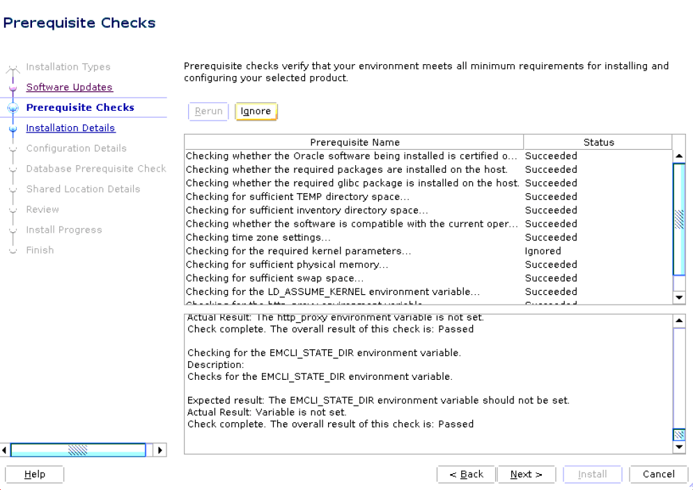

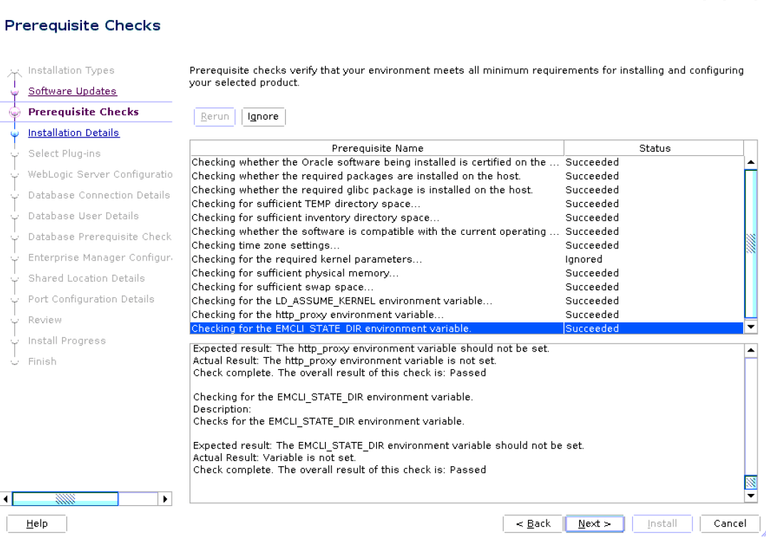

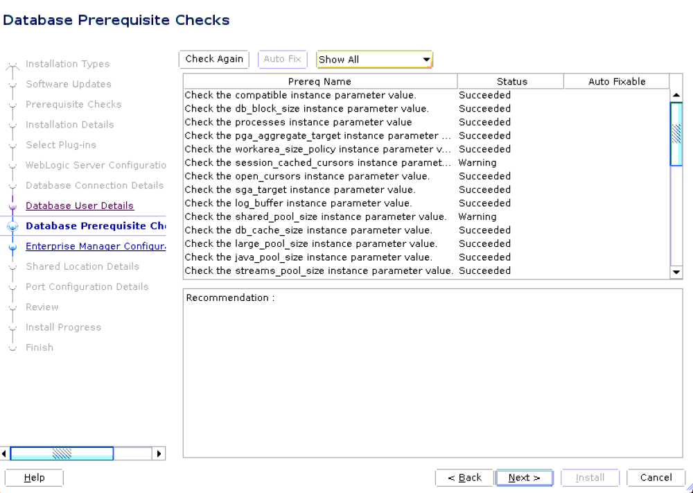

  9. Check Prerequisites.
    Check Prerequisites
    On the Prerequisite Checks screen, check the status of the prerequisite checks run by the installation wizard, and verify whether your environment meets all the minimum requirements for a successful installation.
    The installation wizard runs the prerequisite checks automatically when you come to this screen. It checks for the required operating system patches, operating system packages, and so on.
    The status of the prerequisite check can be either Warning, Failed, Succeeded, Not Executed, In Progress, or Pending.
    • If some checks result in Warning or Failed status, then investigate and correct the problems before you proceed with the installation. The screen provides details on why the prerequisites failed and how you can resolve them. After you correct the problems, return to this screen and click Rerun to check the prerequisites again.
    • However, all package requirements must be met or fixed before proceeding any further. Otherwise, the installation might fail.
  10. Click Next.
    If a prerequisite check fails reporting a missing package, then make sure you install the required package, and click Rerun. The installation wizard validates the package name as well as the version, so make sure you install the packages of the minimum versions mentioned in Package, Kernel Parameter and Library Requirements for Enterprise Manager. To understand the logic the installation wizard uses to verify these packages, see About the Logic Used by the Enterprise Manager Installation Wizard to Verify the Packages.

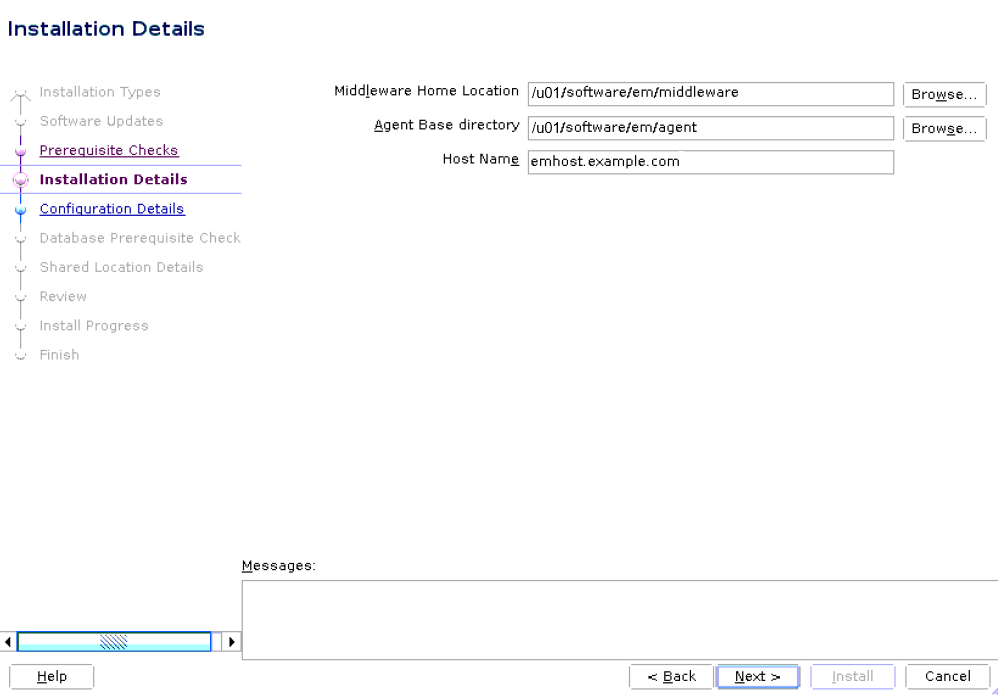

  11. Enter Installation Details.
    Installation Details Screen for Simple Installation
    On the Installation Details screen, do the following:
    1. Enter the Middleware home where you want to install the OMS and other core components.
      For example, /u01/software/em/middleware
      • The Enterprise Manager Installation Wizard installs Oracle WebLogic Server 12c Release 2 (12.2.1.4.0) and JDK 1.8.0_431 by default in this middleware home directory you enter here.
        Starting with Enterprise Manager 13c Release 1, a preinstalled JDK or Oracle WebLogic Server is not supported.
      • Ensure that the number of characters in the middleware home path does not exceed 70 characters for Unix platforms and 25 characters for Microsoft Windows platforms.
        For example, the middleware home path C:\Oracle\MW\EM containing only 15 characters is acceptable. However, C:\OracleSoftware\OracleMiddleware\OracleEnterpriseManager\OMS\newrelease\mwh containing more than 25 characters is not acceptable for Microsoft Windows platforms.
      • By default, the OMS instance base directory (gc_inst) is created outside the middleware home, and at the same parent level as the middleware home.
        For example, if you enter /u01/software/em/middleware as the middleware home, then the OMS instance base directory is created as /u01/software/em/gc_inst.
        However, if you are installing on an NFS-mounted drive and creating the OMS instance base directory (gc_inst) on that NFS-mounted drive, then after you install, move the lock files from the NFS-mounted drive to a local file system location. Modify the lock file location in the httpd.conf file to map to a location on a local file system. For instructions, refer to Performing Postinstallation Tasks After Installing an Enterprise Manager System.
    2. Enter the absolute path to the agent base directory, a location outside the Oracle Middleware home where the Management Agent can be installed. For example, if the middleware home is /u01/software/em/middleware, then you can specify the agent base directory as /u01/software/em/agent.
      Ensure that this location is empty and has write permission. Also ensure that it is always maintained outside the middleware home.
    3. Validate the name of the host where you want to configure the OMS.
      The host name appears as a fully qualified name. The host name can also appear as a virtual host name if your host is configured with virtual machine.
      You can choose to accept the default host name and proceed with the installation. Alternatively, you can change the name if it is incorrect, or enter another host name for this host. Ensure that the host name you enter is accessible from other hosts in the network (other hosts must be able to ping this host).
      The host name appears as a fully qualified name, or as a virtual host name if your host is configured with virtual machine. If the installation wizard was invoked with a value for ORACLE_HOSTNAME, then this field is prepopulated with that name.
      Accept the default host name, or enter a fully qualified domain name that is registered in the DNS and is accessible from other network hosts, or enter an alias host name that is defined in the /etc/hosts file on all the OMS instances at this site.
      The host name must resolve to the local host or virtual host because the host name is used for the local Oracle WebLogic Server as well as the Oracle Management Service.
      Oracle recommends using a fully qualified domain name.
      • Do not provide a remote host or a load balancer virtual host in this field.
      • Do not enter an IP address.
      • Do not use underscores in the name.
      • Short names are allowed, but a warning message gets displayed.

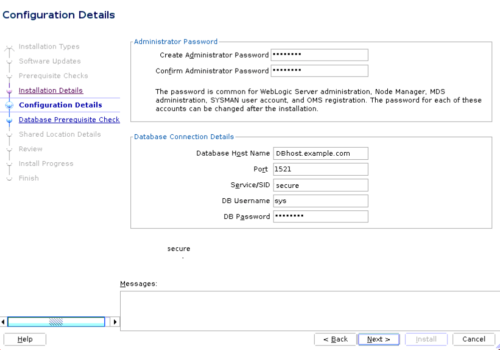

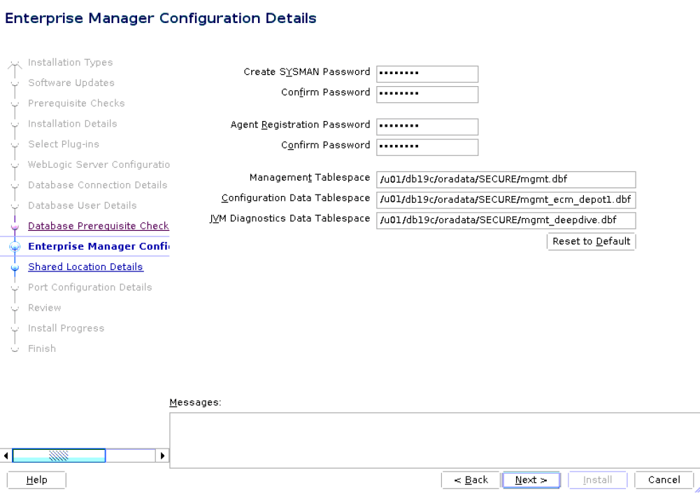

  13. Enter Configuration Details.
    Figure 5-5 Configuration Details
    On the Configuration Details screen, do the following:
    1. Administrator Password
      Enter an administrator password, which can be used as a common password for configuring the Enterprise Manager.
      The passwords used here must follow the conventions required for the SYSMAN account. The SYSMAN account password must begin with a letter, and can only contain uppercase or lowercase letters, numbers and the following characters: $, # , _
      Table 5-4 describes what the administrator password is used for.
      Table 5-4 Usage of Administrator Password
      Purpose Description
      Creates SYSMAN User Account
      The user account is used as the super administrator for configuring the SYSMAN schema in the Management Repository.
      Creates Default WebLogic User Account weblogic
      The user account is used as the administrator for creating the WebLogic domain: GCDomain.
      Creates Default Node Manager User Account nodemanager
      The user account is automatically created during the configuration of Enterprise Manager.
      This user account is for the GCDomain WebLogic domain.
      Authenticates New Management Agents
      The agent registration password is used for authenticating new Management Agents that join Enterprise Manager system, where the communication between the OMS and the Management Agent is secure.

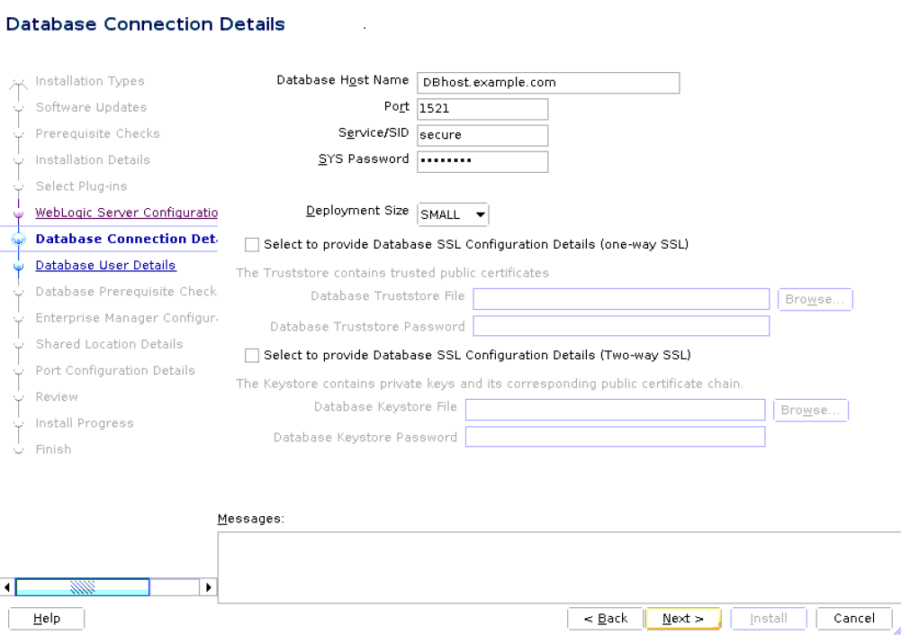

    2. Database Connection Details
      Provide details of the existing, certified database where the Management Repository needs to be created including the SYS database user password.
      If you have already created a database instance with a preconfigured Management Repository using the database templates offered by Oracle, then provide details about that database instance.
      The installer uses this information to connect to the existing database for creating the SYSMAN schema and plug-in schemas. If you provide details of a database that already has a preconfigured Management Repository, then the installer only creates plug-in schemas.
      • For information about creating a database instance with a preconfigured Management Repository using the database templates offered by Oracle, refer to Creating a Database Instance with Preconfigured Repository Using Database Templates.
      • If you connect to a database instance that was created using the database template offered by Oracle, then the password assigned to user accounts SYSMAN, SYSMAN_MDS, SYSMAN_APM, and SYSMAN122140_OPSS, which were created while preconfiguring the Management Repository, are automatically reset with the administrator password you enter here on this screen. We also unlock all these user accounts.
        Starting with Enterprise Manager 13c Release 4, SYSMAN_OPSS user no longer exists. It has been replaced by SYSMAN<WebLogic_Server_Version>_OPSS user. In this case, SYSMAN122140_OPSS user.
      • To identify whether your database is a certified database listed in the certification matrix, follow the steps outlined in Accessing the Enterprise Manager Certification Matrix.
      • If you are providing the details of a pluggable database (PDB), then use the full service name instead of the alias. For example, pdb.example.com. If you are providing the details of a lone-pluggable database (Lone-PDB), then use the full service name. For example, pdb.example.com. If you are providing the details of a non-container database (Non-CDB), then use the SID.
      • If you are providing the details of an Oracle RAC database that is configured with Single Client Access Name (SCAN), then enter the SCAN name as the host name.
      • For information on all the database initialization parameters that are set, and all the prerequisite checks that are run, and for instructions to run the prerequisite checks manually if they fail, see Repository Prerequisite Checks Run by the EM Prerequisite Kit.
  14. Click Next.
    • If you are connecting to an Oracle RAC database, and if you have specified the virtual IP address of one of its nodes, then the installation wizard prompts you with a Connection String dialog and requests you to update the connection string with information about the other nodes that are part of the cluster. Update the connection string and click OK. If you want to test the connection, click Test Connection.
    • Starting from DB version 18.X or higher, if the RAC database is configured with Single Client Access Name (SCAN) listener, then you can enter a connection string using the SCAN listener.
    • If you are connecting to an Oracle Database that is configured with CDB or PDB, then make sure you open the PDB before you provide the PDB details on this screen.
    • If you see an error stating that the connection to the database failed with ORA-01017 invalid user name/password, then follow these steps to resolve the issue:
      (1) Verify that SYS password provided is valid.
      (2) Verify that the database initialization parameter REMOTE_LOGIN_PASSWORDFILE is set to Shared or Exclusive.
      (3) Verify that password file with the file name orapw<SID> exists in the <ORACLE_HOME>/dbs directory of the database home. If it does not, create a password file using the ORAPWD command.

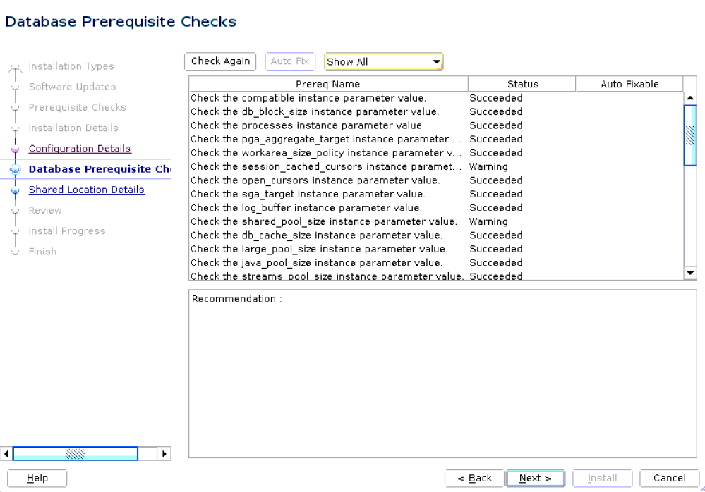

  15. Check Database Prerequisites.
    On the Database Prerequisites Checks screen review the results and check the prerequisites with status Failed.
    • If the Auto Fixable column is Yes, you can click on Auto Fix and the installer will fix the issue automatically.
    • If the Correction Type is Manual, you need to fix the issue manually.
  16. Click Next.

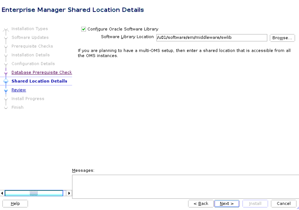

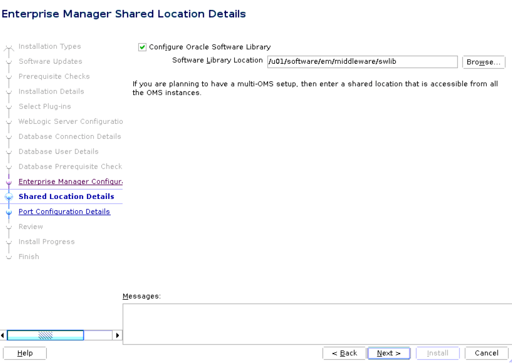

  17. Configure Shared Locations.
    Shared Locations Details Screen
    When you invoke the installer on Microsoft Windows, the Enterprise Manager Shared Location Details screen does not show the Config Volume and Cluster Volume options. This is an expected behavior.
    On the Enterprise Manager Shared Location Details screen, do the following:
    1. (Optional) Configure Oracle Software Library.
      Oracle Software Library (Software Library) is a feature within Enterprise Manager that acts as a repository to store software entities such as software patches, virtual appliance images, reference gold images, application software, and their associated directive scripts. You require the Software Library for operations such as provisioning, patching, and so on.
      Select Configure Oracle Software Library, and enter the absolute path leading up to a unique directory name. By default, the storage location that is configured is the OMS Shared File System location, so Oracle strongly recommends that the location you enter is a mounted location on the OMS host. This helps when you install additional OMS instances that can use the same mounted Software Library location.
      Software Library supports two types of storage locations, mainly OMS Shared File System location and OMS Agent File System location. To understand these storage locations, see Upload File Locations in the Oracle Enterprise Manager Administrator's Guide.
      For some reason, if you are unable to configure an OMS Shared File System location, then configure an OMS Agent Storage location. For instructions, see the section on configuring an OMS Agent file system location in Configuring an OMS Agent File system Location in the Oracle Enterprise Manager Administrator's Guide.
      • Configuring the Software Library at the time of installation is optional. Even if you do not select this option and configure it now, your installation will succeed. You always have the option of configuring the Software Library later using the Initial Setup Console or the Software Library Administration Console (available within the Enterprise Manager Console). However, Oracle strongly recommends that you select this option and configure it at the time of installation so that the installer can automatically configure it for you. This saves time and effort, and enables you to install an additional OMS, immediately after the first OMS, and configure it to use the same Software Library location.
      • Once the Software Library is configured, you can view the location details in the Software Library Administration Console. To access this console, from the Setup menu, select Provisioning and Patching, then select Software Library.
  18. Click Next.

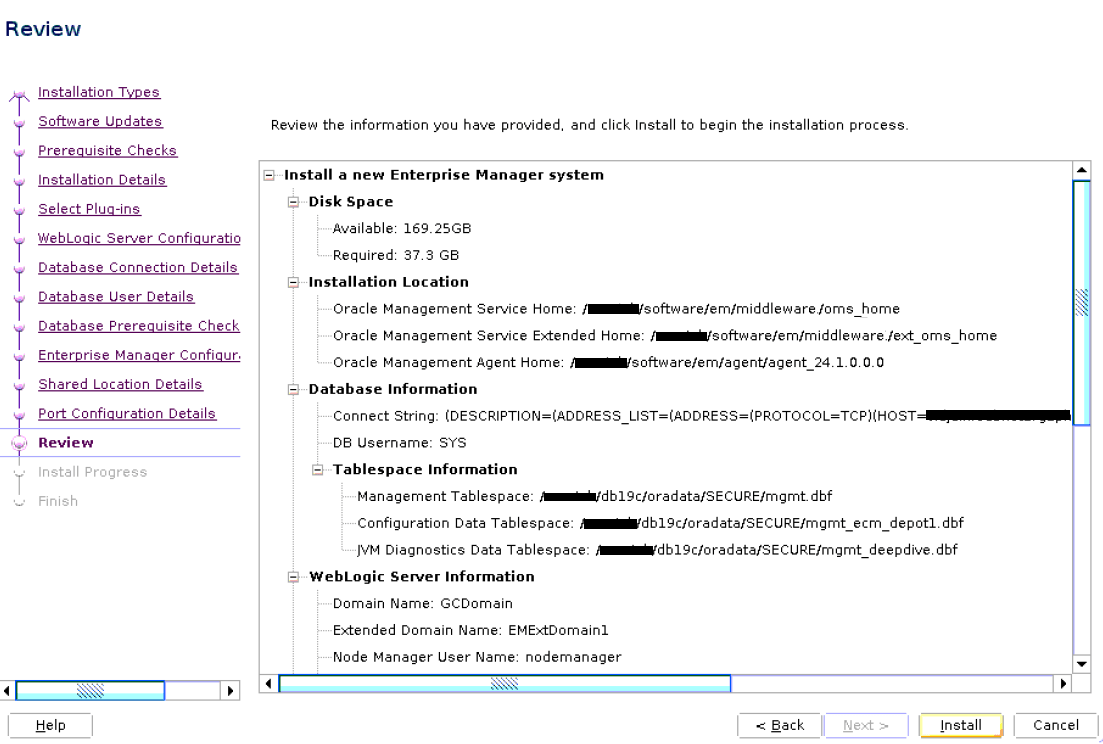

  19. Review and Install.
    Figure 5-6 Review
    Review Screen for Simple Install
    On the Review screen, review the details you provided for the selected installation type.
    • If you want to change the details, click Back repeatedly until you reach the screen where you want to make the changes.
    • After you verify the details, if you are satisfied, click Install to begin the installation process.
    Figure 5-7 Installation Types
    Installation Types Screen for Advanced Installation
    On the Installation Types screen, select Create a new Enterprise Manager system, then select Advanced Install.
  4. Click Next.
    Despite providing the My Oracle Support credentials, if you are unable to download the software updates, then exit the installer, and invoke the installer again passing the -showProxy parameter in the following way:
    Prerequisites Checks Screen for Advanced Installation
    You can choose to ignore the checks with Warning status by clicking Ignore. However, all package requirements must be met or fixed before proceeding any further.
  10. Click Next.
    Installation Details Screen for Advanced Installation
    1. Enter the Middleware home where you want to install the OMS and other core components. This is essentially the Oracle home.
      • The Enterprise Manager Installation Wizard installs Oracle WebLogic Server 12c Release 2 (12.2.1.4.0) and JDK 1.8.0_431 by default in this middleware home directory you enter here. A preinstalled JDK or Oracle WebLogic Server is not supported from 13c Release 1 onwards.
    2. Enter the absolute path to the agent base directory, a location outside the middleware home where the Management Agent can be installed. For example, if the middleware home is /u01/software/em/middleware, then you can specify the agent base directory as /u01/software/em/agentbasedir.
      Ensure that this location is empty and has write permission. Also ensure that it is always maintained outside the Oracle Middleware home.
      The host name must resolve to the local host or virtual host because the host name is used for the local Oracle WebLogic Server as well as the Oracle Management Service. Do not provide a remote host or a load balancer virtual host in this field. Do not enter an IP address. Do not use underscores in the name. Short names are allowed, but you will see a warning, so Oracle recommends that you enter a fully qualified domain name instead.

  15. Enter WebLogic Server Configuration Details.
    WebLogic Server Configuration Details Screen for Advanced Installation
    On the WebLogic Server Configuration Details screen, enter the information for the GCDomain WebLogic domain.
    Enter the credentials for the WebLogic Server user account and the Node Manager user account, and validate the path to the Oracle Management Service instance base location. By default, the WebLogic user name is weblogic. You can modify it if preferred.
    • The password should contain at least 8 characters without any spaces, start with a letter, and include at least one numeric value.
    • Ensure the Oracle Management Service (OMS) instance base location is outside the middleware home.
    • If you are installing on an NFS-mounted drive and creating the OMS instance base directory (gc_inst) on that NFS-mounted drive, then after you install, move the lock files from the NFS-mounted drive to a local file system location. Modify the lock file location in the httpd.conf file to map to a location on a local file system. For instructions, see Performing Postinstallation Tasks After Installing an Enterprise Manager System.
    By default, the WebLogic Domain name is GCDomain, and the Node Manager name is nodemanager. These are non-editable fields. The installer uses this information for creating Oracle WebLogic domain and other associated components such as the admin server, managed server, and node manager. A node manager enables you to start, shut down, or restart an Oracle WebLogic Server instance remotely, and is recommended for applications with high availability requirements.
    On Microsoft Windows, a Node Manager service is NOT created. This is an expected behavior.
  16. Click Next.
  17. Enter Database Connection Details.
    Database Connection Details Screen for Advanced Installation
    On the Database Connection Details screen, do the following:
    1. Provide details of the existing, certified database where the Management Repository needs to be created including the SYS database user password.
      • The database connection details in this step apply to on-premises OMR databases. For ATP-S OMR databases, use the Software Only installation and ConfigureGC flow. In that flow, the connection details are derived from the ATP-S wallet. For more information, see Using ATP-S as the Oracle Management Repository in the Enterprise Manager Advanced Installation and Configuration Guide.
      • If you connect to a database instance that was created using the database template offered by Oracle, then note that the password assigned to the user accounts SYSMAN_MDS, SYSMAN_APM, and SYSMAN122140_OPSS, which were created while preconfiguring the Management Repository, are automatically reset with the SYSMAN password you enter on the Enterprise Manager Configuration Details screen.
        Starting with Enterprise Manager 13c Release 4, SYSMAN_OPSS user no longer exists. It has been replaced by SYSMAN<WebLogic_Server_Version>, in this case SYSMAN122140_OPSS user.
      • For more information on creating a database instance with Preconfigured Repository using database templates for CDB and PDB, refer Creating a Database Instance with Preconfigured Repository Using Database Templates for CDB and PDB.
    2. Select the deployment size from the Deployment Size list to indicate the number of targets you plan to monitor, the number of Management Agents you plan to have, and the number of concurrent user sessions you plan to have.
      Table 5-5 describes each deployment size.
      Table 5-5 Deployment Size
      Deployment Size Targets Count Management Agents Count Concurrent User Session Count
      Small
      Up to 999
      Up to 99
      Up to 10
      Medium
      Between 1000 and 9999
      Between 100 and 999
      Between 10 and 24
      Large
      10,000 or more
      1000 or more
      Between 25 and 50
      If the database you are connecting to is a database instance created with a preconfigured Management Repository using the database templates offered by Oracle (as described in Creating a Database Instance with Preconfigured Repository Using Database Templates), then make sure the deployment size you select on this screen matches with the deployment size you selected in the Oracle Database Configuration Assistant (DBCA) while creating the database instance.
      If you want to select a deployment size different from the deployment size you had selected while creating the database instance using DBCA, then do one of the following:
      For more information on deployment sizes, the prerequisite checks that are run, the database parameters that are set, and how you can modify the deployment size after installation, see What is a Deployment Size for Enterprise Manager in an Advanced Configuration? in the Oracle Enterprise Manager Advanced Installation and Configuration Guide.
    3. (Optional) Check the Select to provide Database SSL Configuration Details (One-way SSL) checkbox if the database is one-way SSL configured. The truststore details are required for one-way SSL configuration.
      Provide the database truststore file and password.
    4. (Optional) Check the Select to provide Database SSL Configuration Details (Two-way SSL) checkbox if the database is two-way SSL configured. The keystore details are required for two-way SSL configuration.
      Provide the database keystore file and password.

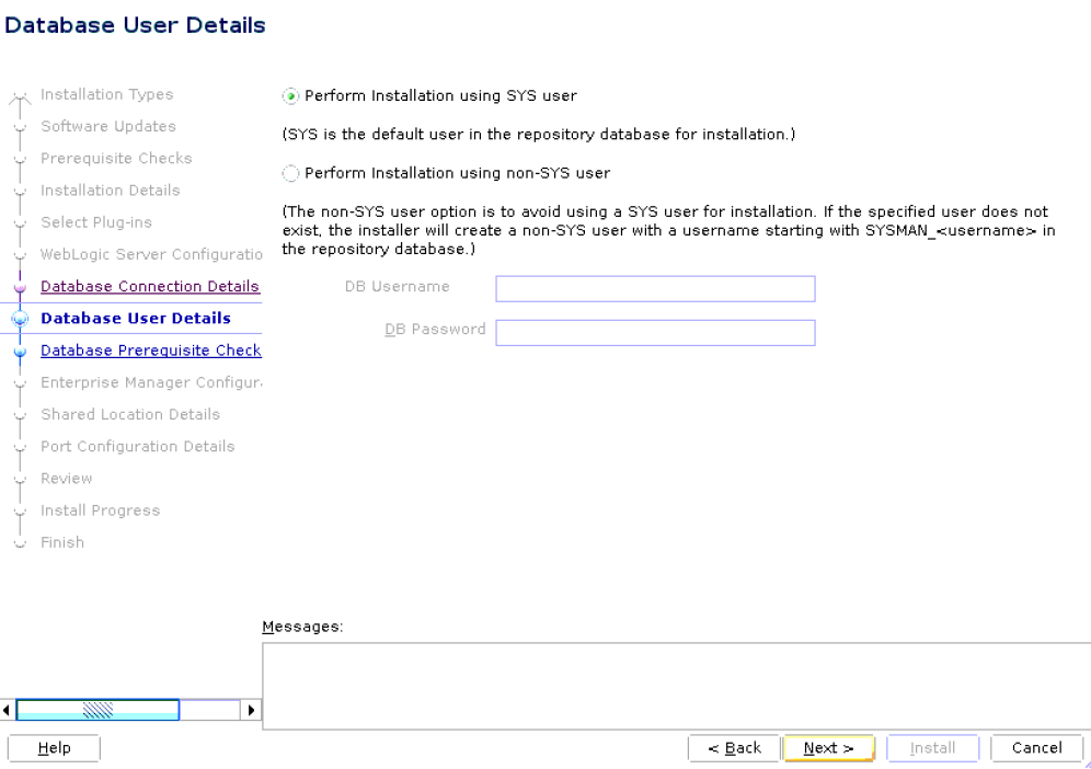

  19. Enter Database User Details
    On the Database User Details screen, select if you want to perform the installation using SYS or non-SYS database user.
    SYS is the default user in the Repository database.
    A non-SYS user is a less privileged administrator user of the Repository database that still allows you to perform Enterprise Manager administration tasks.
    If the Perform Installation using non-SYS user is selected, you need to provide the database user name and password for the non-SYS user. The non-SYS user name should have the SYSMAN_ prefix as part of user name. For example, you can enter SYSMAN_ADMIN under DB Username. If the user doesn't exist, the Enterprise Manager installer creates the new user in the Repository database.

  20. Check Database Prerequisites.
    On the Database Prerequisites Checks screen, check the status of the database prerequisites.
    Review the results and check the prerequisites with status Failed.
  21. Click Next.
  22. Enter Enterprise Manager Configuration Details.
    Enterprise Manager Configuration Details Screen for Advanced Installation
    On the Enterprise Manager Configuration Details screen, do the following:
    1. For SYSMAN Password, enter a password for creating the SYSMAN user account. The SYSMAN user account is used for creating the SYSMAN schema, which holds most of the relational data used in managing Enterprise Manager. SYSMAN is also the super administrator for Enterprise Manager.
      • The SYSMAN account password must begin with a letter. It can only contain uppercase or lowercase letters, numbers and the following special characters: $, #, _
      • If you connect to a database instance that was created using the database template offered by Oracle, then note that the password assigned to the user accounts SYSMAN_MDS, SYSMAN_APM, and SYSMAN122140_OPSS, which were created while preconfiguring the Management Repository, are automatically reset with the SYSMAN password you enter on this screen.
    2. For Registration Password, enter a password for registering the new Management Agents that join the Enterprise Manager system.
      Ensure that your password contains at least 8 characters without any spaces, begins with a letter, and includes at least one numeric value.
    3. For Management Tablespace, enter the full path to the location where the data file for management tablespace (mgmt.dbf) can be stored. The installer uses this information for storing data about the monitored targets, their metrics, and so on. Ensure that the specified path leads up to the file name.
      For example, /u01/oracle/prod/oradata/mgmt.dbf
      If the database is on Oracle Automatic Storage Management (Oracle ASM), then the path must look like: +<disk_group>/<sid>/<subdir_path_if_any>/<datafilename>.dbf.
      For example, +DATA/oemrsp01d/datafile/mgmt.dbf
    4. For Configuration Data Tablespace, enter the full path to the location where the data file for configuration data tablespace (mgmt_ecm_depot1.dbf) can be stored. This is required for storing configuration information collected from the monitored targets. Ensure that the specified path leads up to the file name.
      For example, /u01/oracle/prod/oradata/mgmt_ecm_depot1.dbf
      For example, +DATA/oemrsp01d/datafile/mgmt_ecm_depot1.dbf
    5. For JVM Diagnostics Data Tablespace, enter the full path to a location where the data file for JVM Diagnostics data tablespace (mgmt_deepdive.dbf) can be stored. Ensure that the specified path leads up to the file name. Enterprise Manager requires this data file to store monitoring data related to JVM Diagnostics and Application Dependency Performance (ADP).
      For example, /u01/oracle/prod/oradata/mgmt_deepdive.dbf.
      For example, +DATA/oemrsp01d/datafile/mgmt_deepdive.dbf.

  24. Configure Shared Locations.
    Shared Locations Details Screen for Advanced Installation
    1. Configure Oracle Software Library. Oracle Software Library (Software Library) is a feature within Enterprise Manager that acts as a repository to store software entities such as software patches, virtual appliance images, reference gold images, application software, and their associated directive scripts. You require the Software Library for operations such as provisioning, patching, and others.
      Check the Configure Oracle Software Library. and enter the absolute path to a unique directory name under the Software Library Location. By default, the storage location that is configured is the OMS Shared File System location, therefore Oracle strongly recommends that the location you enter is a mounted location on the OMS host. This helps when you install additional OMS instances that can use the same mounted Software Library location.
  25. Click Next.
  26. Customize Ports.
    Figure 5-8 Port Configuration Details
    Port Configuration Details Screen for Advanced Installation
    On the Port Configuration Details screen, customize the ports to be used for various components.
    If all the ports on this screen appear as -1, then it indicates that the installer is unable to bind the ports on the host. To resolve this issue, exit the installer, verify the host name and the IP configuration of this host (ensure that the IP address of the host is not being used by another host), restart the installer, and try again.
    You can enter a free custom port that is either within or outside the port range recommended by Oracle. For more information, see What Ports Are Used for Installation? in the Oracle Enterprise Manager Advanced Installation and Configuration Guide.
    • On Unix:
    However, the custom port must be greater than 1024 and lesser than 65535. Alternatively, if you already have the ports predefined in a staticports.ini file and if you want to use those ports, then click Import staticports.ini file and select the file.
    If the staticports.ini file is passed during installation, then by default, the ports defined in the staticports.ini file are displayed. Otherwise, the first available port from the recommended range is displayed.
    The staticports.ini file is available in the following location:
    <Software_Extracted_Location>/response

  28. Review and Install.
    Review Screen for Advanced Installation
