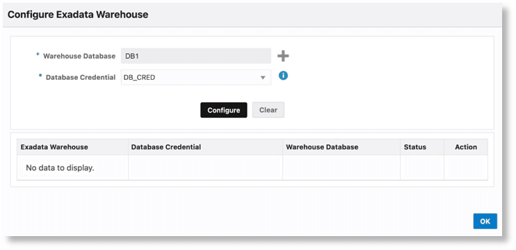

Set Up Exadata Warehouse
You can set up Exadata Warehouse by selecting a database, creating an analytics user and named credential, and then configuring it in Enterprise Manager.
The database that hosts Exadata Warehouse can be an on-premises database or an Autonomous AI Database and should be version 19c or later. A database hosted on Exadata provides greater space efficiency through Hybrid Columnar Compression. Ensure that the Database plug-in is deployed on all the agents monitoring the Database Machine.
To set up Exadata Warehouse:
  1. Identify a database monitored by Enterprise Manager to serve as Exadata Warehouse.
    Exadata Warehouse supports all database types, including on-premises databases and Autonomous AI Databases.
  2. Create an analytics user schema on the selected database by running the appropriate script in SQL Manager.
    • If Exadata Warehouse is hosted on an Autonomous AI Database, use the analytics-user script given below:

    1. Log in to Enterprise Manager as a Super Administrator user.
    2. From the Setup menu, select Cloud Bridge.
      The Cloud Bridge page opens and is initially empty. For information on creating a Cloud Bridge, see Integrating Enterprise Manager with OCI Services in Oracle Enterprise Manager Administrator's Guide .
    3. Click Configure Exadata Warehouse.
    4. In the Configure Exadata Warehouse dialog box, select the Warehouse Database, specify the corresponding Database Credential, click Configure to create the Exadata Warehouse service, and then click OK to return to the Cloud Bridge page.
    5. On the Cloud Bridge page, click Enable Data Export.
    6. In the OCI Service Data Export dialog box, select Exadata Warehouse in the OCI Service field, select the target group containing the Database Machine targets in the Source field, select the OCI bridge, and then click Submit.
      Data export is enabled and data from the Enterprise Manager instance starts uploading to the specified OCI bucket.
