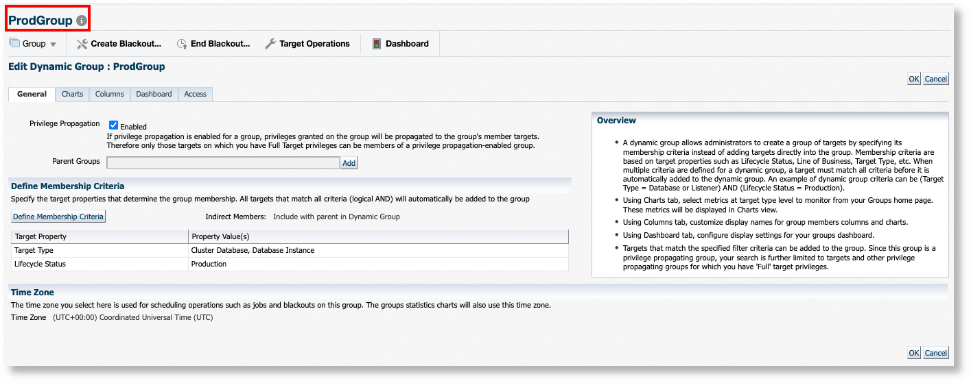

Group Membership Criteria:
The following image shows the group ProdGroup, a dynamic group which contains all cluster databases or single-instance databases that have their Lifecycle Status set to Production.

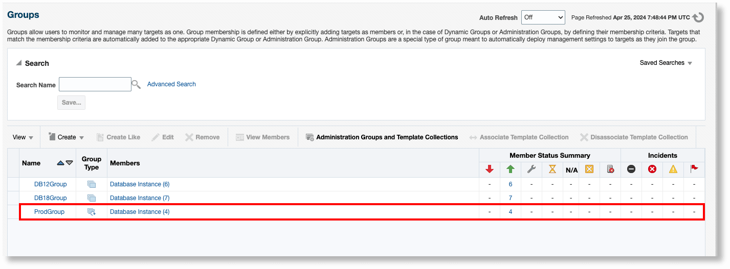

Group Members:
The following image shows that ProdGroup currently has 4 database members:
