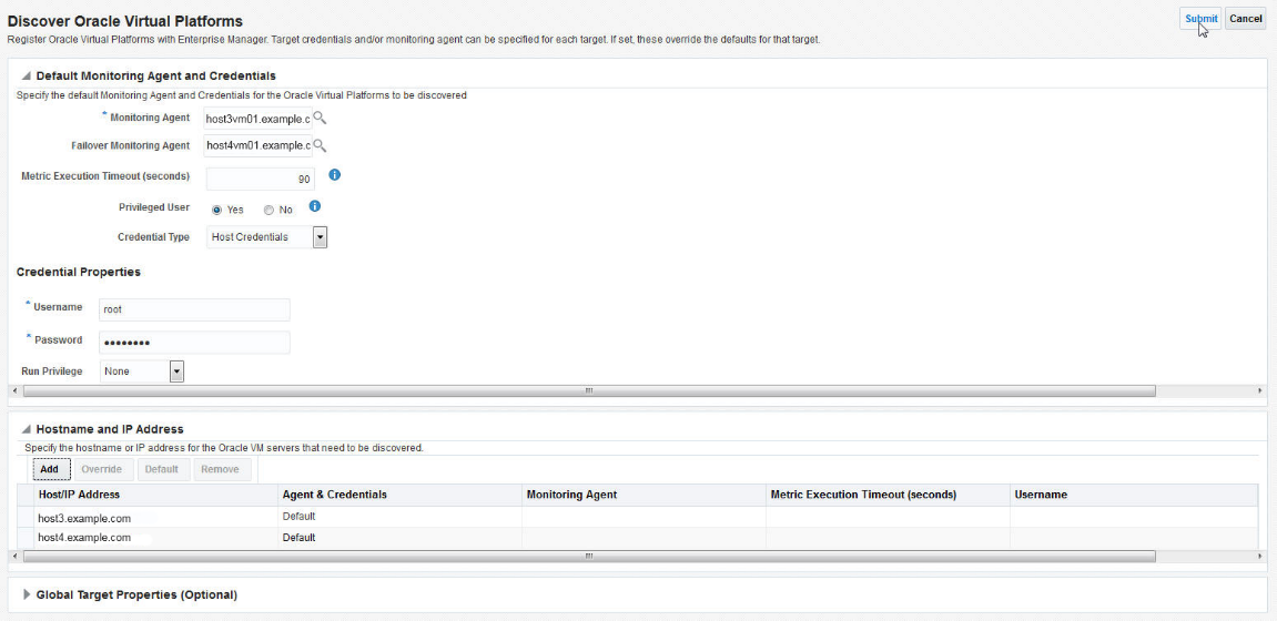

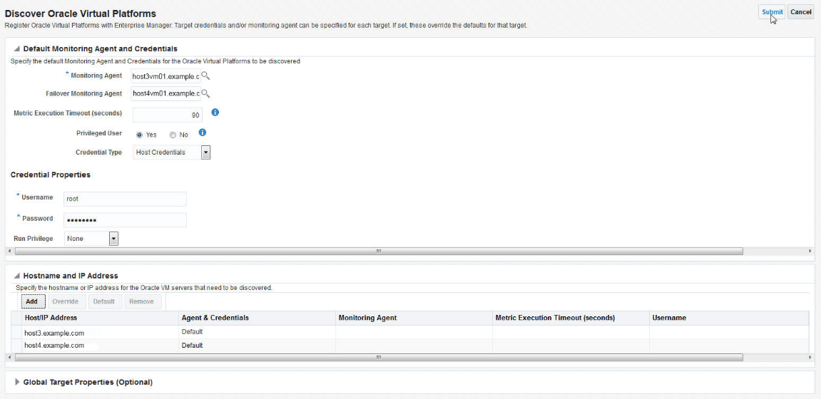

  4. On the Discover Oracle Virtual Platforms screen, do the following:
    1. Select the agent installed on the first compute node domU (virtual machine) for the Monitoring Agent and select the second compute node domU (virtual machine) agent for the Failover Monitoring Agent.
    2. For the Credential Properties, enter the user name for the root or non-root user and provide the password.
    3. In the Hostname and IP Address section, click on the Add button and type in the fully qualified hostname for the dom0 servers (one per line) and click Add.
    4. Click Submit.

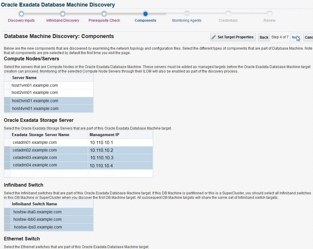

  8. On the Components page, the components below are pre-selected. You can deselect any unwanted component. Components include, but are not limited to, the following:
    • Compute Node: Select the hosts that are compute nodes in the Oracle Exadata Database Machine.
    • Oracle Exadata Storage Server: Select the Oracle Exadata Storage Servers that are part of this Oracle Exadata Database Machine target.
    • InfiniBand Switch: Displayed if this is an IB Oracle Exadata. Select the InfiniBand Switches that are part of the Oracle Exadata Database Machine. These also will be added as managed targets.
    • Ethernet Switch: Select the Ethernet switches that are part of the Oracle Exadata Database Machine. If this is an IB Oracle Exadata, select the admin switch. If this is Oracle Exadata X8M, select the admin and RoCE switches. The Ethernet switches will be added as managed targets.
    • Compute Node ILOM: Select the Integrated Lights Out Managers (ILOMs) of the compute nodes that are part of this Oracle Exadata Database Machine. These ILOMs will be added as managed targets.
    A partitioned rack can list other components that should be deselected manually (for example, compute nodes).

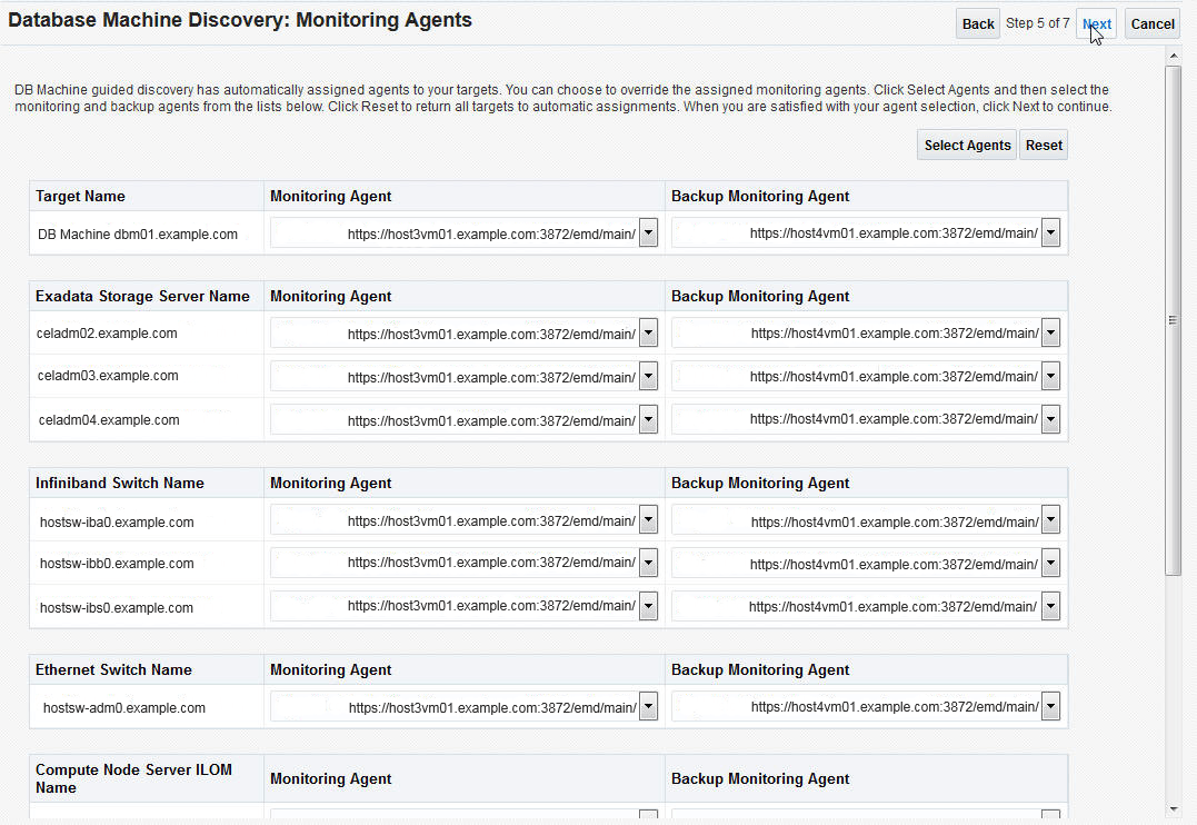

  9. By default, the agents are automatically assigned to the targets. To add more monitoring agents:
    In the Monitoring Agents page, click Select Agents > in the pop-up window, select the required agents for each target on the Exadata Database Machine. Use the Ctrl key to select multiple agents.
    A Warning will be thrown if only one agent is used as monitoring and backup agents. Click Select Agents and add more agents, if available.

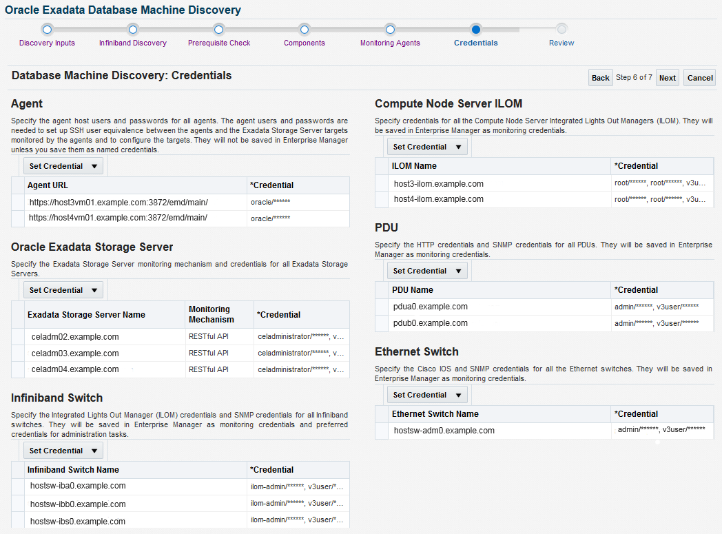

  10. On the Credentials page, set the credentials for all components within the Oracle Exadata Database Machine (for example, the Storage Server, PDU, InfiniBand Switch, and so forth). Click Set Credential to set the credential for the component. If the users and passwords are the same for all components of the type, choose Same for all and enter the user and password combination.
    • Depending on the component, you may need to provide additional information. For example, in the Oracle Exadata Storage Server Credentials window, you must enter the SNMP Credentials as well as the monitoring Credentials.

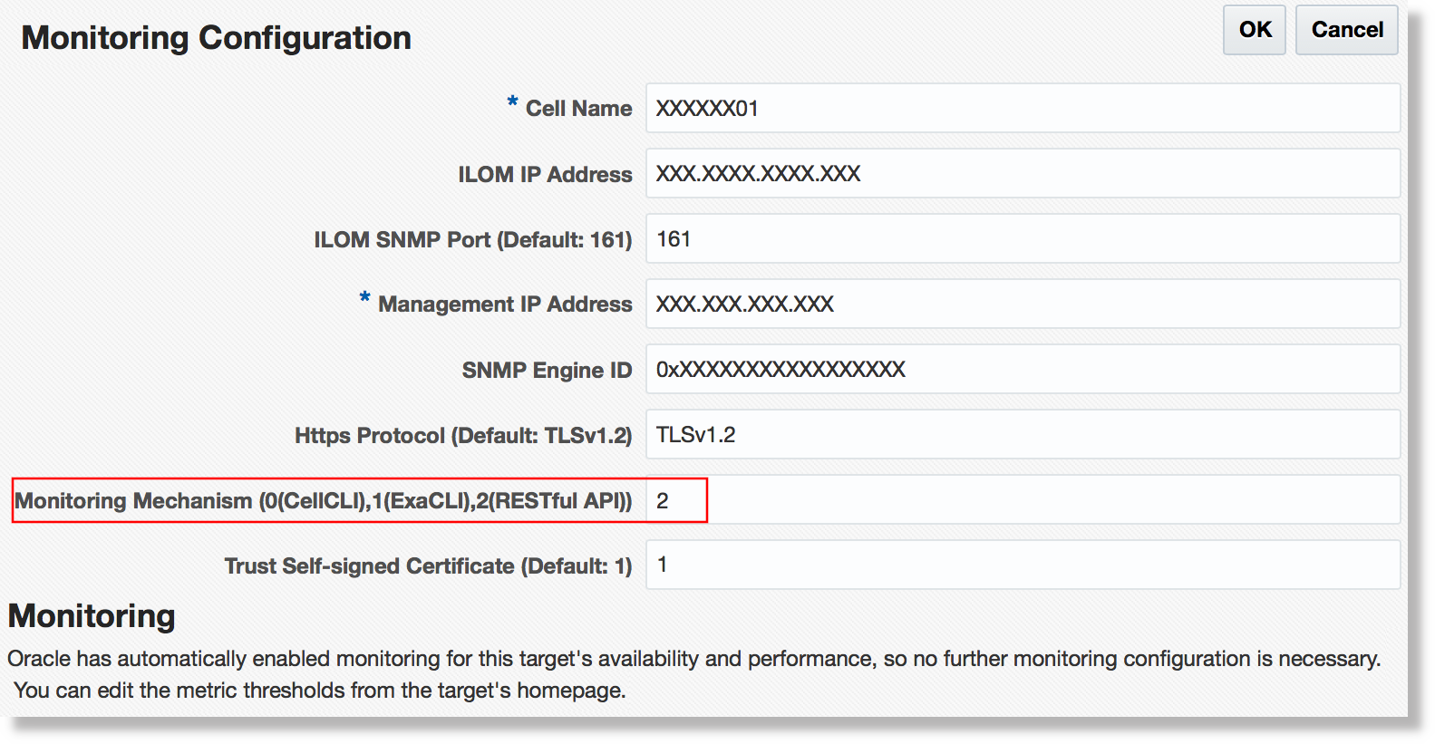

    • The recommended monitoring mechanism for the Oracle Exadata Storage Servers is RESTful API. An ExaCLI user is required to use the RESTful API. For details on how to create the necessary ExaCLI user, refer to Creating Users for Use with ExaCLI in Oracle Exadata Database Machine Maintenance Guide.
    • SNMP subscriptions are required for EM to receive alerts for hardware and software failures from Exadata components. Each component credential screen provides fields for SNMP configuration. The recommendation for SNMP subscriptions is to use SNMP v3 for all subscriptions. For IPv6 environments, only SNMPV3 credentials are supported.
    • The SNMP community string is like a password. It is sent along with each SNMP Get-Request, and allows or denies access to the device. Please check with your network administrator to get the appropriate community string details for your environment.
    • For the Compute Node Server ILOM Credentials, you can additionally specify the named credentials for monitoring using RESTful API. Click Test Connection to verify the proper working of the SSH and RESTful API credentials. The ILOM version for REST monitoring must be 5.0.1 or higher. Also, for REST monitoring, ensure to use the latest Exadata plug-in release update on the agent side.
      You can create a Compute node REST credential to promote ILOM REST access point by navigating in the Enterprise Manager as follows: Click Setup in the Enterprise Manager home > Click Security > Click Named Credential > Enter the details for the REST credentials.
    The table below provides sample guidance on the recommended values for the credentials.
    Table 3-1 Credential Details
    Component Credential Monitoring Mechanism SNMP Subscription Notes
    Agent oracle (or the user who owns the agent installation) . . .
    Oracle Exadata Storage Server celladministrator RESTful API SNMP V3 .
    Infiniband Switch root / ilom-admin . SNMP V3 This component will not be present when discovering RoCE based systems
    Compute Node Server ILOM root SSH / Enhanced monitoring using RESTful API SNMP V3 In case of enhanced ILOM monitoring using RESTful API, both root and admin user credentials are supported.
    PDU admin . SNMP V3 .
    Ethernet Switch admin . SNMP V3 In a RoCE based system, these credentials will be used for the Management switch discovery as well as the RoCE switch discovery. If the passwords are different between the Management and RoCE switches, passwords can be specified by switch.

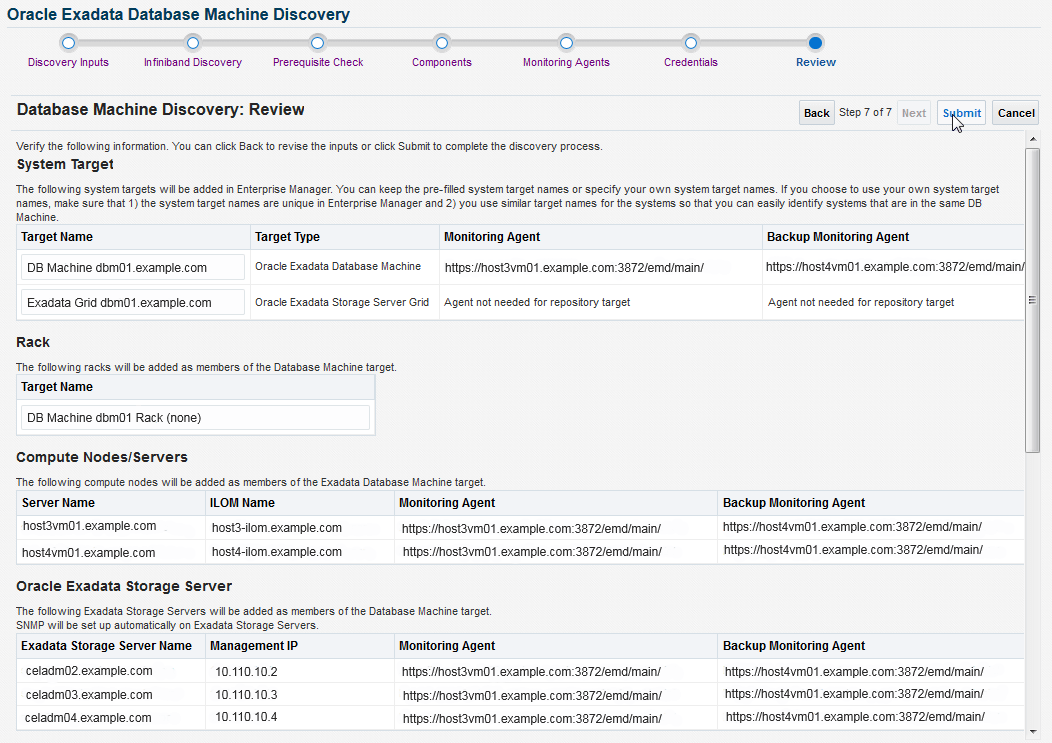

  11. On the Review page, verify each section is correct. The following figure shows an example of an accurate review.
    Database Machine Discovery: Review
    Click Submit.

Update the Monitoring Configuration Using Console
For each Exadata Storage Server, provide the RESTful API monitoring credentials in the monitoring configuration.
  1. From the Exadata Storage Server menu, select Target Setup, then select Monitoring Configuration.
    The Monitoring Configuration dialog box opens.
  2. Set the value of Monitoring Mechanism to:
    • 1 for ExaCLI
    • 2 for RESTful API
  3. Set Trust Self-signed Certificate to 1.
    Monitoring Configuration: Set to Monitor Using ExaCLI or RESTful API
    Click OK.
