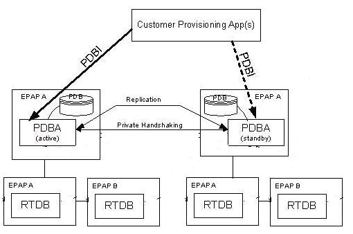

Figure 6-1 EPAP Standalone PDB Architecture
img/t-epap-standlone-pdb-architecture.jpg
With this new functionality, the EPAP has the following architectures:
  1. Standalone PDB - PDB only sites
  2. Mixed EPAP - PDB and RTDB
  3. Non-Provisionable EPAP - RTDB only sites

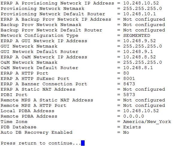

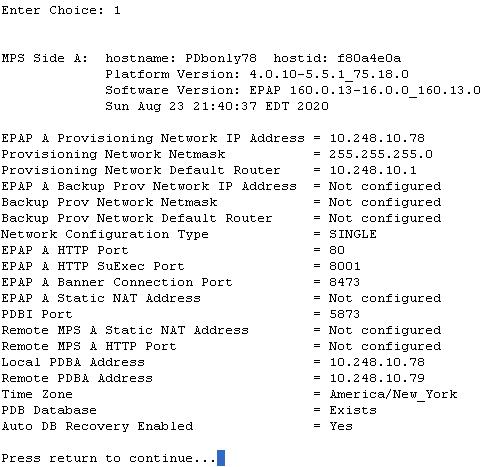

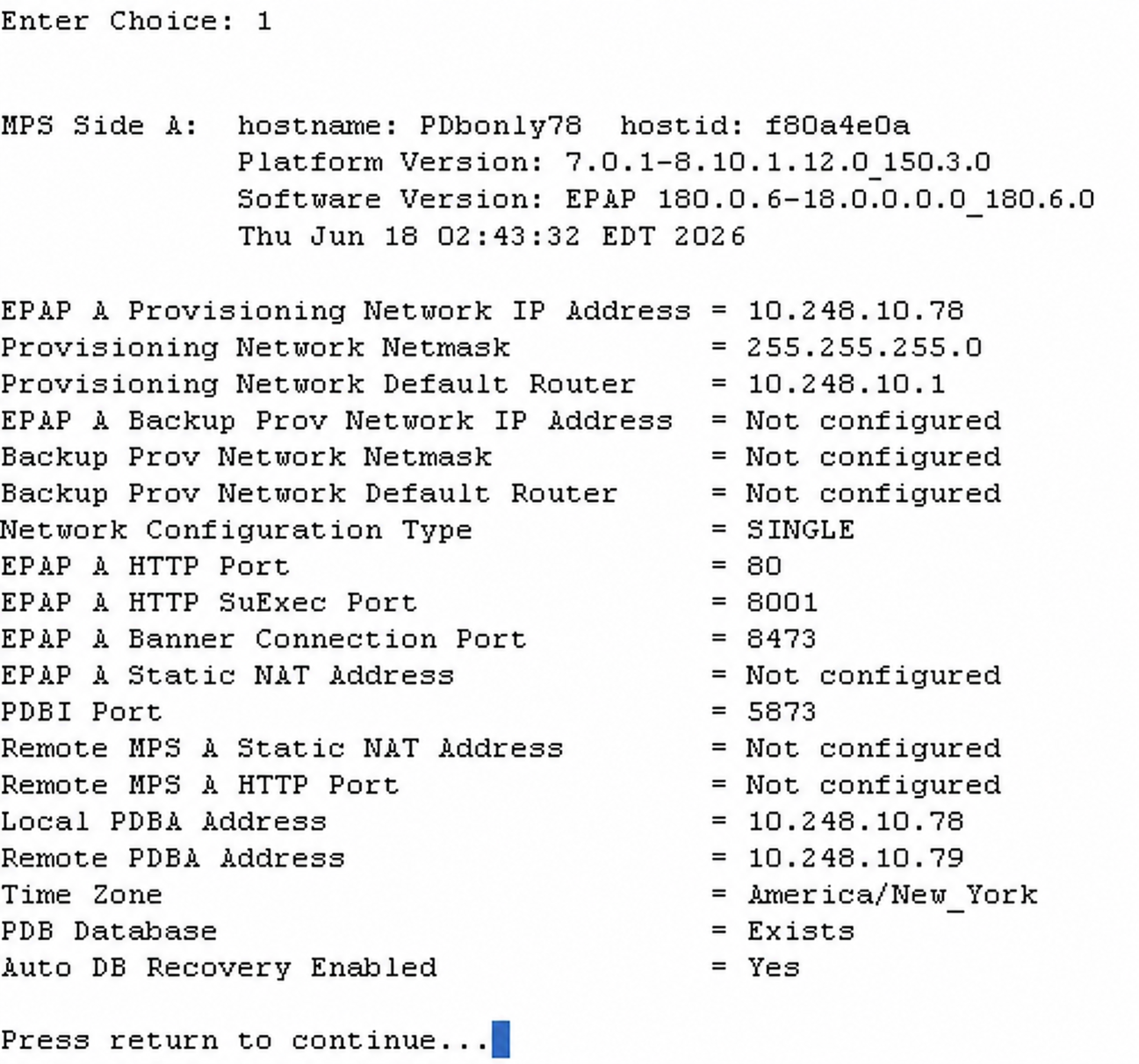

The display configuration menu option 1, displays the EPAP configuration. On standalone PDB site, only the configuration related to EPAP A and PDB are displayed, as shown in Figure 6-3.
Please note that the parameter values displayed in the below figure are just examples. The values depend on the site configuration.
Figure 6-3 Single Network Configuration Display
img/t-epap-standlone-pdb-single-network-config1.jpg
Figure 6-4 Segmented Network Configuration Display
img/t-epap-standlone-pdb-segmented-network-config1.jpg

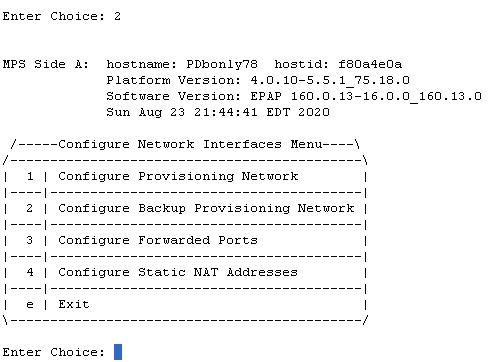

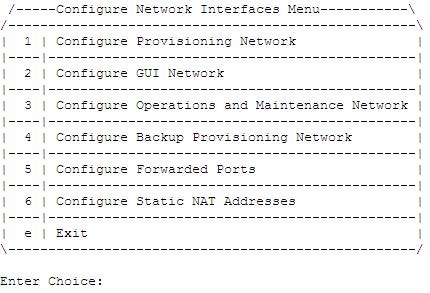

Configure Network Interfaces Menu
The network interfaces configuration menu Option 2, does not provide the option to configure the DSM and sync interfaces because of the non-requirement of eagle and EPAP B (mate) connectivity, respectively. The menus for PDBA proxy are also be removed. The displayed menu options are dependent on the configured Network Configuration Type.
Figure 6-5 Single Network Interface Menu
img/t-epap-standlone-pdb-single-network-interface-menu.jpg
For the segmented configuration, the menu allows the user to configure all the interfaces separately. The IP version on the interfaces shall be independent of each other. This means that the user is able to configure any interface in the IPv4 only, IPv6 only or dual stack configuration.
Figure 6-6 Segmented Network Interface Menu
img/t-epap-standlone-pdb-segmented-network-interface-menu.jpg

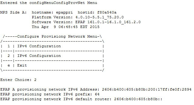

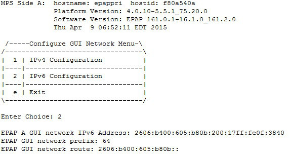

For each menu selection, except Static NAT Addresses, the user must select whether the input is an IPv4 or IPv6 address. The Provisioning, GUI, Backup Provisioning and Operations and Maintenance Network configuration is configured the same way for a mixed EPAP.
Configure Provisioning Network Menu
The 'Configure provisioning network' menu configures the EPAP provisioning network for the standalone PDB site. Unlike the standard EPAP site, the user is not prompted for EPAP B (mate) parameters. On the standalone PDB site, the provisioning IP configured through this menu is used for the following operations: PDBI sockets, File imports for provisioning, Replication to the standby PDB and PDBA clients (RTDB).

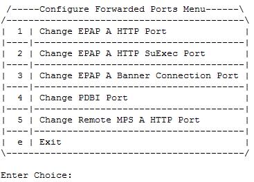

Configure Forwarded Ports Menu
The Configure Forwarded Ports menu provides the functionality to configure the standalone PDB ports for the Web UI on EPAP A.
Figure 6-10 Forwarded Ports Configuration Menu
img/t-epap-standlone-pdb-configure-forwarded-ports-menu.jpg

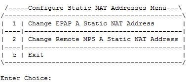

Configure Static NAT Addresses Menu
The Configure Static NAT Addresses menu provides the functionality to configure the static NAT addresses of the standalone PDB site. Each of the configured IP Address is used outside of the firewall for remote access to the MPS.
Figure 6-11 Static NAT Addresses Menu
img/t-epap-standlone-pdb-static-nat.jpg

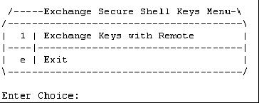

Exchange Secure Shell Keys
The key exchange is facilitated with the remote PDBA server only.
Figure 6-12 Exchange Secure Shell Keys Menu
img/t-epap-standlone-pdb-exchange-secure-shell.jpg

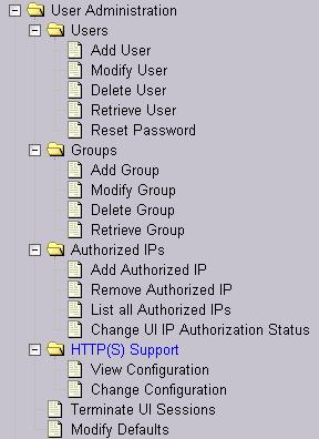

User Administration sub-menu
The User Administration sub-menu remains unchanged.
Figure 6-20 EPAP A User Administration Menu
img/t-epap-standlone-pdb-user-admin-menu.jpg

  5. Choose option 1, Display Configuration.
    This option provides a means of verifying EPAP A Provisioning Network IP address, the Time Zone, and other provisioning values for the MPS on EAGLE A.
    Figure 6-26 Single Network Configuration Menu
    img/t-epap-standlone-pdb-single-network-config.jpg
    Figure 6-27 Segmented Network Configuration Menu
    img/t-epap-standlone-pdb-segmented-network-config.jpg
  6. Press Return to return to the EPAP Configuration Menu.
  7. Choose option 2, Configure Network Interfaces Menu.
    Enter Choice 2:
    MPS Side A:  hostname: PDbonly78  hostid: f80a4e0a
                 Platform Version: 4.0.10-5.5.1_75.18.0
                 Software Version: EPAP 160.0.13-16.0.0_160.13.0
                 Sun Aug 23 10:24:54 EDT 2014
     /-----Configure Network Interfaces Menu----\
    |  1 | Configure Provisioning Network        |
    |  2 | Configure Backup Provisioning Network |
    |  3 | Configure Forwarded Ports             |
    |  4 | Configure Static NAT Addresses        |
    |  e | Exit                                  |
    Enter Choice:
     /-----Configure Network Interfaces Menu-----------\
    |  2 | Configure GUI Network                        |
    |  3 | Configure Operations and Maintenance Network |
    |  4 | Configure Backup Provisioning Network        |
    |  5 | Configure Forwarded Ports                    |
    |  6 | Configure Static NAT Addresses               |
    |  e | Exit                                         |
    Enter choice:
  8. Choose option 1, Configure Provisioning Network.
    The Configure Provisioning Network Menu allows you to accept the default IP address values presented by the configuration software for EPAP A provisioning network and network netmask, or enter a specific IP value previously received from the customer for the MPS.
    127.0.0.1 is not a valid IP address for this operation. 0.0.0.0 is a valid IP address and can be used to reset the VIP/backup provisioning IP address.
    Refer to the information recorded in Table 5-1 through Table 5-4 for the correct addresses.
    No default value is provided for the EPAP provisioning network default router. This value must be received from the customer.
    The display for the submenu for configuring communications networks appears.
    EPAP A provisioning network IP Address [10.248.10.49]:
    EPAP provisioning network netmast [255.255.255.0]:
    EPAP provisioning network default router [10.248.10.1]:
  9. Press the Return to return to the Configure Network Interfaces Menu. Choose 2, Configure GUI Network.
    The Configure GUI Network menu prompts the user for the standalone PDB GUI Network IP addresses. The user is allowed to access the EPAP GUI through the configured IP only. This menu is available only on standalone PDB sites.
    EPAP A GUI network IP Address [192.168.3.10]:
    EPAP GUI network netmast [255.255.255.0]:
    EPAP GUI network route [192.168.3.1]:

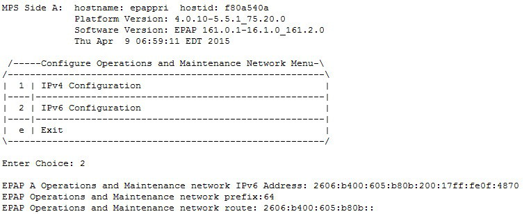

  10. Press Return to return to the Configure Network Interfaces Menu. Choose 3, Configure Operations and Maintenance Network.
    The Configure Operations and Maintenance Network menu prompts the user for the standalone PDB O&M Network IP addresses. The user is allowed to access the EPAP CLI through the configured IP only. This menu is available only on the standalone PDB sites. The IP configured through this menu is used for the SSH operations.
    EPAP A Operations and Maintenance network IP Address [192.168.4.10]:
    EPAP Operations and Maintenance network netmask [255.255.255.0]:
    EPAP Operations and Maintenance network route [192.168.4.1]:

    Unless the MPS is separated from the GUI workstations and provisioning systems by a port forwarding firewall, skip 13 through 16 and proceed to 20, Configure Forwarded Ports.
  13. Choose option 3 or 5 (depending on the Menu displayed by the Network Type Configuration), Configure Forwarded Ports.
     /-----Configure Forwarded Ports Menu------\
    |  1 | Change EPAP A HTTP Port              |
    |  2 | Change EPAP A HTTP SuExec Port       |
    |  3 | Change EPAP A Banner Connection Port |
    |  4 | Change PDBI Port                     |
    |  5 | Change Remote MPS A HTTP Port        |
    |  e | Exit                                 |
    Enter choice:
  14. Enter the correct option number for the port information to be entered.
    Refer to the information recorded in Table 5-1 for the correct information.
  15. Enter the appropriate port information.
    Press return to return to the Configure Forwarded Ports Menu.
    EPAP A HTTP Port [80]:
  16. Enter an option number or enter e to return to the Configure Network Interfaces Menu.

  17. Choose option 6, Configure Static NAT Addresses.
     /-----Configure Static NAT Addresses Menu---\
    |  1 | Change EPAP A Static NAT Address       |
    |  2 | Change Remote MPS A Static NAT Address |
    |  e | Exit                                   |
    Enter Choice:
  18. Enter the appropriate option to configure the Static NAT Address.
    Each numbered item of the Configure Static NAT Addresses Menu allows you to specify an IP Address used outside of the firewall for remote access to the MPS.
  19. Enter a valid NAT IP address from Table 5-1.
    EPAP A Static NAT Address:

    Option 1, ExchangeSecure Shell Keys, is performed automatically by the configuration software at the start of configuration (the configuration software would not have proceeded to this point if the exchange had not been successful). If you do not want to exchange secure shell keys, skip this step and proceed to 28.
  25. Choose option 1 , Exchange Secure shell Keys.
     /-------Exchange Secure Shell Keys Menu-----\
    |  1 | Exchange Keys with Remote              |
    |  e | Exit                                   |
    Enter Choice:
    A prompt appears:
    Are you sure you wish to exchange keys? [N]: y
  26. Enter y.
    You are prompted for a Remote IP Address:
    Temote IP Address:
  27. Enter a valid IP address and Press Return.
    Passord for EPAPdev@<above IP>:
    You are prompted for the password of the remote. Contact My Oracle Support for the password.
    After entering the appropriate password, a verification of the exchange appears and you are returned to the EPAP Configuration menu.
