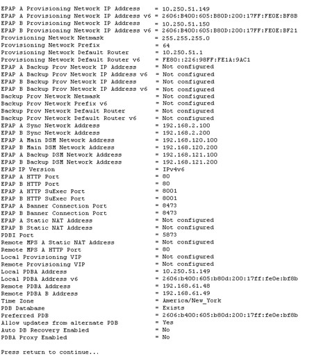

5.2 EPAP Configuration and Initialization
Before beginning to use EPAP for provisioning, the EPAP software must be configured and initialized. The EPAP configuration and initialization is performed through the EPAP text-based user interface.
Connect a local (optional) customer terminal to eth0 (port 0 on GB card 1) on the MPS frame at each EAGLE. Refer to Application B Card Hardware and Installation Guide for additional information. To begin the initialization, log in to EPAP A the first time as the epapconfig user. An automatic configuration is performed on both mated EPAPs.
No other user is able to log in to an EPAP until the configuration step is completed for that system.
All network connections and the mate EPAP must be present and verified to allow the initial configuration to complete successfully.

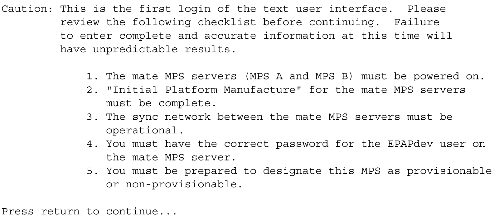

  1. Mate MPS servers (MPS A and MPS B) must be powered on.
  2. “Initial Platform Manufacture” for the mate MPS servers must be complete.
  3. The Sync Network between the mate MPS servers must be operational.
  4. You must have the correct password for the epapdev user on the mate MPS server.
  5. You must be prepared to designate this MPS as provisionable or non-provisionable. (Obtain and record the necessary information in the tables provided in Required Network Address Information. That data is used in the configuration procedure.

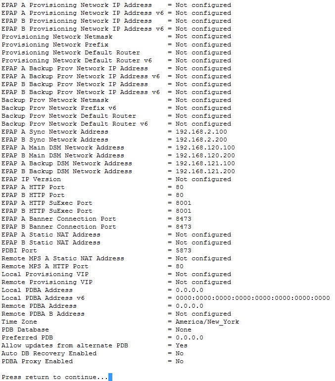

5.2.3 Configuration Menu Conventions

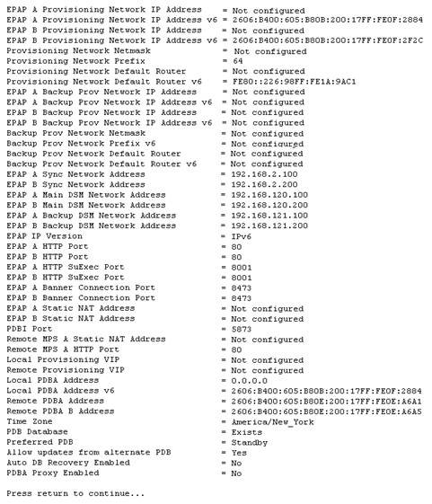

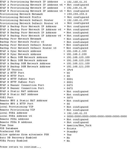

After you have logged into the EPAP user interface with the epapconfig user name, the menu appears that corresponds to that user login name. Before going into the details about the Configuration Menu, you need to know a few things about the Menu Format, Prompts and Default Values, and Error Message Format, which are covered next.
Menu Format
The configuration menu has a header format displaying specific information. On the first line, it indicates the MPS Side A or B, with which you are active. On the same line, you are shown the hostname and hostid. The second and third lines show the Platform Version, followed by the Software Version. The last line displays the date and time. Figure 5-1 shows a sample configuration header format.
Figure 5-1 Configuration Menu Header Format
When you are shown a menu, choose a menu item by entering the number of the item (or e for Exit) in response to the Enter Choice prompt that follows the menu. Press Return to enter your choice.
When you choose a menu item, the user interface performs the requested operation. The operation and any associated output for each menu item are described in detail later in this section.
If you enter an invalid choice (such as a letter or a number that is not available for that menu), an error appears. Perform the corrective action described for that error.

When you log into an EPAP with user name epapconfig after the first initialization of the EPAP, the configuration process begins. See Procedure for Configuring EPAPs. The configuration process lets you change IP addresses, time zone, and password for epapconfig. You can display the host ID and exchange secure shell keys. This section describes each configuration menu item.
Initial epapconfig User Logon
The first time the epapconfig user logs in to the system, the text screen is displayed, as shown in Figure 5-2.
Figure 5-2 Initial Configuration Text Screen
If all five criteria above are not met, the configuration cannot proceed. Ensuring that the MPS servers are powered on requires a visual check. If the Initial Platform Manufacture is not complete, the configuration cannot proceed; the user is also notified if the sync network is not operational.
When the five criteria are met, press Return and the process resumes. Figure 5-3 shows the continuation of the screen information. The installer enters y if the installation is to continue.
Figure 5-3 Initial Configuration Continues

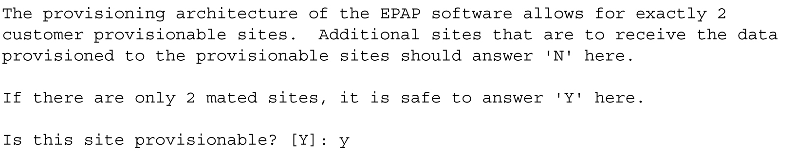

Next, the installer declares the MPS to be provisionable or non-provisionable, as shown in Figure 5-4. The example illustrates this MPS as a provisionable MPS.
Figure 5-4 Designating Provisionable or Non-Provisionable MPS

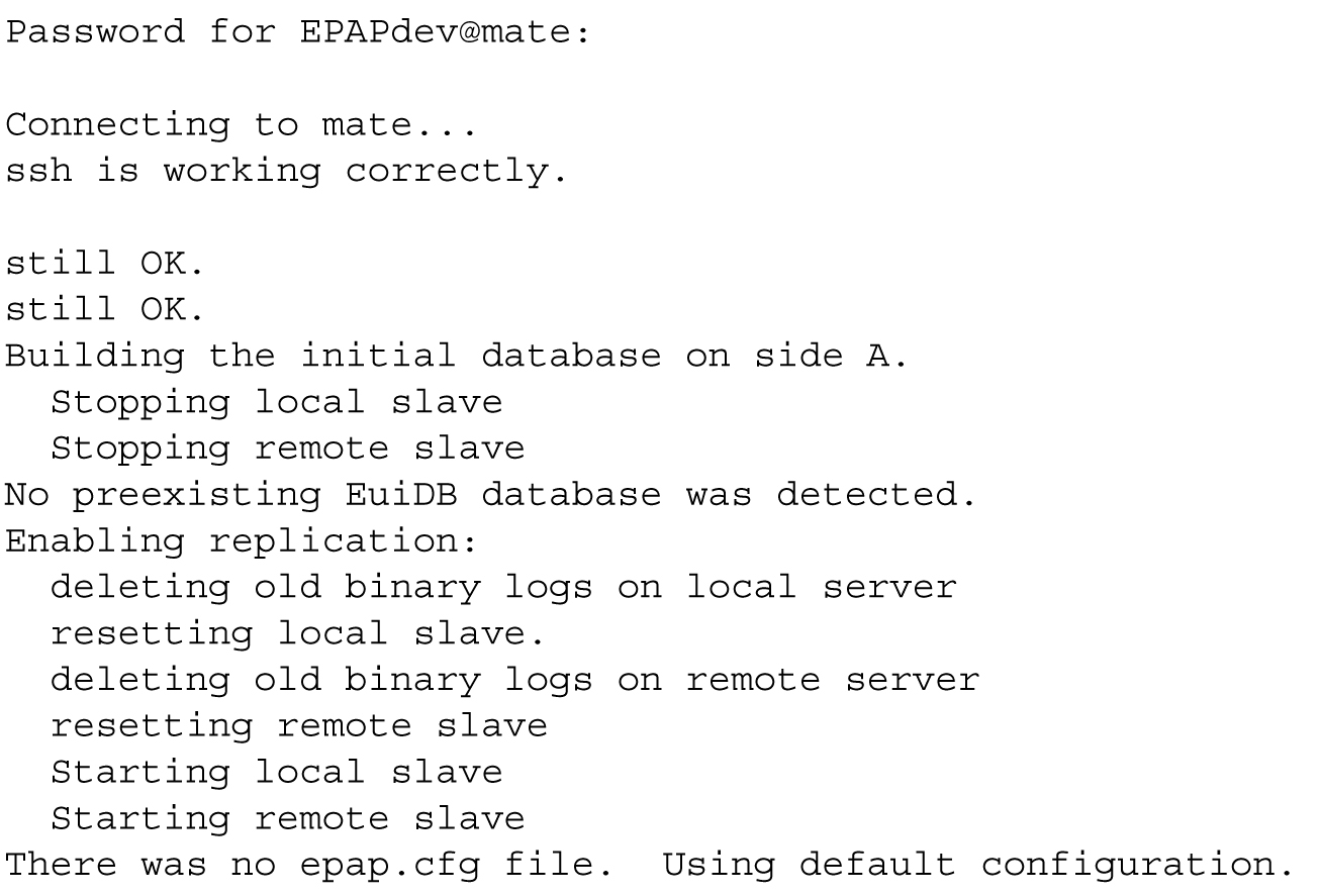

Next, the installer is prompted for the epapdev user password on the mate MPS server. Figure 5-5 shows sample output that is generated after the correct password is entered.
Figure 5-5 Entering the epapdev Password

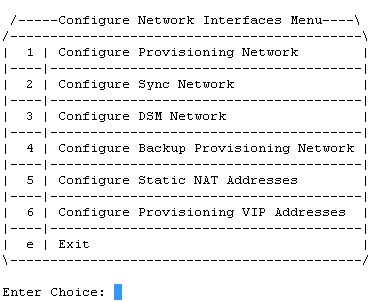

/-----EPAP Configuration Menu----------\
|  1 | Display Configuration             |
|  2 | Configure Network Interfaces Menu |
|  3 | Set Time Zone                     |
The Display Configuration option 1 displays a configuration of the EPAP. The following figure shows an example report:
Figure 5-6 Example of Configuration Report When the EPAP is Not Configured
Addresses that you choose should not conflict with your internal network addresses. The class C networks you choose should not conflict with the class C network used in your network scheme. Table 5-6 shows an example of IP addresses that could be used in the configuration process.
Table 5-6 Sample IP Addresses Used in Configuration

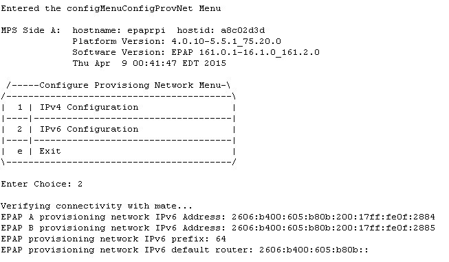

5.3.1 Configure Network Interfaces Menu
The Configure Network Interfaces Menu option 2 of the Configuration Menu displays the submenu shown in Figure 5-7. It supports the configuration of all the network interfaces for the EPAP.
Figure 5-7 Configure Network Interfaces Menu
Configure Provisioning Network
The Configure Provisioning Network option 1 of the Configure Network Interfaces Menu configures the EPAP provisioning network. With EPAP 16.1, the user is able to configure an IP address, net mask, and default router IP address when using an IPv4 address, and an IP address, Prefix and default router when using an IPv6 address. This information allows the EPAP to communicate with an existing customer network.
127.0.0.1 is not a valid IP address for this operation. 0.0.0.0 is a valid IP address and can be used to reset the VIP/backup provisioning IP address.
You must configure these IP addresses. Obtain the values for the IP address, netmask, and default router from the customer’s Information Services department. Record the values in the four tables in Required Network Address Information.
In response to each prompt, you can enter a dotted decimal IP address or press Return to leave the current value unchanged. The current value is shown in brackets after the prompt text. See Figure 5-8 for the option 1 configuration.
Figure 5-8 Configure Provisioning Network Menu
Take care in configuring the IP information. Incorrect information can prevent the EPAP from accepting provisioning data and establishing remote EPAP user interface connections over the customer network.

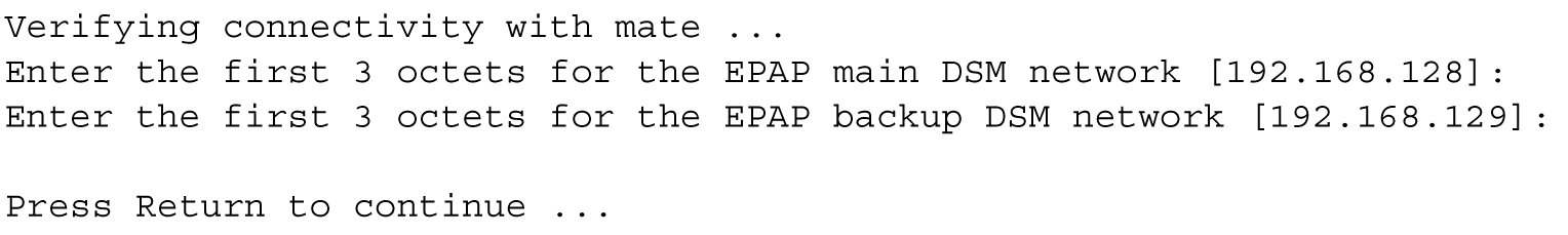

Configure DSM Network
The Configure DSM Network option 3 of the Configure Network Interfaces Menu prompts you for the EPAP DSM network IP addresses. This information allows the EPAP to communicate with the main and backup DSM networks.
Unless there is a known network address conflict, the installer can bypass option 3.
It is strongly advised not to change the DSM network subnet (IP addresses), if not absolutely necessary.
In response to each prompt, you can enter a dotted decimal IP address or press Return to leave the current value unchanged (the current value is shown in brackets after the prompt text).
See Network Connections for a description of EPAP network IP address assignments. See Figure 5-9 for the option 3 output.
Figure 5-9 Configure DSM Network
Take care in configuring the IP information. Incorrect information will prevent the EPAP from communicating with the EAGLE.

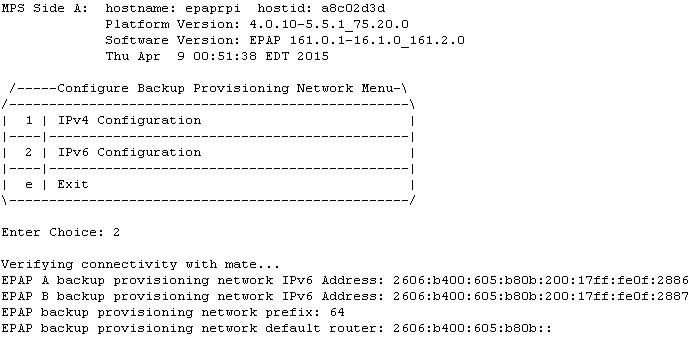

Configure Backup Provisioning Network
The Configure Backup Provisioning Network option 4 of the Configure Network Interfaces Menu prompts you for the EPAP Backup Provisioning Network IP addresses. This information allows the EPAP to communicate with the backup provisioning network. With EPAP 16., the user is able to configure an IP address, net mask, and default router IP address when using an IPv4 address, and an IP address, Prefix and default router when using an IPv6 address. In response to each prompt, enter a dotted decimal IP address.
See Network Connections for a description of EPAP network IP address assignments. See Figure 5-10 for the option 4 output.
Figure 5-10 Configure Backup Provisioning Network
Take care in configuring the IP information. Incorrect information will prevent the EPAP from communicating with the Backup Provisioning Network.

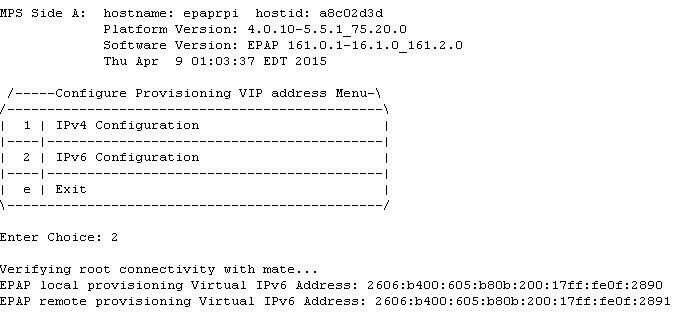

Configure Provisioning VIP Addresses
The Configure Provisioning VIP Addresses option 7 from the Configure Network Interfaces Menu provides the functionality to configure the PDBA Proxy feature.
The user must enter the VIP address for the local PDBA (MPS-A) and the remote PDBA using either an IPv4 or IPv6 address. The following figure shows an example of the option 7 output.
Figure 5-12 Configure Provisioning VIP Address
img/c-epap-configure-provisioning-vip-addresses.jpg

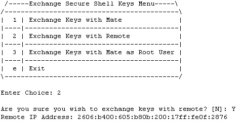

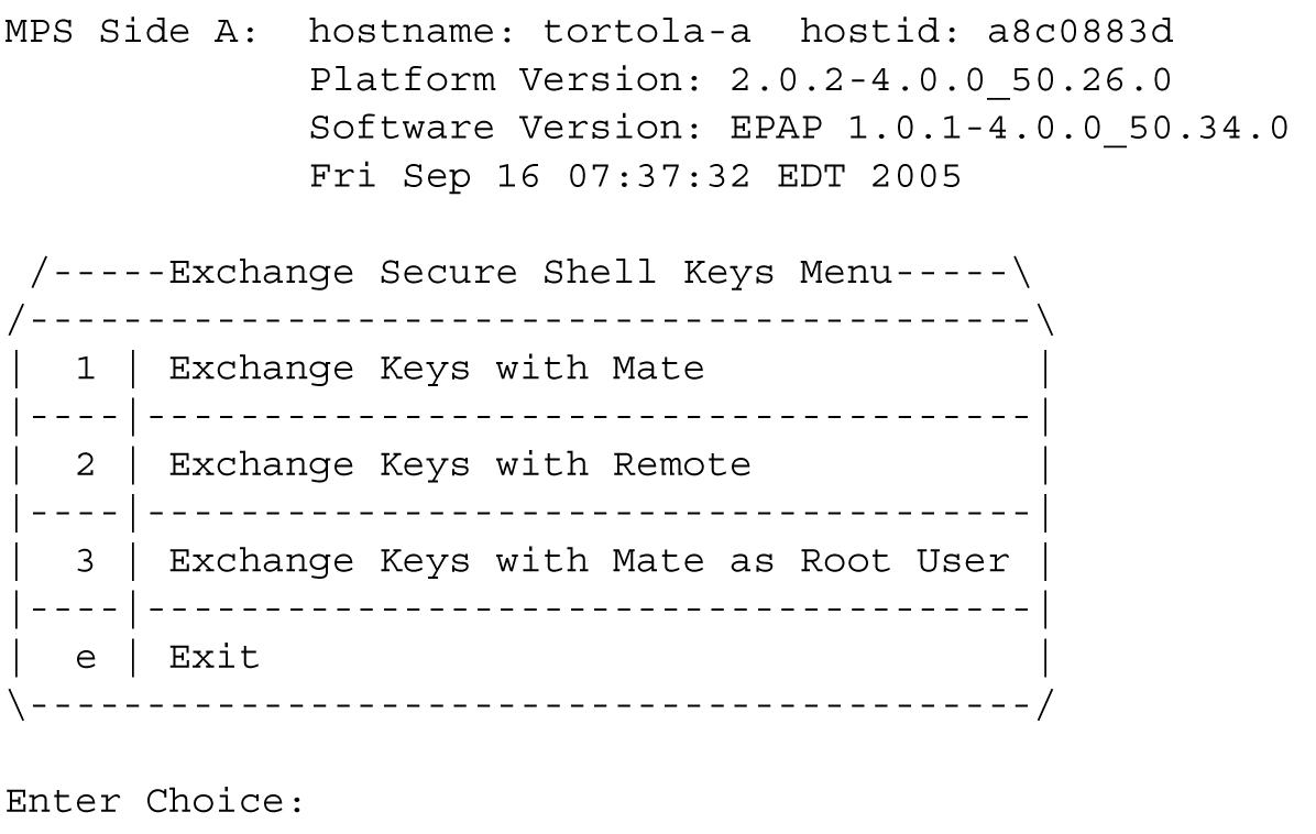

5.3.3 Exchange Secure Shell Keys
The Exchange Secure Shell Keys option 4 accesses the Exchange Secure Shell Keys menu. This menu is used to enable connections between local and remote EPAPs. The EPAPs exchange encryption keys are required to run the secure shell.
The exchange normally occurs automatically during EPAP initialization. Use this menu item only if the exchange must be performed manually.
See Figure 5-13 for the option 4 output.
Figure 5-13 Exchange Secure Shell Keys Menu
img/c-epap-exchange-secure-shell-keys.jpg

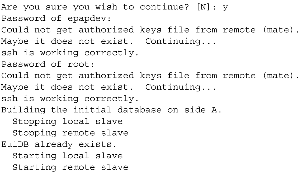

Option 1 is used for the initial configuration. Option 2 is used to do a reload of the RTDB from the remote server. Option 3 is required before using the PDBA Proxy feature. Before doing a reload from the remote server, you must exchange keys with the remote server. The sub menu "Exchange Keys with Remote" allows the user to exchange keys with the remote server. The remote server IP will be either IPv4 or IPv6.
The epapconfig user must know the password for the epapdev@mate. The notification “ssh is working correctly” in the following figure confirms the “ssh” (i.e., secure shell) exchange of keys has completed successfully.
See Figure 5-14 for the Option 1 output.
Figure 5-14 Exchange Secure Shell Keys Output

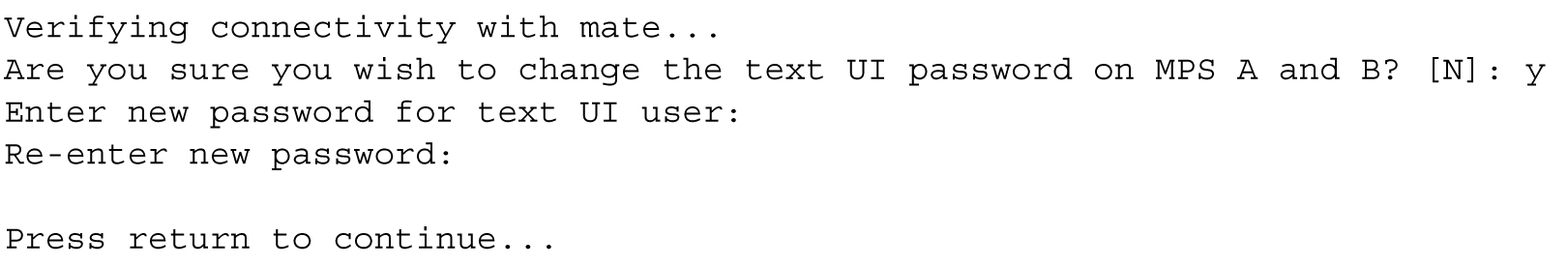

5.3.4 Change Password
The Change Password option 5 changes the text-based user interface password for the epapconfig login name for both MPS A and B.
See Figure 5-15 for the option 5 output.
Figure 5-15 Change Password
Change Password

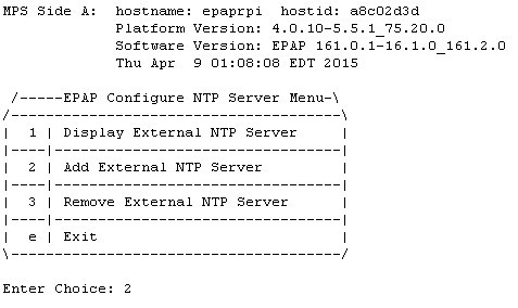

5.3.6 Configure NTP Server Menu
The Configure NTP Server Menu option 7 allows for the display, addition, and removal of an external NTP server. As of EPAP 16.1, the user is able to add/remove external NTP servers using both IPv4 and IPv6 addresses.
  • The user is allowed to configure IPv4 only remote system address
  • The user is allowed to configure IPv6 only remote system address
  • On dual stack - the user is allowed to configure IPv4 or IPv6 remote system address
See the following figure for the option 9 output:
Figure 5-17 Configure NTP Server Menu
img/c-configure-ntp-server-menu.jpg
Display External NTP Server
The Display External NTP Server option 1 of the Configure NTP Server Menu displays External NTP Server information. If a server is present, the server name and IP address are displayed. If an NTP Server is not present, the following is displayed.
There are no External NTP Servers.
Press return to continue...

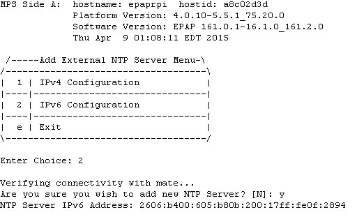

Add External NTP Server
The Add External NTP Server option 2 of the Configure NTP Server Menu adds an External NTP Server. The following figure shows an example of the addition of an External NTP Server.
The IP address must be a valid address for an External NTP Server.
Figure 5-18 Add NTP Server Menu
img/c-epap-add-ntp-server-menu.jpg
Remove External NTP Server
The Remove External NTP Server option 3 of the Configure NTP Server Menu removes an External NTP Server. If a server is present, selecting the Remove External NTP Server removes the server. If an NTP Server is not present, the following appears.
EPAP Configure NTP Server Menu Exit
The EPAP Configure NTP Server Menu Exit option e exits the EPAP Configure NTP Server Menu, and returns to the EPAP Configuration Menu.

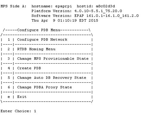

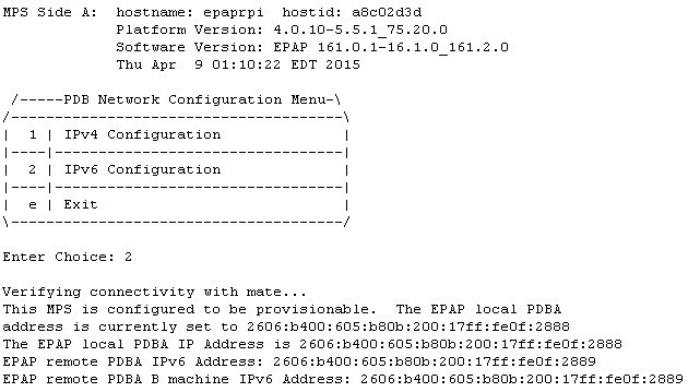

5.3.7 PDB Configuration Menu
The PDB Configuration Menu option 8 supports configuring the PDB network, homing of the RTDBs, changing the MPS provisionable status, creating the PDB, and enabling the Automated Database Recovery and PDBA Proxy features. Beginning with EPAP 16.1, the user is able to configure both IPv4 and IPv6 addresses for a PDB address. See Figure 5-19 for the option 8 output.
Figure 5-19 Configure PDB Menu
img/epap-mixed-configure-pdb.jpg
Configure PDB Network
The Configure PDB Network option 1 of the Configure PDB Menu identifies the provisioning network interface addresses of the remote PDBs. For provisionable MPSs, the local provisioning interface address is known. The configuration user interface prompts for only the remaining remote address. Non-provisionable MPSs prompt for both remote PDB addresses.
Provisionable MPSs then prompt for the password of the epapdev user at the remote PDB address. The following table shows Remote PDBA configuration use cases:
Table 5-7 Remote PDBA Configuration Use Cases

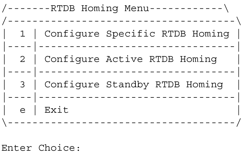

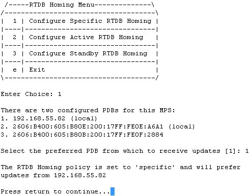

RTDB Homing Menu
The RTDB Homing Menu option 2 of the Configure PDB Menu provides a menu to configure specific and active homing of RTDBs to the PDBAs. For more information about active and specific homing, refer to Selective Homing of EPAP RTDBs. Figure 5-20 shows the option 2 output.
Figure 5-20 RTDB Homing Menu
img/c-pdb-configuration-menu-epapsoftconfig-epapadmin-fig4.jpg
Configure Specific RTDB Homing
The Configure Specific RTDB Homing option 1 of the RTDB Homing Menu sets the RTDB homing policy to specific and configures the address of the preferred PDB.
This configuration cannot be completed until the PDB network has been configured. See Configure PDB Network. Provisionable sites indicate the address of the local PDB with the text (local) and that site is the default value for the preferred PDB.
The text-based User Interface prompts for the preferred PDB. When the choice is selected, the text confirms the choice and identifies the selection is 'specific' homing. When the EPAP is configured in a dual stack configuration, the PDBA also has both the IPs, one in IPv4 format and the other in IPv6 format. By default, the RTDB Homing Policy is set to the PDBA IPv6 IP. If the user wants to change the RTDB homing policy to the PDBA IPv4 IP, then the Configure Specific RTDB Homing menu option must be used.
Figure 5-21 RTDB Homing Policy Configuration
img/c-rtdb-homing-policy-config.jpg
Configure Active RTDB Homing
The Configure Active RTDB Homing option 2 of the RTDB Homing Menu sets the RTDB homing policy to active and configures whether to allow updates from the alternate PDB. The prompt selection must be confirmed if updates are not allowed from the standby PDB.
The text-based User Interface prompts for whether updates are to be allowed from the standby MPS. When the choice is entered, the text confirms the choices and identifies the selection is ‘active’ homing and whether updates are allowed from the PDB of the standby MPS.
EPAP software and PDBA are running. Stop Them? [N] y
In the event that the active PDB is unavailable, should updates be allowed to the RTDBs from the standby MPS? [Y]: N
Caution: If this option is selected, the standby PDB will not provision the RTDBs at this site in the event that the active PDB is not available.
Are you sure you want to disallow updates to the RTDBs from the standby PDB? Y
The RTDB Homing policy is set to 'active' and will not allow updates from the standby PDB.
Configure Standby RTDB Homing
The Configure Standby RTDB Homing option 3 of the RTDB Homing Menu sets the RTDB homing policy to standby and configures whether to allow updates from the active PDB. The prompt selection must be confirmed if updates are not allowed from the active PDB.
The text-based User Interface prompts for whether updates are to be allowed from the active MPS. When the choice is entered, the text confirms the choices and identifies the selection is ‘standby’ homing and whether updates are allowed from the PDB of the active MPS.
In the event that the standby PDB is unavailable, should updates be allowed to the RTDBs from the active MPS? [Y]: N
Caution: If this option is selected, the active PDB will not provision the RTDBs at this site in the event that the standby PDB is not available.
Are you sure you want to disallow updates to the RTDBs from the active PDB? Y
The RTDB Homing policy is set to 'standby' and will not allow updates from the active PDB.
Change MPS Provisionable State
The Change MPS Provisionable State option 3 of the Configure PDB Menu specifies this site as provisionable or non-provisionable. For more information about these states, refer to Provisioning Multiple EPAPs Support. This command toggles the states between provisionable and non-provisionable.
See EPAP Configuration Menu for the prompt that is displayed for this menu item. To complete this configuration, the user is prompted to configure the remote PDBA addresses from which the non-provisionable EPAP takes the updates. The user is allowed to specify either the IPv4 or the IPv6 address for the remote PDBA:

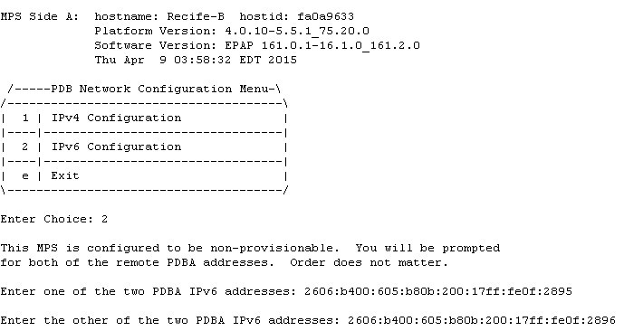

Figure 5-22 Configure PDB Network for Provisionable MPS
img/c-pdb-network-configuration-menu.jpg
Figure 5-23 Configure PDB Network for Non-Provisionable MPS
img/c-pdb-non-network-configuration-menu.jpg
Create PDB
The Create PDB option 4 of the Configure PDB Menu creates and initializes a Provisioning Database (PDB) for the EPAP.
Caution:
If the text-based User Interface is exited before the successful creation of the PDB on a provisionable MPS, this caution message is displayed.
PDB not created Caution: This MPS has not been completely configured.  Applications may not         run until all required parameters are entered through the text         user interface.  Choose "Display Configuration" for a list of         configurable parameters and their settings. Press return to continue...
Change Auto DB Recovery State
The Change Auto DB Recovery State option 5 of the Configure PDB Menu is used to enable the Automated Database Recovery feature.
The text-based User Interface prompts with this text:
Auto DB Recovery is currently DISABLED.
Do you want to ENABLE Auto DB Recovery? [N]:
Change PDBA Proxy State
The Change PDBA Proxy State option 6 of the Configure PDB Menu is used to enable the PDBA Proxy feature.
PDBA PROXY is currently DISABLED.
Do you want to ENABLE PDBA Proxy? [N]:
PDB Configuration Menu Exit

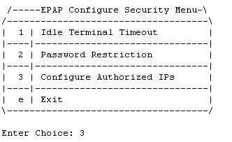

The Security Menu option 9 provides access to configure the Idle Terminal Timeout and the password restrictions for EPAP system users. See Figure 5-25 for the option 8 output.
Figure 5-25 EPAP Configure Security Menu
img/c-epap-configure-security-menu.jpg

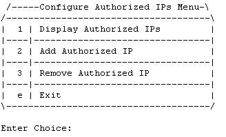

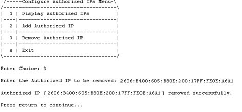

The submenu Configure Authorized IPs allows the user to configure the authorized IPs for the EPAP. The functionality of this menu is the same as the GUI menu User Administration, and then Authorized IPs.
Figure 5-26 EPAP Configure Authorized IPs Menu
img/c-epap-configure-authorized-ip-menu.jpg

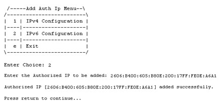

The Add Authorized IP menu option allows the user to add a new IP address, either in IPv4 or IPv6 format, to the list of the authorized IP addresses. The authorized IP version is independent of the EPAP network configuration. The authorized IP list can have a mix of the IPv4 and IPv6 IPs:
Figure 5-27 Add Authorized IP
img/c-add-authorized-ip.jpg
The Display Authorized IPs menu option displays the list of authorized IPs. It displays all the configured IPs:
Figure 5-28 Display Authorized IPs
img/c-display-authorized-ip.jpg
The Remove Authorized IP screen allows the user to remove an IP address from the list of authorized IP addresses. The screen has no change for the IP version. The "IP to remove" field accepts both type of IPs, either IPv4 or IPv6:
Figure 5-29 Remove Authorized IP
img/c-remove-authorized-ip.jpg

Password Change for System Users
The appuser users use the passwd command provided by the Operating System. If changing a password using the passwd command, then the Linux PAM credit rules are used.
The system user epapconfig uses the option provided in the EPAP Configuration Menu. Linux PAM rules are not applicable while changing the password for the epapconfig user. Only the configured minimum password length applies.
If the password for the appuser or epapconfig user is changed by the root user, the appuser or epapconfig user will be prompted to change the password again.

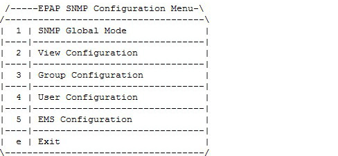

5.3.9 SNMP Configuration Menu
The SNMP Configuration option 10 is used to support all configuration related to SNMPv2c and SNMPv3. See Figure 5-30 for the option 10 output.
Figure 5-30 EPAP SNMP Configuration Menu
img/c-snmp-config-menu.jpg

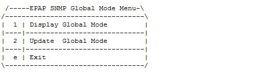

SNMP Global Mode
EPAP supports three SNMP global modes: SNMPv2c, SNMPv3, and both. The EPAP user is able to update or view the global mode in the menu by choosing option 1).
Figure 5-31 SNMP Global Mode Menu
img/c-snmp-global-mode-menu.jpg

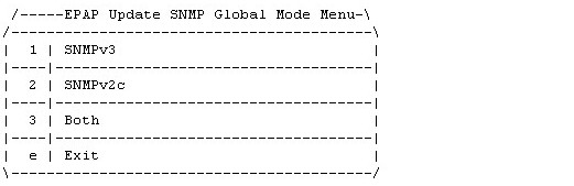

Update SNMP Global Mode Menu
The EPAP user is able to update the global mode using option 2.
Figure 5-32 Update SNMP Global Mode Menu
img/c-snmp-update-global-mode-menu.jpg
If SNMPv2c (option 2) mode is enabled, then EPAP only supports SNMPv2c:
  • EPAP forwards SNMPv2c format traps only to the configured EMS(s) that support v2c.
  • EPAP only allows the addition of any new EMS supporting v2c to be configured. Existing EMS(s) are prohibited from modification to support v3.
  • Prior to the mode change to SNMPv3 only, all configured EMS(s) supporting v2c will be removed.
If SNMPv3 (option 1) mode is enabled (recommended), then the EMS only supports SNMP version 3:
  • EPAP forwards SNMPv3 format traps only to the configured EMS(s) that support v3.
  • EPAP only allows the addition of any new EMS supporting v3 to be configured. Existing v3-supporting EMS(s) are prohibited modification to support v2c.
  • Prior to the mode change to SNMPv2c ONLY, all configured EMS(s) supporting v3 will be removed.
If Both (option 3) mode is enabled, then EPAP supports both SNMPv2c and SNMPv3.
  • EPAP forwards traps to all the configured EMS(s) that support v2c or v3.
  • EPAP allows the addition of new or updated EMS(s) supporting v2c or v3.

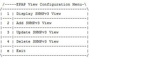

SNMPv3 Access View Configuration Menu
To support View-Based Access Control Mode for SNMPv3, View Configuration, option 2 under the SNMP Configuration menu, supports sub-menus Add, Delete, Update, Display in order to manage Access Views. The View menu is only accessible if SNMP Global Mode is configured as SNMPv3 ONLY or Both. If SNMPv2c only mode is enabled and the EPAP user tries to access the View menu, the "Error: SNMPv3 View must NOT be configured for SNMP v2c Mode" is displayed.
Figure 5-33 View Configuration Menu
img/c-snmp-view-configuration-menu.jpg

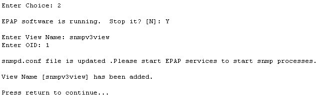

The EPAP user is able to add a new View using option 2 under the View Configuration menu, as displayed in Figure 5-34. The default view is not be shown during add/update/delete, as no write operation is allowed on it.
Figure 5-34 Add SNMPv3 View
img/c-snmp-add-snmpv3-view.jpg

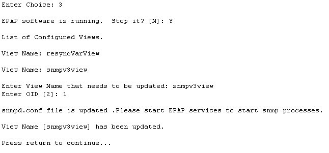

The EPAP user is able to update the configured View using option 3 under the View Configuration menu, as displayed in Figure 5-36. The already configured OID associated with corresponding view name is shown in square brackets:
Figure 5-36 Update SNMPv3 View
img/c-snmp-update-snmpv3-view.jpg

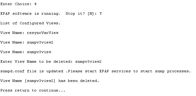

The EPAP user is able to delete the view using option 4 under the View Configuration menu, as displayed in Figure 5-37:
Figure 5-37 Delete SNMPv3 View
img/c-snmp-delete-snmpv3-view.jpg
  • View name is non-empty and unique.
  • The length of View name cannot be more than 32 characters.
  • View Name contains only alphanumeric characters and is case insensitive when being configured.
  • OID to be associated with the View is mandatory.
  • A View that is associated to any group cannot be deleted.

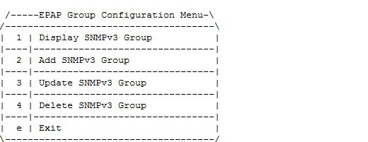

SNMPv3 Group Management
To support User-Based Security Mode for SNMPv3, Group Configuration, option 3 under the SNMP Configuration menu, supports sub-menus Add, Delete, Update, Display in order to manage Groups. The Group menu is only accessible if SNMP Global Mode is configured as SNMPv3 ONLY or Both. If SNMPv2c only mode is enabled and the EPAP user tries to access the Group menu, the "Error: SNMPv3 Group must NOT be configured for SNMP v2c Mode" is displayed.
Figure 5-38 Group Configuration Menu
img/c-snmp-group-configuration-menu.jpg

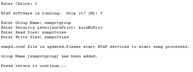

The EPAP user is able to add a new Groups using option 2 under the Group Configuration menu, as displayed in Figure 5-39. The default value of the security level "AuthPriv" is shown in square brackets:
Figure 5-39 Add SNMPv3 Group
img/c-snmp-add-snmpv3-group-view.jpg
The EPAP user is able to display the configured Group using option 1 of the Group Configuration menu, as displayed in Figure 5-40:
Figure 5-40 Display SNMPv3 Group
img/c-snmp-display-snmpv3-group-view.jpg

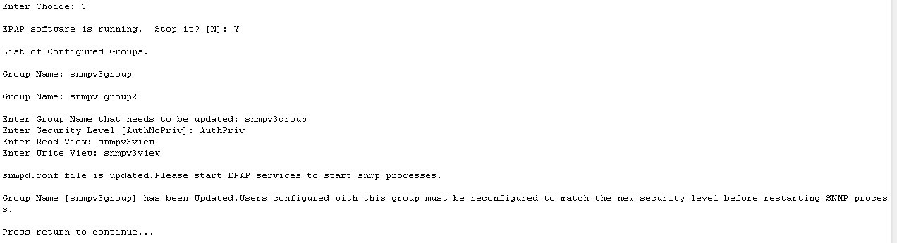

The EPAP user is able to update the configured Groups using option 3 under the Group Configuration menu, as displayed in Figure 5-41. The already configured security level related to the corresponding Group is shown in square brackets; however, the read and write view is not shown in square brackets, as these are allowed to be empty:
Figure 5-41 Update SNMPv3 Group
img/c-snmp-update-snmpv3-group-view.jpg

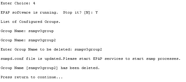

The EPAP user is able to delete the Groups using option 4 under the Group Configuration menu, as displayed in Figure 5-42:
Figure 5-42 Delete SNMPv3 Group
img/c-snmp-delete-snmpv3-group-view.jpg
  • Group name is non-empty and unique.
  • The length of Group name cannot be more than 32 characters.
  • View Name must contain only alphanumeric characters and is case insensitive when configured; however, during update, Group name is case sensitive.
  • Security Level is mandatory. Valid values are noAuthNoPriv, AuthNoPriv, and AuthPriv.
  • Read View is optional. Specify the View name spelled exactly as configured in the View Menu if added.
  • Read View is configured if it is to be added to the Group.
  • Write View is optional. Specify the View name spelled exactly as configured in the View Menu if added.
  • Write View is configured if it is to be added to the Group
  • A Group that associated to any user cannot be deleted.

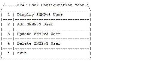

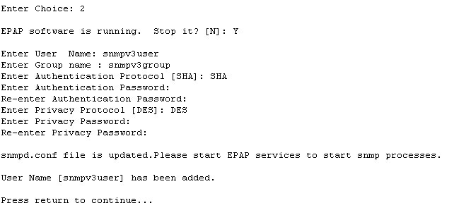

SNMPv3 User Management
To support User-Based Security Mode for SNMPv3, User Configuration, option 4 under the SNMP Configuration menu, supports sub-menus Add, Delete, Update, Display in order to manage Users. The User menu is only accessible if SNMP Global Mode is configured as SNMPv3 ONLY or Both. If SNMPv2c only mode is enabled and the EPAP user tries to access the User menu, the "Error: SNMPv3 User must NOT be configured for SNMP v2c Mode" is displayed.
Figure 5-43 User Configuration Menu
img/c-snmp-user-configuration-menu.jpg
The User sub-menus are able to configure a user name, a group, and optional Privacy Protocol, Privacy Password, Authentication Protocol, and Authentication Password, depending on the security level configured for the chosen Group.
The EPAP services will be stopped through an interactive prompt menu every time the EPAP user initiates Add, Delete, or Update Group configuration.
The EPAP user is able to add a new User using option 2 under the User Configuration menu, as displayed in Figure 5-44. The password information is not visible to the EPAP user. The default value of the Authentication Protocol and Privacy Protocol will be shown in square brackets while adding a new User:
Figure 5-44 Add SNMPv3 User
img/c-snmp-add-user.jpg
The Add SNMPv3 User is configured based on Group configuration. First, the Group Name values are validated against the Group configured. If no valid Group is found, the Add step fails with a corresponding error message. If the Group entered is validated, then the menu lists only the valid fields corresponding to the Group entered. If the security level configured for the chosen group is 'noAuthNoPriv', then the input fields for Authentication Protocol, Authentication Password, Privacy Protocol, and Privacy password will not be displayed. If the security level configured for the chosen group is 'AuthNoPriv', the input fields Priv Protocol and Priv Password will not be displayed. By default, DES is selected for the addition of a new User for an AuthPriv scenario.

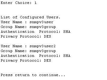

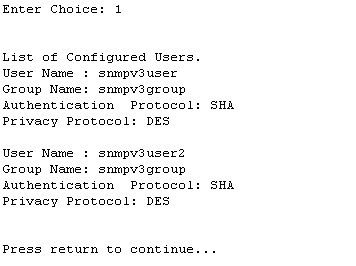

The EPAP user is able to display the configured Users using option 1 of the User Configuration menu, as displayed in Figure 5-45. The password information for the authentication protocol and privacy protocol is not displayed:
Figure 5-45 Display SNMPv3 User
img/c-snmp-display-configured-user.jpg

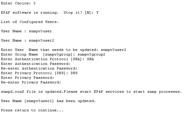

The EPAP user is able to update the configured Users using option 3 under the User Configuration menu, as displayed in Figure 5-46. The parameters already configured for the corresponding user will be shown in square brackets:
Figure 5-46 Update SNMPv3 User
img/c-snmp-update-user.jpg

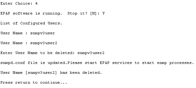

The EPAP user is able to delete the Usersroups using option 4 under the User Configuration menu, as displayed in Figure 5-47:
Figure 5-47 Delete SNMPv3 User
img/c-snmp-delete-user.jpg
  • User Name must contain only alphanumeric characters and is case insensitive when configured.
  • Group must have been configured if it is to be added to the User.
  • Group must be spelled in the exact case as configured in the Group menu.
  • If the security level configured for the chosen group is 'noAuthNoPriv', then the input to Authentication Protocol, Authentication Password, Privacy Protocol and Privacy Password fields will not be displayed.
  • If the security level configured for the chosen group is 'AuthNoPriv', then it is required to input the desired value for Authentication Protocol and provide a valid password in the Authentication Password field. The input to Privacy Protocol and Privacy Password fields are not required.
  • If the security level configured for the chosen group is 'AuthPriv', then it is required to select the desired values for Authentication Protocol and Privacy Protocol fields and provide valid passwords in the Authentication Password and Privacy Password fields.
  • Valid values for Auth Protocol is SHA as the default.
  • Valid values for Priv Protocol are DES and AES; DES is the default.
  • Auth and Priv password length must be between 8 and 255 inclusive.
  • Auth and Priv password is stored in encrypted form in the DB.
  • Only the following alphanumeric characters and special characters are allowed in Auth and Priv passwords: @, #, $, !
  • A user associated to any EMS cannot be deleted.
  • A default user "oracleuser" is for system use and will not be visible, added, edited, or deleted by customers through this menu.

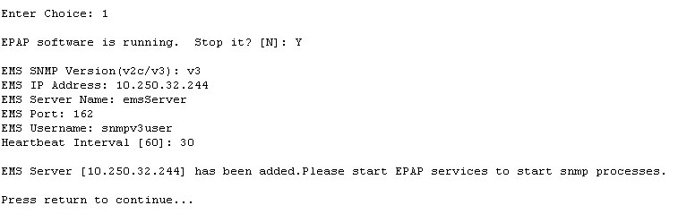

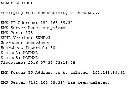

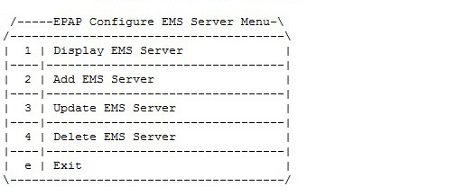

5.3.9.1 Configure EMS Server
The EMS Configuration option 5 under the EPAP SNMP Configuration Menu allows the user to configure the EMS server using either an IPv4 or IPv6 address. The User Configuration sub-menus can be configured with an EMS host name, IP, Port, Heart Beat in seconds, and either Community or User, depending on the global mode set in SNMP Global Mode. If the Global Mode is SNMPv2c ONLY, the input field "User" will not be displayed.
The EPAP supports the configuration of maximum 5 EMS Servers. The EPAP supports the configuration of multiple EMS Servers with a mix of IPv4 and IPv6 IPs with which to interact to send the alarms to send as traps. See Figure 5-30 for the option 5 output.
Figure 5-48 Configure EMS Server
img/c-ems-configuration-menu.jpg
Display EMS Server
Configure EMS Server Menu option 1 displays all configured EMS servers. For PROV/Non PROV EPAP, the display operation displays the values of the fields shown in Figure 5-49. For PDB_ONLY EPAP, all fields except the StatusB field are displayed:
Figure 5-49 Display EMS Configuration for PROV/Non-PROV Server
img/c-display-ems-both.jpg
Figure 5-50 Display EMS Configuration for PDBonly EPAP
img/c-display-ems-pdb-only.jpg

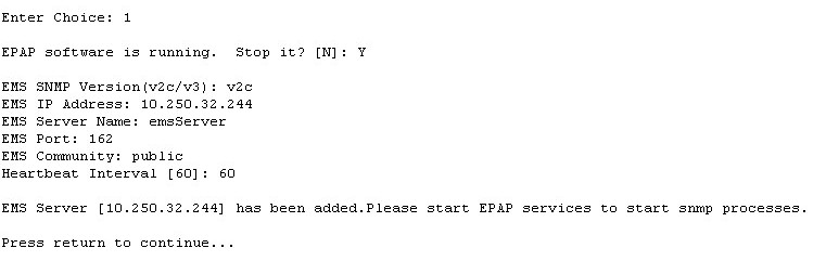

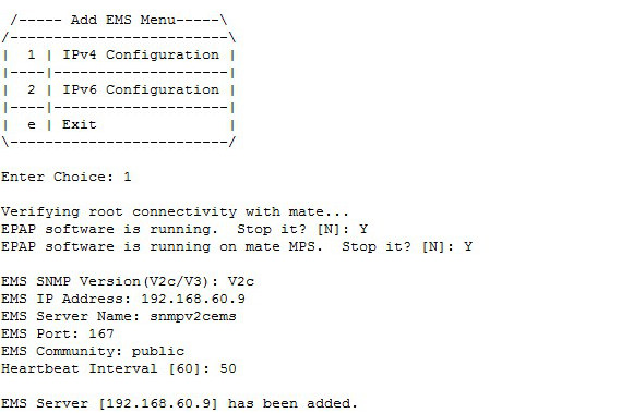

Add EMS Server
Configuration EMS Server Menu option 2 allows the addition of EMS servers:
EMS IP Address
IP address of EMS to receive traps
EMS Server Name
A logical name for the EMS
EMS Port
Destination UDP port
EMS Community
SNMP community contained in traps
Heartbeat Interval [60]
Number of seconds between heartbeat traps (system alive message); the default is 60 seconds if not specified
Figure 5-51 and Figure 5-52 display examples of adding IPv4 SNMPv2c EMS servers:
IPv6 Configuration, menu option 2, follows the same procedures as IPv4 for adding EMS servers.
Figure 5-51 Add IPv4 SNMPv2c EMS When Global Is Set to Both for PROV/Non-PROV EPAP
img/c-add-ipv4-snmpv2c-ems.jpg
Figure 5-52 Add IPv4 SNMPv2c EMS When Global Mode Is Set to Both for PDBOnly EPAP
img/c-add-ipv4-snmpv2c-ems-pdb-only.jpg

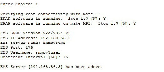

and display examples of adding IPv4 SNMPv3 EMS servers:
Figure 5-53 Add IPv4 SNMPv3 EMS When Global Mode Is Set to Both for PROV/Non-PROV EPAP
img/c-add-ipv4-snmpv3-ems-both.jpg
Figure 5-54 Add IPv4 SNMPv3 EMS When Global Mode Is Set to Both for PDBOnly EPAP
img/c-add-ipv4-snmpv3-pdb-only.jpg

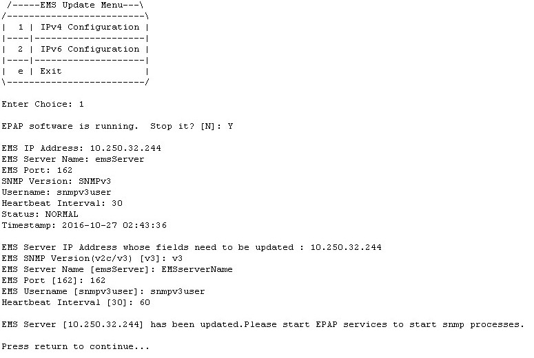

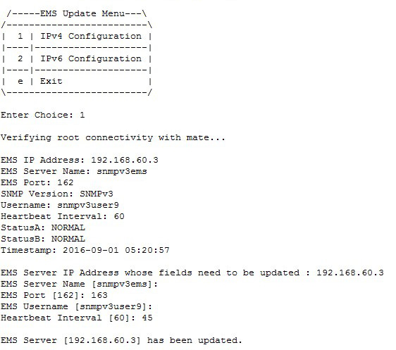

Update EMS Server
Configure EMS Server Menu option 3 allows the update of the EMS Server Name, EMS Port, EMS Community, and Heartbeat Interval fields for an EMS server IP address entered by the user, as displayed in .
Figure 5-55 Update EMS Configuration for PROV/Non-PROV EPAP When Global Mode Is SNMPv3
img/c-update-ems-snmpv3-both.jpg
Figure 5-56 Update EMS Configuration for PDBOnly EPAP When Global Mode Is Both
img/c-update-ems-snmpv3-pdb-only.jpg

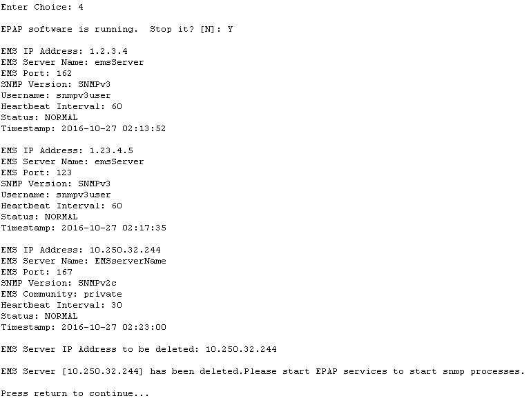

Delete EMS Server
Configure EMS Server Menu option 4 allows the deletion of the EMS server, as displayed in.
Figure 5-57 Delete EMS Configuration for PROV/Non-PROV
img/c-delete-ems-both.jpg
Figure 5-58 Delete EMS Configuration for PDBonly EPAP
img/c-delete-ems-pdb-only.jpg

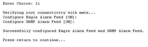

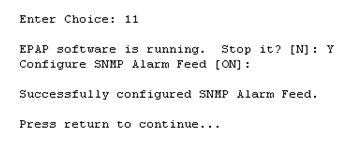

5.3.10 Configure Alarm Feed
The Configure Alarm Feed option 11 allows the user to configure the Eagle Alarm Feed and SNMP Alarm Feed parameters. For PROV/Non PROV EPAP (see Figure 5-59), the EPAP software is stopped in both the EPAP A and EPAP B servers before configuring the alarm feeds.
Figure 5-59 Alarm Feed Configuration Menu for PROV/Non PROV EPAP
img/c-configure-alarm-feed-menu-epapsoftconfig-fig1.jpg
As shown in Figure 5-60, the Eagle Alarm Feed parameter is not configurable for PDB_ONLY EPAP. The EPAP software is stopped in the EPAP A server before configuring the alarm feed.
Figure 5-60 Alarm Feed Configuration Menu for PDB_ONLY EPAP
img/c-configure-alarm-feed-menu-epapsoftconfig-fig2.jpg

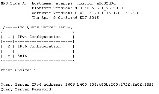

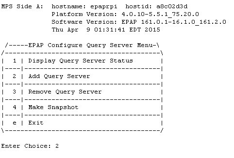

Add Query Server
The Add Query Server option 2 adds a query server at EPAP. As shown in Figure 5-63, the following parameters are configurable for a query server:
  • IP address of the query server
  • Password needed for replication user
Figure 5-63 Add Query Server
img/c-query-server-add.jpg

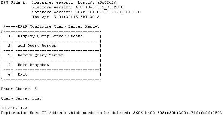

Remove Query Server
The Remove Query Server option 3 removes the query server configured at EPAP, as shown in Figure 5-64.
Figure 5-64 Remove Query Server
img/c-query-server-remove.jpg

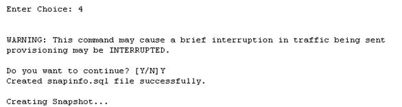

Make Snapshot
The Make Snapshort option 4 creates a snapshot of the EPAP PDB, as shown in Figure 5-65.
Figure 5-65 Make Snapshot
img/c-configure-query-server-menu-epapsoftconfig-fig5.jpg

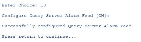

5.3.12 Configure Query Server Alarm Feed
The Configure Query Server Alarm Feed option 13 allows the user to turn on or turn off the Query Server Alarm Feed, as shown in Figure 5-66.
Figure 5-66 Configure Query Server Alarm Feed
img/c-configure-query-server-alarm-feed-menu-epapsoftconfig-fig1.jpg
When the Query Server Alarm Feed is set to ON, the EPAP QS Replication Issue and EPAP QS Lagging behind alarms can be raised in the system according to their alarm condition.

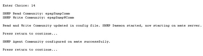

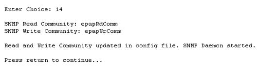

5.3.13 Configure SNMP Agent Community
The Configure SNMP Agent Community option 14 allows the user to configure the SNMP Read and Write Communities in the snmpd.conf file, as shown in Figure 5-67 and Figure 5-68. The default strings for the Read and Write communities in the snmpd.conf file are epapRdSnmp and epapWrSnmp.
|  3 | Set Time Zone                     |
|  4 | Exchange Secure Shell Keys        |
|  5 | Change Password                   |

After connecting to the MPS on EAGLE A, you are prompted to log in.
  1. Log in as epapconfig.
    A Caution notice is displayed. Evaluate the conditions listed.
    mpsa-f0c7c3 console login: epapconfig
    Password:
    Caution: This is the first login of the text user interface.  Please
             review the following checklist before continuing.  Failure
             to enter complete and accurate information at this time will
             have unpredictable results.
                 1. The mate MPS servers (MPS A and MPS B) must be powered on.
                 2. "Initial Platform Manufacture" for the mate MPS servers
                    must be complete.
                 3. The sync network between the mate MPS servers must be
                    operational.
                 4. You must have the correct password for the EPAPdev user on
    Press return to continue…
  2. After all conditions of the Caution notice are satisfied, press Return to continue.
    After pressing Return to continue, you can abort or proceed with the initial configuration.
    Pressing Return accepts the default value n.
    Are you sure you wish to continue? [N]: y
    Password of epapdev:
    Could not get authorized keys file from remote (mate).
    Maybe it does not exist.  Continuing...
    ssh is working correctly.
    Password of root:
    Building the initial database on side A.
      Stopping local slave
      Stopping remote slave
    EuiDB already exists.
      Starting local slave
      Starting remote slave
  3. To continue with the configuration, enter y.

  4. Declare whether the MPS is provisionable or non-provisionable.
    This example shows this MPS as a provisionable MPS.
    A: MPS on EAGLE A:
    Answer y in this step.
    B: MPS on EAGLE B:
    N: Non-Provisionable MPS:
    Answer n in this step.
    The provisioning architecture of the EPAP software allows for exactly 2 customer provisionable sites.  Additional sites that are to receive the data provisioned to the provisionable sites should answer 'N' here.
    If there are only 2 mated sites, it is safe to answer 'Y' here.
    Is this site provisionable? [Y]: y
  5. When prompted, enter the epapdev user password on the mate MPS server in order to confirm the secure shell keys are successfully exchanged.
    This example shows the output generated when the correct password is entered, the secure shell keys are successfully exchanged, and the UI database is set up on MPS A and MPS B at this site.
    Password for EPAPdev@mate:
    Connecting to mate...
    still OK.
    still OK.
    No preexisting EuiDB database was detected.
    Enabling replication:
      deleting old binary logs on local server
      resetting local slave.
      deleting old binary logs on remote server
      resetting remote slave
    There was no epap.cfg file.  Using default configuration.

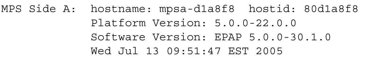

    Upon successful configuration file setup, the EPAP Configuration Menu appears (for the first time) with associated header information.
    The server designation of MPS A at this site is displayed along with hostname, hostid, Platform Version, Software Version, and the date.

    |  8 | PDB Configuration Menu            |

    This option provides a means of verifying EPAP A and EPAP B Provisioning Network IP addresses, the Time Zone, and other provisioning values for the MPS on EAGLE A.
    Figure 5-72 Example of Configuration Report When the EPAP is Not Configured
    img/c-epap-display-configuration1.jpg
    When the EPAP is configured in dual stack configuration, the "EPAP IP Version" is set to "IPv4v6". The Display Configuration option displays both the IPv4 and IPv6 network configurations:
    Figure 5-73 Display Configuration of EPAP Configured in Dual Stack
    img/c-epap-configuration-dual-stack.jpg
    In the IPv4 only configuration, the "EPAP IP Version" is set to IPv4. The Display Configuration option displays only the IPv4 network configuration. The IPv6 network configuration is be displayed as "Not configured."
    Figure 5-74 Display Configuration of EPAP Configured as IPv4 Only
    img/c-epap-configuration-ipv4-only.jpg
    In the IPv6 only configuration, the "EPAP IP Version" is set to IPv6. The Display Configuration option displays only the IPv6 network configuration. The IPv4 network configuration is be displayed as "Not configured."
    Figure 5-75 Display Configuration of EPAP Configured as IPv6 Only
    img/c-epap-configuration-ipv6-only.jpg

    | 11 | Configure Alarm Feed              |

  9. Choose option 1, Configure Provisioning Network.
    MPS Side A:  hostname: dakar  hostid: a8c03c42
                 Platform Version: 2.0.4-0.19570
                 Software Version: EPAP 1.0.8-0.19570
                 Tue Dec  6 11:06:52 EST 2005
     /-----Configure Network Interfaces Menu----\
    |  1 | Configure Provisioning Network        |
    |  2 | Configure Sync Network                |
    |  3 | Configure DSM Network                 |
    |  4 | Configure Backup Provisioning Network |
    |  5 | Configure Static NAT Addresses        |
    |  6 | Configure Provisioning VIP Addresses  |
    |  e | Exit                                  |
    Enter choice: 1
    The Configure Provisioning Network Menu allows you to accept the default IP address values presented by the configuration software for EPAP A and EPAP B provisioning network and network netmask, or enter specific IP values previously received from the customer for the MPS.
    Refer to the information recorded in Table 5-1 through Table 5-4 for the correct addresses.
    No default value is provided for the EPAP provisioning network default router. This value must be received from the customer.
    The display for the submenu for configuring communications networks appears.

  11. Enter option 2, Configure Sync Network.
    |  5 | Configure Forwarded Ports             |
    |  6 | Configure Static NAT Addresses        |
    |  7 | Configure Provisioning VIP Addresses  |
    |  e | Exit                                  |
    Enter choice: 2
    Verifying connectivity with mate...
    Enter the first 3 octets for the EPAP MPS sync Network [192.168.4]

  13. Accept the default IP address octets for the EPAP main DSM network and the EPAP backup DSM network presented by the configuration software unless a known network conflict exists.
    Enter the first 3 octets for the EPAP main DSM network [192.168.136]:
    Enter the first 3 octets for the EPAP backup DSM network [192.168.137]:
    Upon accepting the default value or entering a specific EPAP backup DSM network octet IP address value, the Configure Network Interface Menu appears.

    This menu selection prompts you for all information necessary to set up a second interface for the customer’s Provisioning Network.
    The address information should be received from the customer for the MPS. Refer to the information recorded in Table 5-1 through Table 5-4 for the correct addresses.
    The IP address for this interface must be on a different class C subnet than the primary Provisioning Network address. You must set up a second default router address to coincide with the Backup Provisioning Network. There are no default values for any of these fields. The customer must supply all the information. The Backup Provisioning Network cannot be configured using the platcfg utility.
    Verifying connectivity with mate…
    EPAP A backup provisioning network IP Address: 192.168.59.169
    EPAP B backup provisioning network IP Address: 192.168.59.170
    EPAP backup provisioning network netmask: 255.255.255.0
    EPAP backup provisioning network default router IP Address: 192.168.59.250
    Press return to continue ...

  24. Choose option 7, Configure Provisioning VIP Addresses.
    |  e | Exit                                  |
    Enter choice: 7
  25. Enter the local and remote provisioning VIP addresses.
    EPAP local provisioning Virtual IP Address [192.168.66.80]:
    EPAP remote provisioning Virtual IP Address [192.168.66.78]:
  26. Choose option e, Exit from the Configure Network Interfaces Menu to return to the EPAP Configuration Menu.
    |  3 | Set Time Zone                     |
    |  6 | Platform Menu                     |
    |  7 | Configure NTP Server              |
    |  9 | Security                          |
    | 10 | SNMP Configuration                |
    | 12 | Configure Query Server            |
    | 13 | Configure Query Server Alarm Feed |
    | 14 | Configure SNMP Agent Community    |
    | 15 | DB Architecture Menu              |
    |  e | Exit                              |
    Enter Choice:3

  30. Choose option 4, Exchange Secure Shell Keys.
    |  3 | Set Time Zone                     |
    |  6 | Platform Menu                     |
    |  9 | Security                          |
    |  e | Exit                              |
    Enter Choice:4
    The Exchange Secure Shell Keys Menu appears.
    MPS Side A:  hostname: tortola-a  hostid: a8c0883d
                 Platform Version: 2.0.2-4.0.0_50.26.0
                 Software Version: EPAP 1.0.1-4.0.0_50.34.0
                 Fri Sep 16 07:37:32 EDT 2005
     /-----Exchange Secure Shell Keys Menu-----\
    |  1 | Exchange Keys with Mate              |
    |  2 | Exchange Keys with Remote            |
    |  3 | Exchange Keys with Mate as Root User |
    |  e | Exit                                 |
    Enter Choice: 1
  31. Select Option 1 to Exchange Keys with the mate.
    A prompt appears.
    Are you sure you wish to exchange keys? [N]: y
  32. Enter y.
    You are notified that secure shell keys have been exchanged.
    Caution: Secure shell keys have already been exchanged between this              MPS server and its mate.  Secure shell is working properly.
  33. Press Return to confirm and continue with the exchange.
    A confirmation prompt appears.
    Are you sure you wish to exchange keys with the mate? [N]: y
    Keys exchanged.
    Verifying that ssh works correctly.
    • Press Return ( 'N' or 'no') to abort the exchange action.
    • Enter Y to confirm the exchange.
    If you enter y, you are prompted for the password of the mate. Contact My Oracle Support for the password.
    After entering the appropriate password, a verification of the exchange appears and you are returned to the EPAP Configuration Menu.
    If you want do not want to change the text-based UI password for the MPSs at this site, skip option5 and proceed to 36.
  34. Enter option 5, Change Password, to change the text-based user interface password for the epapconfig login name for both MPS A and B at this site.
    |  3 | Set Time Zone                     |
    |  6 | Platform Menu                     |
    |  9 | Security                          |
    |  e | Exit                              |
    Enter Choice:5
    You are prompted to confirm the action of changing the password for both servers ( MPS A and MPS B) at this site.
    Are you sure you wish to change the text UI password on MPS A and B? [N]: y
    Enter new password for text UI user:
    Re-enter new password:
    • Press Return to accept the default ('N' or 'no') and abort the action to change the password.
    • Enter y invokes a prompt for the new password and re-entry of the password to confirm the entry.
  35. Enter the new password, confirm, and press Return to return to the EPAP Configuration Menu.

  36. Enter option 7, Configure NTP Server, to add an NTP Server.
    |  3 | Set Time Zone                     |
    |  6 | Platform Menu                     |
    |  9 | Security                          |
    |  e | Exit                              |
    Enter Choice:7
  37. Enter option 2, Add External NTP Server.
     /-----EPAP Configure NTP Server Menu-\
    |  1 | Display External NTP Server     |
    |  2 | Add External NTP Server         |
    |  3 | Remove External NTP Server      |
    |  e | Exit                            |
    Enter Choice: 2
    You are prompted to confirm the action of adding a new NTP Server.
    • Press Return to accept the default ('N' or 'no') and abort the action to add an external NTP server.
    • Enter y to add an external NTP server.
    A prompt appears allowing you to add the IP address of the NTP server.
    Are you sure you wish to add new NTP Server? [N]: y
    Enter the EPAP NTP Server IP Address: 192.168.61.69
    Verifying NTP Server. It might take up to 1 minute.
    External NTP Server [192.168.61.69]
    has been added.

  42. Enter option 8, PDB Configuration Menu, to configure the PDB network
    |  3 | Set Time Zone                     |
    |  6 | Platform Menu                     |
    |  9 | Security                          |
    |  e | Exit                              |
    Enter Choice:8
  43. Enter option 1, Configure PDB Network.
    The procedure for configuring the PDB Network will be different for provisionable MPSs and non-provisionable MPSs, as described in the following choices.
     /-----Configure PDB Menu------------\
    |  1 | Configure PDB Network          |
    |  2 | RTDB Homing Menu               |
    |  3 | Change MPS Provisionable State |
    |  4 | Create PDB                     |
    |  5 | Change Auto DB Recovery State  |
    |  6 | Change PDBA Proxy State        |
    |  e | Exit                           |
    Enter Choice: 1
    Refer to Table 5-1 through Table 5-4 for the information required to configure the PDB Network.
    • Only for provisionable MPSs (MPS of EAGLE A or MPS of EAGLE B):
      A: MPS on EAGLE A:
      You must have the IP address for the MPS A of EAGLE B (recorded in Table 5-2 ).
      B: MPS on EAGLE B:
      You must have the IP address for the MPS A of EAGLE A (recorded in Table 5-1 ).
      Option 1 requires you to provide the IP address of the MPS A on EAGLE A and the IP address for the MPS A on EAGLE B where the remote PDBA database is to reside. (See the following NOTE about the use of ‘local’ and ‘remote’.)
      You must enter the password for MPS A on EAGLE B. If configuration of the PDB network is successful, the output confirms the secure shell keys are exchanged.
      If you configure the PDBA Proxy feature, the IP address for MPS B (mate non-provisionable MPS) on EAGLE B is required.
      References to 'local' and 'remote,' by the software configuration, are relative to the MPS that is actively executing the configuration software.
      This MPS is configured to be provisionable.  The EPAP local PDBA address is 192.168.61.84. EPAP software and PDBA are running. Stop Them? [N] y Enter the EPAP remote PDBA address: 192.168.61.86 Password for epapdev@192.168.61.119: Keys exchanged. Verifying that ssh works correctly. ssh is working correctly. Press return to continue...
      Upon pressing Return, you are returned to the Configure PDB Menu. If you are configuring only provisionable MPSs, proceed to 44.
    • Only for non-provisionable MPSs:
      You must have the IP addresses for the MPS A of EAGLE A and MPS A of EAGLE B (recorded in Table 5-1 and Table 5-2 ).
      Option 1 requires you to provide the IP addresses for the MPS A on EAGLE A and the MPS A on EAGLE B, as shown in the output for non-provisionable MPSs.
      This MPS is configured to be non-provisionable.  You will be prompted for both of the remote PDB addresses.  Order does not matter.
      Enter one of the two PDBA addresses: 192.168.61.84
      Enter the other of the two PDBA address: 192.168.61.86
      After pressing Return, you are returned to the Configure PDB Menu.

  45. Enter option 1, 2, or 3 from the RTDB Homing Menu.
    You can specify specific homing, active homing, or standby homing for this MPS. For more information about the homing feature, refer to Selective Homing of EPAP RTDBs.
     /-------RTDB Homing Menu------------\
    |  1 | Configure Specific RTDB Homing |
    |  2 | Configure Active RTDB Homing   |
    |  3 | Configure Standby RTDB Homing  |
    |  e | Exit                           |
    Enter Choice: (1, 2, or 3)
    • Option 1 for specific homing:
      Select one of the two IP addresses on the list, as shown in the output:
      There are two configured PDBs for this MPS:
      1. 192.168.61.84 (local)
      2. 192.168.61.86
      Select the preferred PDB from which to receive updates [1]: 1
      The RTDB Homing policy is set to 'specific' and will prefer updates from 192.168.61.84.
    • Option 3 for standby homing:
      Choose whether to allow updates from the active PDB. If updates from the active PDB are not allowed, the choice must be confirmed, as shown in the output:
    Upon making a selection, you are returned to the RTDB Homing Menu.
  46. Enter option e to exit the RTDB Homing Menu.
    |  e | Exit                           |
    Enter Choice: e
    |  4 | Create PDB                     |
    |  e | Exit                           |
    Enter Choice: 5

    Enter Choice:e
    A Caution statement appears.
    PDB not created
    Choose"Display Configuration" for a list of configurable parameters and their settings.
