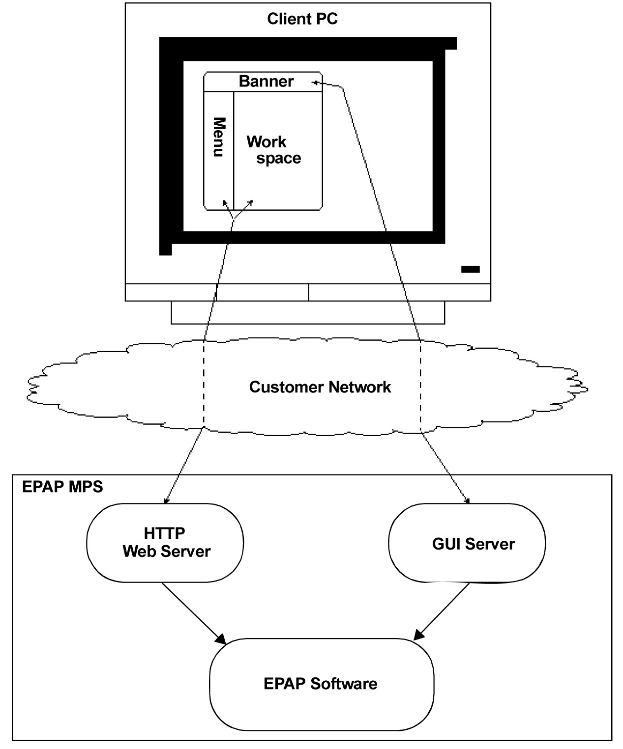

EPAP uses a Web-based user interface in a typical client-server paradigm. The front end appears on a Web browser. See Compatible Browsers for supported browsers. The back end operates on the MPS platform.
The graphical user interface display has three different sections:
  • Banner header section for displaying the real-time status of the MPS servers
  • Menu section for selecting desired actions
  • Work area section for filling out requested information and displaying results
The banner header sections communicate directly with the GUI Server process on the MPS. The menu and work area sections primarily consist of CSS3 and HTML5 generated by Ajax and CGI (Common Gateway Interface) scripts on the back end. Perl socket programming, along with CGI scripts, are used for the watchers. The banner displays the current EPAP IP and Status, PDBA IP and Status, Timer, Oracle Logo, Watchers, Alarm Indicators and Message History. The banner contains the EPAP A and B areas, both PDBA areas, and the busy icon.
An http or https (Hypertext Transfer Protocol) Web server starts the process of handling requests from browsers. It receives the requests and loads the document. If the document is a simple HTML file, the http or https Web server returns the document to the browser. The EPAP software may also connect with the GUI server to request actions be performed. HTML output from the script is returned to the browser and displayed.

Figure 3-1 shows the architecture view of the EPAP user interface.
Figure 3-1 Process Architecture View of the EPAP UI
img/c-epap-graphical-user-interface-epapgui-epapadmin-fig1.jpg

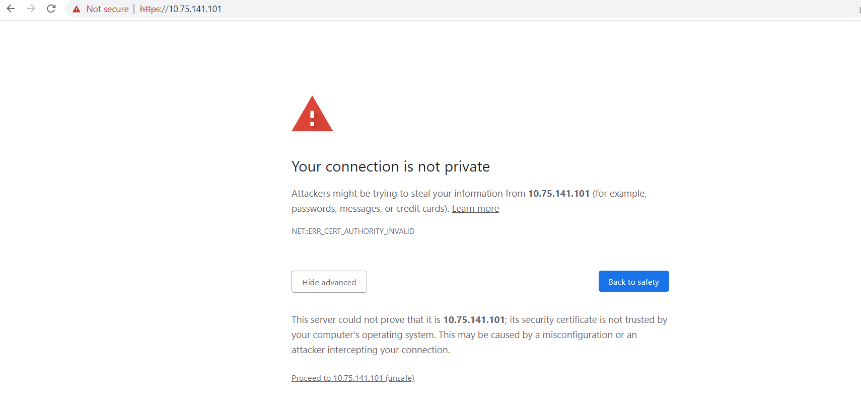

Opening HTTPS Mode Without Installing Security Certificate
Opening the EPAP GUI in HTTPS mode without installing the security certificate causes the following menu tabs to fail to open:

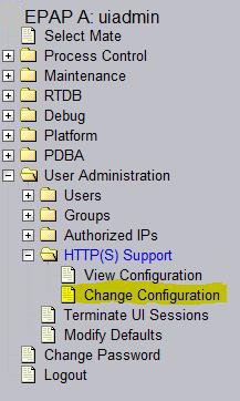

  3. On the EPAP A site, select User Administration, and then HTTP(S) Support, and then Change Configuration.
    Figure 3-4 Change Configuration Menu Option

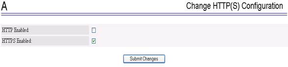

  4. Select the check box "HTTPS Enabled," and uncheck "HTTP Enabled."
    Figure 3-5 HTTPS Enabled
    img/t-https-redo-1.jpg
  5. Click on the Submit Changes button to enable HTTPS. A success screen will appear.

  8. Access the EPAP GUI using HTTPS.
    Figure 3-7 HTTPS Address Bar
    img/t-https-url.jpg
  9. Click on "Continue to this website (not recommended)."

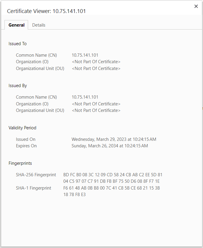

  10. Click on Certificate Error.
  11. In the popup window titled "Certificate Invalid," click on the View certificates link to display the Certificate dialog box.
    Figure 3-10 Certificate
    Certificate

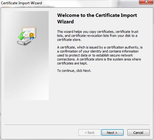

  12. Click Install Certificate... to begin the Certificate Import Wizard. The Certificate Import Wizard "Welcome" page is displayed:
    Figure 3-11 Certificate Import Wizard
    img/t-certificate-import-wizard.jpg
  13. Click on Next to display the Certificate Store page of the Certificate Import Wizard. The Certificate Import Wizard "Certificate Store" page is displayed:
    Figure 3-12 Certificate Store
    img/t-certificate-import-ie-8-9.jpg

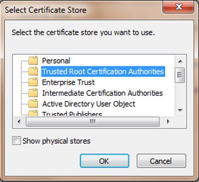

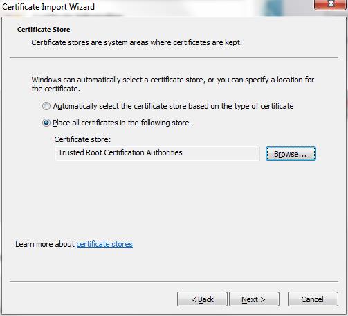

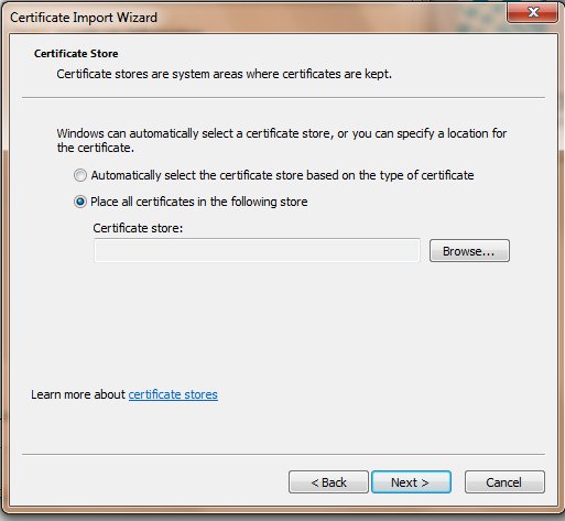

  14. Select the "Place all certificates in the following store" radio button, then click Browse to display the Select Certificate Store window.
    Figure 3-13 Select Certificate Store
    img/t-select-certificate-store.jpg
  15. Select the "Trusted Root Certification Authorities" option and click OK to display the Certificate dialog box.
    Figure 3-14 Certificate Store
    img/t-certificate-import-wizard-place-store.jpg

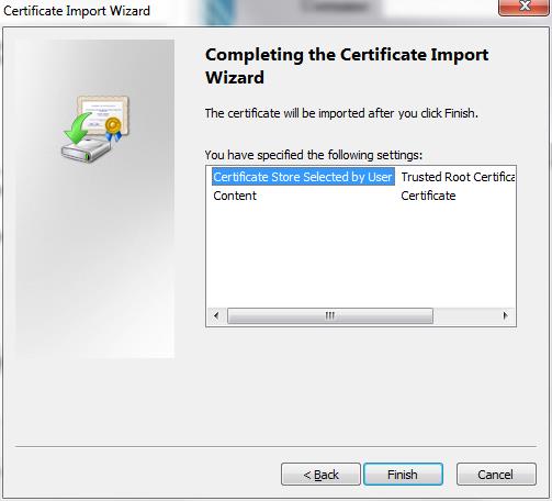

  16. Click Next. The Certificate Import Wizard "Completing the Certificate Import Wizard" page is displayed:
    Figure 3-15 Completing the Certificate Import Wizard
    img/t-certificate-import-wizard-complete.jpg

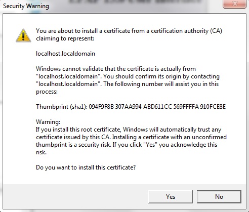

  17. Click Finish. If a Security Warning dialog box is displayed, click Yes.
    Figure 3-16 Security Warning
    img/t-certificate-import-warning.jpg
    Figure 3-17 Import Successful
    img/t-certificate-import-success.jpg
  18. After the message box "The import was successful" is displayed, click OK to close the Certificate Import Wizard.
    1. Select Tools, and then Internet Options.
    2. Select Security, and then Trusted Sites, and then Sites.
    3. Select the URL you just added, then select Remove, and then Close.
    4. Shut down all running instances of Chromium-based Edge Browser and restart the browser.
    The site's certificate should now be trusted.

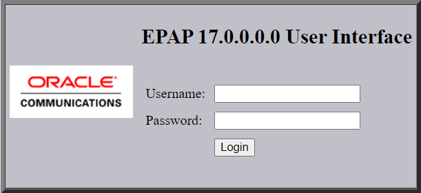

3.1.2 Login Screen

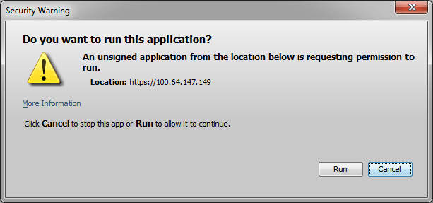

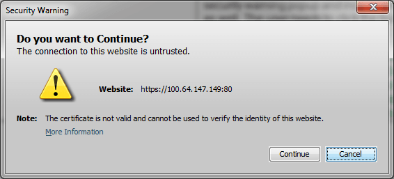

The first screen of the EPAP User Interface (UI) is the login screen. Two fields are prompted for on this screen: Username and Password. To log in, enter a valid user name and password, then click the Login button. These fields provide the user identification and verification.

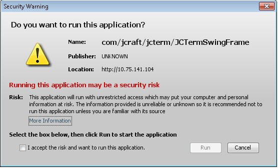

After logging in, a Security Warning dialog box alerts the user that the connection is untrusted. The user clicks Continue to proceed to the second Security Warning dialog box.
Figure 3-18 Security Warning for Untrusted Connection
img/security-warning-connection-epapgui.png
The second Security Warning dialog box asks the user whether to run the unsigned application. The user clicks Run to run the application.
Figure 3-19 Security Warning for Unsigned Application
img/security-warning-application-epapgui.png
When a user logs in successfully, the screen workspace indicates that the user is logged in.
When a user logs into the EPAP UI, the user does not need to log in again if the web browser session remains active and if no user in the admin user group changes the HTTPS configuration. Subsequent user authentication is handled with cookies, which are stored in the browser of the user and are retained during the browser operation. If a user in the admin user group changes the HTTPS configuration from only HTTP to only HTTPS, all logged -n users are disconnected. Similarly, if a user in the admin user group changes the HTTPS configuration from only HTTPS to only HTTP, all logged-in users are disconnected. For more information, see EPAP Support for HTTPS on GUI.
The user uses the Logout menu option to terminate the session. Alternatively, the user can be logged out by session inactivity (interval defined by User Administration), by disabling in the HTTP or HTTPS configuration, by administrator termination, and by selection of another window using another independent browser.

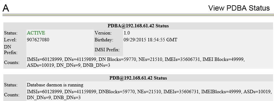

PDBA and EPAP Status
The first row of the EPAP banner displays the PDBA details with PDBA IP and its status. This displays the details of both the Local PDBA and Remote PDBA. The color coding is applied for the different statuses of the PDBA, as seen in Table 3-1.
Table 3-1 PDBA Status
Status Description Color Code
NONE No established connection currently exists to the EPAP GUI server. This can result because of connectivity problems or because the GUI server is not running Black
DOWN EPAP was contacted, but the PDBA software is not running Red
STANDBY PDBA software is running as STANDBY Blue
ACTIVE PDBA software is running as ACTIVE Green
REPLERR PDBA detected presence of a PDB replication failure Red
ACTIVE (By Proxy) PDBA is running on EPAP B using the PDBA Proxy feature, when EPAP A goes down Green
TERMINATED Connection has been closed by the server Red

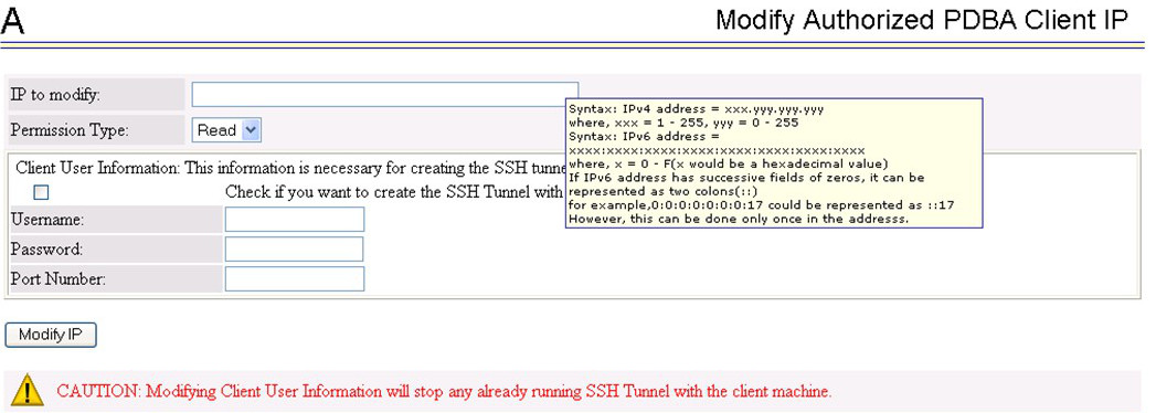

Workspace Syntax Checking
The web browser user interface uses layers of syntax checking to validate user input for text-entry fields.
  • Mouse-over syntax check: For many of the entry fields, a list of syntax hints can be displayed when the mouse is moved over the field.
  • Pop-up syntax checking: When the Submit button is clicked, syntax is verified on the client side by code running on the user's browser. Incorrect syntax appears in a pop-up window, which contains a description of the syntax error. When the window is dismissed, the error can be corrected, and the input submitted again.
  • Back-end syntax checking: When the Submit button has been clicked and the client side syntax checking has found no errors, back-end syntax checking is performed. If back-end syntax checking detects an error, it is displayed in the work space with an associated error code.

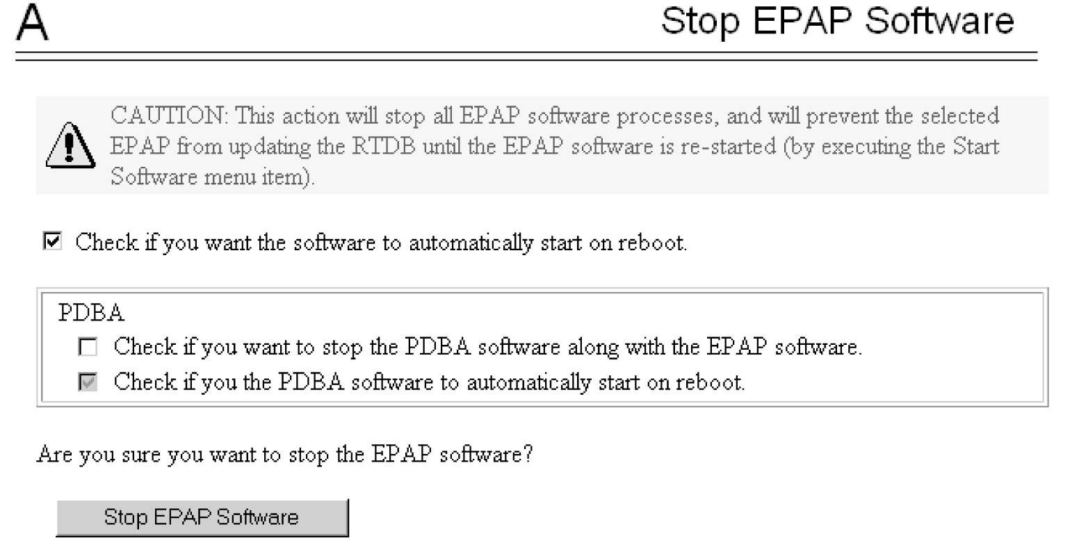

Stop EPAP Software
The Stop EPAP Software screen contains a button to confirm that the user wants to stop the software processes. It also allows a choice to automatically restart the software when the server reboots.
Figure 3-26 Stop EPAP Software Screen

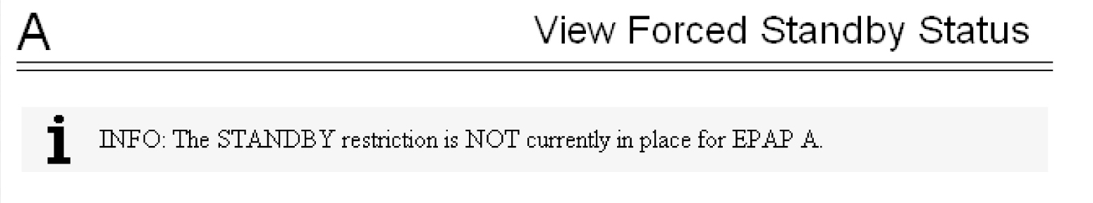

The Maintenance / Force Standby menu gives the user the ability to view the EPAP status and change the status.
The Force Standby menu provides the following actions:
View Status
The View Status screen displays whether or not EPAP is currently in a forced standby state.
Figure 3-27 View Forced Standby Status Screen
img/c-maintenance-menu-epapgui-epapadmin-fig3.jpg

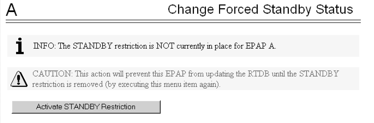

Change Status
The Change Status screen displays the current state of the selected EPAP. If the EPAP is not currently in forced standby mode, this screen lets the user force it into standby mode.
If the EPAP is currently in forced standby mode, the user can remove the standby restriction on the selected EPAP. See the Change Forced Standby Status screen.
Figure 3-28 Change Forced Standby Status Screen
img/c-maintenance-menu-epapgui-epapadmin-fig4.jpg
Table 3-4 Rules for Change Forced Standby Status
Semantic Rules
Error Code
A connection to the EPAP maintenance process must be available
E1005
Other Messages
Condition
Message Text
Standby restriction removed
Forced standby restriction removed from EPAP <selected EPAP>.
Forced standby completed
EPAP <selected EPAP> now in forced standby mode

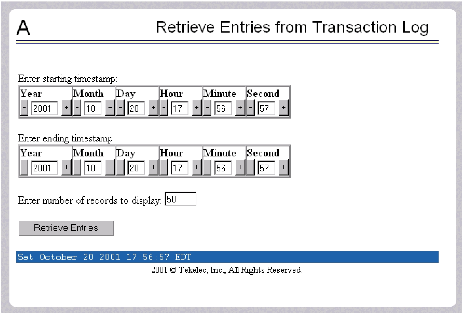

Retrieve Entries Screen
The Retrieve Entries screen lets the user retrieve log entries from the transaction log. The user is prompted for the start and end time range, along with the maximum number of records to display to the screen.
Figure 3-29 Retrieve Entries from Transaction Log Screen
img/c-maintenance-menu-epapgui-epapadmin-fig10.jpg
Table 3-6 shows the syntactic and semantic rules for retrieving transaction log entries.
Table 3-5 Rules for Retrieving Transaction Log Entries
Syntax Rules
Error Code
Dates/Times must be valid:
Field Valid Range
Year: 0000 - 9999
Month: 01 - 12
Day:01 - 31
Hour: 00 - 23
Minute: 00 - 59
Second: 00 - 59
(The day must be appropriate for the month and year.)
E1002
Maximum number of records must be in the range of 1 to 10,000
E1002
Semantic Rules
Error Code
Transaction log task must successfully process query
E1039
Transaction log task must create a file containing the result
E1040
UI task must successfully parse the result
E1041

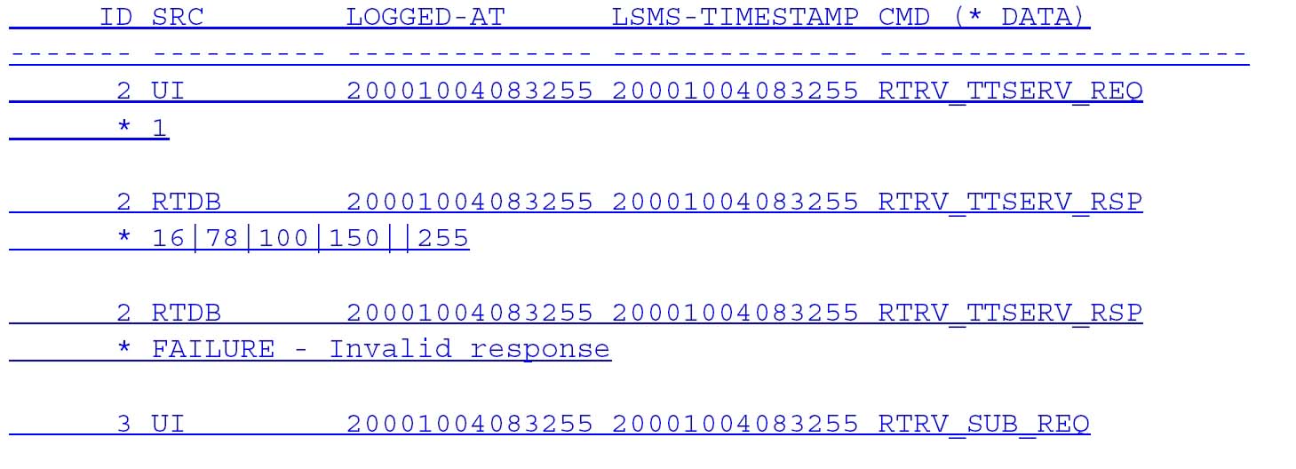

See Figure 3-30 for a sample of the output from the Retrieve Transaction Log, followed by a table with the output field descriptions.
Figure 3-30 Sample of Retrieve Transaction Log Entry Output
img/c-maintenance-menu-epapgui-epapadmin-fig11.jpg
Output Field Descriptions
Field
Description
ID
This field represents a unique identifier for the corresponding transaction. It is used internally with the Transaction log to correlate commands and responses. Any entries with the same ID are part of the same transaction. This field is used by customer service or engineering to investigate an issue.
SRC
This field stores the source of the corresponding transaction. The SRC field correlates to an internal task with the EPAP software and is used to determine the originator of the transaction. This field is used by customer service or engineering to investigate an issue.
LOGGED-AT
This field is the timestamp when the transaction was logged by the EPAP software. The format is: “yyyyMMddhhmmss” which indicates:
yyyy:
Year
MM:
Month
dd:
Day
hh:
Hour
mm:
Minute
ss:
Second
LSMS- TIMESTAMP
This field is the timestamp from the LSMS for the transaction.
CMD (* DATA)
This field contains a command identifier string and the command string from the LSMS. Command strings too long to be displayed on one line are not truncated.
For details about the contents of the Transaction Log, refer to Figure 3-30, which shows sample output as obtained by the Retrieve Entries action.

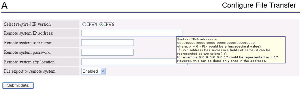

3.2.3.5 Configure File Transfer
This screen has several different functions. This screen can be used to:
  • Define the location of where the results of the automatic import are stored.
  • Provide the options for enabling/disabling the Automatic Export capability.
  • Provide a mechanism for testing the connection to the remote machine. This is done by using the username/ password and IP address provided to attempt to make an SFTP connection to the remote machine. The status of the connection is then displayed . This test is run anytime the data on this screen is entered or modified.
This screen consists of the following fields:
  • Choice of IPv4 or IPv6 remote system address:
    • The user is allowed to configure IPv4 only remote system address
    • The user is allowed to configure IPv6 only remote system address
    • On dual stack - the user is allowed to configure IPv4 or IPv6 remote system address
  • Remote System IP Address - the IP address from where the data will be exported (customer system).
  • Remote System User Name - required for logging onto the customer system
  • Remote System Password - required for logging onto the customer system. This password will be stored in encrypted format.
  • Remote System SFTP Location - the location of the directory on the customer system.
  • File Export to Remote System - this is used to return the results of the import file (default = enabled ).
The Configure File Transfer Screen is shown in Figure 3-31.
Figure 3-31 Configure File Transfer Screen
img/c-epap-configure-file-transfer.jpg

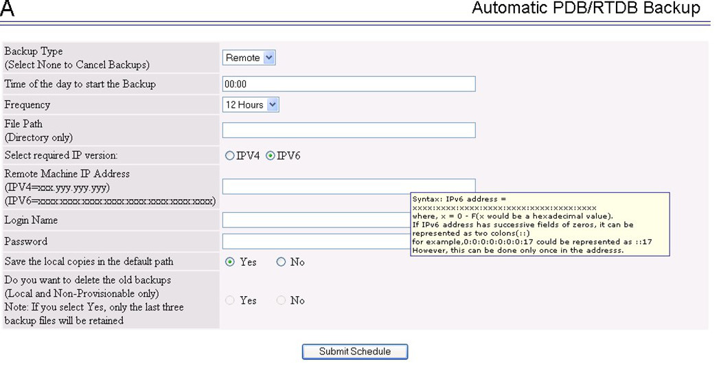

3.2.3.6 Automatic PDB/RTDB Backup
This screen is used to configure the Automatic PDB/RTDB Backup using either IPv4 or IPv6 addresses for a remote machine IP. The options for backup type are:
  • Local - Backup is stored on the same EPAP server
  • Mate - Backup is stored on the mate EPAP server
  • Remote - Backup is stored on a remote server
  • None - No backup is scheduled and cancel all previously scheduled backups. This will not affect a backup that is currently in progress.
    Verify there is adequate disk space (approximately 17 GB of disk space is required per backup) to store backup files locally, on the mate, or on a remote server. If there is inadequate disk space to store 3 copies on the local or mate, stored backups will not be overwritten, and backup operation failure alarms will be generated.
Use Table 3-9 as a guide when populating the Automatic PDB/RTDB Backup screen. See Figure 3-32.
Table 3-9 Mandatory and Optional Parameters
Parameter Backup Type
Local Mate Remote
Time of the day to start the Backup
Mandatory
Mandatory
Mandatory
Frequency
Mandatory
Mandatory
Mandatory
File Path (Directory only)
Optional
Optional
Mandatory
Remote Machine IP Address (xxx.xxx.xxx.xxx)
Not Applicable
Not Applicable
Mandatory
Login Name
Not Applicable
Not Applicable
Mandatory
Password
Not Applicable
Not Applicable
Mandatory
Save the local copies in the default path
Not Applicable
Optional
Mandatory
Do you want to delete the old backups (Local and Mate only) Note: If you choose Yes, only the last three backup files, including the current one will be kept.

Oracle recommends that this Automatic PDB/RTDB Backup be performed on a daily (24 hour) basis. If the 12-hour frequency is selected, the first backup will always be created in the AM. For example, if the Time of the day to start the backup is selected as 15:00, the first backup will be created at 3 AM and then subsequent backups at 12-hour intervals.
The default file path where subdirectories are created (in the mate and locally) is /var/TKLC/epap/free/.
In the case of mate and remote backup destinations, a local copy is saved (even if the option not to save the local copy was selected) if the transfer of the file fails after the backup has been created on the local machine. This file is located at the default file path. In the case of mate and remote backup destinations, a local copy is saved (even if the option not to save the local copy was selected) if the transfer of the file fails after the backup has been created on the local machine. This file is located at the default file path.
PDB only maintains a single copy of backup file, if this backup file is already present automatic backup will fail for PDB. Therefore it is required to schedule remote transfer of PDB backup file using Configure File Transfer as described in section Configure File Transfer.
If the Automatic PDB/RTDB backups are being directed to a remote server, then before scheduling:
  • The SFTP must be installed at the remote server
  • The connection to the remote server must be validated
  • Verify there is adequate disk space (approximately 17 GB of disk space is required per backup)
  • Verify user name and password.
When using the Automatic PDB/RTDB Backup screen to configure the automatic backup, follow these semantic rules:
Backup Type - Select None to cancel Backups.
Time of the Day should be in hh:mm 24 hour (14:03) format.
File path (in remote only) should be the absolute path from root /backups/xxxx
IP address should be in xxx.yyy.zzz.aaa format (192.168.210.111).
Password entered by the user will be displayed in asterisks (*)
Figure 3-32 Automatic PDB/RTDB Backup Screen

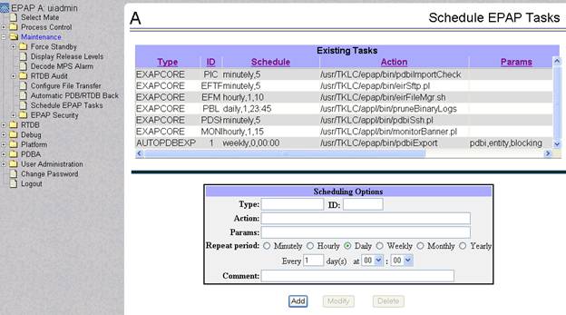

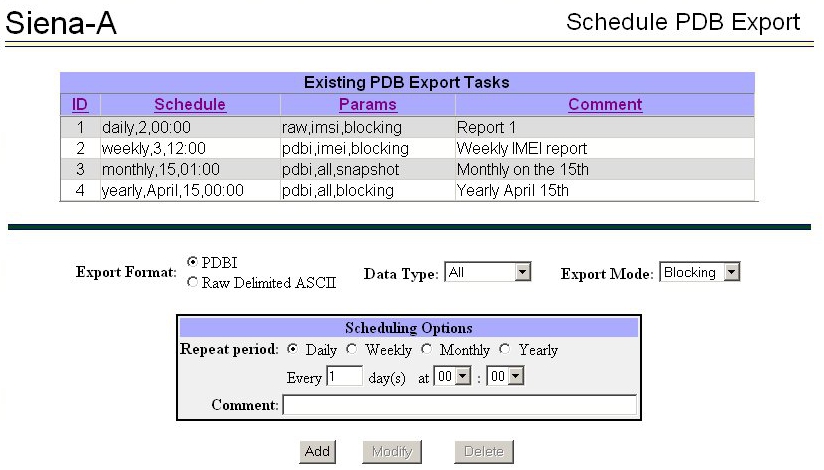

3.2.3.7 Schedule EPAP Tasks
Maintenance /Schedule EPAP Task
This screen is used to Schedule EPAP Tasks. Through this screen the customer has a choice of what tasks to be scheduled as well as the day and time of day for the execution of the tasks.
The tasks can be scheduled at a specific time for each of the following repeat periods: at specific minute, at specific hour, every N number of days (N can be up to 30), on specific days of the week, on a specified day of the month, or on a specified day of the year.
The Schedule EPAP Tasks screen is used to display any existing tasks and to create a task by specifying the type, ID, Action, Parameters, as well as the time and repeat period. In addition, a Comment field is available to describe the task.
Figure 3-33 is an example of the Schedule EPAP Tasks screen.
Figure 3-33 Schedule EPAP Tasks Screen
img/epapadmin-scheduletasks.jpg
Existing Tasks
The Existing Tasks portion at the top of the screen displays all currently scheduled tasks in table format.
Clicking on a column heading causes the entries in that column to be sorted, either alphabetically or numerically, depending on whether the column entries start with a letter or a number. Clicking the column again sorts the entries in the opposite order.
Clicking on a row causes the data contained in that task to be displayed in the data entry fields below the table, to view, modify or to delete the tasks.
Scheduling Options
The Scheduling Options section of the Schedule Tasks screen allows the user to choose how often to repeat the scheduled task and to specify the exact day and time. The appearance of this section changes depending on which Repeat Period radio button is selected:
The following fields are the same among the various Repeat Period selections (for more information
about fields that differ depending on the Repeat Period selected, see Variable Fields in Scheduling Options:
Type:
Type of the task can be specified in this field.
ID:
ID of the task can be specified in this field.
Action:
Action of the task specified by adding the path for the task.
Parameters:
Parameters for the task can be specified in this field.
Comment:
Use this optional field to add comments about Tasks. The content of this field is stored and displayed on the GUI, but it is not used otherwise.
The following sections describe how the Scheduling Options fields change depending on the Repeat Period that is selected.
Minutely Repeat Period
To schedule the task to be run minutely, select the minutely radio button, select the minute and optionally enter a comment.
Hourly Repeat Period
To schedule the task to be run hourly, select the hourly radio button, select the hour, select the minute and optionally enter a comment.
Daily Repeat Period
To schedule the task to be run every N days, select the Daily radio button, specify a number (N) to indicate that the Task should be run every N days, select the time and optionally enter a comment.
Although the maximum value allowed in the day(s) field is 30.
Weekly Repeat Period
To schedule the task to be run each week, select the Weekly radio button, select one or more days of the week, select the time and optionally enter a comment.
Monthly Repeat Period
To schedule the tasks to be run one day each month, select the Monthly radio button, select a numeric day of the month, select the time and optionally enter a comment.
For months that do not contain the number of days specified in the Day field, the task will run on the first day of the following month. (For example, if the Day field value is 29, the task will run on March 1 rather in February for any year that is not a leap year.)
Yearly Repeat Period
To schedule the tasks to be run one day each year, select the Yearly radio button, select a numeric day of the year, select the day of the month, select the time, and optionally enter a comment.
Add, Modify, and Delete Buttons
The Add, Modify, and Delete buttons are located at the bottom of the Schedule EPAP Tasks screen.
Add
To add a scheduled EPAP Task, enter all the data to describe the task, and click the Add button.
If the task, as described by the current data in the data entry fields, does not exactly match an existing task, a new task is scheduled. If the task exactly matches an existing task, an error message is displayed.
Modify
To modify a scheduled EPAP Task, click that task in the Existing Tasks in Tasks table, change any data that describes the task, and click the Modify button. The Modify button is selectable only when an entry in the Existing Tasks table at the top of the screen has been selected and one or more fields other than Type and ID on the screen have been changed.
Delete
To delete a scheduled Task, click that task in the Existing EPAP Tasks table, and click the Delete button.
The Delete button is selectable only when an entry in the Existing Tasks table at the top of the screen has been selected.

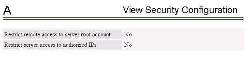

View Security Configuration
This menu allows the user to view security access for EPAP server on which the GUI is open. The user can view the following two configurations:
  • Restrict command line access to server root account.
  • Restrict server access to only authorized IPs or to all.
Configuration may be different on mate. To view configuration on mate, select mate from GUI and select Maintenance, and then EPAP Security, and then View Security Configuration on mate to view configuration on mate server.
When the value of Restrict remote access to server root account is set to No, root can access the server using ssh. When the value of Restrict remote access to server root account is set to Yes, root cannot directly access the server using ssh. However, the user can ssh to the server as epapdev and then do an su - root to access the server as root.
When the value of Restrict server access to authorized IPs is set to No, the server can be accessed from any IP address. When the value of Restrict server access to authorized IPs is set to Yes, the server can be accessed only from the IP addresses that are added in file /etc/hosts.allow.
Figure 3-35 View Security Configuration

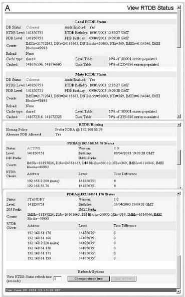

3.2.4.1 View RTDB Status
The RTDB / View RTDB Status screen displays the current level and birthday of the EPAP RTDBs. This selection displays the RTDB status information for both the selected EPAP and its mate. The status information reports the DB level and the DB birthday (date and time of the creation of the database). The RTDB Status refresh time can be viewed and changed with this screen.
The IMSI count returned from the RTDB and the IMSI count returned from the PDB may not match when there is both G-Flex and EIR data. Any IMSI created for EIR that does not have a G-Flex IMSI association is not included in the IMSI counts of the PDB. The PDB reports only G-Flex IMSIs. The RTDB reports the total of G-Flex and EIR IMSIs as one count.

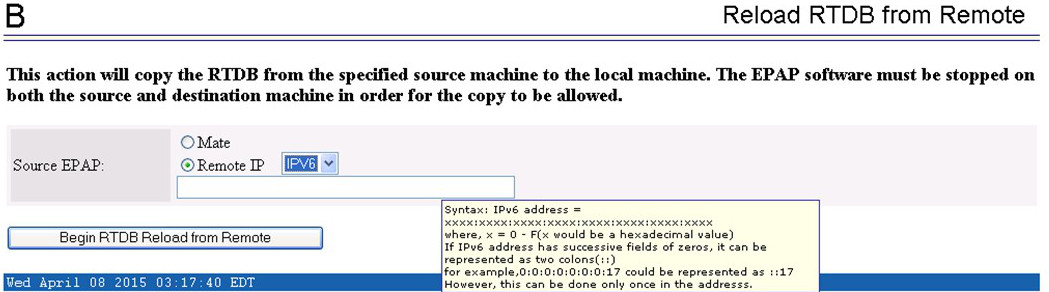

3.2.4.2.2 Reload RTDB from Remote
The RTDB / Maintenance / Reload RTDB from Remote screen makes a copy of the RTDB from the specified source machine, either the mate EPAP or a specified IPv4 or IPv6 address. Note: the EPAP software must be stopped on both of the machines involved:
Figure 3-38 Reload RTDB from Remote Screen
img/c-epap-reload-rtdb-from-remote.jpg
See Table 3-11 for the rules about reloading the RTDB from a remote.
Table 3-11 Rules for the Reload RTDB from Remote
Semantic Rules
Error Code
The mate EPAP must be available.
E1006
RTDB must acknowledge receipt of the reload request within 15 seconds.
E1031
Other Messages
Condition
Message Text
RTDB reload started.
RTDB reload started. You will be notified when the reload is complete.
RTDB reload complete.
RTDB successfully reloaded from mate EPAP. You must remove the STANDBY restriction (by logging in as user 'epapmaint' and executing the “Remove Standby Restriction” menu item) before the selected EPAP can update the RTDB.
To perform the copy of the RTDB contents, select the source machine and press the Begin RTDB Reload from Remote button.

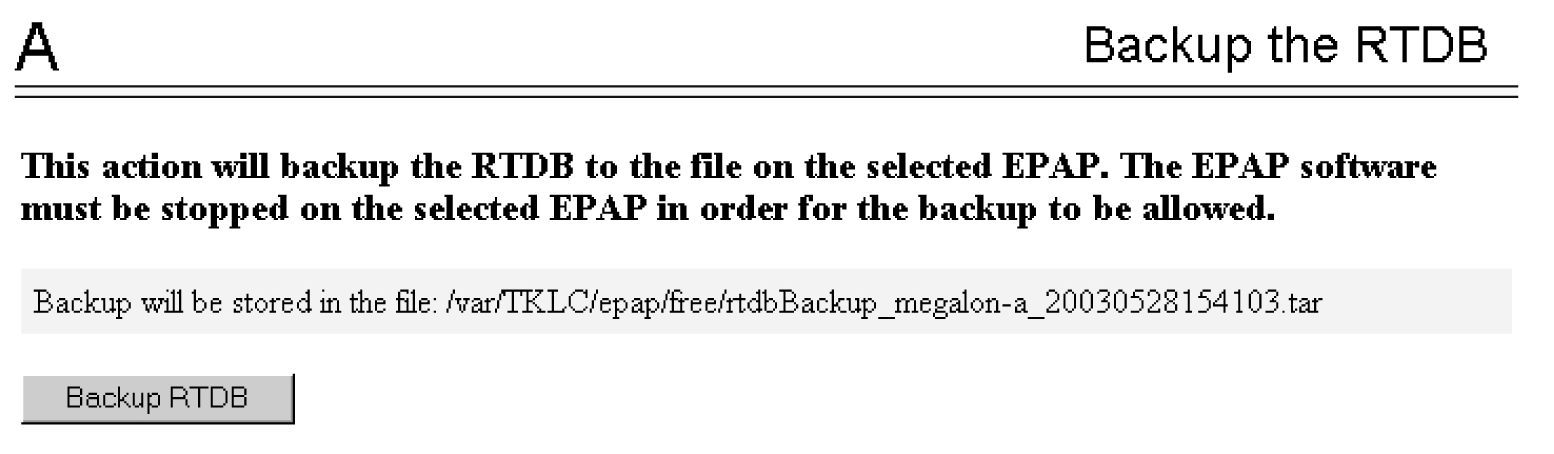

3.2.4.2.3 Backup the RTDB
The RTDB / Maintenance / Backup the RTDB screen allows the user to backup the RTDB to a specified file on the selected EPAP. The software must be stopped on the selected EPAP for the backup to be allowed to ensure that no updates are occurring:
See also Table 3-12 for the rules about backing up a RTDB.
Figure 3-39 Backup the RTDB Screen
img/c-rtdb-menu-epapgui-epapadmin-fig6.jpg

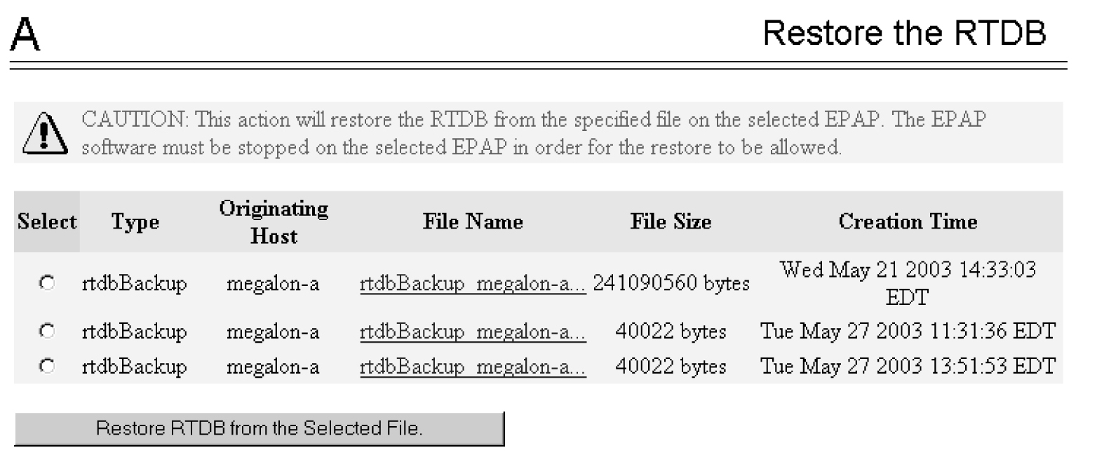

3.2.4.2.4 Restore the RTDB
The RTDB / Maintenance / Restore the RTDB screen allows the user to restore the RTDB from the specified file on the selected EPAP. The software must be stopped on the selected EPAP for the restore action to be allowed to ensure that no other updates are occurring.
If the RTDBs have different birthdates (as a result of this restore), you must perform a Reload RTDB from Remote on the mate EPAP (see Reload RTDB from Remote). RTDBs with different birthdates may not take updates or update the Service Module cards.
See also Table 3-13 for the rules about backing up a RTDB.
Figure 3-40 Restore the RTDB
img/c-rtdb-menu-epapgui-epapadmin-fig7.jpg
Table 3-13 Rules for Backup the RTDB Screen
Semantic Rules
Error Code
The device must exist.
E1019
Other Messages
Condition
Message Text
Backup started.
Backup in progress. The backup requires approximately 35 minutes. You will be notified when the backup is complete
Backup did not start.
Backup failed.
Backup complete.
RTDB backup complete.
To restore the RTDB contents from a specified file on the selected EPAP, stop the selected EPAP software. Select the proper file and click the Restore RTDB from the Selected File button.

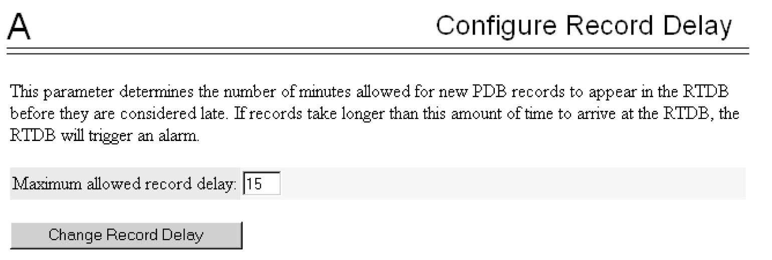

3.2.4.2.5 Configure Record Delay
The RTDB / Maintenance / Configure Record Delay screen allows the user to specify the time in minutes for new PDB records to appear in the RTDB. If records take longer to arrive at the RTDB than this amount of time, the records are considered late, and the RTDB triggers an alarm:
Figure 3-41 Configure Record Delay Screen
img/c-rtdb-menu-epapgui-epapadmin-fig8.jpg
To update the time period for the new PDB records to arrive at the RTDB, enter the desired value in the entry field, and click the Change Record Delay button.
Table 3-14 Rules for Configure Record Delay
Semantic Rules
Error Code
Other Messages
Condition
Message Text

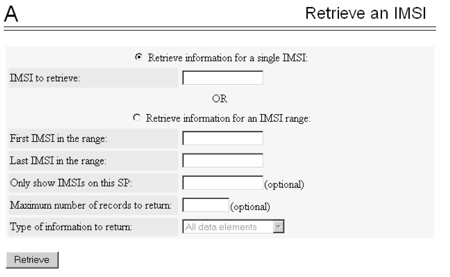

3.2.4.3.1 IMSI
The RTDB / Retrieve Records / IMSI screen allows the user to retrieve information about about an IMSI (International Mobile Subscriber Identity).
The output displays the following information about an IMSI:
  • IMSI ID
  • SP
  • NE data for the Service Provider of the IMSI (see Network Entity)
  • IMEI data if the IMSI being retrieved is associated with an IMEI (see IMEI)

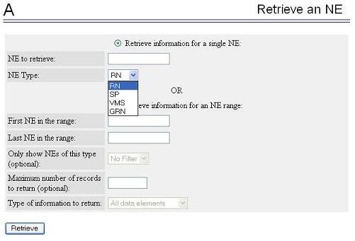

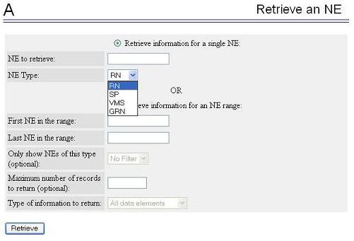

3.2.4.3.4 Network Entity
The RTDB / Retrieve Records / Network Entity screen allows the user to retrieve information about a network entity:
The output displays the following information about a network entity:
  • ID
  • Type (RN, SP, VMS, GRN)
  • Point Code
  • Routing indicator (RI)
  • Subsystem Number (SSN)
  • Cancel Called Global Title (CCGT)
  • New Translation Type (NTT)
  • New Nature of Address Indicator (NNAI)
  • New Numbering Plan (NNP)
  • Digit Action (DA)
  • SRF IMSI (Signaling Relay Function International Mobile Subscriber Identity)
  • DN Reference Count
  • IMSI Reference Count

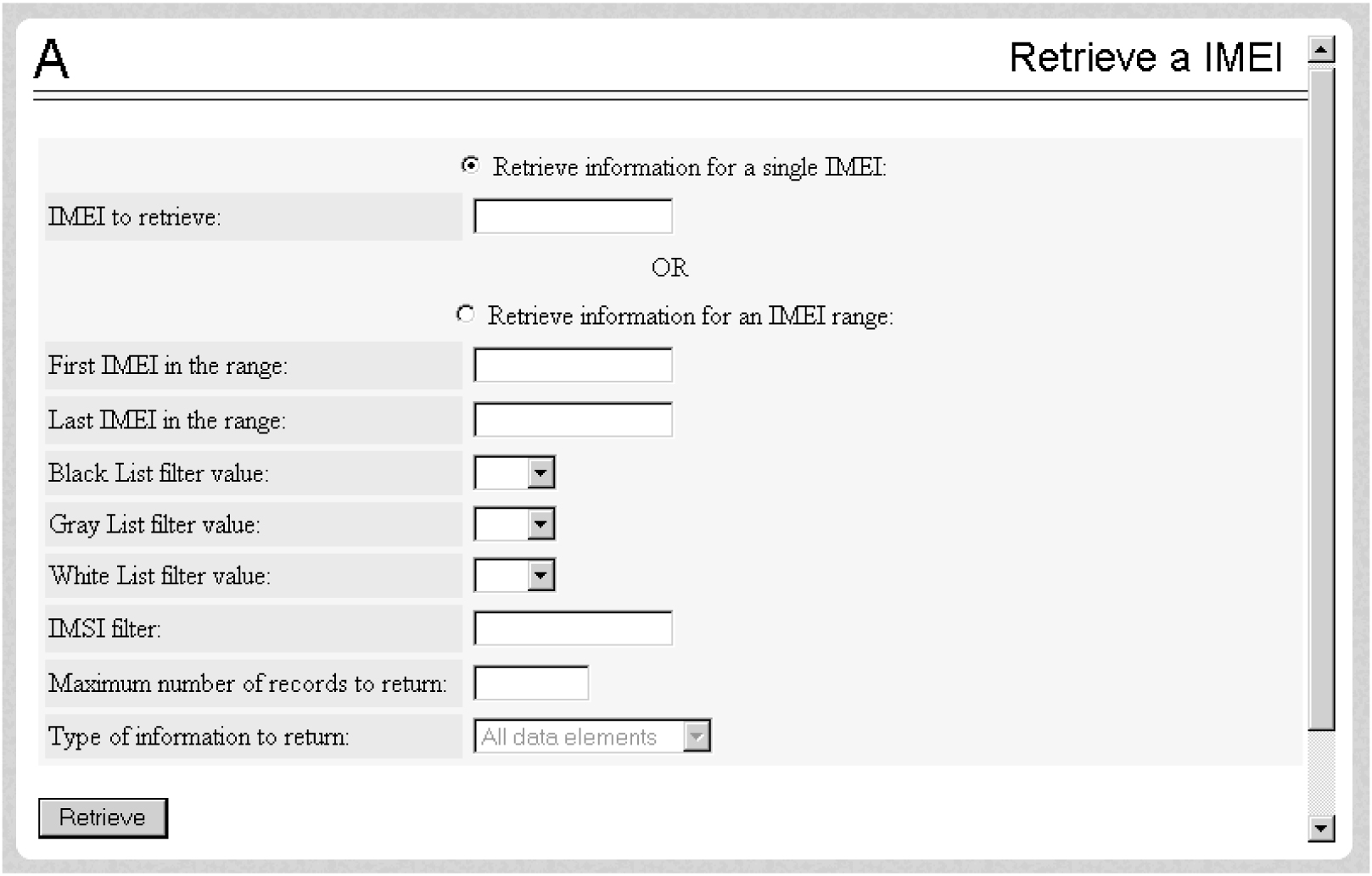

3.2.4.3.5 IMEI
The RTDB / Retrieve Records / IMEI screen allows the user to retrieve information about an IMEI.
The output information displays:
  • IMEI ID
  • Software Version (SVN)
  • Block list indicator
  • Gray list indicator
  • Allow list indicator
  • An IMSI reference count to show the number of IMSIs that are associated with an IMEI.
The IMEI lookup is performed on the IMEI blocks database when an IMEI is not present in the individual IMEI database.
3.2.4.3.6 IMEI Block
The RTDB / Retrieve Records / IMEI Block screen allows the user to retrieve information about a single IMEI (International Mobile Equipment Identity) block.
  • First IMEI
  • Last IMEI

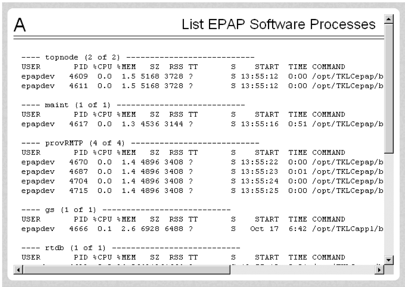

3.2.5 Debug Menu
The Debug Menu allows the user to view logs and list running processes.
The Debug menu actions are:

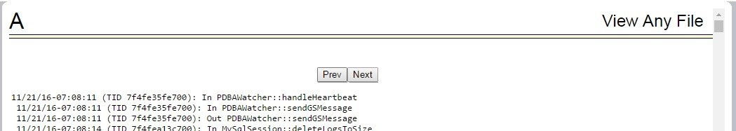

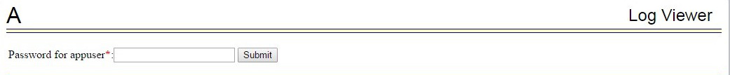

3.2.5.1 View Logs
The Debug / View Logs menu allows appuser to view such logs as the Maintenance, RTDB, Provisioning, RTDB audit, and UI logs.
The View Logs submenu under the Debug menu has the following options:
  • Maintenance Log
  • RTDB Log
  • Provisioning Log
  • RTDB Audit Log
  • CGI Log
  • GS Log

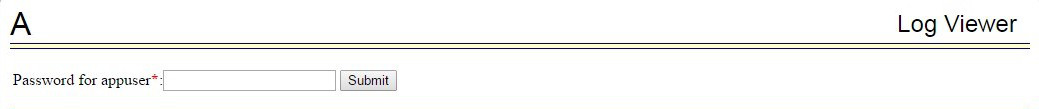

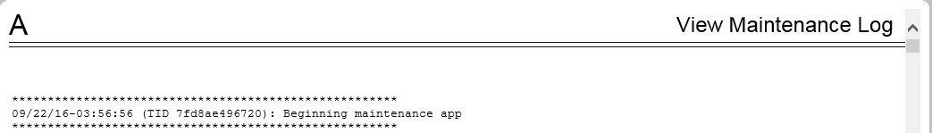

When any of the Debug / View Logs files are chosen, the process is the same. Complete the following steps to view logs from the EPAP GUI menu:
  1. Log in to the EPAP GUI
  2. Expand the Debug Menu, then Select View Logs
  3. Select a log file. Figure 3-42 shows the selection of the Maintenance log file:
    Figure 3-42 Maintenance Log Option

    The system may ask you to change the appuser password from the CLI. If you change the password from the root user, the system will prompt you to change the password again. If the password is changed using the appuser, you will not be asked to change it an additional time.
  4. Enter the password for the appuser and select the Submit button.
    Figure 3-43 Log Viewer Password Prompt
    img/c-viewlogs-password-prompt.jpg
    When the user selects the Submit button without entering the password, the following error will display:

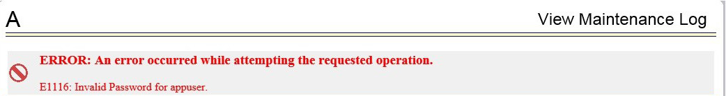

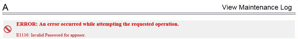

    If the user enters an invalid password, the following error will display:
    Figure 3-45 Log Viewer Invalid Password
    img/c-viewlogs-password-invalid.jpg

    On the successful submission of the appuser password, the log file contents will be visible in the work area. Figure 3-47 shows an example of the Maintenance Log:
    Figure 3-47 Maintenance Log Viewer
    img/c-viewlogs-success.jpg

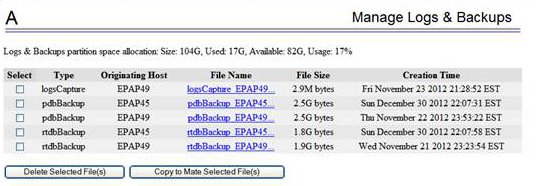

The Debug / Manage Logs and Backups displays the captured log files and allows the user to delete the copies no longer wanted or copy the selected file to the mate. See Figure 3-50 with an example of one recorded log file on the Manage Log Files screen.
Figure 3-50 Manage Logs & Backups Screen
img/epapadmin-managelogs.jpg
In the Manage Log Files screen, you can remove a log file by clicking the Delete? button and then the Delete Selected Capture File button. A successful removal message appears.

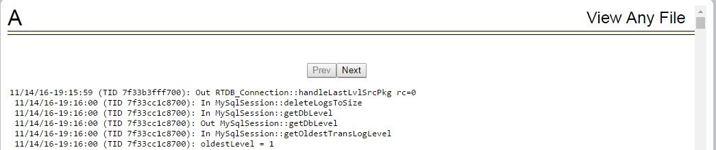

3.2.5.4 View Any File
The View Any File screen allows the user to "view any log file" on the system using the Log Viewer by entering the authorized password for the user appuser. Log files that cannot be viewed from this utility include:
  • exinit.log
  • slow-queries.log
  • platwrap.log
  • backupPdb.out
When the user enters a filename, the Log Viewer is invoked. Complete the following steps in order to view logs using the View Any File menu on the EPAP GUI:
  1. Log in to the EPAP GUI.
  2. Expand the Debug menu.
  3. Select View Any File.
    Figure 3-51 View Any File on the EPAP GUI Menu
    img/c-viewanyfile-epap-gui-menu.jpg

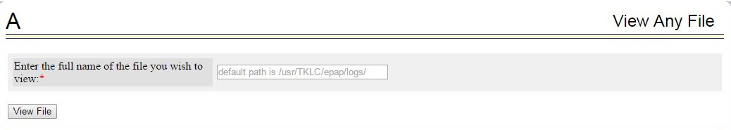

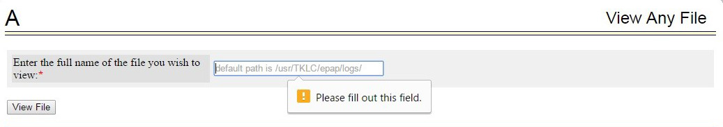

  4. On selecting View Any File, the user will be asked to enter the filename to be viewed. The default path for this utility is /usr/TKLC/epap/logs. The filename field is mandatory (marked with * as displayed in Figure 3-52).
    Figure 3-52 View Any File Filename Prompt
    img/c-viewanyfile-filename-prompt.jpg
    When the View File button is selected without inputting the filename, the following error will be displayed:
    Figure 3-53 View Any File With Missing Filename
    img/c-viewanyfile-without-filename.jpg

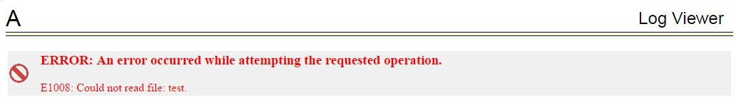

    If the user inputs a non-existing filename in the /usr/TKLC/epap/logs directory, the following error will be displayed:
    Figure 3-54 View Any File Non-Existing Filename Error
    img/c-viewanyfile-nonexisting-filename.jpg
  5. After entering a valid filename, the user will be prompted for the appuser password, as displayed in Figure 3-55:
    Figure 3-55 View Any File Password Prompt
    img/c-viewanyfile-password-prompt.jpg

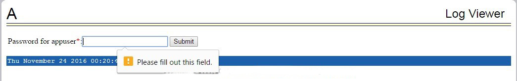

    When the Submit button is selected without inputting the appuser password, the following error will be displayed:
    Figure 3-56 Log Viewer Appuser Missing Password
    img/c-viewanyfile-log-viewer-password-prompt.jpg
    When the user inputs an invalid appuser password, the following error will be displayed:
    Figure 3-57 Log Viewer Invalid Password Error
    img/c-viewanyfile-invalid-password.jpg

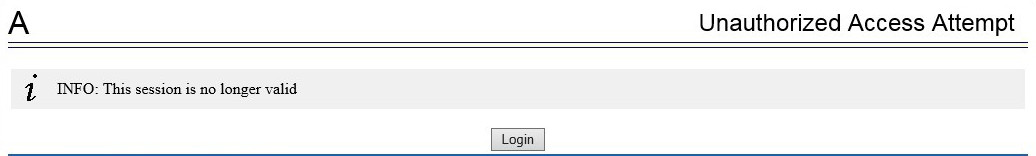

    If the user enters a password after the GUI expires and selects Submit, the following error will be displayed:
    Figure 3-58 Expired Log Viewer
    img/c-viewanyfile-expired-log.jpg
  6. After entering the valid appuser password, the log file contents will be visible in the work area, along with the log file name as its heading, as displayed in Figure 3-59:
    Figure 3-59 Log Viewer
    img/c-viewanyfile-log-viewer.jpg
Opening any file in this window displays the requested file in the file viewer window. All files are viewed with the same file viewing utility. For details about this utility, see Platform Menu.

3.2.5.5 List EPAP Processes
The Debug / List EPAP Processes screen shows the EPAP processes started when the EPAP boots or with the “Start EPAP software” prompt. The /usr/ucb/ps -auxw command generates this list. The operating system's manual page for the ps command thoroughly defines the output for this command. Figure 3-60 shows an example of the format of the process list.
Figure 3-60 Example of List EPAP Processes Output
img/c-debug-menu-epapgui-epapadmin-fig11.jpg

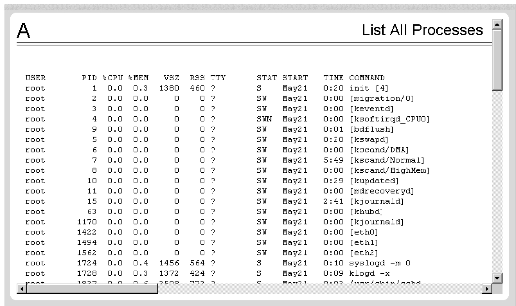

3.2.6.2 List All Processes
The Platform / List All Processes screen lists all processes running on the selected EPAP. The /usr/ucb/ps -auxw command generates this list. The operating system's manual page for the ps command thoroughly defines the output for this command. Figure 3-61 shows an example of the process list.
Figure 3-61 List All Processes Screen
img/c-platform-menu-epapgui-epapadmin-fig5.jpg
The process list shown here will not be the same on your EPAP servers. The output from this command is unique for each EPAP, depending on the EPAP software processes, the number of active EPAP user interface processes, and other operational conditions.

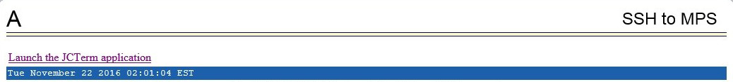

  3. Select Launch the JCTerm application:
    Figure 3-63 JCTerm Application Launch Window

  4. The JCTerm jar, along with the Jzlib jar and Jsch jar, are self-signed. Accept the security check that follows and select Run to launch the JCTerm applet for the SSH to MPS interface:
    Figure 3-65 JCTerm Security Check Window
    img/c-epap-sshtomps-jcterm-security-check.jpg

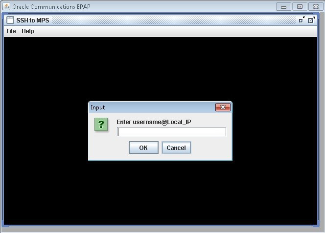

  5. The SSH to MPS window will be displayed. A user name and password is required. On the EPAP configured in the dual stack configuration, both the IPv4 and IPv6 addresses for Local EPAP are accepted for the SSH. The following formats are accepted:
    1. sshusername@<IPv4 IP>
    2. sshusername@<IPv4 IP>:<Port>
    3. sshusername@IPv6 IP>
    4. sshusername@[IPv6 IP>]
    5. sshusername@[IPv6 IP>]:<Port>
    Figure 3-66 SSH to MPS Log in Window
    img/c-epap-sshtomps-login.jpg

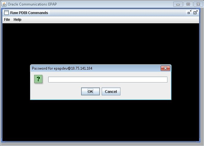

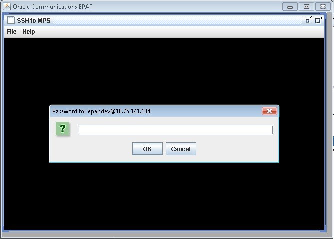

    After inputting a user name and local EPAP IP, the password prompt window appears, as displayed in Figure 3-67:
    Figure 3-67 SSH to MPS Password Prompt Window
    img/c-epap-sshtomps-password.jpg

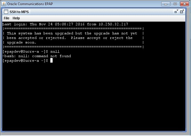

    After a successful log in, the SSH window opens and can be used to perform SSH communications, as displayed in Figure 3-68:
    There is no limit to the maximum number of concurrent sessions opened using the SSH to MPS utility.
    Figure 3-68 SSH to MPS Interface
    img/c-epap-sshtomps-interface.jpg

To schedule an export to be run one day each month, select the Monthly radio button, select a numeric day of the month, select the time, and optionally enter a comment, as shown in Figure 3-190.
To schedule an export to be run one day each year, select the Yearly radio button, select a numeric day of the year, select the time, and optionally enter a comment, as shown in Figure 3-191.

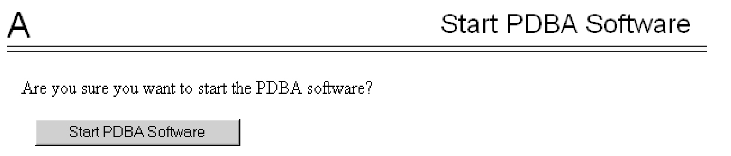

The PDBA / Process Control / Start PDBA Software screen begins the execution of the PDBA software. When you click the Start PDBA Software button, the EPAP attempts to start the software. Starting the PDBA software from this menu item also clears the indicator that keeps the software from being automatically started on a reboot.
Figure 3-69 Start PDBA Software Screen
img/c-pdba-menu-epapgui-epapadmin-fig6.jpg
When you choose the Start PDBA Software screen, another screen requires to confirm your choice to start the PDBA software. Click the Start PDBA Software button.

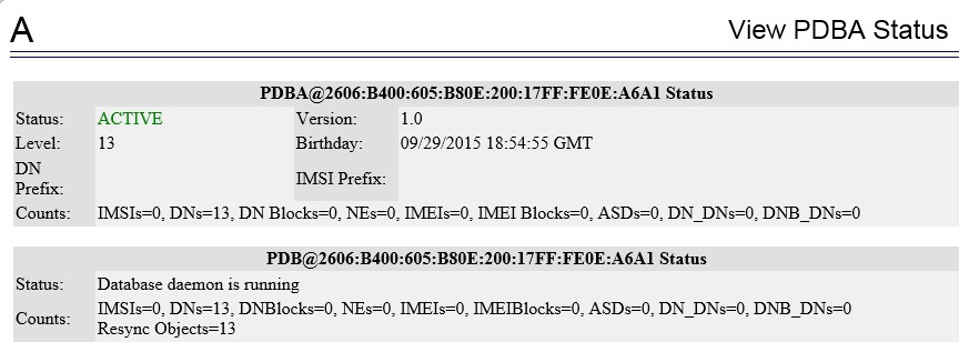

3.2.7.4 View PDBA Status
The PDBA / View PDBA Status screen is used to display the current status of the selected PDBA. The PDBA Status refresh time can be viewed and changed with this screen.
When the EPAP is configured in the dual stack configuration, the PDBA will also have both IPs. On the "View PDBA Status" screen, the PDBA IP will be in the IP version format with which the EPAP GUI is accessed. If the EPAP GUI is accessed using the IPv6 IP, then the PDBA IP will be displayed in the IPv6 format. If the EPAP GUI is accessed using the IPv4 IP, then the PDBA IP will be displayed in the IPv4 format.
See the rules for screen in Table 3-18.
Figure 3-70 View PDBA Status With IPv6 PDBA IP
img/c-view-pdba-status-ipv6.jpg
Figure 3-71 View PDBA Status With IPv4 PDBA IP
img/c-view-pdba-status-ipv4.jpg
Table 3-18 Rules for Viewing PDBA Status

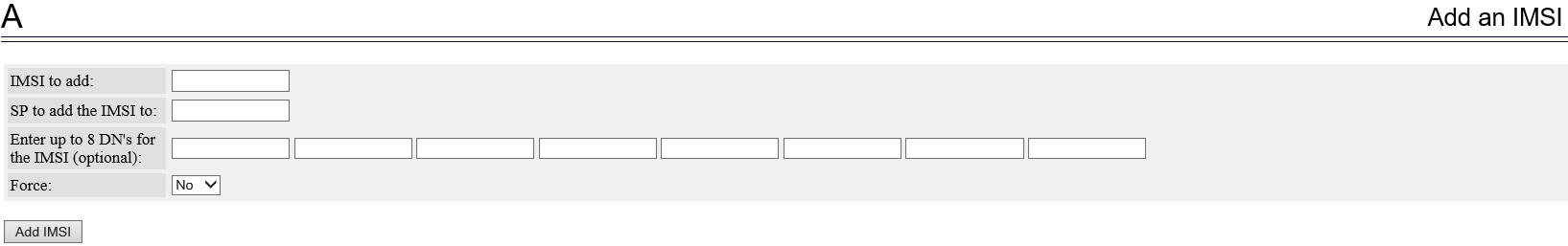

Add an IMSI
The PDBA / Manage Data / IMSI / Add an IMSI screen promptsthe user for the fields needed to add an IMSI to the Provisioning Database (PDB). If there is a conflicting subscription in the PDB, the user is prompted to confirm before overwriting the existing subscription.
There are limited numbers of digit combinations in the first 9 digits of DN/IMSI/IMEI. In DN/IMSI the first 9 digits consist of the Country Code, Area Code, Service Provider Code, and up to 2 digits of Subscriber number. The maximum number of 9digs is 65K entries, which includes two (2) default entries representing 5 digits and 6 digits, regardless if they are provisioned or not. If all provisioned DN/IMSIs have digits greater than or equal to 7, the max number of 9digs parsed from these provisioned DNs cannot exceed 65K - 2 entries.
Figure 3-72 Add an IMSI
img/epap-add-imsi.jpg
Table 3-19 describes the rules that the EPAP user interface uses to perform the Add IMSI action. The table also describes other messages generated by the EPAP user interface while performing this action.

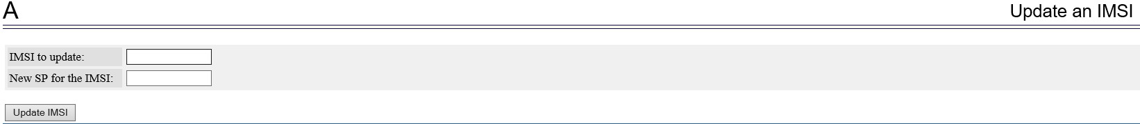

Update an IMSI
The PDBA / Manage Data / IMSI / Update IMSI screen prompts the user for the fields necessary to change the SP for an IMSI in the Provisioning Database (PDB).
Figure 3-73 Update an IMSI
img/epap-update-imsi.jpg

Retrieve an IMSI
The PDBA / Manage Data / IMSI / Retrieve an IMSI screen prompts you for the fields necessary to retrieve subscriptions from the Provisioning Database (PDB). If you specify the ‘last IMSI’, all subscriptions from the ‘first IMSI’ and ‘last IMSI’ are shown.
Figure 3-74 shows a sample output form the Retrieve IMSI menu action. The choices for the drop down menu for the Display field are: All data elements, Network entries only, and Record counts only.
Figure 3-74 Retrieve IMSI Screen
img/c-pdba-menu-epapgui-epapadmin-fig18.jpg

Update an IMSI Range
The PDBA / Manage Data / IMSI Range / Update an IMSI Range screen prompts the user for the fields necessary to change the SP for an IMSI Range in the Provisioning Database (PDB).
This screen is only operational to SOG customers.
Table 3-23 describes the rules that the EPAP user interface uses to perform the Update IMSI action. The table also describes other messages generated by the EPAP user interface while performing this action.
Table 3-23 Rules for Update IMSI Range Screen
Syntax Rules
Error Code
The user must enter a valid SP.
E1002
The user must enter a valid IMSI.
E1002
Semantic Rules
Error Code
This menu option is valid only if the G-Flex feature is installed.
None
The IMSI must exist in the PDB.
E1015
The SP must exist in the PDB.
E1014
The PDBI must return a success status.
E1017
Other Messages
Condition
Message Text
The subscription was modified.
Subscription successfully modified.
The subscription was not modified.
Subscription not modified.

Retrieve an IMSI Range
The PDBA / Manage Data / IMSI Range / Retrieve an IMSI Range screen prompts you for the fields necessary to retrieve subscriptions from the Provisioning Database (PDB). All subscriptions overlapping the Beginning IMSI to the Ending IMSI are shown. The Ending IMSI is not required.
Table 3-25 describes the rules that the EPAP user interface uses to perform the Retrieve IMSI action. The table also describes other messages generated by the EPAP user interface while performing this action.
Table 3-25 Rules for Retrieve IMSI Range Screen
Syntax Rules
Error Code
E1002
E1002
Semantic Rules
Error Code
This option is valid only if the G-Flex feature is installed.
None
The type of output data to return may only be entered if a range of IMSIs is requested.
None
The maximum number of records to return may only be entered if a range of IMSIs is requested.
None
E1017
Other Messages
Condition
Message Text
No records were found.
Query returned no subscriptions.

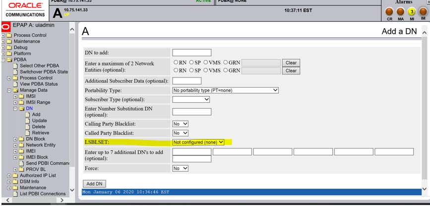

Add a DN
The PDBA / Manage Data / DN / Add a DN screen prompts you for the fields needed to add a DN to the Provisioning Database (PDB). If there is a conflicting subscription in the PDB, you are prompted to confirm before overwriting the existing subscription.
It is not recommended to provision more than 60 millions of Number Substitute of DN (NSDN). Higher NSDN data causes a failure in the RTDB reload from the PDB.
See Figure 3-75 for an example of the Add a DN screen.
Figure 3-75 Add a DN Screen
img/epap-add-dn.jpg
Table 3-26 describes the rules that the EPAP user interface uses to perform the Add DN action. The table also describes other messages generated by the EPAP user interface while performing this action.
Table 3-26 Rules for Add DN Screen
Syntax Rules
Error Code
E1002
E1002
The user must enter a valid DN.
E1002
Semantic Rules
Error Code
The user may enter a portability type only if an SP was not specified.
None
E1014
The RN must exist in the PDB.
E1014
The user may enter up to 8 DNs
None
The user may elect to force the transaction to be entered into the PDB, even if there are conflicting subscriptions.
None
E1017
E1068
PDBI command ent-sub, on the creation of one or more DNs on the same NE with no IMSI, supports a response "PDBI_MAX_IMSI9DIG_LIMIT" if the to-be provisioned DN causes the first 9 digits go above its max limit of 65,000.
Other Messages
Condition
Message Text
The new subscription already exists in the PDB.
This subscription conflicts with an existing subscription.
The new subscription was attempting to overwrite an existing DN.
One of the DNs already exist in the PDB. If you choose to overwrite the existing subscription, all data associated with the existing DN will be lost.
The subscription was added.
Subscription successfully added.
The subscription was not added.
Subscription not added.

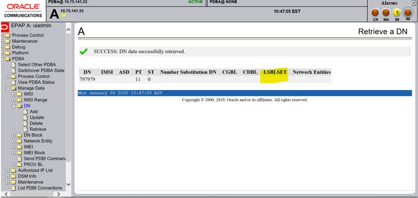

Retrieve a DN
The PDBA / Manage Data / DN / Retrieve a DN screen prompts you for the fields necessary to retrieve subscriptions from the Provisioning Database (PDB) by DN.
Figure 3-78 Retrieve a DN
img/epap-retrieve-dn.jpg
Table 3-29 describes the rules that the EPAP user interface uses to perform the Retrieve DN action. The table also describes other messages generated by the EPAP user interface while performing this action.
Table 3-29 Rules for Retrieve DN Screen
Syntax Rules
Error Code
E1002
E1002
The user must enter a valid RN.
E1002
Semantic Rules
Error Code
The user may enter a range of DNs.
None
The user may only enter an SP if G-Flex or G-Port is installed.
None
The user may only enter an RN if G-Port or INP is installed.
None
The type of output data to return may only be entered if a DN range is requested.
None
The maximum number of records to return may only be entered if a DN range is entered.
None
E1017
Other Messages
Condition
Message Text

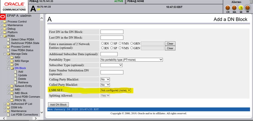

Add a DN Block
The PDBA / Manage Data / DNBlock / Add a DN Block screen prompts you for the fields needed to add a DN block to the Provisioning Database (PDB). If there is a conflicting subscription in the PDB, you are prompted to confirm before overwriting the existing subscription.
Figure 3-79 Add a DN Block
img/epap-add-dn-block.jpg

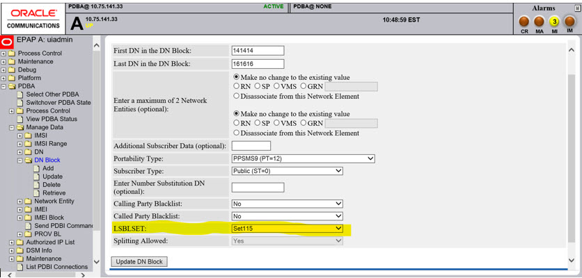

Update a DN Block
The PDBA / Manage Data / DNBlock / Update a DN Block screen prompts you for the fields necessary to change the SP or RN for an DN block in the Provisioning Database (PDB).
Figure 3-80 Update a DN Block Screen
img/c-pdba-menu-epapgui-epapadmin-fig31.jpg
Table 3-31 describes the rules that the EPAP user interface uses to perform the Update DN Block action. The table also describes other messages generated by the EPAP user interface while performing this action.
Table 3-31 Rules for Update a DN Block Screen
Syntax Rules
Error Code
E1002
E1002
E1002
Semantic Rules
Error Code
This menu option is valid only if the G-Port or INP feature is installed.
None
E1014
E1022
The DN block must exist in the PDB.
E1016
The DN may not be already associated with an IMSI.
E1018
The user my enter a portability type only if an RN is specified.
None
E1017
Other Messages
Condition
Message Text

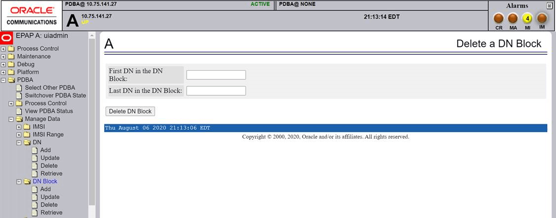

Delete a DN Block
Figure 3-81 Delete a DN Block Screen
Delete a DN Block
The PDBA / Manage Data / DNBlock / Delete a DN Block screen prompts the user for the fields necessary to remove a DN block from the Provisioning Database (PDB).
Table 3-32 describes the rules that the EPAP user interface uses to perform the Delete DN Block action. The table also describes other messages generated by the EPAP user interface while performing this action.
Table 3-32 Rules for Delete DN Block Screen
Syntax Rules
Error Code
E1002
Semantic Rules
Error Code
The menu option is valid only if the G-Port or INP feature is installed.
None
The subscription must exist in the PDB.
E1012
E1017
Other Messages
Condition
Message Text
The subscription was deleted.
Subscription successfully deleted.
The subscription was not deleted.
Subscription not deleted.

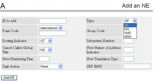

The PDBA / Manage Data / Network Entity menu lets you add, update, delete, and retrieve network entities in the Provisioning Database (PDB).
The PDBA / Manage Data / Network Entity menu provides these actions:
Add Network Entity
The PDBA / Manage Data / Network Entity / Add Network Entity menu selection prompts for the fields needed to add a network entity to the Provisioning Database (PDB).
Figure 3-83 Add an NE Example
img/c-new-feat-epap-9-5-12.jpg
Table 3-34 describes the rules that the EPAP user interface uses to perform the Add Network Entity action. The table also describes other messages generated by the EPAP user interface while performing this action.

Retrieve Network Entity
The PDBA / Manage Data / Network Entity / Retrieve Network Entity screen prompts you for the fields necessary to retrieve a Network Entity from the Provisioning Database (PDB).
Figure 3-84 Retrieve an NE Example
img/c-new-feat-epap-9-5-15.jpg

There are limited numbers of digit combinations in the first 9 digits of DN/IMSI/IMEI. In IMEI, the first 9 digits are Type Allocation Code (TAC), which must not exceed 250,000 combinations.
Table 3-39 describes the rules that the EPAP user interface uses to perform the Add IMSI action. The table also describes other messages generated by the EPAP user interface while performing this action.
Table 3-39 Rules for Add IMSI Screen
Syntax Rules
Error Code
E1002
E1002
E1002
Semantic Rules
Error Code
None
E1014
None
None
E1017
PDBI command ent-sub, on the creation of a single IMSI with or without DNs, supports a response "PDBI_MAX_IMSI9DIG_LIMIT" if the to-be provisioned IMSI causes the first 9 digits go above its max limit of 65,000. E1066
"PDBI_MAX_IMEI9DIG_LIMIT" if to-be provisioned IMEI causes the first 9 digits to go above its max limit of 250,000. E1067
Other Messages
Condition
Message Text

Retrieve an IMEI
The PDBA / Manage Data / IMEI / Retrieve is used to retrieve IMEI data from the Provisioning Database (PDB). The following functions are performed from this screen:
  • Retrieve an IMEI and its associated List Types (WL,GL,BL), SVN, and 0 to 400 IMSIs. The IMEI must be specified. Once IMSIs are added as part of the add IMEI option, the user will be allowed to add up to 400 IMSIs per IMEI using PDBI commands or import scripts, with no more than 8 IMSIs to be added per command.
  • Retrieve a range (1 through 10,000) of IMEIs that match either filter:
    • Have a specific List Type set to YES.
    • Have an IMSI that matches the requested IMSI.
  • Retrieve the beginning and ending IMEI. At least one optional filter type must be specified.
See Figure 3-86 for an example of the Retrieve a IMEI screen.
Figure 3-86 Retrieve an IMEI Screen
img/c-pdba-menu-epapgui-epapadmin-fig43.jpg

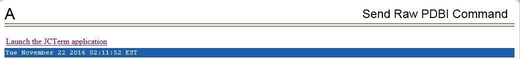

3.2.7.5.8 Send PDBI Command
The PDBA / Manage Data / Send PDBI Command screen allows only the epapdev user to type PDBI (Provisioning Database Interface) commands that are not explicitly covered by the menu set. This uses WebStart Java technology, which works independent of the web browser once it is launched. The dynamic JNLP files are used to launch the WebStart application. The Send PDBI Command screen appears under the PDBA / Manage Data menu.
A socket connection to the PDBI is available; however, all other functions, including creating and ending transactions, must be entered manually. For additional information about the PDBI commands, refer to Provisioning Database Interface User's Guide.

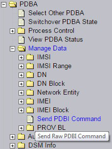

  2. Select PDBA, and then Manage Data, and then Send PDBI Command, as displayed in Figure 3-87:
    Figure 3-87 Send PDBI Command on the EPAP GUI Menu
    img/c-sendpdbicmd-epap-gui-menu.jpg
    Figure 3-90 JCTerm Security Check Window
  5. The Send PDBI Command window will be displayed, as show in the following figure:
