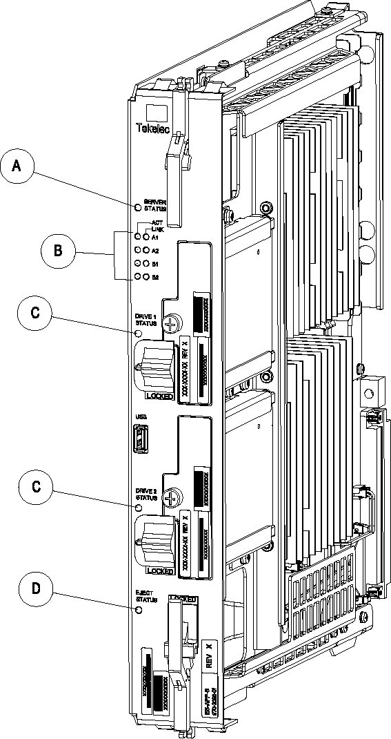

Figure 2-1 shows the E5-APP-B card LEDs on the front panel
Figure 2-1 E5-APP-B Card LEDs
img/card-overview-2.jpg
The following light-emitting diode (LED) status indicators can be found on the E5-APP-B card:
  • One Server Status indicator (A)
  • Four E-Net link and Active LED status indicators (B)
  • Two drive module status indicators (C)
  • One Card Eject status indicator (D)
