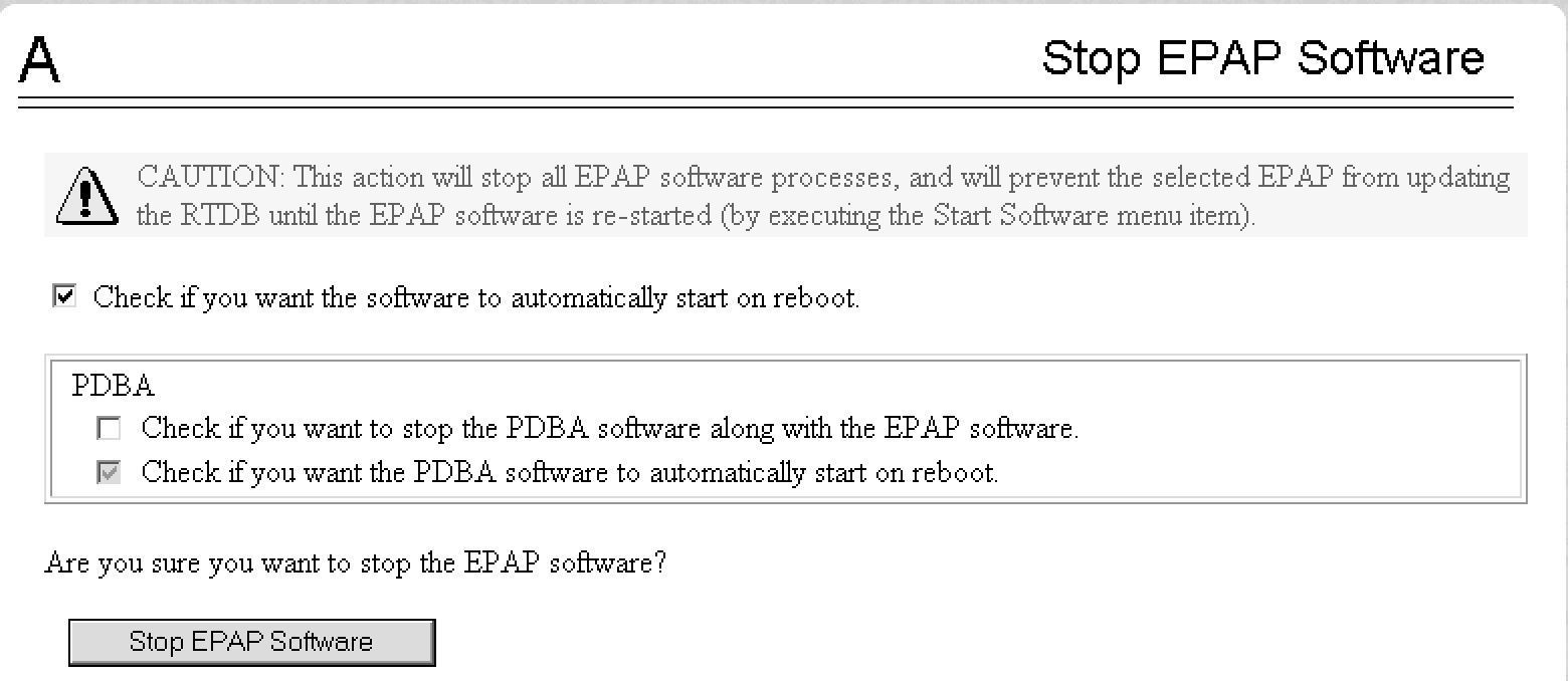

  3. From the EPAP Menu, select Process Control>Stop Software.

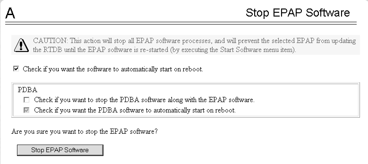

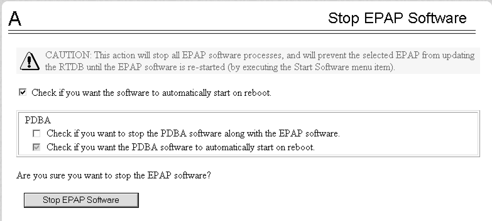

  4. In the Stop EPAP Software screen as shown in Figure 3-1, click Stop EPAP Software.
    DO NOT select the option to stop the PDB along with the EPAP software.
    Figure 3-1 Stop EPAP Software
    Stop EPAP Software

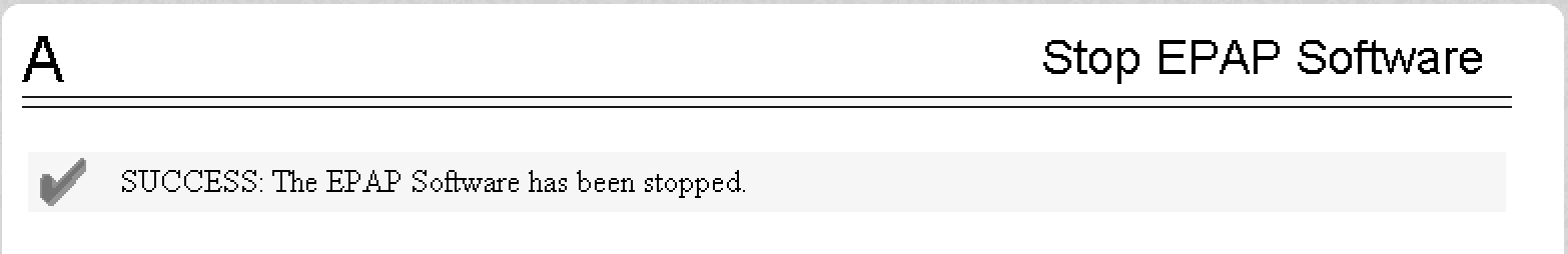

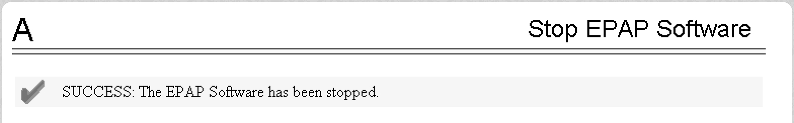

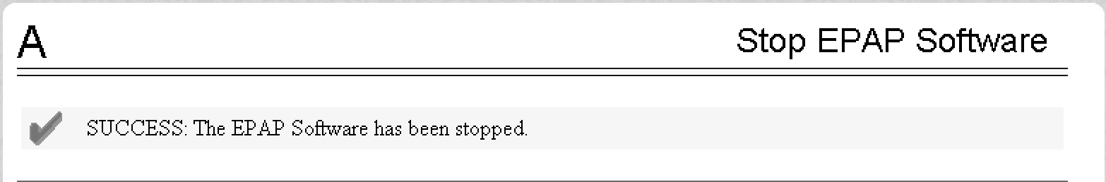

    After the EPAP software has stopped successfully, the screen shown in Figure 3-2 is displayed.
    Figure 3-2 EPAP Software Successfully Stopped

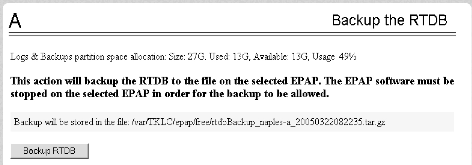

  5. From the EPAP menu, select RTDB>Maintenance>Backup RTDB.
    The screen shown in Figure 3-3 is displayed.

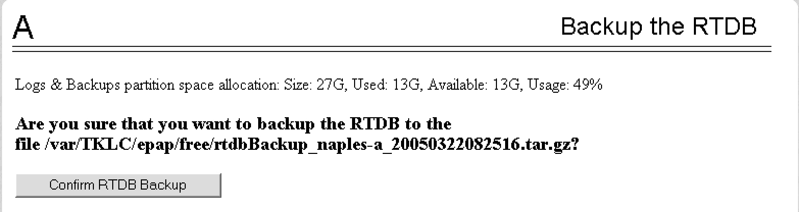

    Figure 3-3 Backup the RTDB
    Backup the RTDB
  6. Record the file name as shown in this example:
    /var/TKLC/epap/free/rtdbBackup_naples-a20050322082516.tar.gz
  7. Click Backup RTDB.
    The screen shown in Figure 3-4 displays a request for confirmation.
    Figure 3-4 Backup the RTDB Confirmation

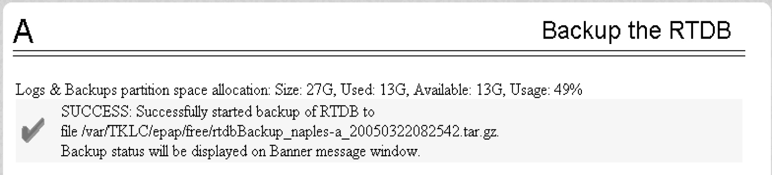

  8. Click Confirm RTDB Backup.
    After the backup completes successfully, the screen shown in Figure 3-5 is displayed.
    Figure 3-5 Backup the RTDB - Success

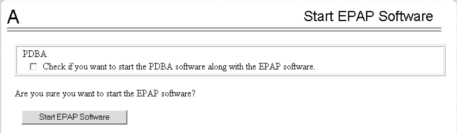

  9. Select Process Control>Start Software from the EPAP Menu.

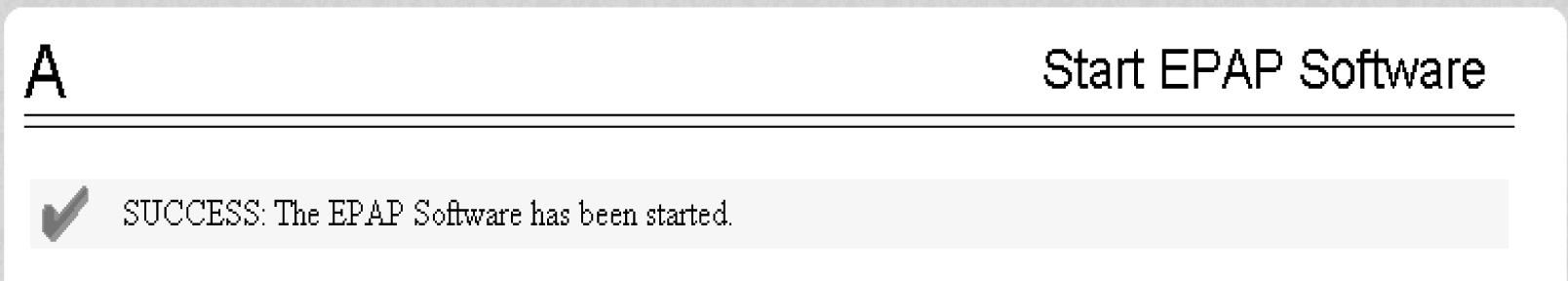

  10. On the Start EPAP Software screen shown in Figure 3-6, click Start EPAP Software.
    Figure 3-6 Start EPAP Software
    Start EPAP Software
    After the EPAP software has started successfully, the screen in Figure 3-7 is displayed.
    Figure 3-7 Start EPAP Software - Success

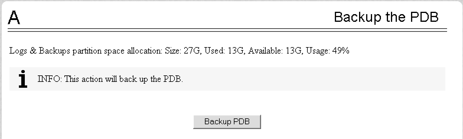

  3. From the EPAP Menu, select PDBA>Maintenance>Backup>Backup the PDB.
  4. In the Backup the PDB screen shown in Figure 3-8, click Backup PDB.
    Figure 3-8 Backup the PDB
    Backup the PDB

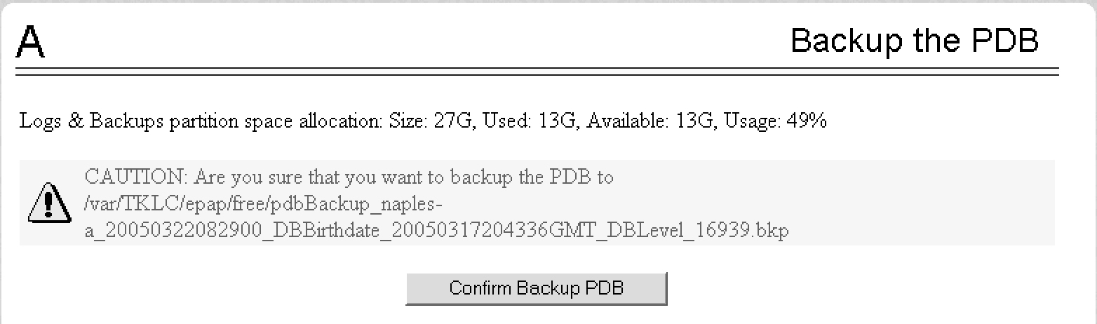

    The resulting screen, shown in Figure 3-9, displays a button to confirm the request to backup the PDB and the file name.
    Figure 3-9 Backup PDB Confirmation
  5. Record the file name.
    In this example, the file name is:
    /var/TKLC/epap/free/pdbBackup_naples-a_20050322082900_DBBirthdate_20050317204336GMT_DBLevel_16939.bkp

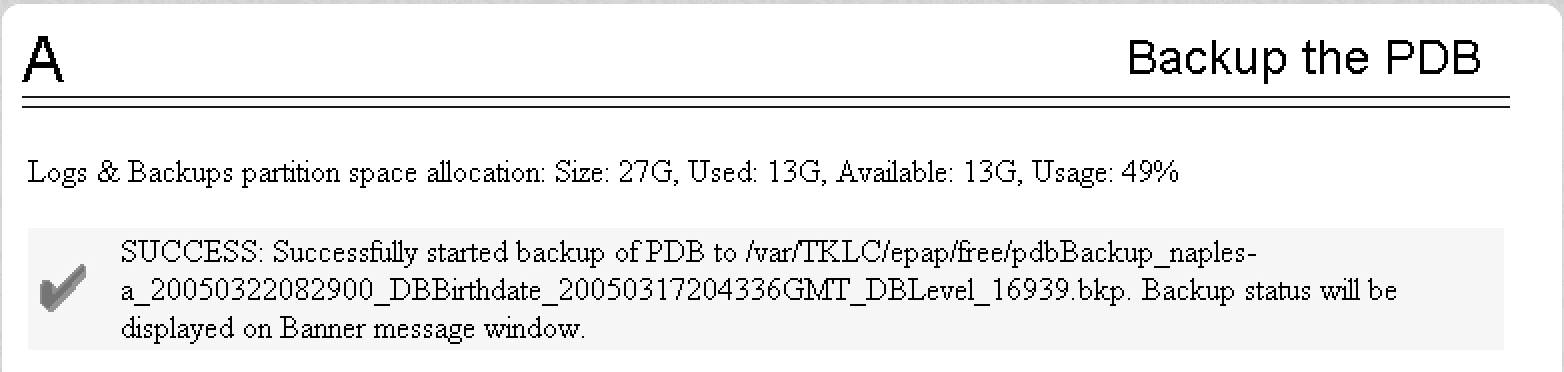

  6. Click Confirm Backup PDB.
    After the backup completes successfully, the screen shown in Figure 3-10 is displayed:
    Figure 3-10 Backup the PDB - Success

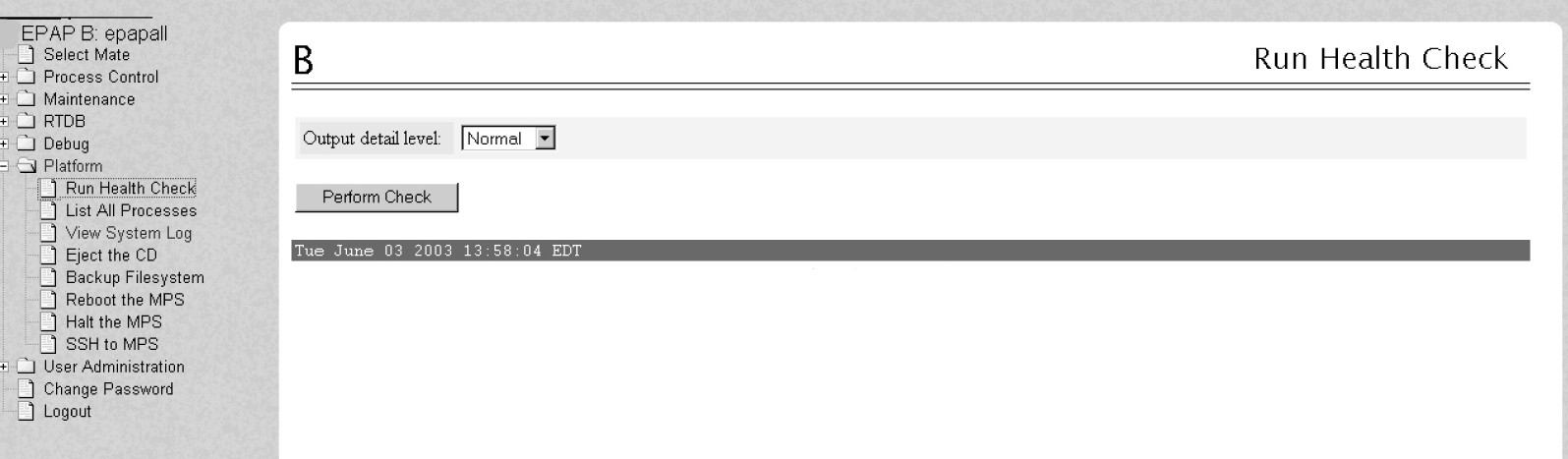

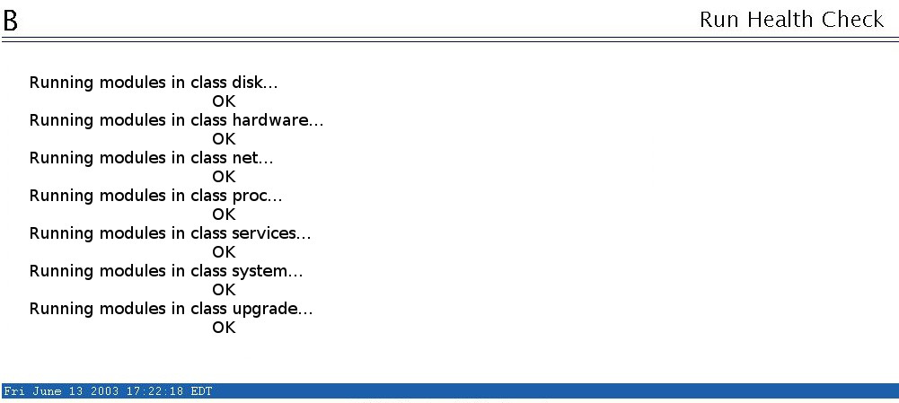

3.2.1 Health Check Outputs
System health check utility syscheck output can be Normal (brief) or Verbose (detailed), depending on how it is initiated.
Normal Output
The following example is an output in Normal format:
[admusr@EPAP17 ~]$ sudo syscheck
Running modules in class disk...
                                 OK
Running modules in class hardware...
                                 OK
Running modules in class net...
                                 OK
Running modules in class proc...
                                 OK
Running modules in class services...
                                 OK
Running modules in class system...
                                 OK
Running modules in class upgrade...
                                 OK
LOG LOCATION: /var/TKLC/log/syscheck/fail_log

3.3.2 Running syscheck Through the EPAP GUI
Refer to Administration Guide for more details and information about logins and permissions.
  1. Log in to the User Interface of the EPAP GUI (see Accessing the EPAP GUI).
  2. Check the banner information above the menu to verify that the EPAP about which system health information is sought is the one that is logged into.
  3. If it is necessary to switch to the other EPAP, click the Select Mate menu item.
  4. When the GUI shows you are logged into the EPAP about which you want system health information, select Platform > Run Health Check as shown in the following window.
    Figure 3-11 Run Health Check
    Run Health Check
  5. On the Run Health Check window, use the pull-down menu to select Normal or Verbose for the Output detail level desired.
  6. Click the Perform Check button to run the system health check on the selected server.
    The system health check output data is displayed. The example shown in Figure 3-12 shows Normal output with errors.
    Figure 3-12 Displaying System Health Check on EPAP GUI

  4. Select Process Control>Stop Software to ensure that no other updates are occurring. The screen in Figure 3-13 displays:
    Figure 3-13 Stop EPAP Software
    Stop EPAP Software
  5. When you stopped the software on the selected EPAP, the screen in Figure 3-14 displays:
    Figure 3-14 Stop EPAP Software - Success

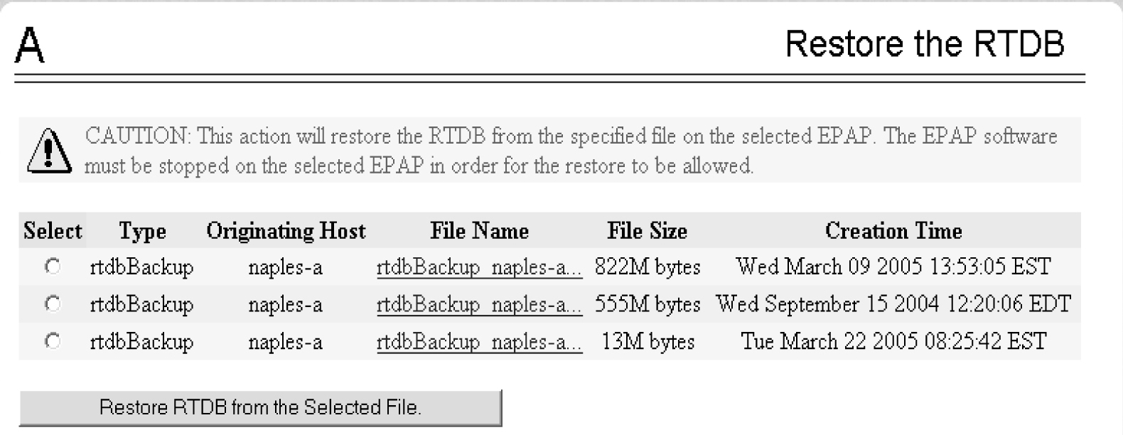

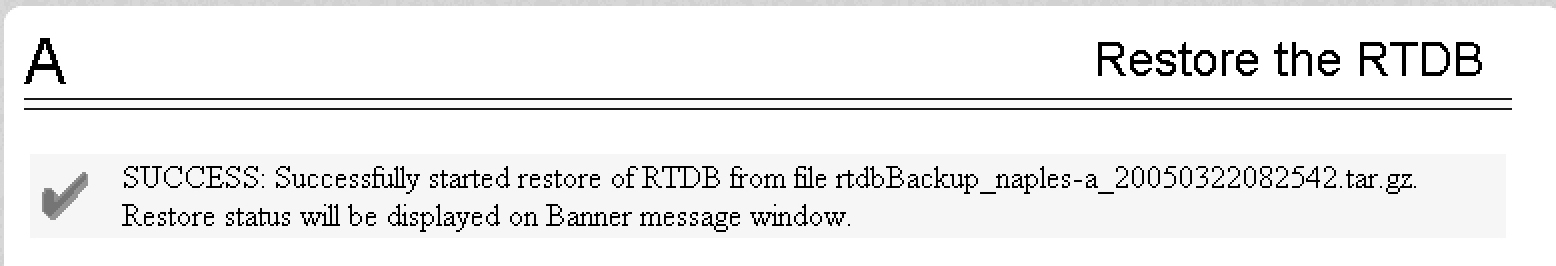

  6. Select RTDB>Maintenance>Restore . The screen shown in Figure 3-15 displays:
    Figure 3-15 Restoring the RTDB
    Restoring the RTDB
  7. On the screen shown in Figure 3-15, select the file that was transferred in Figure 3-15. Click Restore the RTDB from the Selected File.

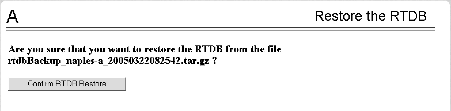

  8. To confirm restoring a file, click Confirm RTDB Restore shown in the screen for RTDB in Figure 3-16:
    Figure 3-16 Restore the RTDB Confirm
  9. When restoring the file is successful, the screen shown in Figure 3-17 displays:
    Figure 3-17 Restore the RTDB - Success
    The screen in Figure 3-18 displays:
    Figure 3-18 Stop EPAP Software
    Stop EPAP Software
  5. When you stopped the software on the selected EPAP, the screen in Figure 3-19 displays:
    Figure 3-19 Stop EPAP Software - Success

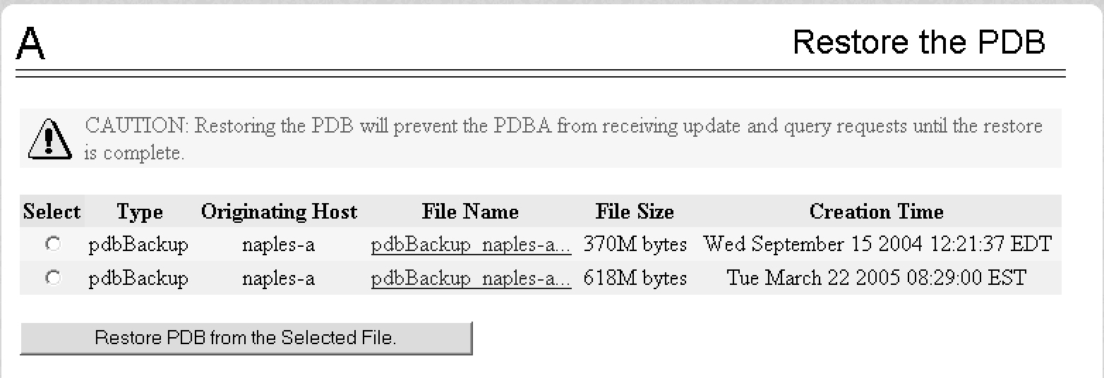

  6. Select PDBA>Maintenance>Backup>Restore the PDB.
    The screen shown in Figure 3-20 displays:
    Figure 3-20 Restoring the PDB
    Restoring the PDB
  7. On the screen shown in 6, select the file that was transferred in Restoring Databases from Backup Files.
    Click Restore the PDB from the Selected File.
  8. Click Confirm PDB Restore.

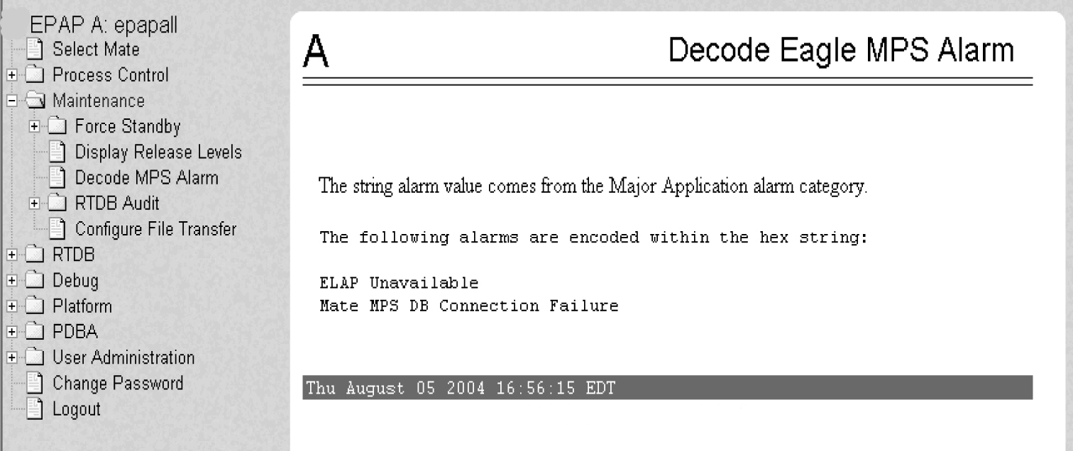

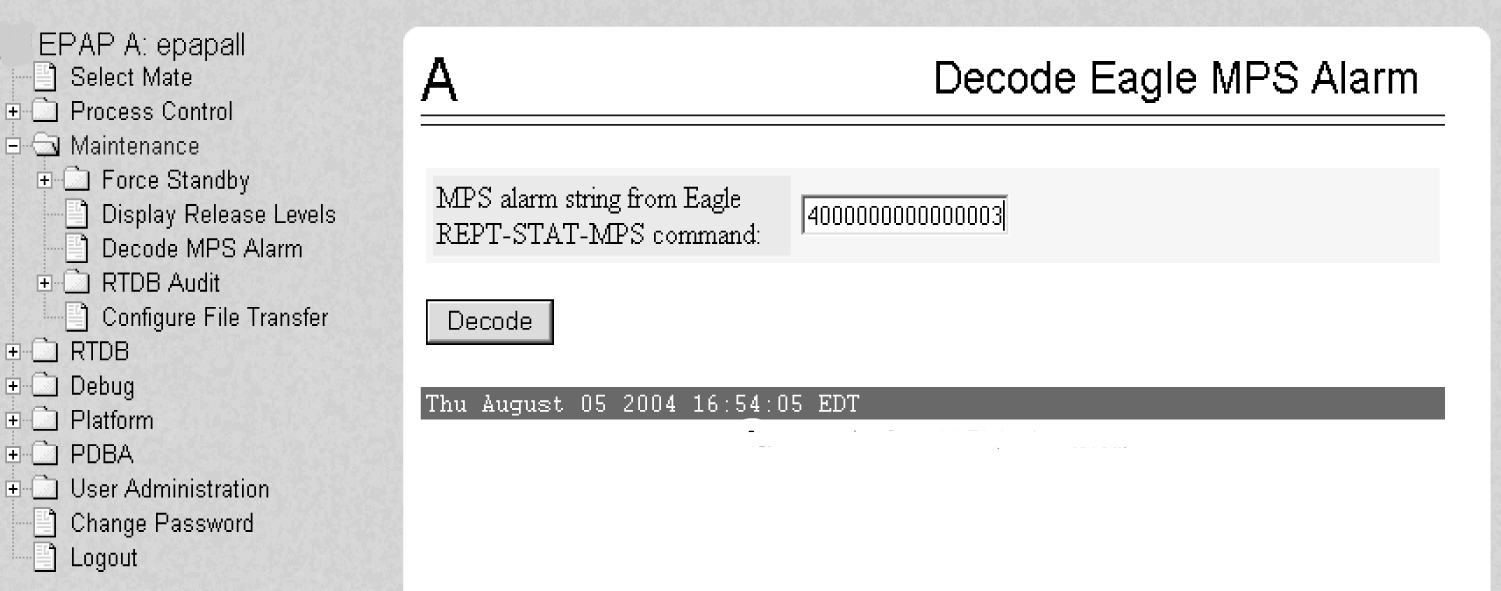

3.5.1 Decode Alarm Strings
Use the following procedure to decode alarm strings that consist of multiple alarms.
  1. Log in to the User Interface screen of the EPAP GUI (see Accessing the EPAP GUI).
  2. After logging in to the EPAP, select Maintenance>Decode MPS Alarm from the menu.
  3. Enter the 16-digit alarm string into the window on the Decode MPS Alarm screen, as shown in Figure 3-21.
    Figure 3-21 Decode MPS Alarm Screen
  4. Click the Decode button.
    The system returns information on the Alarm Category (Critical Application, Major Platform) and error text, as shown in Figure 3-22.
    Figure 3-22 Decoded MPS Alarm Information
