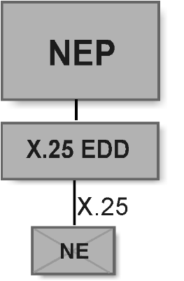

The NEP supports the X.25 and X.29 protocols. The X.2X EDD is an external device driver that allows the NEP to easily communicate with an NE through either the X.25 or X.29 protocol.
The EDD acts as a gateway where each connection goes into the X.25 EDD and comes out as one X.25 logical channel. Each command processor deals with one X.25 logical channel.
The X.2X EDD communicates with an NE through X.25 when the NE is in packet mode. The X.2X EDD is also able to communicate with an NE through X.29 when the NE is in non-packet mode DTE (Data Terminal Equipment), or start-stop mode DTE.
For more information, see the discussion on BX25_EDD configuration parameters in the ASAP Server Configuration Guide.

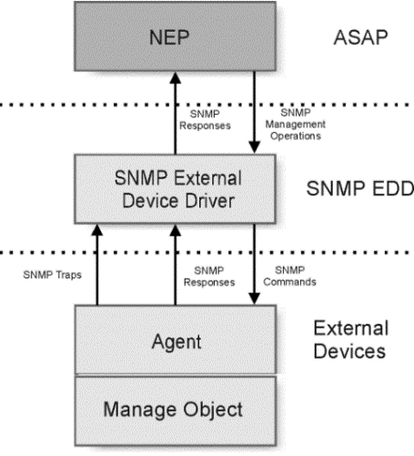

SNMP Interface Configuration Parameters
ASAP includes NEP support for the SNMP NE Interface.
This section describes the configurable aspects of the SNMP NE interface and the configuration process.
SNMP Research Toolkit Configuration
The SNMP Research BRASS (Bilingual Request and Security Subsystem) Server is used to support the SNMP option. The BRASS Server is a management multiplexer that is used with the ASAP SNMP NEP. The BRASS Server maintains information about MIB variables, performs SNMP requests and filters incoming SNMP Trap messages. As a multiplexer, the BRASS Server coordinates SNMP management operations for many connected instances of ASAP SNMP NEP applications.
SNMP Research Asynchronous Request Library requires an environment variable named SR_MGR_CONF_DIR to determine where the MIB compiler generated configuration files are located.
The BRASS Server is bundled with ASAP, however, it must be started manually prior to starting the SNMP NEP.
For more information, refer to SNMP Research documentation.
