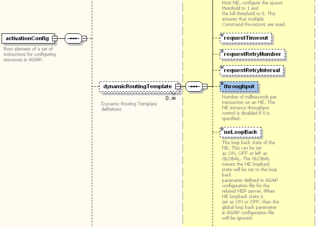

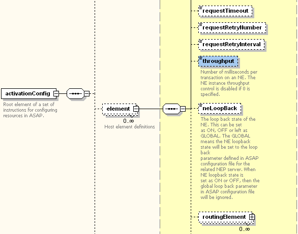

NE instance throughput (expressed as the number of milliseconds per transaction on an NE) can be configured using XML through the SACT or using asap_utils. (See asap_utils option 18. Set NE instance throughput in the ASAP Server Configuration Guide for more information).
For general information on NE throughput configuration, see the ASAP Server Configuration Guide.
The Activation Configuration XML schema supports configuration of NE instance throughput through the ElementType and DynamicRoutingTemplateType schema definitions, illustrated below:
Figure A-2 DynamicRoutingTemplateType Schema
Description of "Figure A-2 DynamicRoutingTemplateType Schema"
