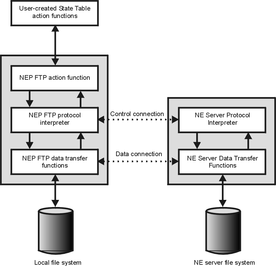

                                     Boolean flag. Specifies whether the FTP NE interface should be enabled. To perform NEP FTP services, you must use the State Table NEP FTP action functions. Refer to the ASAP Developer's Guide for more information.  |
                                     LDAP  |
                                     LDAP_IF_SUPPORTED  |
                                     Mandatory  |
                                     1  |
                                     Indicates whether LDAP is enabled.  |
To set up a control connection to the appropriate server, you must also set up the communication parameters in the SARM database table tbl_comm_param.

FTP Port Communication Parameters
The NEP server provides built-in support for a TCP/IP FTP client interface. This client interface allows for FTP and SFTP communication. You can enable and configure the NEP FTP driver to communicate with NEs for file transfer. In conjunction with the standard action functions, UNIX or Linux file management action functions, and FTP action functions, files, and contents of files can be constructed, managed, sent, and received by the NE-specific State Table programs over such FTP connections.
You can write a State Table Program using the FTP action functions provided by the NEP. The request is submitted to the NE and the NE FTP server analyzes the request and takes the proper FTP-related functions. The NE sends the correct responses back to the NEP through the FTP control and data connections. Response messages are stored in the appropriate diagnostic files.
Numerous FTP commands and choices are provided by the FTP protocol specification to control the way a file is transferred. Although the NEP FTP does not use all possible options, it does support the minimum requirements for a standard FTP client.
For more information on FTP action functions, see the ASAP Developer's Guide.
FTP uses the following TCP connections to transfer files:
Control Connection – Initiated by the client (NEP FTP) to a server (NE FTP server). Prior to this connection the server does a passive open on the port for FTP (port 21) and waits for a client to connect. The control connection stays alive during the entire communication session between client and server. This connection is used for sending and receiving FTP commands and replies (error codes, status information, etc.).
Data Connection – Created each time a file (or directory listing, etc.) is transferred between the client and server. The client uses an ephemeral port, which is supplied by the system host, for each connection.
The following diagram shows the high level functional architecture of the NEP FTP and the NE FTP server based upon the RFC 959 FTP model. The diagram shows the two TCP connections and the respective components for interpreting FTP commands and transferring files. FTP users (State Table programs) do not deal with FTP commands and replies. These are handled by the protocol interpreters on both sides and whenever a file is about to be transferred, a data connection is established.
Figure 11-1 NEP FTP and NE FTP Server Functional Architecture
Description of "Figure 11-1 NEP FTP and NE FTP Server Functional Architecture"
The NEP FTP is the FTP client component of the NEP which provides State Table programs the capability to send and receive files to and from an NE, and to also delete files.
The NEP Multi-Protocol Manager handles the initial FTP control connection to the NE. After the connection is successful, the FTP State Table commands are interpreted and the appropriate FTP commands are sent to the NE FTP server through the control connection.
Whenever a file is transferred, the NEP FTP creates a data connection and the file is transferred through that connection.
FTP communication is a core ASAP NE interface. The SARM database table tbl_comm_param must contain entries for the remote server address, port, host name, user ID, and password. You must also set up the device type and device value in the table which are F and COMMON_DEVICE_CFG respectively.
For information about tbl_comm_param, see tbl_comm_param in the ASAP Developer's Guide.

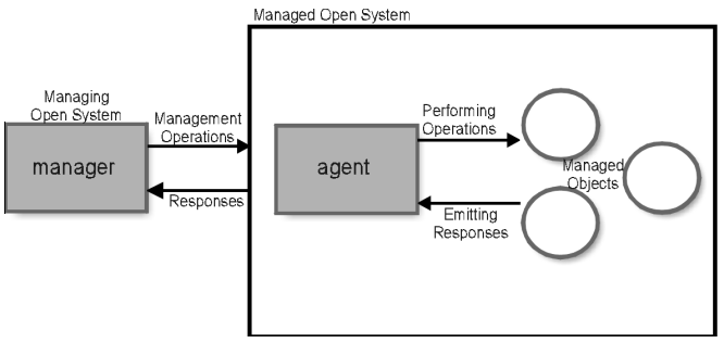

You can write a State Table Program using SNMP action functions provided by the NEP. This request is submitted to the NE, and the SNMP agents can send traps back to the NEP and print to the ASAP diagnostic file.
The NEP SNMP manager provides SNMP agents with access to SNMP management operations through State Table action functions, and intercepts the management responses and SNMP traps. The NEP SNMP coexists with other interface types in the same NEP, including core interfaces such as TL1 and X.25/X.29.
ASAP processes each State Table program in an interactive mode by sending a command to an NE and waiting for a response. ASAP also processes more than one State Table program simultaneously with multiple connections to NEs.
Figure 11-2 illustrates the SNMP Manager interface.
To interface with NEs supporting the SNMP, State Tables can do the following:
Send requests to the agents.
Receive traps from the agents.
Receive trap messages from the agents, used to notify the NEP of errors and other significant events encountered during the process.
The NEP SNMP option supports SNMPv1, SNMPv2*, and SNMPv2c, including authentication, authorization, access control, and privacy.
For more information on the SNMP interface, see the ASAP Developer's Guide.
