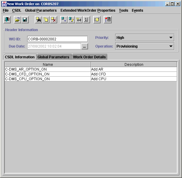

Adding Header Information
The Header Information section of the New Work Order window identifies the general work order parameters.
Table 2-1 Work Order Header Fields
| Field | Definition |
WO ID |
The work order identifier. A default work order ID is automatically generated by the system. If required, you can modify the work order ID. Maximum length: 80 characters. |
Due Date |
The date and time that you want the work order processed. The due date defaults to the current system date and time. |
Priority |
The priority of the work order. The default is High. Other valid values are Normal and Low. |
Operation |
The operation ASAP is going to apply to the work order. The values are:
To add header information:
If required, edit the automatically generated work order identifier in the WO ID field of the New Work Order window.
Do one of the following to select the date and time for the work order to be processed:
If you use the default date and time, from the Operation list, select the operation that you want to perform on the work order.
Do the following to enter a new date and time for the work order to be processed:
Click the ellipsis button next to the Due Date field.
The Date/Time Properties dialog box opens. The default is the current system date and time.
Select the month from the list.
Select the year from the list.
To select a date, click the number on the calendar.
To select the time, click the time and then use the arrows.
To change from AM to PM if you have selected a 12-hour, click AM or PM and then use the arrows. For information on selecting different time formats, see "Changing the Date or Time Format."
Click OK.
The new date and time are entered in the Due Date field.
From the Priority list, select the required value.
From the Operation list, select the operation that you want to perform on the work order.
After completing the header information for the new work order, you can add CSDL information.

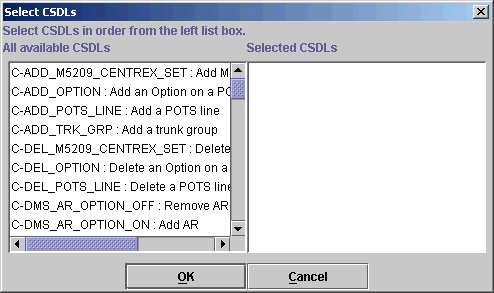

Adding CSDLs
The CSDL is a generic language for ASAP commands that are associated with particular actions from a work order. You must add one or more CSDLs to a work order.
To add CSDL information:
In the New Work Order window, from the CSDL menu, select Add.
The Select CSDLs dialog box appears.
In the All available CSDLs list, click the required CSDLs.
The ones you choose are automatically placed in the Selected CSDLs section.
To deselect a CSDL, click the CSDL in the Selected CSDLs section.
Each selected CSDL is automatically placed in the All available CSDLs list.
Click OK.
The names and descriptions of the selected CSDLs appear in the CSDL Information tab.

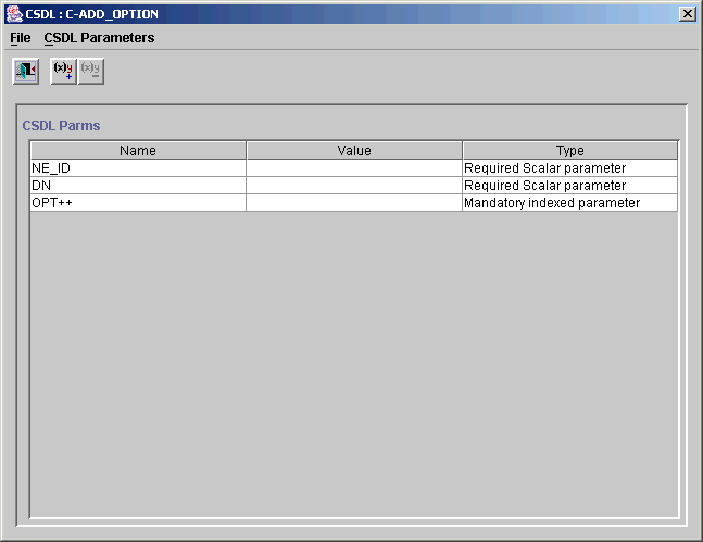

To add CSDL parameter values:
In the CSDL Information tab of the New Work Order window, select the CSDL that you want to add parameter values to.
From the CSDL menu, select Update.
The CSDL dialog box appears.
In the Value field for the selected CSDL, do one of the following:
Enter the value for each CSDL parameter.
For the MCLI parameter, select the applicable value from the Value list.
Tip:
You can CTRL+click a selected CSDL to deselect it.
From the File menu, select Exit.

Submitting Work Orders
When you have provided the appropriate information for the work order, you can submit it. OCA validates all work orders. A warning message appears if any required values are missing. Before the work order can be successfully submitted, you must provide any missing information.
To submit a work order:
In the New Work Order window, from the File menu, select Submit Work Order.
Do one of the following:
If the work order is accepted, a confirmation message appears. Click OK. The work order is submitted.
If the work order is rejected, a rejection message appears. Make the necessary changes and resubmit the work order.
The successful submission of a work order indicates that the order has been accepted for further processing. You can check the Work Order Query window for further status updates on this work order.
To create another work order by clearing the information from the work order you have just submitted, from the File menu, select New Work Order. A message appears asking you to confirm that you want to reset the work order. Click Yes. The WO ID field in the New Work Order window displays the new work order ID, and all other work order information is cleared.
If you do not want to submit any more work orders, from the File menu, select Exit.

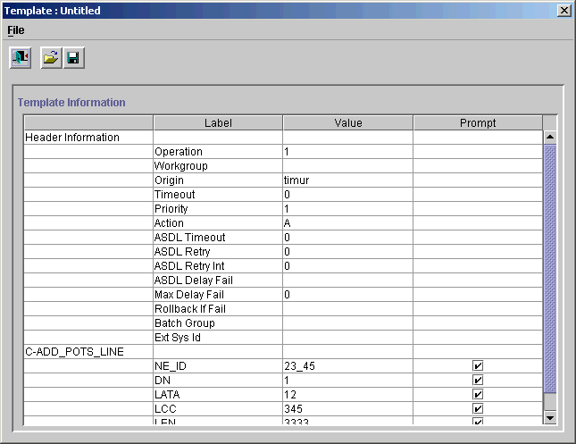

To create a work order template:
In the New Work Order window, from the File menu, select Save as Template.
The Template window appears.
The Template window displays the work order header information, CSDLs, and the parameters for each CSDL. To designate the CSDL parameters that can be modified in the Order Entry Wizard, enable the corresponding Prompt.
From the File menu, select Save As Template, to save a template.
The Save Template As dialog box appears.
To restrict access to the template to yourself, click User.
To allow all users to have access to the template, click Global.
In the Template field, enter the template name and then click OK.
The name of the template appears in the title bar of the Template window.
In the Template window, from the File menu, select Exit.
In the New Work Order window, from the File menu, select Exit.

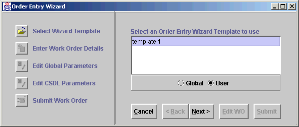

Using the Order Entry Wizard
The Order Entry Wizard guides you through the work order entry process. You use the templates that you have created as a basis for a new work order. To customize the new work order information, you can change global and CSDL parameters as defined by the template you created. All other parameters you predefined when you created the template.
The Order Entry Wizard dialog box consists of the following panels:
Select Wizard Template: Select the template to base your new work order on.
Edit Work Order Details: View and edit the header information.
Edit Global Parameters: Change the global parameters for the work order as designated in the template.
Edit CSDL Parameters: Change the CSDL parameters for the work order as designated in the template.
Submit Work Order: View a summary of the new work order details and submit or edit the work order. If you choose to edit the work order, the New Work Order window appears, and you can make additional changes as required before submitting the work order.
To create new work orders using the Order Entry Wizard:
In the New Work Order window, select Tools, then select Order Entry Wizard.
The Order Entry Wizard dialog box appears.
To select the required template, enable Global or User and then select the template you want to use.
Click Next.
The work order header information is displayed on the right.
If required, edit the work order header information and click Next.
The global parameter details appear.
If required, edit the work order global parameters and then click Next.
Each CSDL that is defined in the template is shown one at a time, and the name of the CSDL you are editing appears above the parameter information. Only CSDL parameters that you designated as prompted in the Template Editor are shown.
If required, edit the CSDL parameters and then click Next. The work order information summary appears.
The work order summary displays the information shown in the previous panels. Click Show all parameters to view all information pertaining to the work order. Click Back to go to a previous panel and edit the required information.
Click Submit.
The Submit Work Order message box appears, stating the work order has been successfully submitted.
