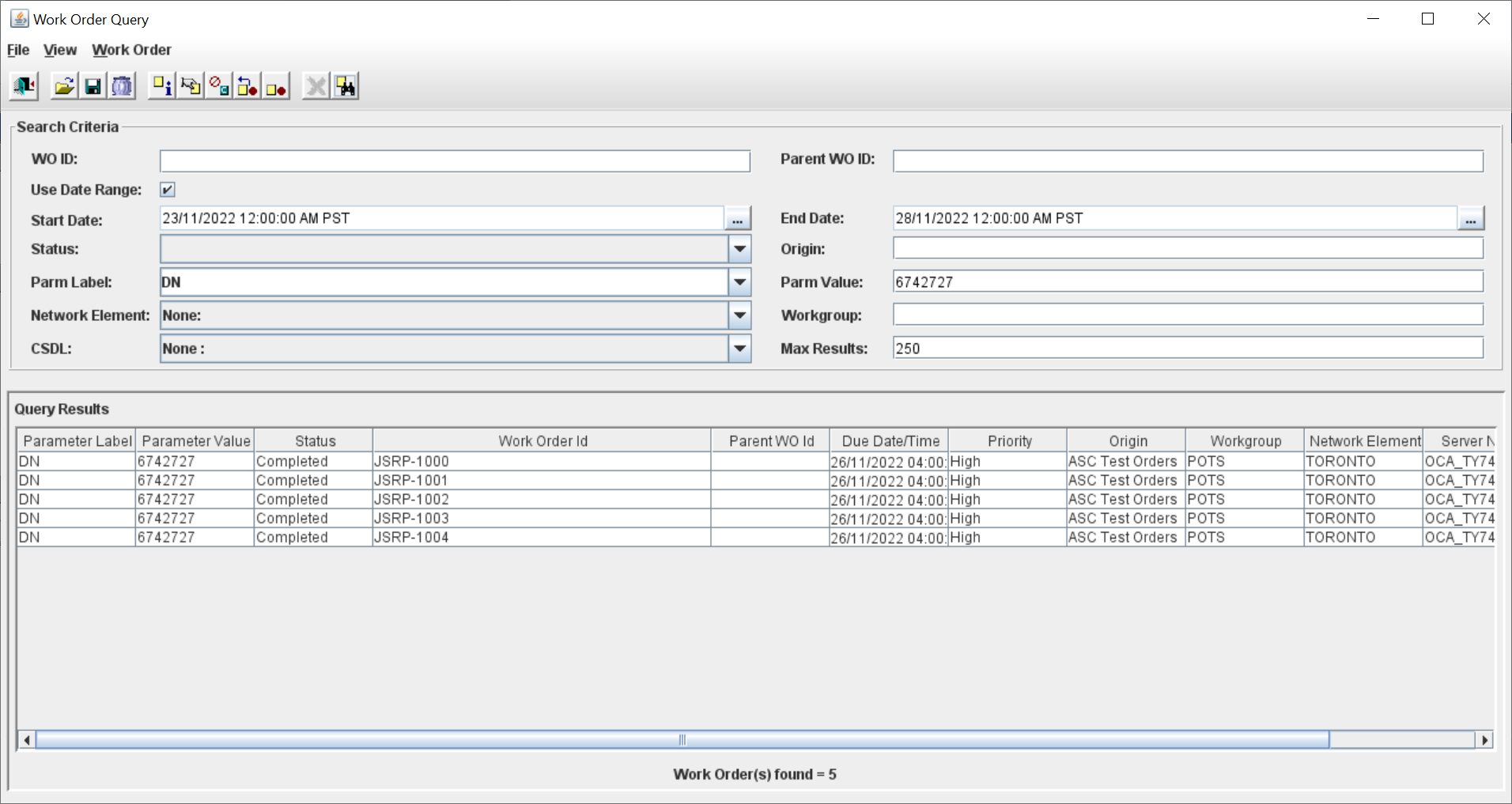

You can access the Work Order Query window from the OCA Console window.
An out-of-memory condition can occur if your query returns too many work orders. This issue is dependent on the Java Virtual Machine (JVM) heap memory. If too many work orders are returned, increase your JVM heap memory or restrict your search.

After specifying the search criteria for the query, from the Work Order menu, select Search.
The search results appear in the Query Results section of the window.

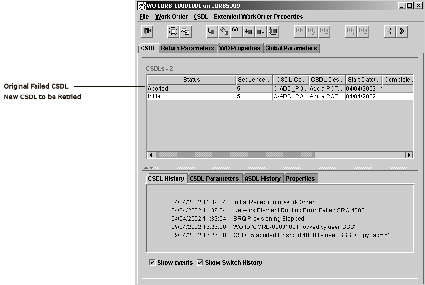

Submitting a Copy of a Work Order for Provisioning
From the search results section of the Work Order Query window, you can copy an existing work order under a new work order ID, make changes, and submit it.
See "Configuring Copy to Submit and Copy to Submit Original" for configuration options.
To submit a copy of a work order for provisioning:
From the Query Results section of the Work Order Query window, select the work order you want to copy.
From the Work Order menu, select Copy to Submit.
The New Work Order window appears, displaying the work order under a unique work order ID.
Make the required changes.
For more information on creating new work orders, see "Creating Work Orders Using the Order Control Application."
Submit the work order for provisioning.
For information on releasing work orders for provisioning, see "Releasing Work Orders for Provisioning."
Submitting a Copy of the Original Work Order for Provisioning
From the search results section of the Work Order Query window, you can copy an existing work order's original data under a new work order ID, make changes, and submit it.
The Copy to Submit command may produce a work order that is validated based on the data updated or inserted by the network element processor. To create a copy of a work order that preserves the original's initial data, use Copy to Submit Original. The validation will only apply to those data fields defined from the original work order.
To obtain the work order's data from its initial state, use either the Original Work Order menu command or the toolbar button on the New Work Order window.

Wildcard Characters
When searching for work orders, you can use the wildcard character % where applicable to represent any number of unknown characters.
Table 3-3 Wildcard Usage
| To search for... | Type... |
All possible values for a field |
All values that begin with h |
h% |
All values that begin with h and end with 2 |
h%2 |
Using Date and Time Properties
You can use date and time properties with all search criteria except WO ID to limit the query to a specific period.
To use date and time properties in a query:
In the OCA Console window, from the Provisioning Management menu, select Order Management.
The Work Order Query window appears.
In the Start Date or End Date fields, click the ellipsis button.
The Date/Time Properties dialog box appears.
Select the month from the list and the year using the scroll bar.
Select the date on the calendar.
By default, the end date is set to the current day. Do not set the end date to a future date.
If necessary, select a specific time or accept the time that is displayed.
Click OK.
The new date and time are entered in the Start Date field.

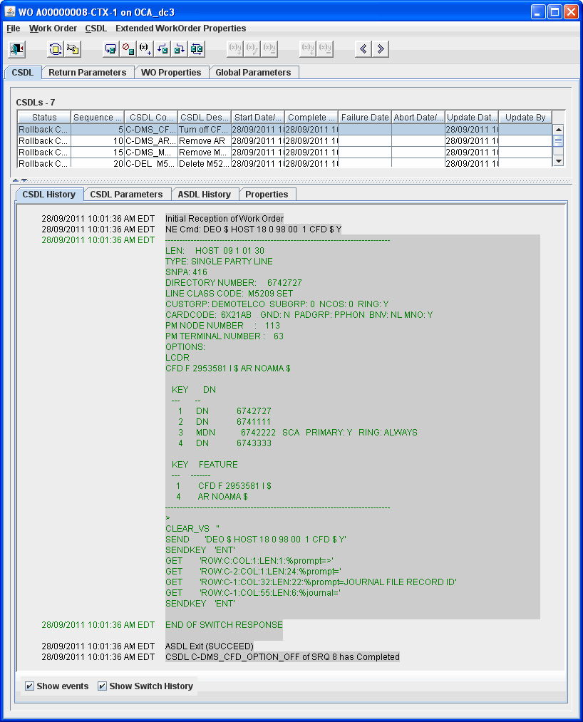

About CSDL History Tab
The CSDL tab provides a CSDL History sub tab. You can enable the following options:
Show events: Provides a response history returned from the NE as a result of MML commands or API calls sent to the NE as a result of a work order.
Show Switch History: You can configure the ASDL Java or State Table implementation to return NE switch history parameters that ASAP stores in the tbl_srq_log database table, in the EVT_TEXT column. This switch history information displays when you select the Show Switch History option. For more information about the tbl_srq_log table, see the ASAP Developer's Guide. For more information about enabling NE History at the Java implementation level, see the ASAP Cartridge Development Guide.
You can augment the information provided in the CSDL History sub tab, by setting the WO_AUDIT_LEVEL parameter in the ASAP_home/config/ASAP.cfg to higher levels. Higher WO_AUDIT_LEVEL setting can have a negative performance impact. For more information about this parameter, see the ASAP Server Configuration Guide.

Retrying CSDLs
You can retry work orders by retrying individual failed CSDLs or all failed and unprovisioned CSDLs. Correcting the CSDL may not be required if the reason for the failure was network-related or equipment-related, rather than CSDL-related. When you retry one or more CSDLs, ASAP aborts the CSDL that caused the failure, copies it, and recreates it in the Initial state. You can then release the work order.
To retry an individual CSDL:
In the CSDL tab of the work order details window, select a CSDL whose status is Failed.
From the CSDL menu, select Retry.
The original CSDL is aborted and a new CSDL appears. The status of the replacement CSDL is Initial.

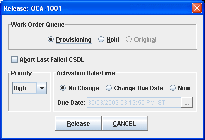

From the Work Order menu, select Release.
The Release dialog box appears.
For information on the options available in the Release dialog box, see "Releasing Work Orders for Provisioning."
Make the required selections.
Select Now to release the work order immediately.
Click Release.
To retry all failed CSDLs:
In the work order details window, from the CSDL menu, select Retry Failed.
Each failed CSDL is aborted and replaced with a new CSDL. The status of the replacement CSDLs is Initial.
If there are multiple ASDLs within a failed CSDL, only failed or rolled back ASDLs are retried. Completed ASDLs are skipped and the retry starts from the first ASDL that failed.
If there are no more corrections to be made, release the work order.
After you have corrected or updated a work order, you can release it for provisioning directly from the work order details window.
You cannot release a locked work order that is being edited by another user. The work order can only be released by the user who originally locked it.
To release a work order to the Provisioning queue:
In the work order details window, search for the work order you want to release.
Click Provisioning in the Work Order Queue section of the dialog box.
To resubmit the work order without the CSDL that caused the failure of the work order, click Abort Last Failed CSDL.
From the Priority list, select one of the following options:
Low: Work orders are submitted to the bottom of the Provisioning queue.
Normal: Work orders are processed after all high-priority work orders have been completed.
High: Work orders are moved to the top of the Provisioning queue.
No Change: Work orders are resubmitted to the Provisioning queue without a change in priority.
To remove a work order from the Hold or Review queue, you must specify a priority other than No Change.
In the Activation Date/Time section, do one of the following:
To release the work order to the provisioning queue immediately, click No Change and then click OK.
To release the work order immediately, click Now.
To specify a time in the future to release the order, click Change Due Date.
In the Due Date field, click the ellipsis button. In the Date/Time dialog box, select the new date and time for the selected work order to be resubmitted to the Provisioning queue. The due date and time you choose must be in the future.
Click Release.
The work is released for provisioning.
