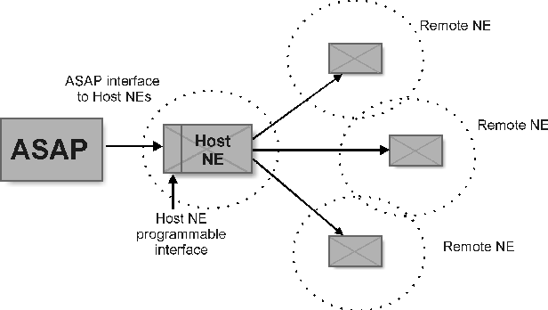

Host and Remote NEs
A host NE is a network element that has an interface through which remote NEs can be provisioned. Several remote NEs covering a given area can be associated with a host NE, which increases the effective coverage of the NE group. Host NEs are not required to have remote NEs assigned to them. An EMS can be considered a host NE if it is configured to manage multiple physical NEs.
Figure 7-2 shows service requests in the form of ASDL commands that are routed through the host NE to the appropriate remote NE.
Every ASDL references a target NE and a software load and version. This information can be configure statically in ASAP or can be provided dynamically as parameters on a work order. The software load and version is used by ASAP to identify a specific interpreter type (C or Java) and program (State Table or Java class.method) to run.

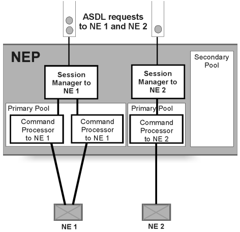

A resource pool is a set of dedicated or shared communication devices that use specific communication protocols and parameters. For example, if NEs are serial asynchronous lines, these devices correspond to physical serial ports.
There are different types of resource pools in the NEP:
Primary Pool – A pool dedicated to a particular NE. It is only used to communicate with that NE. It is not necessary that all devices in the primary pool are used.
Auxiliary Pool – A pool used to connect to any of the NEs that the NEP manages. A session manager can acquire these devices to communicate with its NE. When the session manager no longer requires the devices, it returns them to the auxiliary pool for other session managers to use. For example, a serial modem device could be part of an auxiliary pool.
For example, consider an NEP that is managing two NEs. The first NE has a primary pool of two devices, the second has a primary pool of one device, and the NEP has an auxiliary pool. Figure 7-3 represents the NEP configuration.

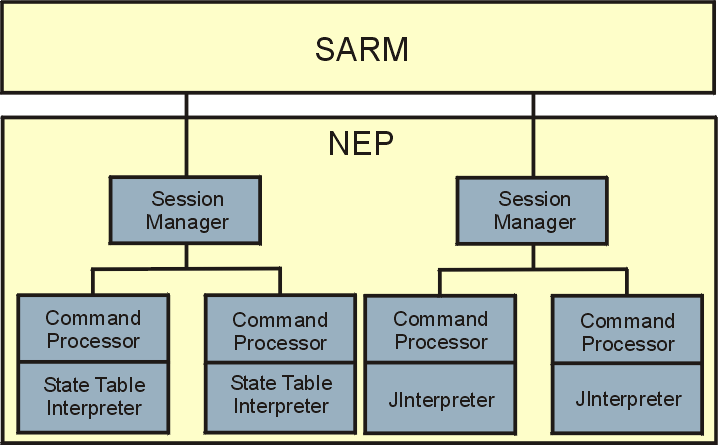

Command Processor
A command processor is a thread that is spawned for each device, in either the primary or auxiliary pool, that manages all interaction with the NEs on a particular connection by using State Table programs or Java methods.
When a session manager receives the first connect request from the SARM, the session manager binds to a command processor in its primary pool. It requests the command processor to connect to and log in to the NE. This connection is termed the primary connection. There is only one designated primary connection to each NE. All other connections to this NE are auxiliary connections, even if they use devices from the primary pool.
The SARM uses a configurable threshold to determine when auxiliary connections to a particular NE are created and destroyed. If auxiliary connections are required, the SARM sends an NE Connect request to the session manager. The session manager then uses an available command processor in its primary pool to open another connection to the NE. If there are no other available devices in the primary pool, the session manager attempts to bind to a command processor from the secondary pool. By doing this, the session manager can manage many concurrent connections to a given NE. For instance, an NEP with five concurrent connections to an NE maintains one session manager and five command processors to manage that NE.
Each command processor can invoke either a State Table Interpreter or JInterpreter. There are still two physical processes within the NEP: a C/C++ process and Java process. The C/C++ process houses the core NEP functionality including the State Table Interpreter. The Java process hosts the JInterpreter.
The layers of functionality of the command processor are:
Application Layer – Handles the communication to the session manager and uses the Interpreter functionality to provision ASDLs through either State Table or Java execution.
Communication Layer – Employs the Multiple Protocol Manager (MPM) functionality to connect to host NEs through various communication protocol drivers. The MPM connects devices to host NEs with various communication protocols. MPM functionality provides a transparent interface between the user-created scripts and the protocol-specific communication details. Protocol-specific communication parameters such as asynchronous serial (wired or dialup), TCP/IP (Telnet, FTP, socket), LDAP, and SNMP interfaces are maintained in the SARM database. The NEP loads these parameters from the SARM after determining the communication protocol to use and prior to connecting to the NE. Every device interface driver provides the functionality to connect to the NE, disconnect from the NE, and transfer data using the specified protocol.
The communication layer functionality is transparent to ASAP users. Once a connection is established to the NE, the application layer handles the execution of the ASDL. The communication layer takes over when problems occur with the connection to the NE. If an ASDL was being run when the problem occurred, the SARM is notified.
Interpreters
ASAP's interpreters run custom code (State Table or Java) to handle device-specific communication with NEs. The custom code is designed to allow for easy, flexible and modular changes to the communication interfaces between ASAP and network elements. State Tables or Java provisioning classes are developed and maintained by a solutions developer (systems integrator, cartridge developer or professional service) independent of the core ASAP product.
Figure 7-4 shows the logical NEP command processor structure.

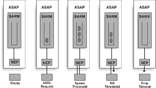

Drop Timeout Parameter
The SARM sends a request to the NEP to disconnect the primary connection to a particular NE after a period of provisioning inactivity, called Drop Timeout. If you set the drop timeout for a busy NE to a high value, such as 24 hours, the connection should never time out and is considered a dedicated connection. If you set the drop timeout to a lower value for an NE that is not very busy, the connection may time out depending on the load to the NE. In general, you should configure NEs that are busy to not time out, and NEs that are not busy to time out.

Spawn Threshold
The SARM triggers the creation and login of new NE connections when the number of ASDLs in the pending queue exceeds the spawn threshold. Connections created in this manner are always auxiliary connections. Once an auxiliary connection has been established, it is used concurrently with other connections to provision ASDLs to a target NE.
By default, the NEP only opens a primary connection to an NE. However, auxiliary connections can be configured to act like dedicated connections by setting a very low spawn threshold.
If the spawn threshold is exceeded by more than one ASDL request, the SARM requests that the NEP establish another auxiliary connection. This process continues as long as:
The number of ASDL requests exceeds the spawn threshold.
Connections to the NE are available.
The maximum number of connections configured by the user is not exceeded.
The spawn threshold must always be greater than the kill threshold if multiple connections are required to a particular NE.
Kill Threshold
SARM triggers the logoff and destruction of NE connections when the number of ASDLs in the pending queue drops below the kill threshold. Connections dropped in this manner are always auxiliary connections.
When the kill threshold is exceeded, the SARM requests that one of the auxiliary connections be terminated. The session manager determines the appropriate command processor and requests that it disconnect from the NE. If the command processor was assigned from the auxiliary pool, it is returned to the auxiliary pool and is made available for all session managers within the NEP to use.
After each ASDL completion, the SARM determines if the current number of ASDLs in the Pending queue is less than the kill threshold. If it is and the ASDL was completed by an Auxiliary NE connection, the SARM sends an NE Disconnect request to the NEP. The NEP disconnects the appropriate Auxiliary port and the SARM decrements its count of available connections to that NE. This process continues as long as the ASDL Pending queue contains fewer ASDL requests than specified by the kill threshold, or until all Auxiliary connections are disconnected.
If the ASDL was completed on the Primary connection, the SARM does not send a disconnect request for the primary connection. Primary connections are dropped according to the drop timeout interval.
Maximum Available Connections
You must configure the maximum number of connections (MAX_CONNECTIONS) that can be established to each NE. The spawn threshold allows additional connections to be opened as required until the number of connections to the NE equals the maximum number of connections.
If the NE is configured within ASAP to allow more connections than is actually available in the primary and auxiliary resource pools, and the SARM sends a request to open the unavailable connection, the NEP sends an Auxiliary connection Failure Notification. When configuring the NE, you must ensure that the maximum number of allowed connections configured is not greater than the total number of connections available.

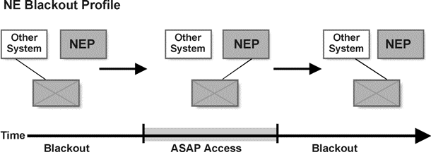

Configuring NE Blackout Periods
If ASAP must share a port to an NE with another system (as illustrated in the figure below) or if regular NE maintenance must be performed, you can define the NE blackout period during which time the NEP will not connect to that NE.
Figure 7-6 shows an NE blackout profile.
The NE Blackout feature automates ASAP NE Access blackout at scheduled times so that the ASAP System Administrator does not have to disable and enable the NE manually before and after the blackout period. When the NEP detects a blackout period during a check of a database table while executing the BLACKOUT State Table action, the NE is put into Maintenance Mode automatically.
You can configure the blackout period in two ways:
Weekly Periodic (Static) – A day of the week, start time, and end time are specified. For example, you can set regular maintenance on the NE to be performed every Sunday between 2:00 a.m. and 4:00 a.m.
Absolute Date and Time (Dynamic) – An absolute date and time for both the start and end periods are specified rather than a day of the week. For example, April 21, 2003 23:59 and April 22, 2003 1:59.
Table 7-4 displays the blackout information you can configure.
