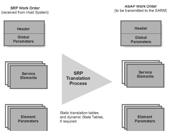

Using this data structure, the SRP performs a translation from the native SRP work order format to the ASAP work order format. Figure 6-1 describes this translation.
The various ASAP work order components created by this process are outlined in the following section.
