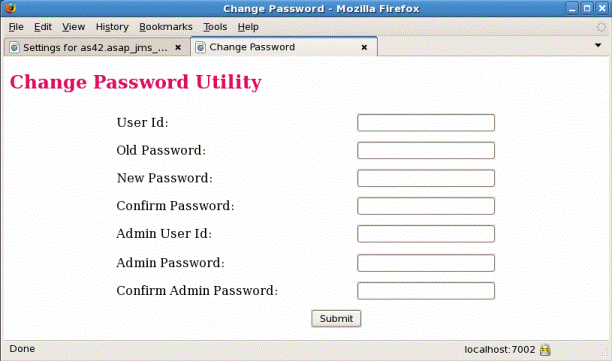

ASAP OCA client users can change their passwords. For more information, refer to the ASAP Order Control Application User's Guide.

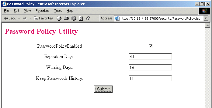

ASAP administrators can configure user password policies through the WebLogic Server Administration Console and the Password Policy Utility page. Password policies defined in the WebLogic Server Administration Console include:
Minimum password length
Lockout enabled
Lockout duration
Reset duration
Lockout cache
Password policies defined in the Password Policy Utility page include:
Password aging
Password expiration warning period
Enabling/disabling password policies
If your ASAP installation includes the OCA client, observe the restrictions described in Table 2-5.
Table 2-5 ASAP Client Password Restrictions

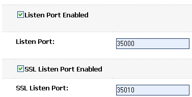

Secure Shell (SSH) must be enabled on the WebLogic Server in order for the Password Policy and Change Password Utility Java server pages (JSPs) to be reachable.
To enable SSH on the WebLogic Server:
Log in to the WebLogic Server Administration Console.
Click Lock & Edit if not already selected. See the WebLogic Server online Help for more information.
In the Domain Structure, click on the domain.
On the Control tab, select Servers.
In the Servers table, click the name of the server to be configured.
Select the SSL Listen Port Enabled checkbox.
Provide an appropriate SSL listen port number in the SSL Listen Port field (that is BEA_SSL_PORT from the Installation Values in the ASAP Installation Guide). Ensure that this is not the same as the server listen port (that is BEA_PORT).
Click Release Configuration.
Restart your WebLogic Server.

Access the Password Policy Utility page by entering the following URL in your web browser:
https://WebLogic_Host:BEA_SSL_PORT/security/PasswordPolicy.jsp) to access.
The Enter Network Password dialog appears.
Enter the WebLogic administrator username and password and click OK.
The Password Policy Utility screen appears.
Complete the following fields:
PasswordPolicyEnabled: Enables or disables the following password security features:
Password change, including password change upon first login, passwords being changed to a previously-used password
Password aging
The following security features are always enabled:
Lockout
Password length of 6 characters or more, but no longer than 20 characters
Inclusion of at least one special character and one number
If you disable the password policy, the password history is deleted.
Expiration Days: Specifies the period of time, in days, for which the password is valid
Warning Days: The number of days prior to password expiration that the user is notified of impending password expiration. The user is prompted to change the password.
Keep Password History: The number of previously-used passwords that are tracked in history. If the password policy is enabled, users are unable to reuse passwords tracked in history.
Click Submit.

To change user passwords:
Type the URL for the JSP, for example,
https://hostname:BEA_SSL_PORT/security/ChangePassword.jsp
The Enter Network Password dialog opens.
In the User Name field, type your user name.
In the Password field, type your password. Click OK.
The Change Password Utility window opens.
In the User ID field, type the user name of the user whose password you want to change.
In the Old Password field, type the user's current password.
In the New Password field, type the user's new password.
In the Confirm Password field, type the user's new password again.
In the Admin User Id field, enter the user ID of the WebLogic Server administrator.
In the Admin Password field, enter the password of the WebLogic Server administrator.
In the Confirm Admin Password field, enter the password of the WebLogic Server administrator again.
Click Submit. A confirmation message appears.
