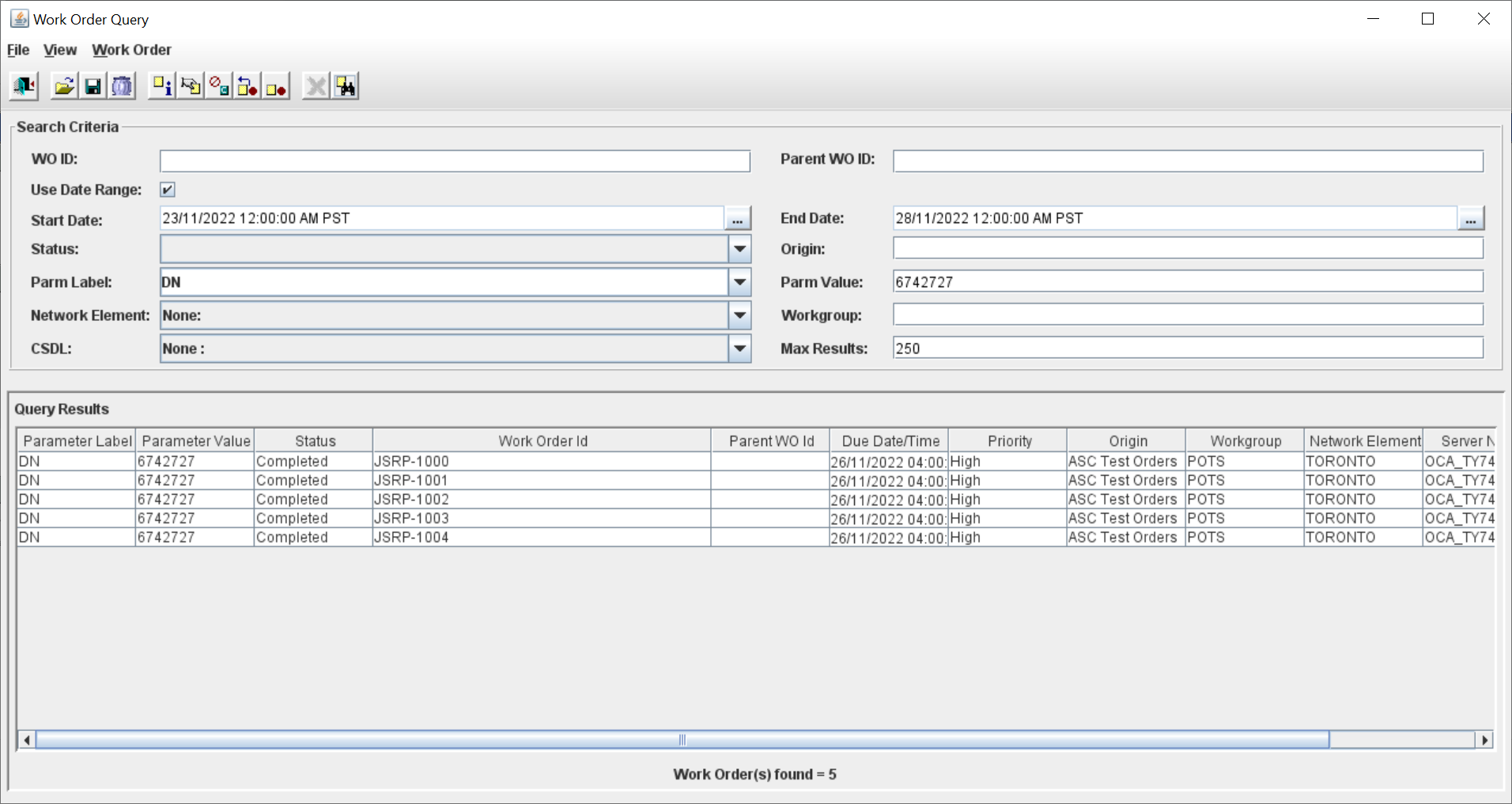

Defining Query Criteria
To restrict the query to specific work orders, use as many known parameters as possible.
Figure 3-1 shows the work order query screen.
Table 3-1 lists and describes the work order query criteria you can use to retrieve work orders.

  1. In the OCA window, from the Provisioning Management menu, select Order Management.
    The Work Order Query window appears.
  2. The Use Date Range check box enables searching by data ranges.
    The Use Date Range check box is enabled and selected by default, to enable searching by date ranges. To disable searching by date and time properties, deselect the Use Date Range check box, which disables the Start Date and End Date.
  3. Set a specific date for Start Date and End Date.
    By default, the Start Date is set to the current date and the End Date is set to the next day of the current date.

Wildcard Characters
When searching for work orders, you can use the wildcard character % where applicable to represent any number of unknown characters.
Table 3-3 Wildcard Usage
To search for... Type...
All possible values for a field
All values that begin with h
h%
All values that begin with h and end with 2
h%2

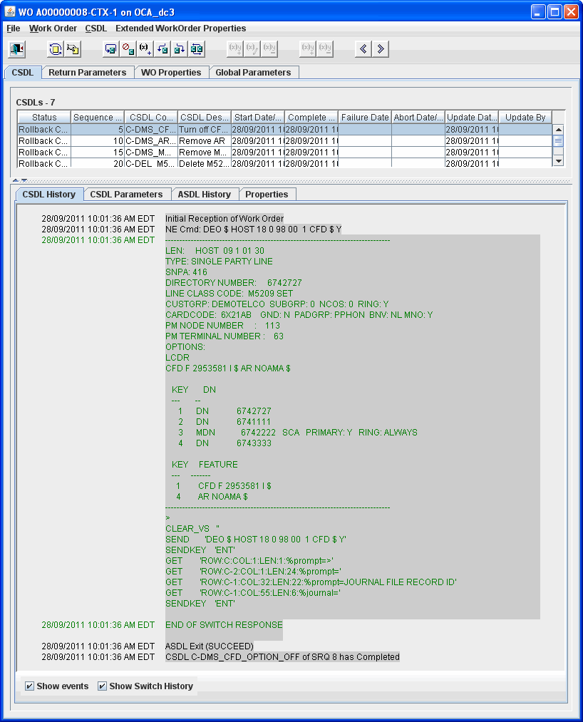

About CSDL History Tab
The CSDL tab provides a CSDL History sub tab. You can enable the following options:
  • Show events: Provides a response history returned from the NE as a result of MML commands or API calls sent to the NE as a result of a work order.
  • Show Switch History: You can configure the ASDL Java implementation to return NE switch history parameters that ASAP stores in the tbl_srq_log database table, in the EVT_TEXT column. This switch history information displays when you select the Show Switch History option. For more information about the tbl_srq_log table, see the ASAP Developer's Guide. For more information about enabling NE History at the Java implementation level, see the ASAP Cartridge Development Guide.
    You can augment the information provided in the CSDL History sub tab, by setting the WO_AUDIT_LEVEL parameter in the ASAP_home/config/ASAP.cfg to higher levels. Higher WO_AUDIT_LEVEL setting can have a negative performance impact. For more information about this parameter, see the ASAP Server Configuration Guide.

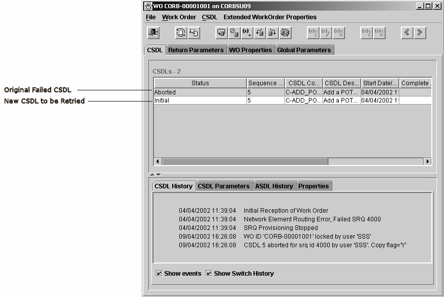

Retrying CSDLs
You can retry work orders by retrying individual failed CSDLs or all failed and unprovisioned CSDLs. Correcting the CSDL may not be required if the reason for the failure was network-related or equipment-related, rather than CSDL-related. When you retry one or more CSDLs, ASAP terminates the CSDL that caused the failure, copies it, and recreates it in the Initial state. You can then release the work order.
To retry an individual CSDL:
  1. In the CSDL tab of the work order details window, select a CSDL whose status is Failed.
  2. From the CSDL menu, select Retry.
    The original CSDL is terminated and a new CSDL appears. The status of the replacement CSDL is Initial.
  3. From the Work Order menu, select Release.
    The Release dialog box appears.
    For information on the options available in the Release dialog box, see "Releasing Work Orders for Provisioning."
  4. Make the required selections.
  5. Select Now to release the work order immediately.
  6. Click Release.
