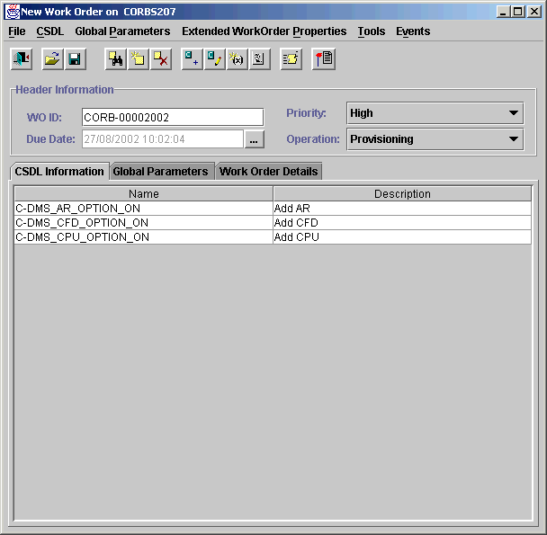

Adding CSDLs
The CSDL is a generic language for ASAP commands that are associated with particular actions from a work order. You must add one or more CSDLs to a work order.

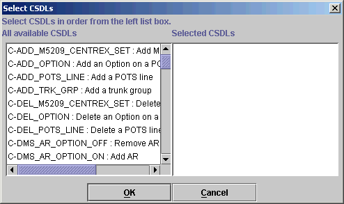

To add CSDL information:
  1. In the New Work Order window, from the CSDL menu, select Add.
    The Select CSDLs dialog box appears.
  2. In the All available CSDLs list, click the required CSDLs.
    The ones you choose are automatically placed in the Selected CSDLs section.
  3. To deselect a CSDL, click the CSDL in the Selected CSDLs section.
    Each selected CSDL is automatically placed in the All available CSDLs list.
  4. Click OK.
    The names and descriptions of the selected CSDLs appear in the CSDL Information tab.
  5. (Optional) To reorder the CSDL, select a CSDL that you want to move and do the following:
    1. From the CSDL menu, select Resequence.
      The CSDL Resequence dialog box appears.
    2. Click on the CSDLs in the left panel in the order in which you want them resequenced.
      As each CSDL is clicked, it appears in the right panel in the new sequence.
    3. To remove a CSDL from the new sequence (to correct an error), click on it in right panel.

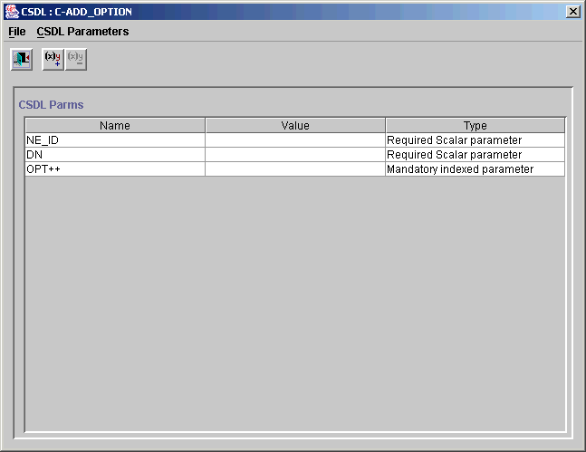

Adding CSDL Parameter Values
CSDLs consist of parameters that are defined when ASAP is installed and configured on your system. The OCA displays the parameters that are associated with a specific CSDL. You can define the values for the CSDL parameter that are required for provisioning, but you cannot add new CSDL parameters.
You can, however, add non-provisionable CSDL parameters and values. Non-provisionable CSDL parameters are any CSDL parameters that are not used by ASAP or defined elsewhere in the provisioning translation process, but may be required to perform activities (for instance, queries) that are not directly related to provisioning. Non-provisionable CSDL parameters may be derived from upstream systems and require representation at the CSDL level.
You must add values for the required parameters before provisioning. Indexed and compound parameters are exceptions. You must add elements to them before adding the parameter values. An index parameter has a ‘++' following the parameter label; for example, OPT++.
The following section includes:
  • Adding CSDL parameter values used in provisioning
  • Adding elements to indexed and compound CSDL parameters
  • Adding non-provisioning CSDL parameters
To add CSDL parameter values:
  1. In the CSDL Information tab of the New Work Order window, select the CSDL that you want to add parameter values to.
  2. From the CSDL menu, select Update.
    The CSDL dialog box appears.
  3. In the Value field for the selected CSDL, do one of the following:
    • Enter the value for each CSDL parameter.
    • For the MCLI parameter, select the applicable value from the Value list.
    Tip:
    You can CTRL+click a selected CSDL to deselect it.
  4. From the File menu, select Exit.

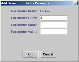

To add elements to indexed and compound parameters:
  1. In the CSDL dialog box, click the Value field for the indexed or compound parameter.
  2. From the CSDL Parameter menu, select Add Element.
    The Add Element for Index Parameter dialog box appears.
    The system-generated index number appears in the Parameter Index field. Entering a value into this field is not allowed by the system.
  3. In the Parameter Suffix field, enter the appropriate number, to insert an indexed compound parameter element.
    The maximum is 80 characters.
  4. In the Parameter Value field, enter the value.
    The maximum is 255 characters.
  5. Click OK.
    The new element name, value, and type appear in the CSDL dialog box below the CDSL index parameter.
To add non-provisionable CSDL parameters:
  1. In the CSDL Information tab of the New Work Order window, select the CSDL that you want to add non-provisionable parameter values to.
  3. From the CSDL Parameters menu, select Add Non-Provisionable Parameter.
    The Add Non-Provisionable Parameter dialog box appears.
  4. In the Name field, enter the parameter name.
  5. In the Value field, enter the parameter value.
  6. Click OK.
    The non-provisionable parameter name and value appear in the CSDL parameter dialog box. The value in the Type field is Optional parameter, indicating that the parameter is not required for provisioning.

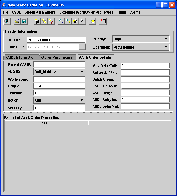

Specifying Work Order Details
After you have added the required CSDLs for the work order and their parameters, you must specify work order details. In the Work Order Details tab, you can set the work order details that you require. In the Work Order Details tab, use the Extended Work Order Properties section to create work order property names and values that suit your requirements. Table 3 contains the field names and their definitions.
To specify work order details:
  1. In the New Work Order window, click the Work Order Details tab.
  2. Enter or select the applicable values in the required fields.
    Table 2-2 Work Order Detail Fields
    Field Definition
    Parent WO ID
    If applicable, the ID of the work order that must be provisioned before the displayed work order is provisioned (maximum 16 characters).
    VNO_ID
    The ID of the virtual network operator. This field and its value represents an ASAP Extended Work Order Property that appears only if VNO_ENABLED is set to 1 in the ASAP.cfg file.
    The default value for this field is configurable based on the OCA SRP using VNO_ID_DEFAULT and VNO_ID_STRIP in the Service Activation Request Manager (SARM) section of ASAP.cfg.
    For more information on both of these attributes, refer to ASAP System Administrator's Guide.
    Workgroup
    The work group to which the work order belongs (maximum eight characters).
    Origin
    The user or system from which this work order originated. The data is user-defined. If you do not enter a value, the system records “Unknown" in the field (maximum 64 characters).
    Timeout
    The work order timeout interval used for this work order instead of the system-wide SARM default.
    Action
    The default value is Add. The action is used to decide the order of provisioning for future-dated orders set for the same time. The provisioning order from first to last is: Remove, Change, Add.
    Security
    Set the security feature. Possible values are:
    • 0: (the default) Output work order information in diagnostic files
    • 1: Secure work order information
    Max Delay/Fail
    The number of ASDL delayed failures before failing a batch order.
    Rollback if Fail
    In the event of failure, this identifies whether this work order is to be rolled back.
    Batch Group
    A unique number that represents the batch order. The categories of batch orders are:
    • Multiple orders in a batch: Multiple, independent orders grouped logically into a loosely coupled batch and activated in parallel with one another while the error threshold for the batch as a whole is maintained.
    • Single batch order: Set of related work orders requesting the application for the same provisioning action (for example, one switch). In effect, the single batch order is one large order with many instances in it.
    ASDL Timeout
    The ASDL timeout interval to be used on this work order instead of the system-wide SARM default.
    ASDL Retry
    The number of times the ASDL is retried in the event of failure instead of the system-wide SARM default.
    ASDL Retry Interval
    The time period in seconds between ASDL retries used on this work order instead of the system-wide SARM default.
    ASDL Delay/Fail
    Y (Yes) or N (No). Indicate whether or not hard errors encountered on the work orders are to be treated as delayed failures, therefore allowing the order to finish processing before failing.

To add an indexed global parameter:
  1. In the New Work Order window, click the Global Parameters tab.
  2. From the Global Parameters menu, select Add.
    The Add Parameter dialog box appears.
  3. In the Name field, enter the indexed global parameter name.
    When you add a global index type, the Value field is disabled.
  4. In the Type list, select one of the optional or mandatory indexed types and then click OK.
    The indexed global parameter name, value, and type appear on the Global Parameters tab in the New Work Order window.
To add an element to the indexed global parameter that you created:
  1. In the Global Parameters tab, select the indexed global parameter you created.
  2. From the Global Parameters menu, select Add Indexed parameter element.
    The Add Element for Index Parameter dialog box appears. The system-generated index number appears in the Parameter Index field. You cannot edit this field.
  3. In the Parameter Suffix field, enter the appropriate number.
  5. Click OK.
    The new element appears below the index parameter name in the Global Parameters tab. The name of the element is a combination of the parameter name and the index number.
To change the numbering of the indexed global parameters while still retaining the same indexed global parameter order:
  1. From the Global Parameters menu, select Renumber indexes.
    The indexed global parameters are renumbered.

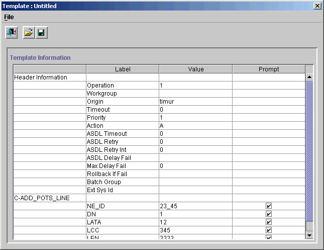

To create a work order template:
  1. In the New Work Order window, from the File menu, select Save as Template.
    The Template window appears.
  2. The Template window displays the work order header information, CSDLs, and the parameters for each CSDL. To designate the CSDL parameters that can be modified in the Order Entry Wizard, enable the corresponding Prompt.
  3. From the File menu, select Save As Template, to save a template.
    The Save Template As dialog box appears.
  4. Do one of the following:
    • To restrict access to the template to yourself, click User.
    • To allow all users to have access to the template, click Global.
  5. In the Template field, enter the template name and then click OK.
    The name of the template appears in the title bar of the Template window.
  6. In the Template window, from the File menu, select Exit.

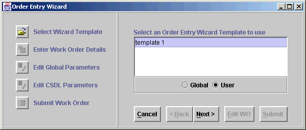

Using the Order Entry Wizard
The Order Entry Wizard guides you through the work order entry process. You use the templates that you have created as a basis for a new work order. To customize the new work order information, you can change global and CSDL parameters as defined by the template you created. All other parameters you predefined when you created the template.
The Order Entry Wizard dialog box consists of the following panels:
  • Select Wizard Template: Select the template to base your new work order on.
  • Edit Work Order Details: View and edit the header information.
  • Edit Global Parameters: Change the global parameters for the work order as designated in the template.
  • Edit CSDL Parameters: Change the CSDL parameters for the work order as designated in the template.
  • Submit Work Order: View a summary of the new work order details and submit or edit the work order. If you choose to edit the work order, the New Work Order window appears, and you can make additional changes as required before submitting the work order.
To create new work orders using the Order Entry Wizard:
  1. In the New Work Order window, select Tools, then select Order Entry Wizard.
    The Order Entry Wizard dialog box appears.
  2. To select the required template, enable Global or User and then select the template you want to use.
  3. Click Next.
    The work order header information is displayed on the right.
  4. If required, edit the work order header information and click Next.
    The global parameter details appear.
  5. If required, edit the work order global parameters and then click Next.
    Each CSDL that is defined in the template is shown one at a time, and the name of the CSDL you are editing appears above the parameter information. Only CSDL parameters that you designated as prompted in the Template Editor are shown.
  6. If required, edit the CSDL parameters and then click Next. The work order information summary appears.
    The work order summary displays the information shown in the previous panels. Click Show all parameters to view all information pertaining to the work order. Click Back to go to a previous panel and edit the required information.
  7. Click Submit.
