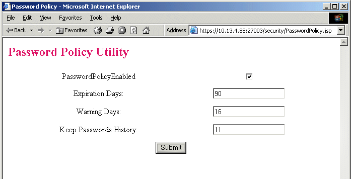

ASAP administrators can configure user password policies through the WebLogic Remote Console and the Password Policy Utility page. Password policies defined in the WebLogic Remote Console include:
  • Minimum password length
  • Lockout enabled
  • Lockout duration
  • Reset duration
  • Lockout cache
Password policies defined in the Password Policy Utility page include:

  9. Access the Password Policy Utility page by entering the following URL in your web browser:
    (https://WebLogic_Host:WLS_SSL_PORT/security/PasswordPolicy.jsp).
    The Enter Network Password dialog box appears.
  10. Enter the WebLogic administrator username and password and click OK.
    The Password Policy Utility screen appears.
  11. Complete the following fields:
    • PasswordPolicyEnabled: Enables or disables the following password security features:
      • Password change, including password change upon first login, passwords being changed to a previously used password
      • Password aging
      The following security features are always enabled:
      • Lockout
      • Password length of 6 characters or more, but no longer than 20 characters
      • Inclusion of at least one special character and one number
      If you disable the password policy, the password history is deleted.
    • Expiration Days: Specifies the period of time, in days, for which the password is valid
    • Warning Days: The number of days prior to password expiration that the user is notified of impending password expiration. The user is prompted to change the password.
    • Keep Password History: The number of previously-used passwords that are tracked in history. If the password policy is enabled, users are unable to reuse passwords tracked in history.
  12. Click Submit.

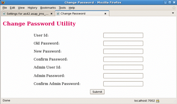

ASAP Administrators can change user passwords at any time using the Change Password Utility JSP, provided that the system uses the WebLogic Server as the user security repository.
An administrator can also change passwords through the WebLogic Remote Console. Oracle does not recommend this because the underlying password policies, such as password length and syntax, cannot be enforced and the administrator is not notified of the policy violation.
Use of the Change Password JSP is not applicable if you are using the WebLogic Server LDAP Realm as the user security repository.
To access the Change Password JSP, you will need the following information:
  • Protocol for the WebLogic Server – Use of https is required to provide security.
  • The Change Password URL is:
    https://hostname:WLS_SSL_PORT/security/ChangePassword.jsp
  • Root context for Security Service – By default, the ASAP installer sets security as the root context of the Security Service.
    For information on the SECURITY_SERVICE configuration variable in the ASAP.cfg file, see the ASAP Server Configuration Guide.
JPasswords must contain at least one uppercase character and one number as well as one special character (that is ~ ! @ # $ % ^ & * ( ) _ + { } | [ ] \ : " ; ' < > ? , . /). This is an internal feature and is not subject to configuration.
To change user passwords:
  1. Type the URL for the JSP, for example,
    The Enter Network Password dialog opens.
  2. In the User Name field, type your user name.
  3. In the Password field, type your password. Click OK.
    The Change Password Utility window opens.
  4. In the User ID field, type the user name of the user whose password you want to change.
  5. In the Old Password field, type the user's current password.
  6. In the New Password field, type the user's new password.
  7. In the Confirm Password field, type the user's new password again.
  8. In the Admin User Id field, enter the user ID of the WebLogic Server administrator.
  9. In the Admin Password field, enter the password of the WebLogic Server administrator.
  10. In the Confirm Admin Password field, enter the password of the WebLogic Server administrator again.
  11. Click Submit. A confirmation message appears.
