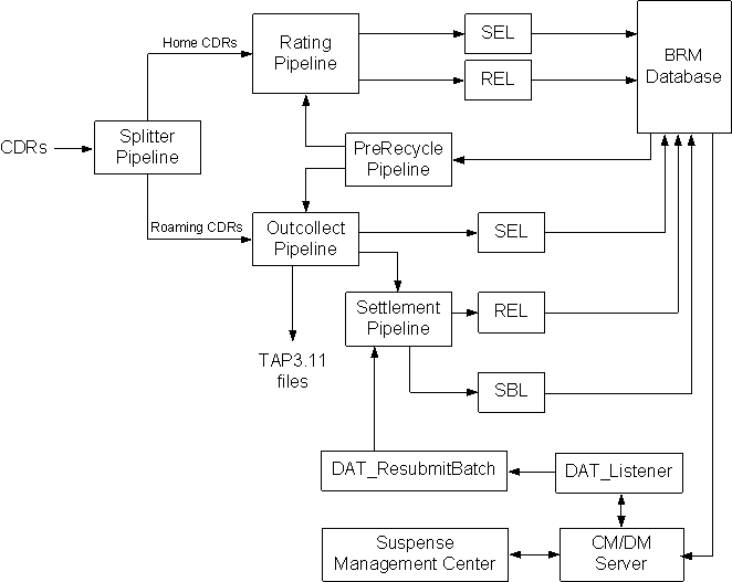

Figure 4-1 depicts a high-level overview of the roaming outcollect process architecture:
Figure 4-1 Roaming Outcollect Process Architecture
Description of "Figure 4-1 Roaming Outcollect Process Architecture"
As Figure 4-1 illustrates, incoming CDRs are handled during the outcollect process as follows:
The splitter pipeline converts the CDRs into event data record (EDR) format and separates the EDRs into home subscribers' EDRs and visiting subscribers' roaming EDRs.
Home subscribers' EDRs are sent to the normal rating pipeline to be rated and loaded into the BRM database by RE Loader. If the rating pipeline fails to rate the EDR, the EDR is suspended and recycled by using Suspense Manager.
Visiting subscribers' roaming EDRs are sent to the outcollect rating pipeline to be rated.
See "How Home CDRs Are Separated from Visiting Subscribers' CDRs" for more information.
The outcollect rating pipeline rates the visiting subscribers' roaming EDRs and generates outcollect TAP files, for each roaming partner network operator, that you send to your roaming partners for verification and billing purposes. A copy of the outcollect TAP file is forwarded to the settlement pipeline for further processing.
If the outcollect rating pipeline fails to rate the roaming EDR, the EDR is suspended and recycled by using Suspense Manager.
See "How Visiting Subscribers' Roaming CDRs Are Rated" for more information.
The settlement pipeline processes the outcollect TAP file and creates settlement events by associating the events with roaming partner accounts in the BRM database. Settlement events are loaded into the BRM database by RE Loader.
If the settlement pipeline fails to create settlement events, the entire TAP file is suspended and loaded into the BRM database. The suspended TAP file can be corrected and recycled back to the settlement pipeline by using Suspense Manager.
See "How Settlement Events for Incollect Roaming Charges Are Created" for more information.
For detailed information on configuring outcollect processing, see "Setting Up Pipeline Manager for Roaming Outcollect Processing".

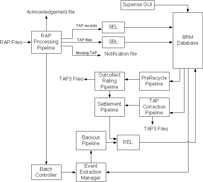

RAP files are handled by the RAP processing pipeline as follows:
The RAP file is parsed by the input module and a RAP Acknowledgment file is generated that you send to your roaming partner. The file includes information about the network operator who sent the RAP file, network operator receiving the file, RAP file sequence number, Acknowledgment file creation timestamp, and Acknowledgment file available timestamp.
For a fatal error RAP file, the entire file is suspended and sent to the TAP correction pipeline for corrections. See "Error Correction for TAP Files with Fatal Errors" for more information.
For a severe error RAP file, the records are suspended and sent to the outcollect rating pipeline for processing. See "Error Correction for TAP Files with Severe Errors" for more information.
For a missing error RAP file, a set of TAP notification files is generated for each missing sequence number.
To back out the balance impacts of the outcollect TAP file or records, the pipeline creates an ASCII file that specifies the extraction criteria for extracting settlement events associated with the TAP file or records. The pin_event_extract utility uses this file to extract the settlement events from the BRM database for backout-only rerating. See "Backing Out the Balance Impacts for the Rejected TAP Files and Records" for more information.
For information on configuring the RAP processing pipeline, see "Configuring the RAP Processing Pipeline".
Figure 4-2 depicts a high-level overview of the RAP processing architecture:

The RAP processing pipeline creates an ASCII file that specifies the extraction criteria for extracting settlement events from the BRM database associated with the rejected outcollect TAP files and records.
For rejected TAP files, the ASCII file is created with a single record with the following information:
Outcollect TAP file sequence number
Network operator sending the TAP file
Network operator receiving the TAP file
For rejected TAP records, an ASCII file is created that contains a record for each rejected TAP record. Each record contains the following information:
MSISDN
IMSI
Call event start timestamp
To back out the settlement event balance impacts (applied to the roaming partner's account when the outcollect TAP file was originally created), you manually run the Event Extraction Manager and specify the ASCII file in the input parameter. Event Extraction Manager uses the information in the ASCII file to extract the settlement events from the BRM database and copies the event data to an output file in the standard BRM input format.
The backout pipeline processes the Event Extraction output file and creates shadow events to negate the balance impacts of the settlement events. The output module writes the shadow events to an output file using RE Loader output grammar. You use RE Loader to load the shadow events into the BRM database.
If the backout pipeline is unable to process the Event Extraction output file, it suspends the entire file. Using Suspense Management Center, you can resubmit the file for processing.
