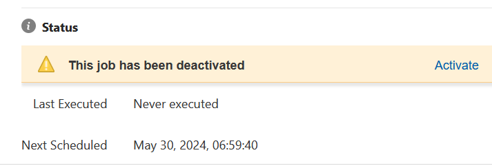

Next to This job has been deactivated, click Activate:
Click Confirm.
