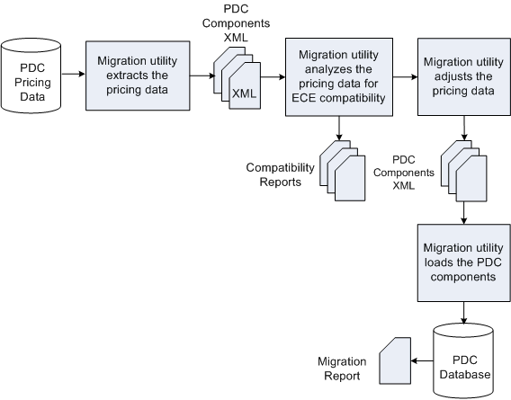

If you are migrating PDC pricing data to PDC with ECE, see "About Migrating PDC Pricing Data to PDC With ECE".

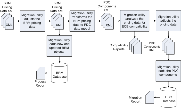

Figure 91-1 shows the data analysis phase for migrating BRM pricing data to PDC with ECE:
Figure 91-1 Data Analysis Phase for Migrating BRM Pricing Data to PDC With ECE
Description of Figure 91-1 follows
Description of "Figure 91-1 Data Analysis Phase for Migrating BRM Pricing Data to PDC With ECE"

Figure 91-2 shows the data migration phase for migrating BRM data to PDC with ECE:
Figure 91-2 Data Migration Phase for Migrating BRM Data to PDC With ECE
Description of Figure 91-2 follows
Description of "Figure 91-2 Data Migration Phase for Migrating BRM Data to PDC With ECE"

If you are using PDC to create and manage your price lists and using the real-time and batch rating engines for usage rating, and you want to use ECE for usage rating, you must first install PDC with ECE and then migrate the pricing data from the source PDC database into the target PDC database.
You use the command-line utility, MigrateBRMPricing, to migrate the PDC pricing data into the target PDC database.
Migration of the PDC pricing data is performed in a single phase, the data migration phase. In the data migration phase, the migration utility extracts the existing PDC data, checks for ECE compatibility, adjusts the pricing data, and migrates the adjusted data to the target PDC database.
You must perform the migration process twice. First you migrate configuration objects. Then, you migrate pricing objects.
The migration utility can adjust most pricing configurations. Adjustments to the PDC pricing data configurations may result in existing objects being updated or new objects being created. In some cases, the migration utility may require additional information from you before it can adjust the data. But, there are some configurations that it cannot adjust and for those cases, you may need to change the configurations manually before continuing with the migration.
You run the MigrateBRMPricing or MigrateBRMPricing -resume command to start the data migration phase.
About the Data Migration Phase for Migrating PDC Pricing Data to PDC With ECE
The following procedure describes how the PDC pricing data is processed in the migration phase:
  1. The migration utility extracts the PDC pricing data and saves the data in XML files.
  2. The migration utility checks the data to determine if the configurations are supported in ECE and whether any configurations need to be adjusted prior to the migration.
  3. The migration utility generates compatibility reports that provide a list of the data configurations that need to be adjusted by the utility during the migration process and any configurations that you would need to adjust manually.
    You need to review the compatibility reports, resolve any pricing data compatibility errors in the PDC database, and restart the migration process.
    When you restart the migration process, the compatibility reports are also re-generated for the latest data.
  4. The migration utility loads the PDC components into the target PDC database.
  5. The migration utility generates the migration report with information about the PDC objects that were successfully migrated to the PDC database.
For more information about the migration utility reports, see "About Migration Reports".
Figure 91-3 shows the data migration phase for migrating PDC data to PDC with ECE:
Figure 91-3 Data Migration Phase for Migrating PDC Data to PDC With ECE
Description of Figure 91-3 follows
Description of "Figure 91-3 Data Migration Phase for Migrating PDC Data to PDC With ECE"
For more information on setting up and migrating the PDC pricing data to PDC with ECE, see "Performing Migration of PDC Pricing Data to PDC With ECE".
