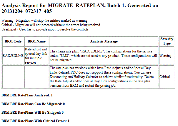

The analysis reports are generated during the data analysis phase of the migration. The reports list the data configurations that are not supported in PDC and that will be modified by the migration utility during the migration process and any data configurations that you need to change manually. Each object in the report is associated with an error message that describes the reason for the error and how to fix it and one of the following severity types:
  • Critical: Indicates that the object configuration is invalid or not supported in PDC. You must manually fix these object configurations in the BRM database.
  • User input: Indicates that the migration utility requires more information about the object configuration to make adjustments. You must provide the required information in XML format.
  • Warning: Indicates that the object will be skipped and not migrated to PDC or the data will be migrated to PDC with changes to some attributes.
  • Info: Indicates that the object will be modified by the migration utility during the migration process.

Figure 90-1 shows a sample product analysis output for the rate plan object.
Figure 90-1 Sample Product Analysis Output for Rate Plan Object
Description of Figure 90-1 follows
Description of "Figure 90-1 Sample Product Analysis Output for Rate Plan Object"
